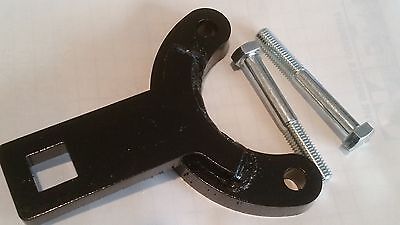

I'm starting to looking into doing this job too, so in the same boat looking for crank tool. Saw this
on ebay, currently out of stock, haven't message the guy yet. Anyone tried this one? Looks like it should work
and the bolt spacing looks right for fzj80 - sellers notes 88.5mm, I saw someone measured on Ih8mud and noted 90mm, so I'm assuming that's the same or within measurement margin.

I have a damaged OTRAMM crank holder tool. The 1/2" hole is rounded out, but the 3/4" is still usable. I'd pretty much just ask for you to pay for shipping from 84124.
The otramm tool has 1/2 and 3/4 hole? All the pics I've seen only have one 1/2 hole. If it's usable and OP doesn't want it I'll take it. I'll pm you. Thanks.
