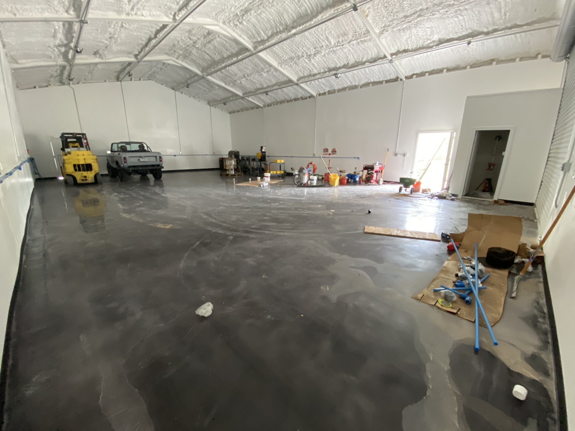

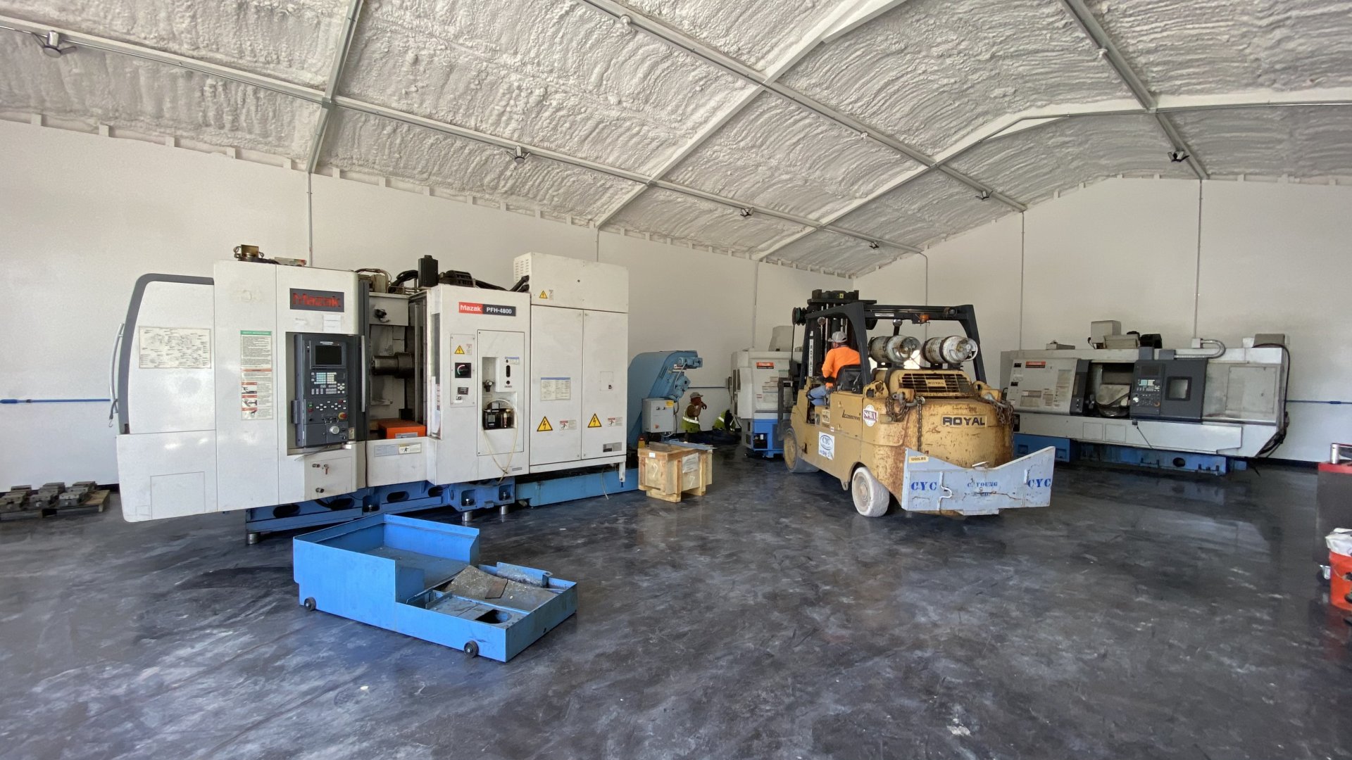

During COVID I had a metal building (40x60x15’) built for a machine shop on our back property. It’s a hobby shop. I will run some parts from my day job to keep the utilities on.
Gang, let me know if we need to make anything for the LC 100? Once up and running could be fun.
Most proud of the polished concrete floor that took us a full week of polishing and staining. Machines are in (but not installed yet) and we are finishing up the electric (480V 3-phase).

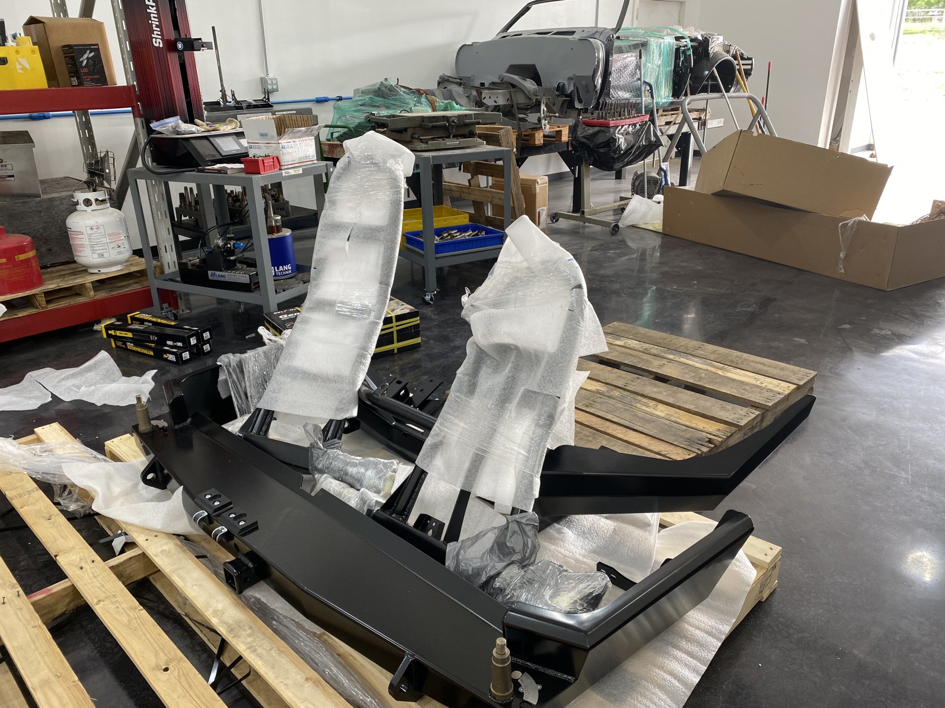

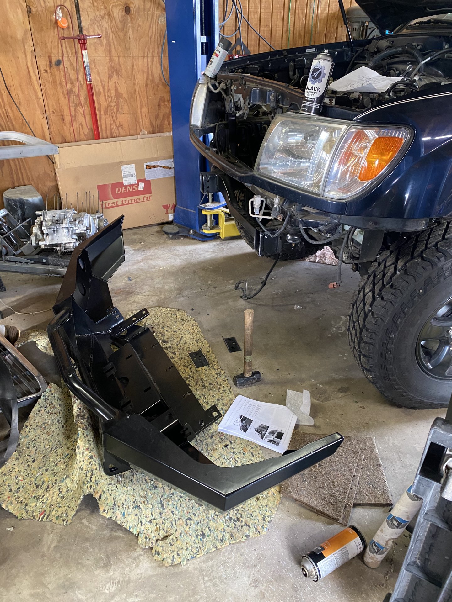

After meeting with Christo after attending a Geophysics conference in Denver we came up with a good solution. The Slee front bumper, rear bumper with tire carrier with ladder and 12.5k lbs ComeUp winch arrived this week.
I totaled my LC !!!

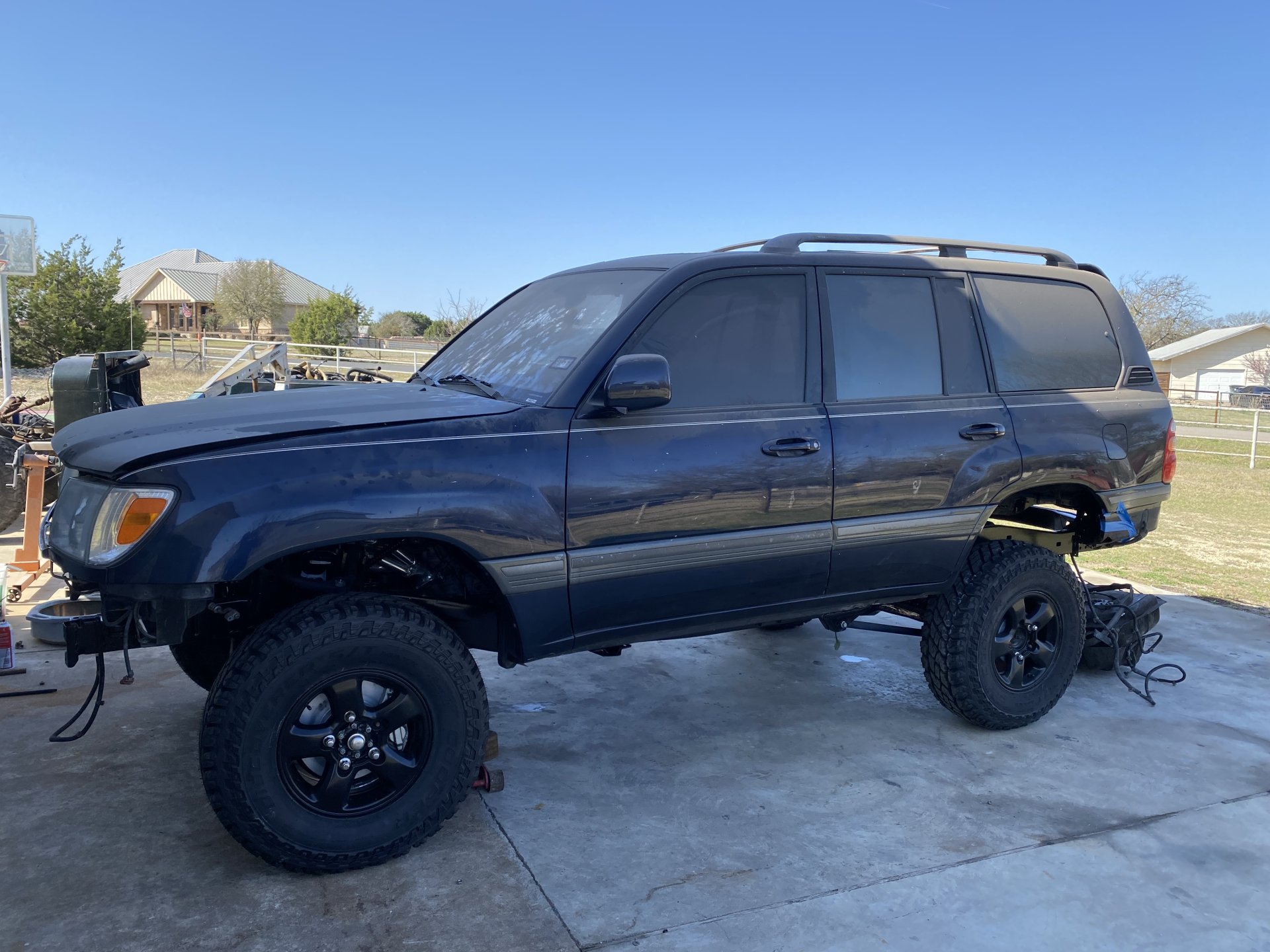

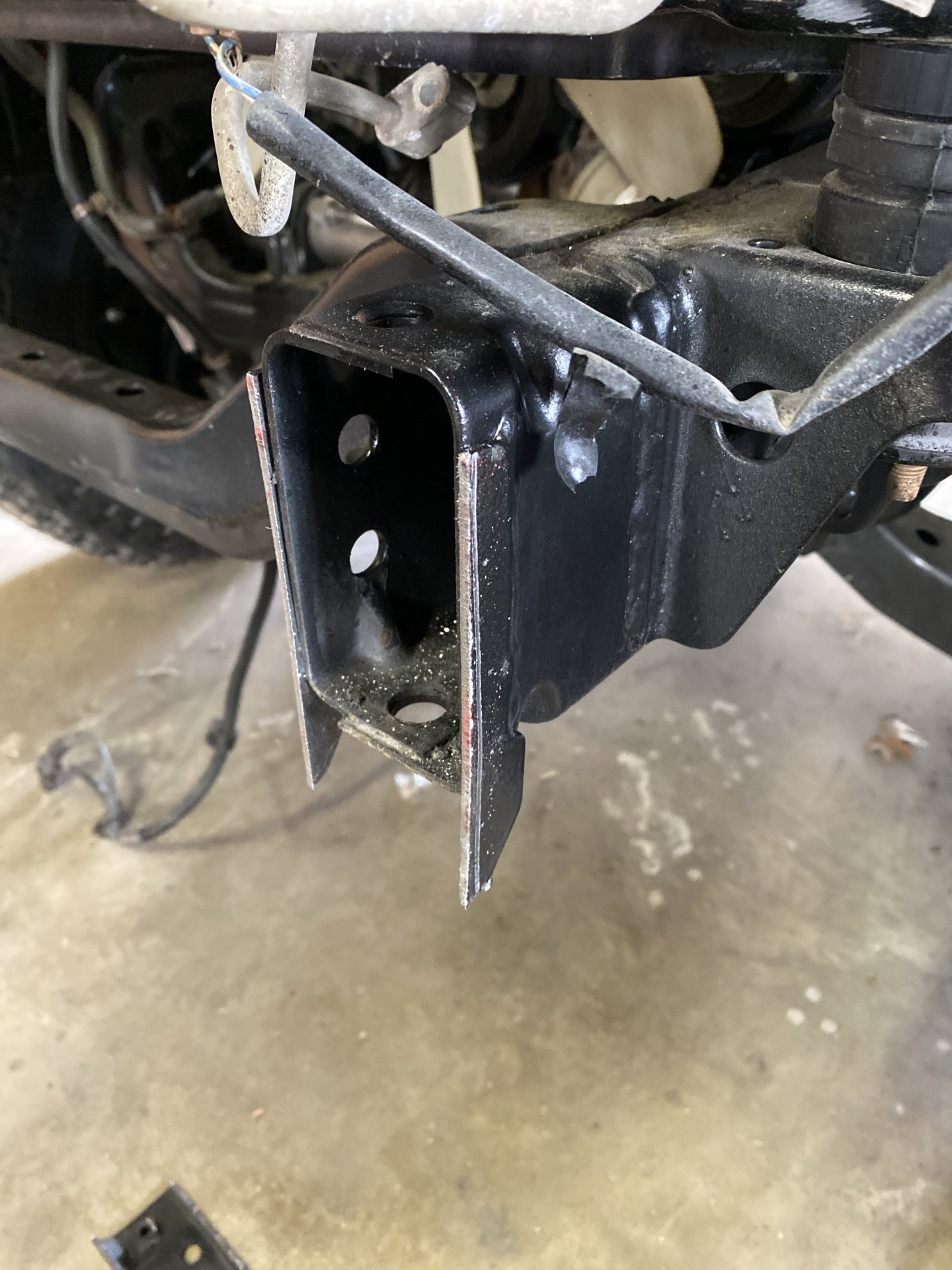

Click bait… Not quite, had to cut the frame horns off to fit the newly arrived @sleeoffroad Blueberry front bumper and 12.5K ComeUp winch.
Technically any alteration to the frame in Texas, damage by accident or self induced totals the vehicle in the insurance companies mind 😂
Maybe that has changed from the days I used to buy at auction and flip cars. Correct me if I’m wrong.

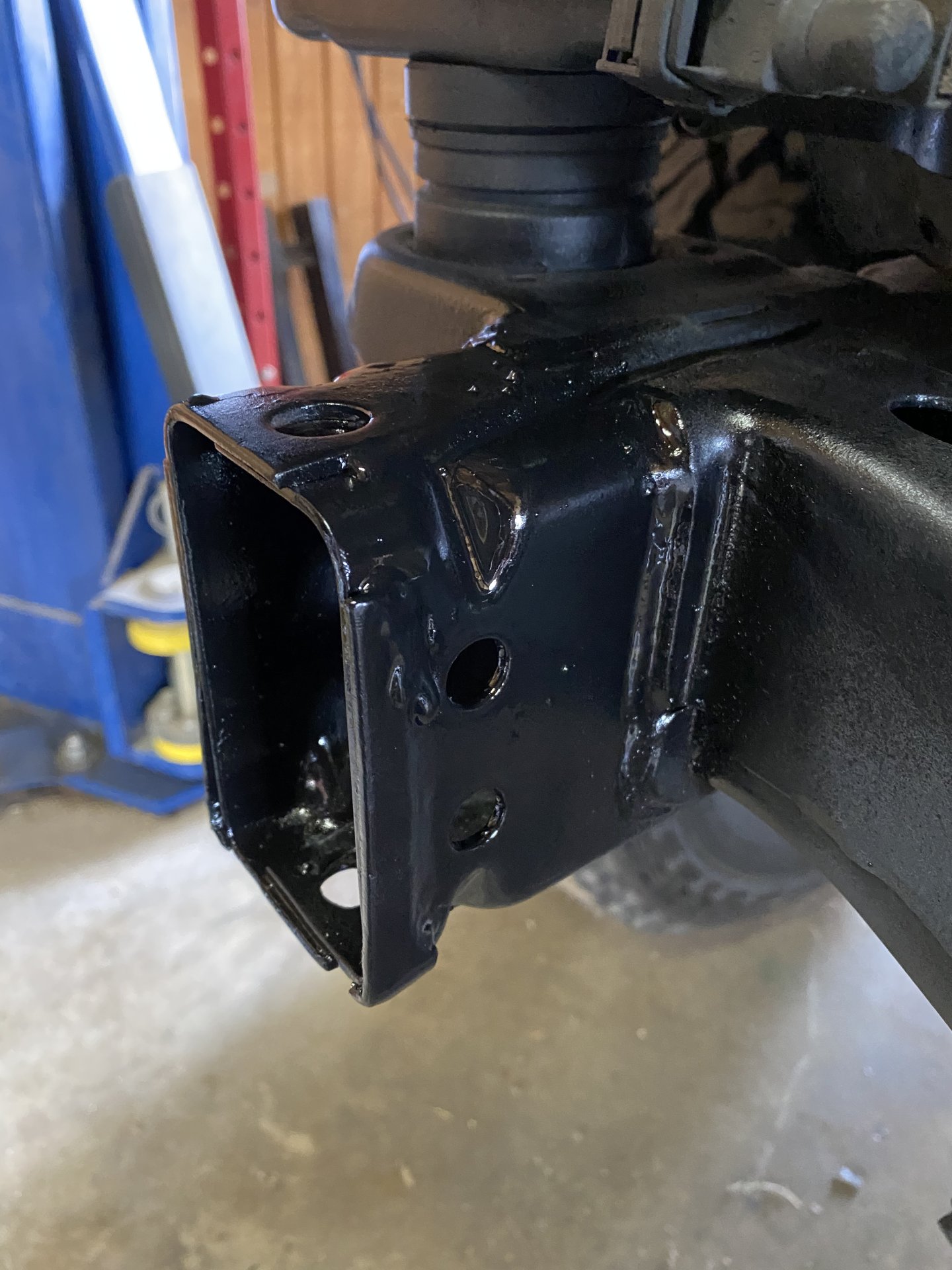

The Cut-off:
Cut bottom tips, hammer bottom tabs, file edges, paint prep, prime and paint:
Now we wait for the paint to dry so that we can get the bumper fitted up and spot the frame hole locations that need to be drilled out for a 1/2” hole
