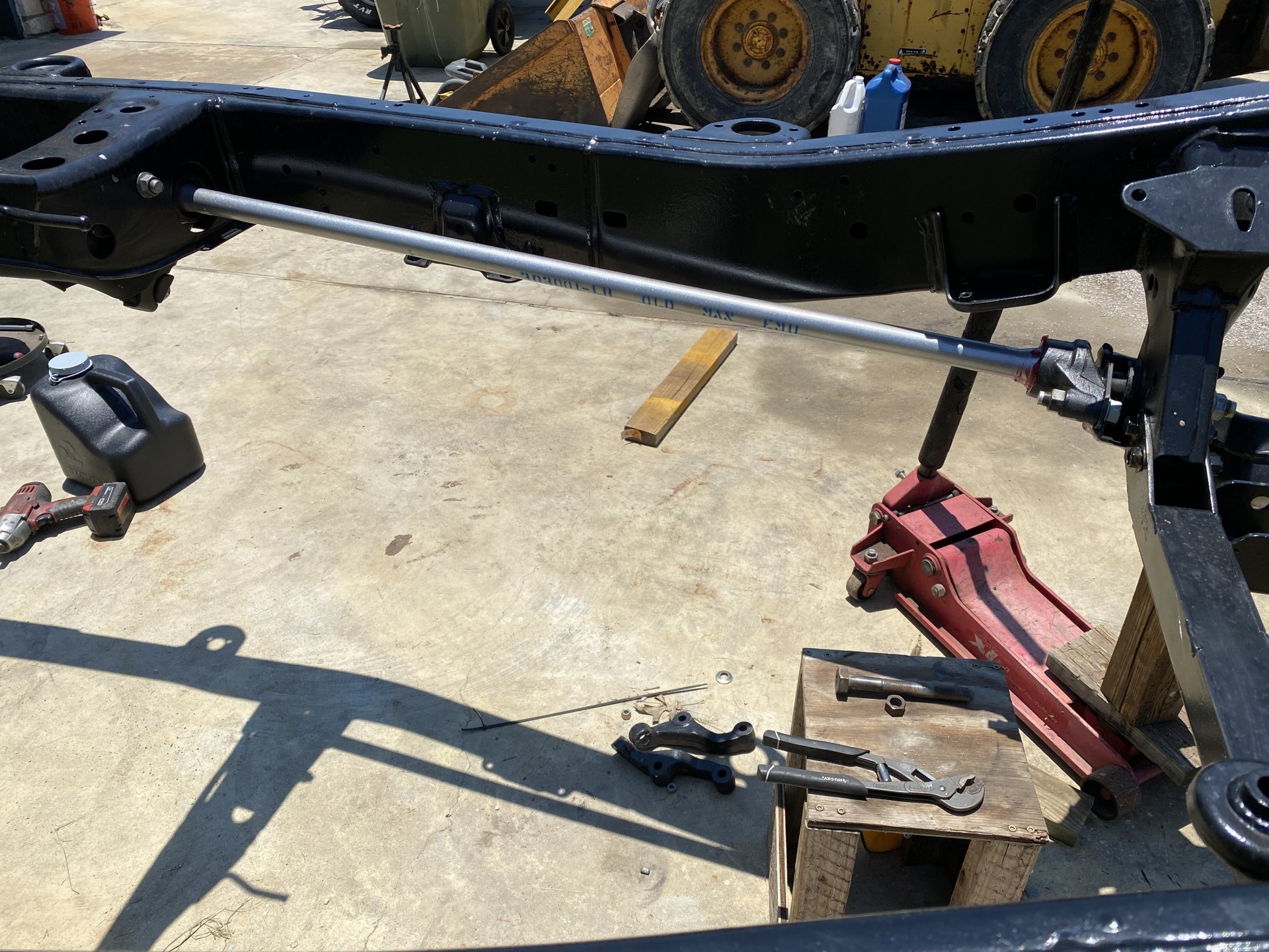

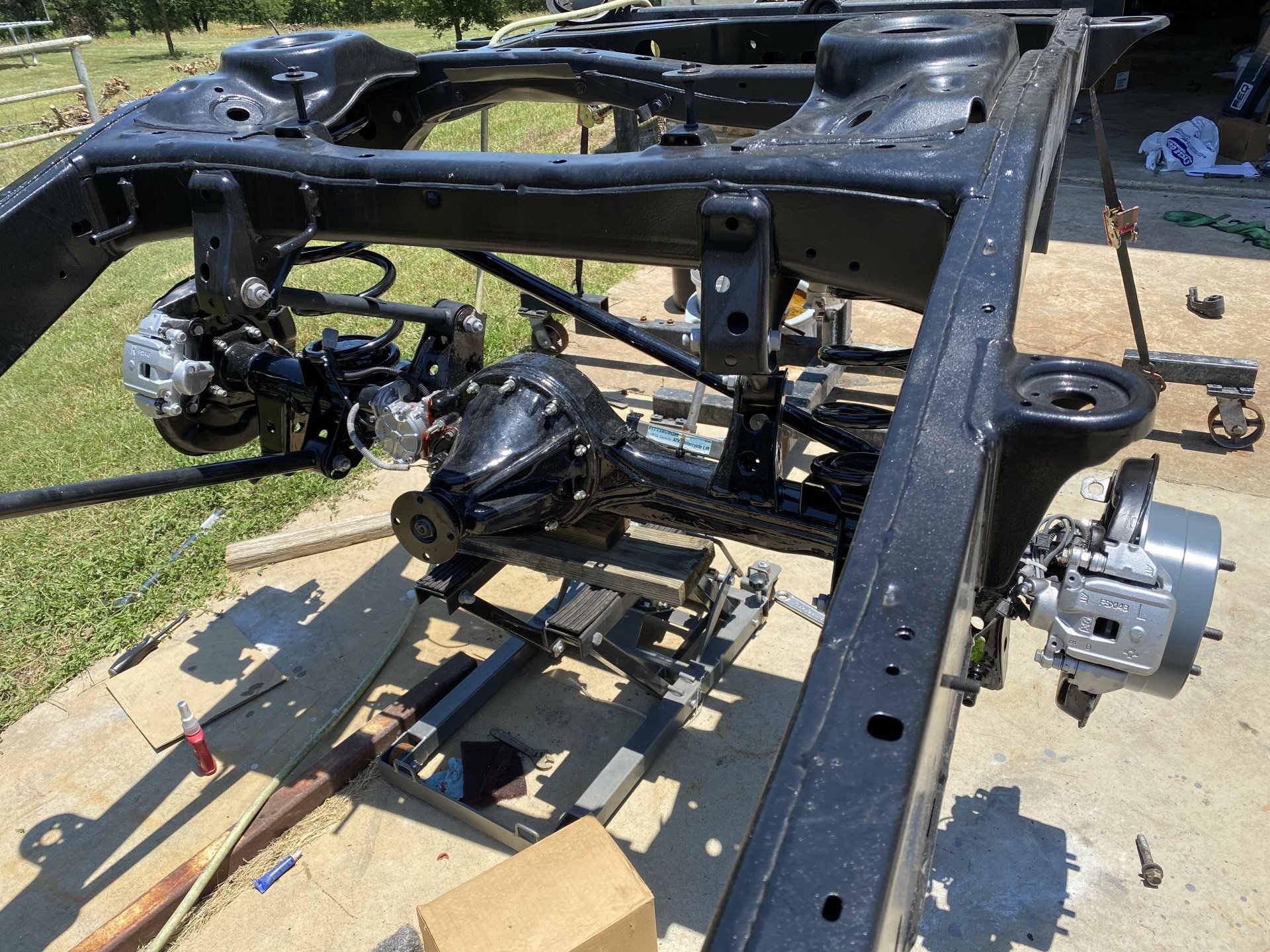

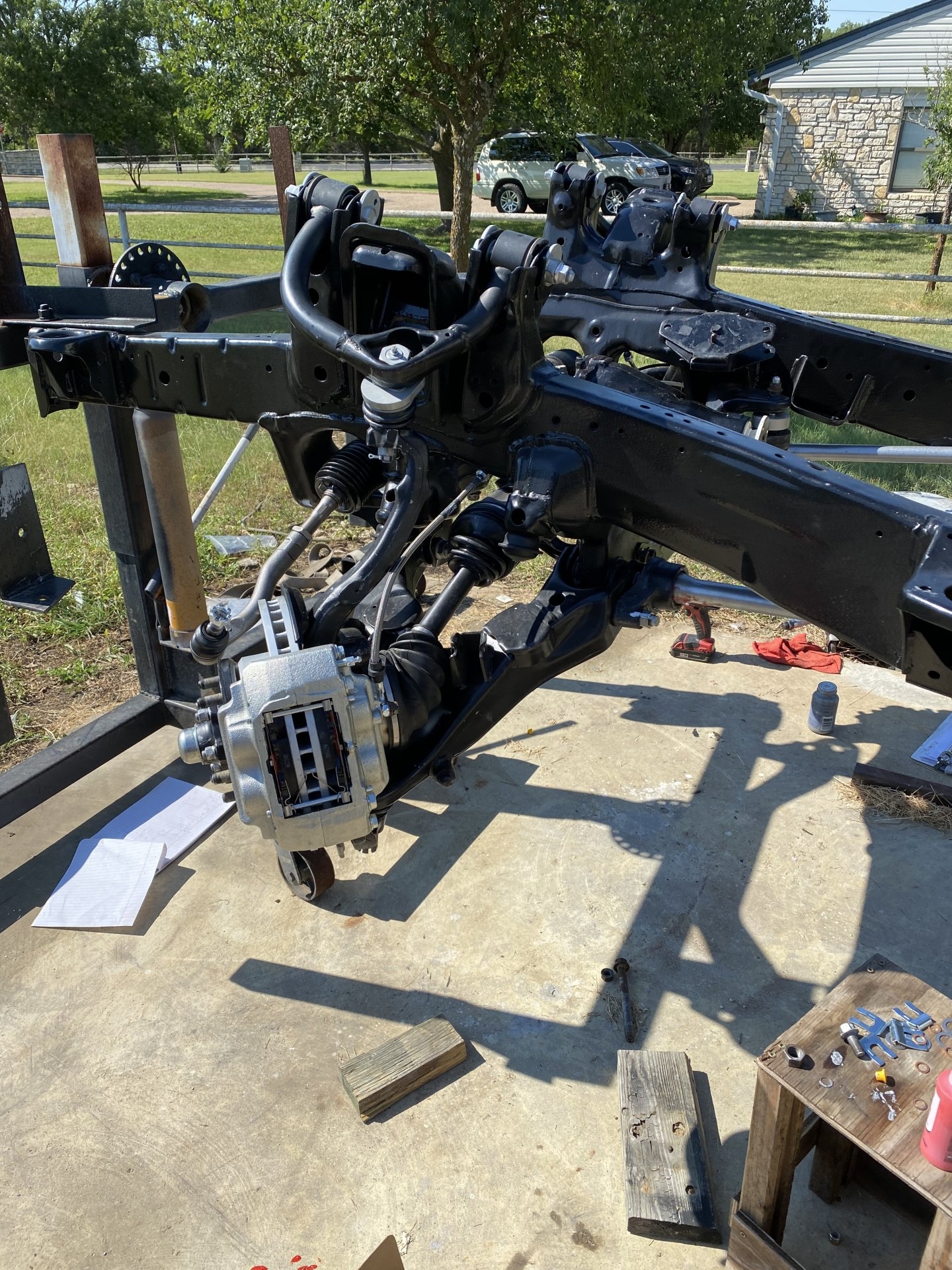

1998 TLC UZJ100 frame off resto build log

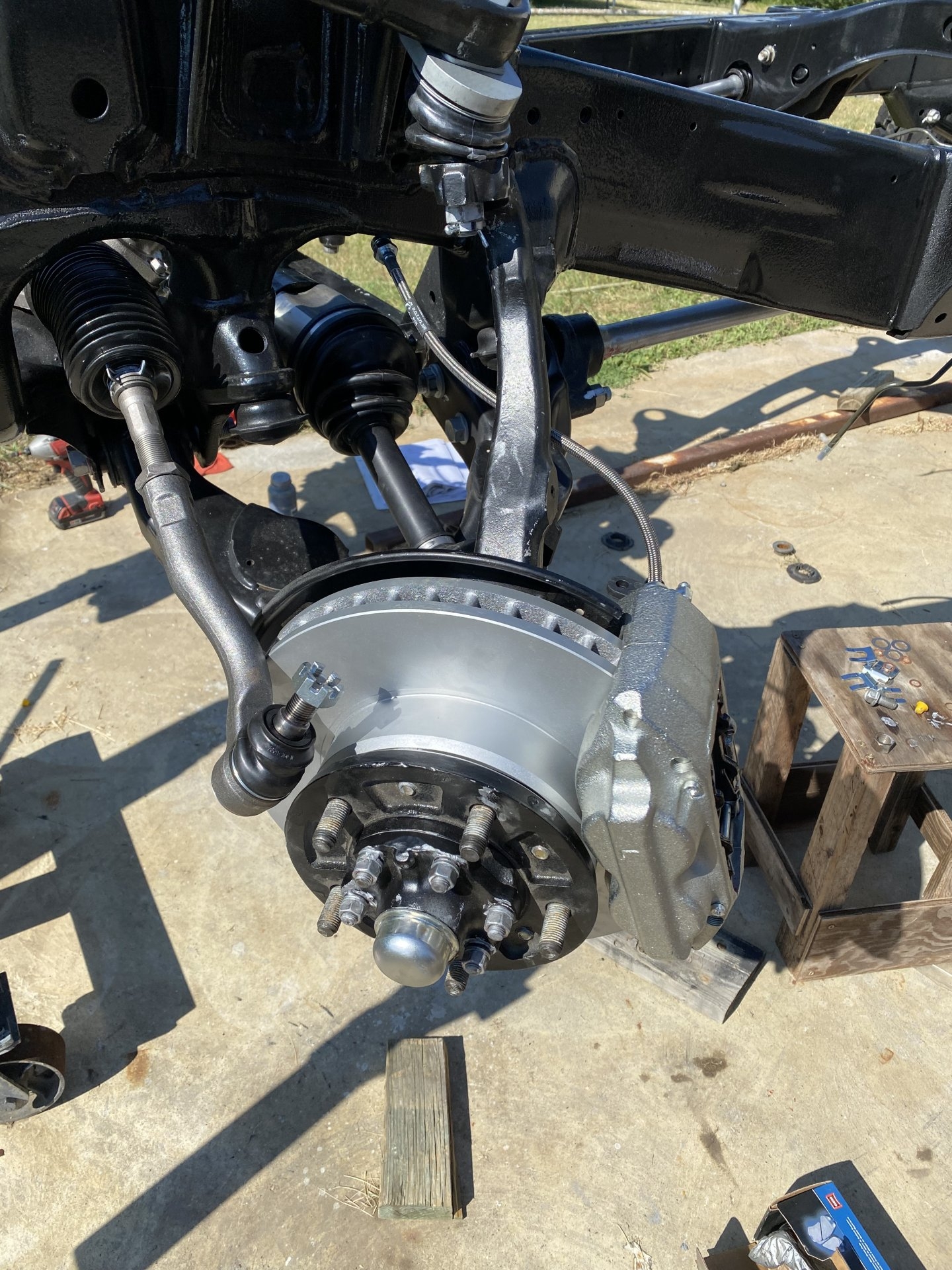

New front and rear calipers and stainless steel braided break lines. New fuel lines and brake lines arrived last week.
Any suggestions to the shocks with remote reservoirs. Slee, Icon, King, etc? My first choice was Slee but there are some availability problems last we checked.

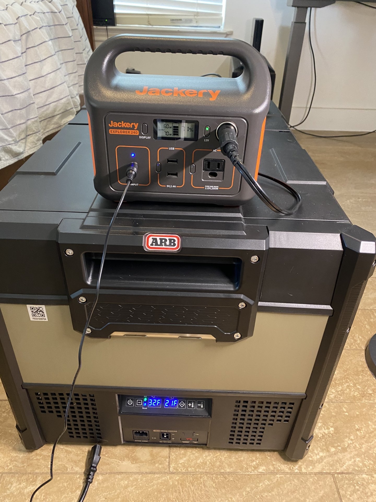

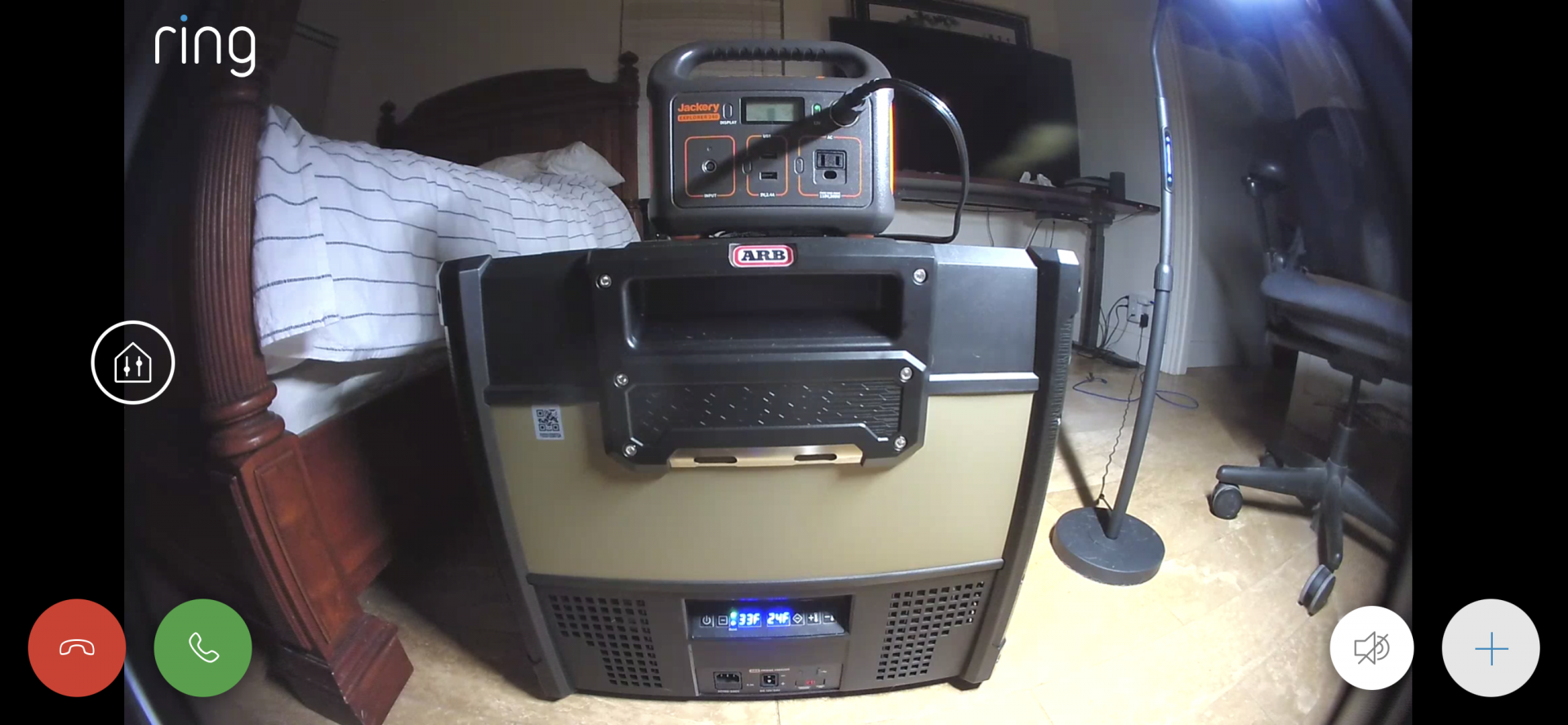

Decided to run a battery life test of the Jackery 240 as backup power for the ARB Zero 101qt dual zone DC fridge. The Jackery supports pass-through charging meaning that I can charge the Jackery while also powering the Zero at the same time. That was I can leave it connected all the time.
Jackery Portable Power Station Explorer 240, 240Wh Backup Lithium Battery, 110V/200W Pure Sine Wave AC Outlet:​
TECHNICAL DETAILS​
Capacity240Wh(16.8Ah/14.4V)
BatteryLithium-ion Battery
AC Output110V~ 60Hz, 16.4A, 200W (400W Peak)
USB-A Output2 x 5V-2.4A
Car Output12V-10A
DC Input12V-3.5A
Weight6.6lbs
Dimensions9.1 x 5.2 x 7.9in
Operating Temperature14-104°F (-10-40℃)
Recharging Temperature
Test parameters:
a. I brought the temps down to 33F (Fridge) and 24F (Freezer) using AC power to simulate my wife’s Lexus RX450h initially cooling the unit and contents while driving. The. The Jackery would only need to run when we are parked.
b. I’m using the 12V outlet to feed the Zero.
c. The Zero is empty
d. We are going to use my wife’s smaller SUV for this trip as the ‘99 LC isn’t ready yet. It’s also a hybrid which is nice for power anywhere.
e. Installed a Ring camera with time stamps so that I can see when the temp led lights go out on the Zero.
f. The Jackery was fully charged for 24hrs once received here. LEd displays shows 100% charge before the test.
g. I’ve intentionally set the worst case scenario in temperatures to force thenZero to draw maximum current draw.
manufacturer claims:
a. ARB Zero claims it runs on just 0.8 @12V (9.6 Watt)
b. Jackery claims that the unit has 240 watts and 16.8Ah@14.4V
Theoretical calculations:
16.8Ah/0.8A = 21 hrs of power to run the Zero
Test results:
3.5hrs used 26%
4.5hrs used 35%
Update: >12hrs before Zero shut off due to Jackery being depleted.
I’ll update this as I know more but right now 21hrs doesn’t seem to be anywhere in the ballpark of their claims. Perhaps it is the ARB that draws double the power at the temps I put it at. I need to measure the current draw with my fluke.

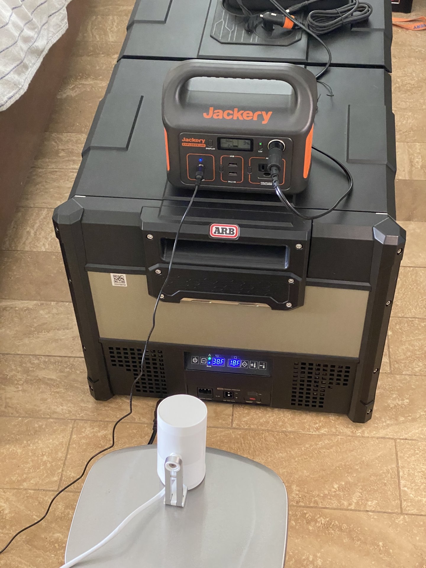

Here is a photo of my setup:

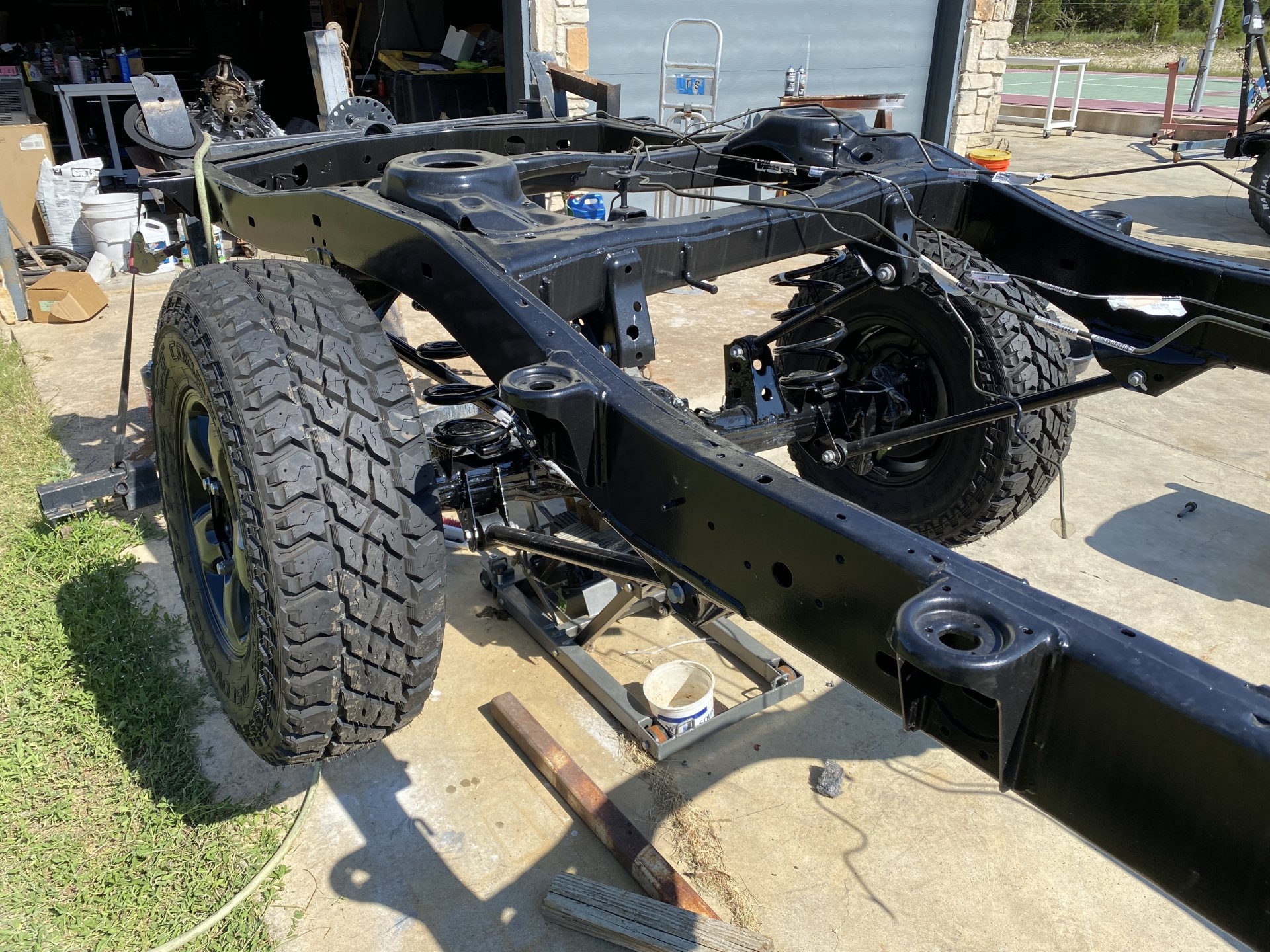

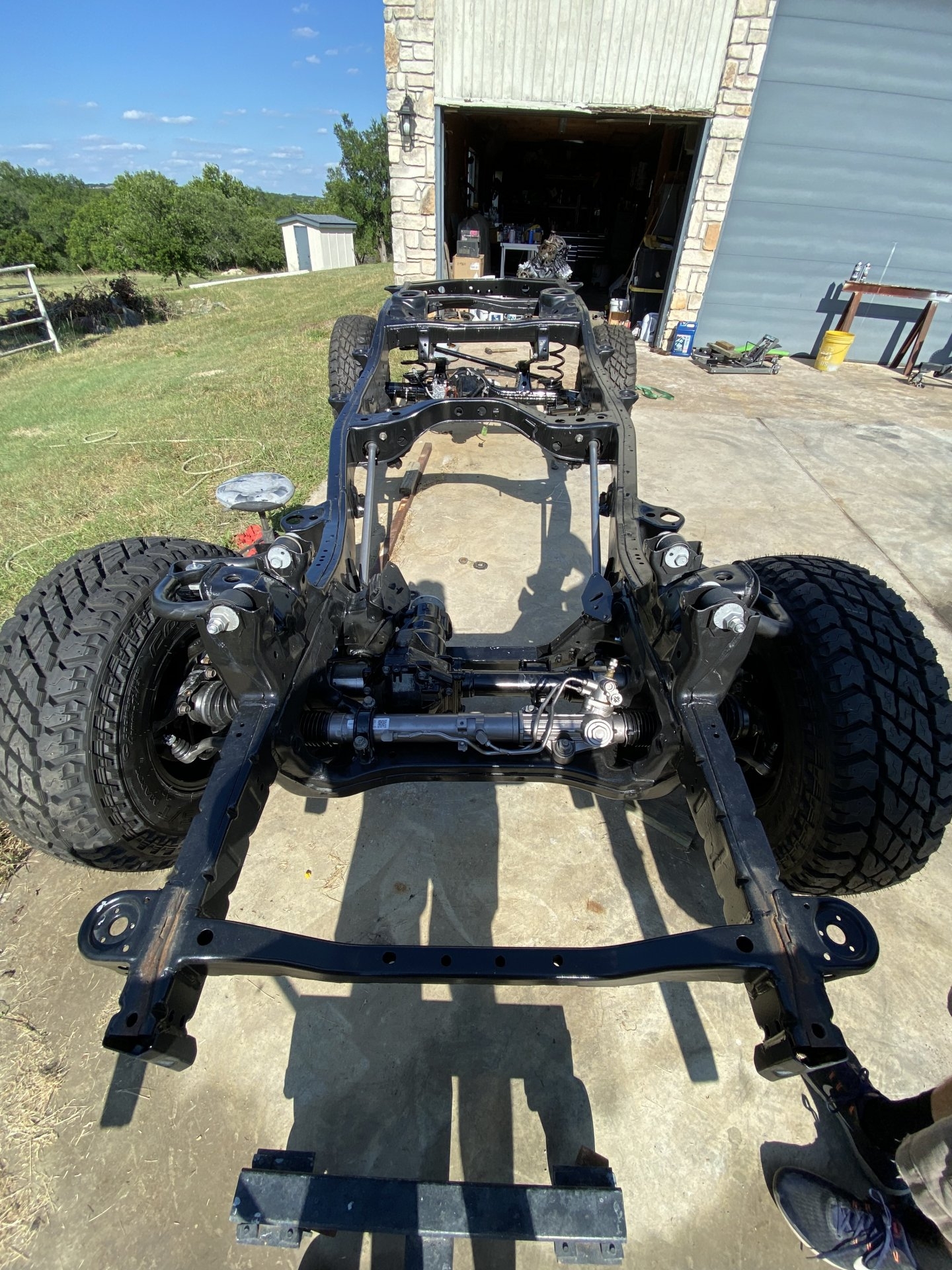

We now have a roller!!!
It’s sitting on its own finally. Time to clean and organize the shop.
Impressive work so far!
(You seem to have a whole lot more patience than I do. Not quite 4 years into the project, and you've got a rolling chassis, but it should be like a new vehicle when you're done.)
Ha! You set up a ring camera to monitor your fridge. That's pure dedication.

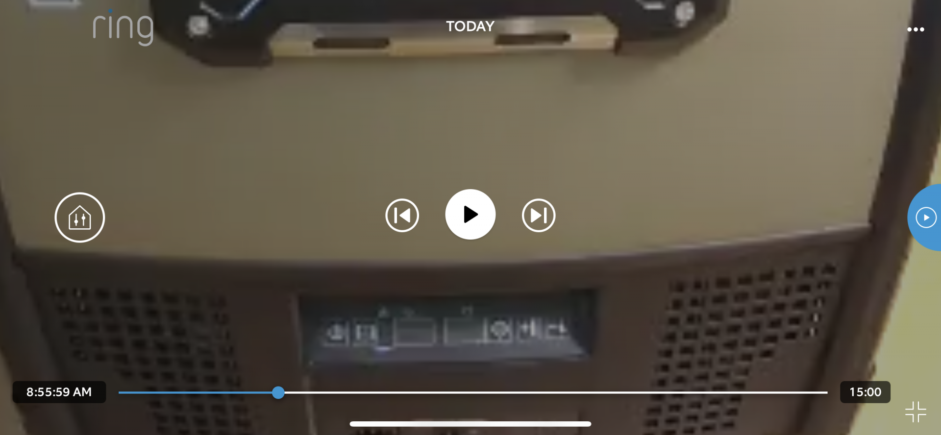

Ok I updated the Jackery 240 and ARB Zero power consumption post above. They are legit. We got just a out 12hrs of use before the Jackery was depleted.
The Zero shut off somewhere between 8:49am and 8:55am. I started the test at 8:27pm
Ok I updated the Jackery 240 and ARB Zero power consumption. They are legit. We got just a out 12hrs of use before the Jackery was depleted.
With this figure in mind it looks like the ARB draws nearly twice the rated 0.8A.
Here could be some reasons for the discrepancy:
1. ARB made their tests in a cooler environment than mine. Our house is at 73F always.
2. ARB had milder temperatures during their test. I set my Zero to 33F for the fridge side and 24F for the freezer.
3. maybe the Jackery has less amp hour capacity than it’s rating. To be clear, the Jackery website isn’t clear about the conditions for the posted battery capacity. There may also be inefficient inverters that are scavenging heat too.
Now that the Jackery power consumption test is completed I wanted to test how long the AC power supply to the Jackery could charge up the Jackery while stilll maintaining the test temperatures during the power consumption test. BTW the Jackery AC power supply output 12V DC to charge the Jackery. This emulates the system being installed in a vehicle powered by a 12V outlet. Jackery calls the ability charge and power accessories “pass-through mode”.
Parameters of the test:
a. The Zero had a starting temperature of 38F/18F.
b. the Jackery 240 was depleted from the prior power consumption test
c. I plugged it into the Zero at 10:44am.
47% charge was achieved at 2:03p (3hrs 19m)
71% charge at 4pm (5hrs 16m)
88% charge at 5:11p (6hrs 27m)
95% charge at 5:31p (6hrs 47m)
That puts us around 7 hrs for a full charge while also powering the Zero.
A thermal blanket would make the Zero more insulated and efficient.
Hope these little tests help
