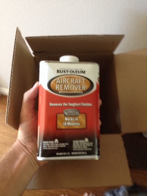

Someone told me to soak a rag in brake fluid and lay it on the bedliner.
I never tried it, but may work.
Guinea Pig????
