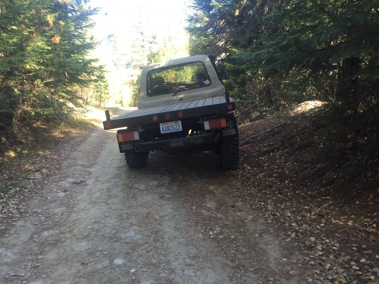

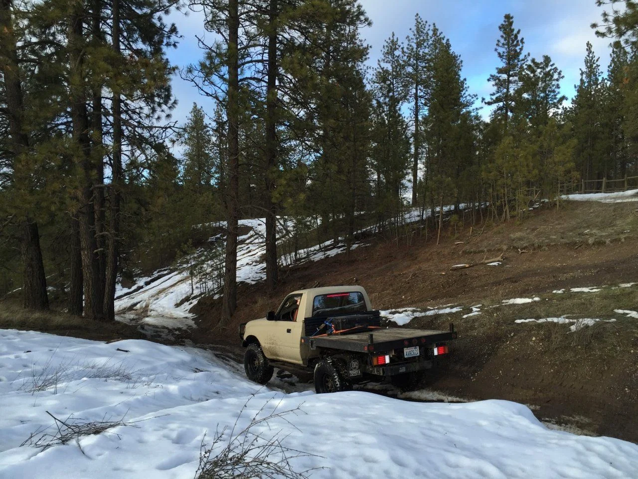

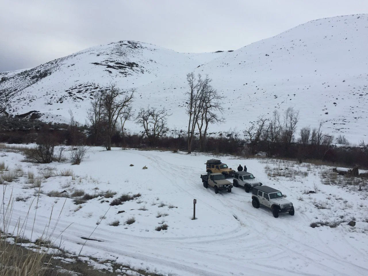

I spent a long day yesterday on the road and trail near Douglas Creek in WA with some folks from NW Overland... it turned out to be me with 8 Jeeps! Luckily a guy in a 100 series showed up. I got a few "confused Toyota" comments, but it's all good...
This was my first long range shakedown trip in the ute and I was very happy. I love just throwing some stuff in the bed and going.

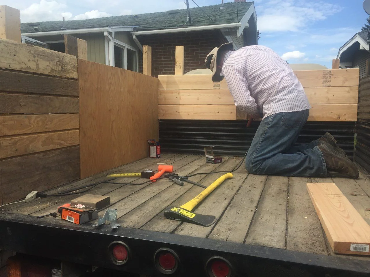

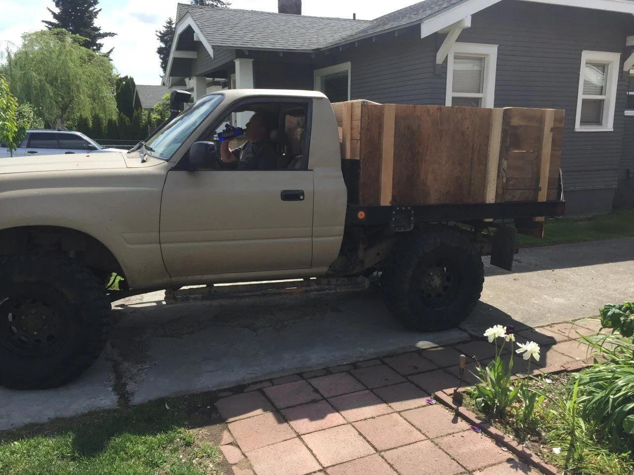

Remember when @NCFJ told me to keep the higher bed sides??
Welp--I should have listened!

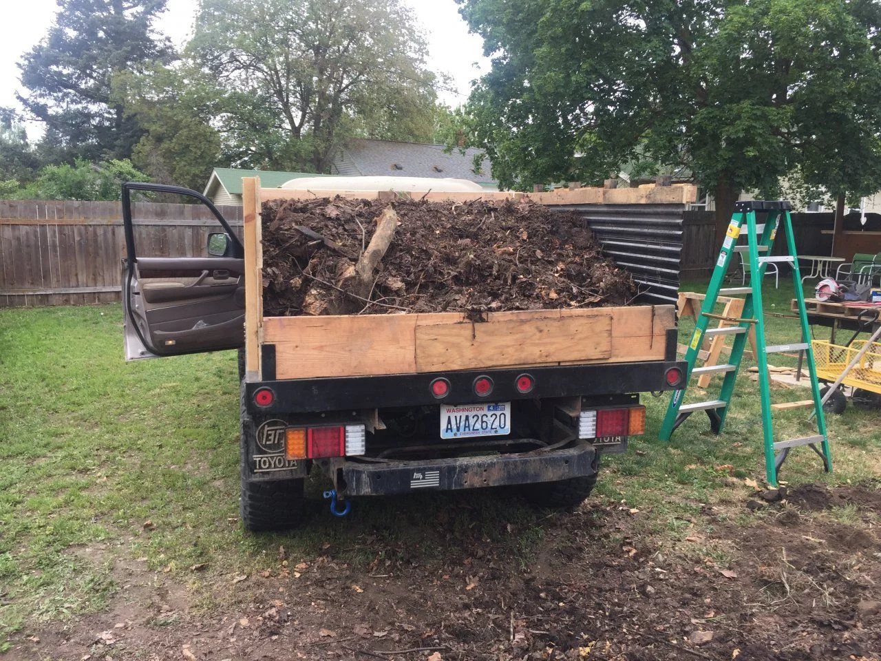

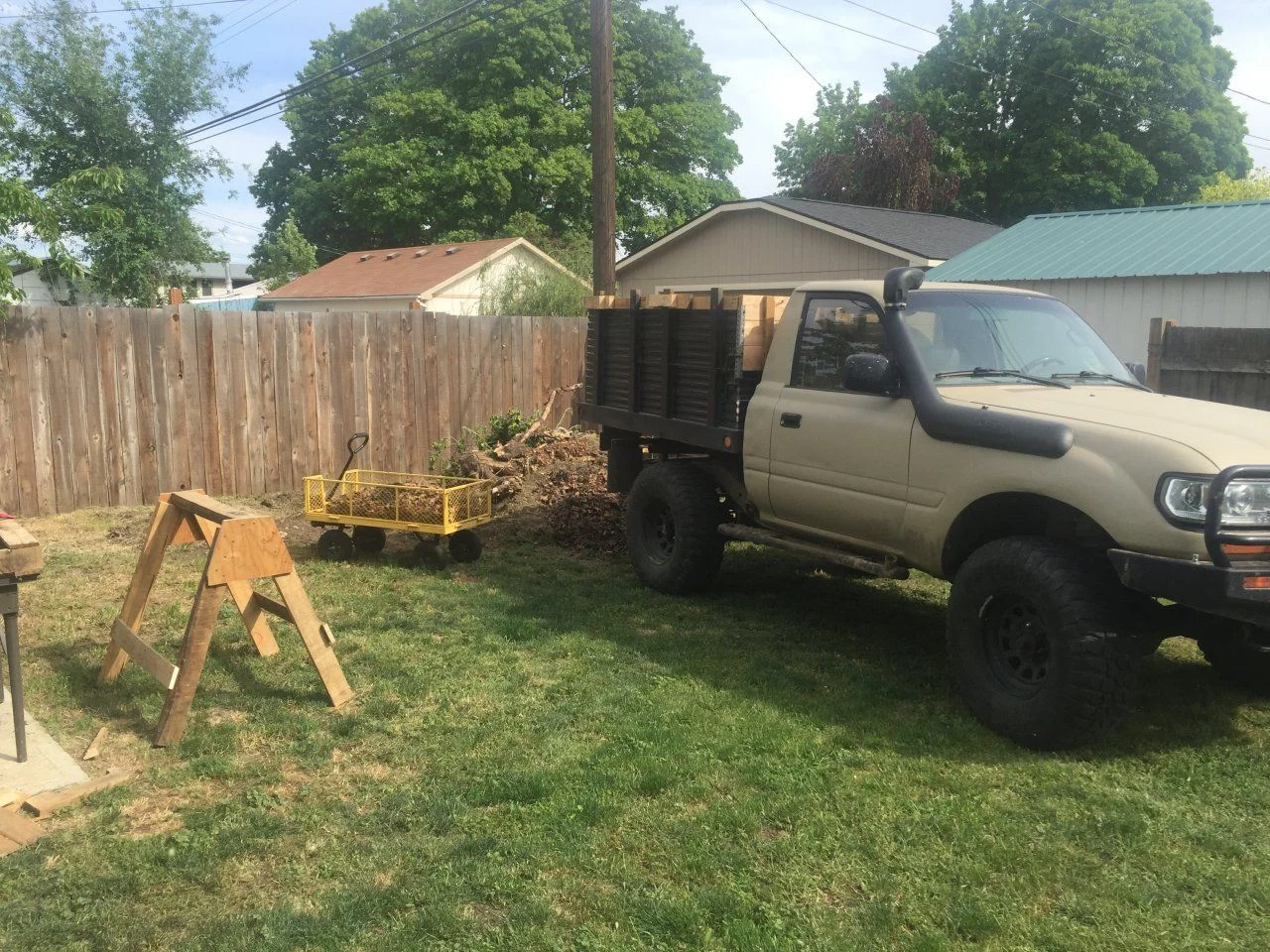

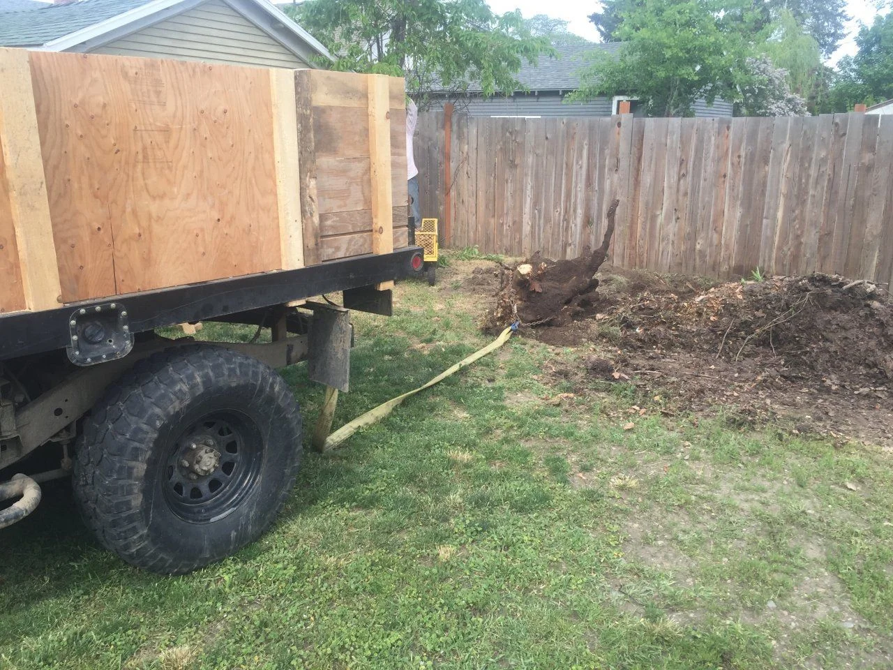

My father came to town for my graduation and we threw some redneck sides together out of scrap for a dump run. We ended up hauling 2600lbs (in two loads) of yard waste and debris, including a stump we pulled.
She had her sag on! We weighed in at 7300lbs on the second run.
And, I love having a ute.

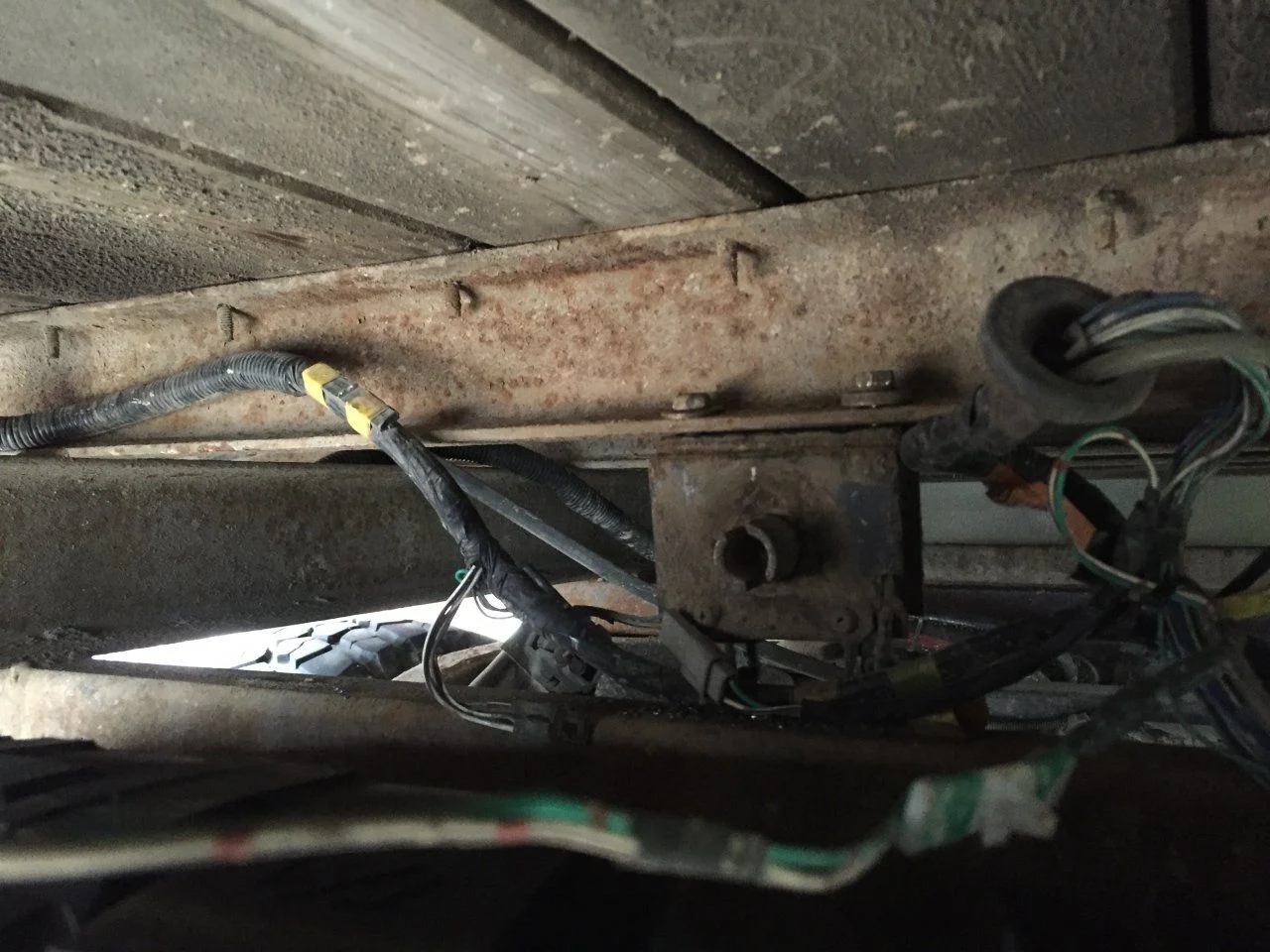

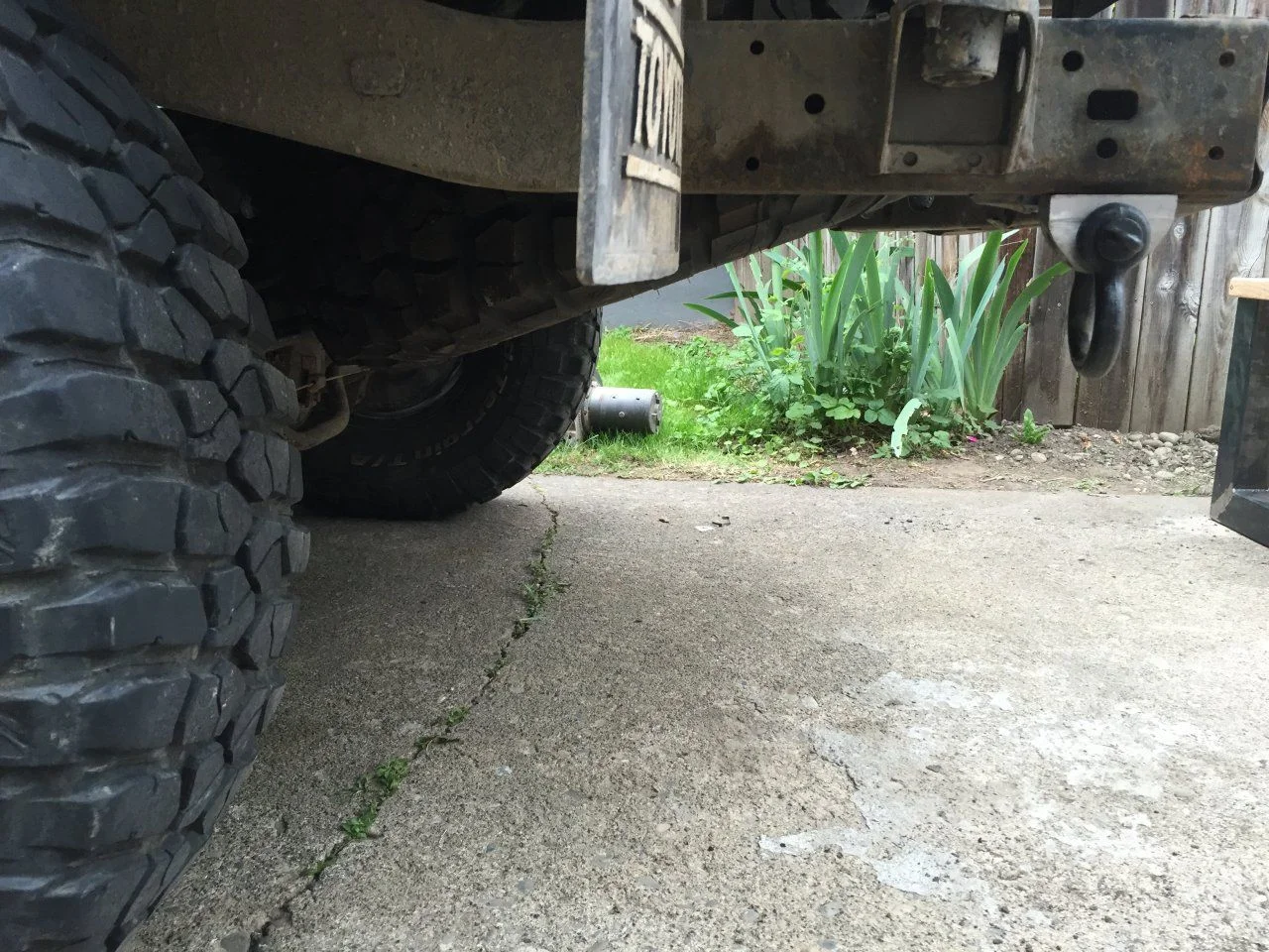

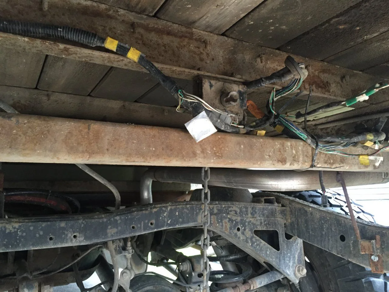

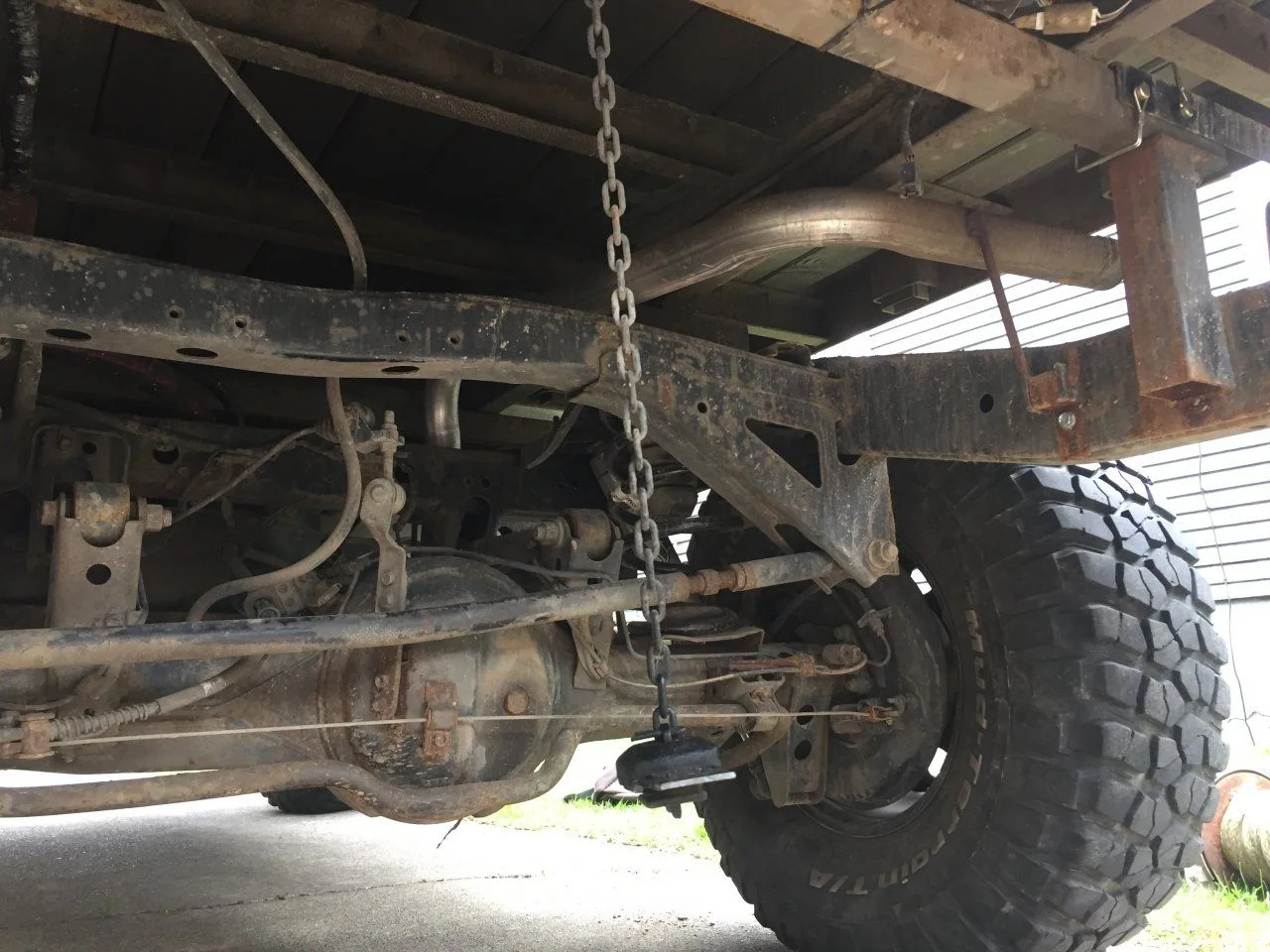

Finally found some time to relocate my tail lights! I cut off the old mounting brackets, drilled some holes in a C-channel crossmember under the bed and voila!
Before:
And, now:
It cleaned the rear up nicely and set the stage for a little more protection later on.

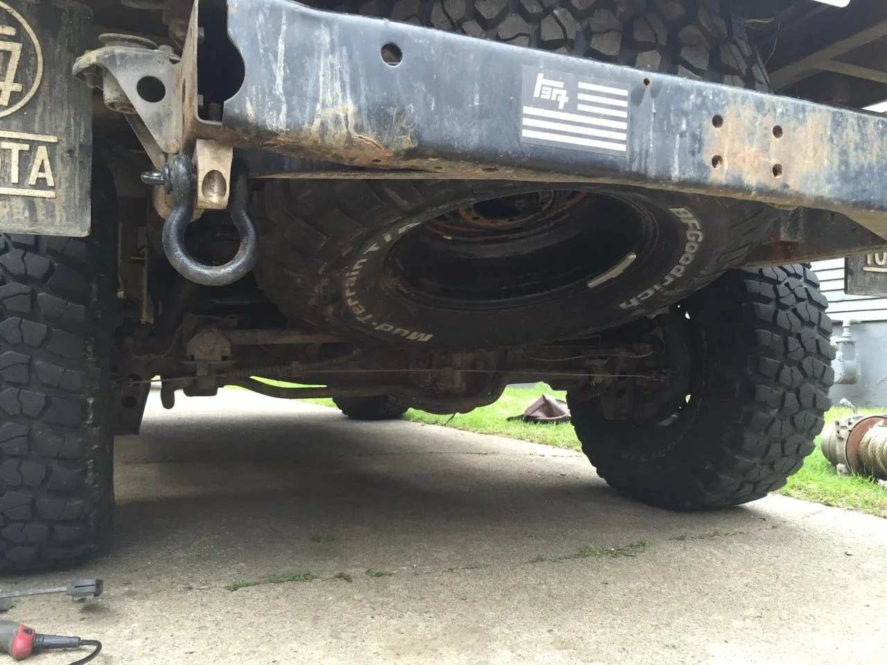

As you can see, the spare tire came out for the next project!

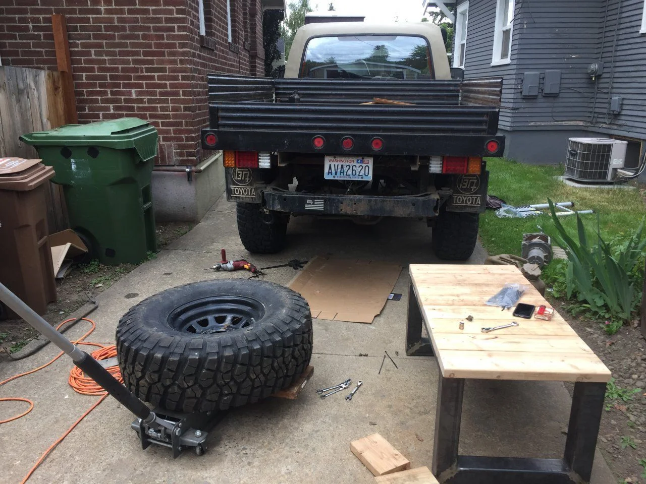

A buddy was in town and offered the spare tire lift off of his pickup, so we took a look at it. Two holes in another of the crossmembers on the flatbed to mount the lift and some flat bar burned onto the mechanism got me a smooth, functional tire lift:
The tire is snugged up nicely and clears everything underneath. I may look into some additional support eventually but need to get a few miles on the setup to make sure all is well.

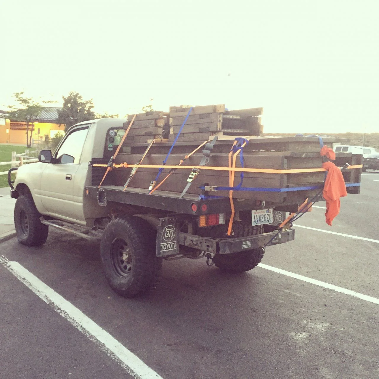

Thanks! The rig was a major part of getting our custom farm tables across WA state and up to the top of a mountain for our wedding last month!
The departure angle could be way better but I opted to keep the frame intact (it could be chopped all the way up to the rear axle) but it's damn good with the lift springs, 315's, and the fact that the flatbed doesn't stick out over the rear crossmember very far at all (and it's a ways above the rear crossmember)
We also drove away from the ceremony in it!
