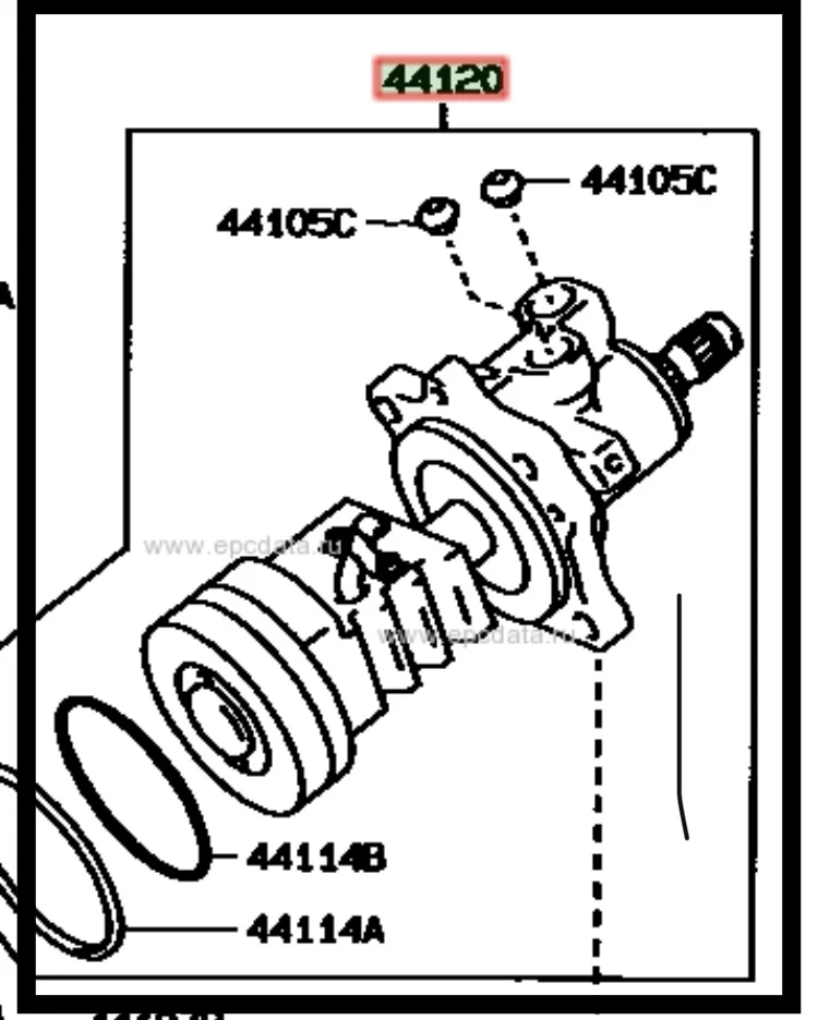

Hi,
Gearing was done on the axle,had to buy pinion and ring for that.
For the stearing I had to buy the valve assy 44120-60180 and yes the sloppiness is gone.

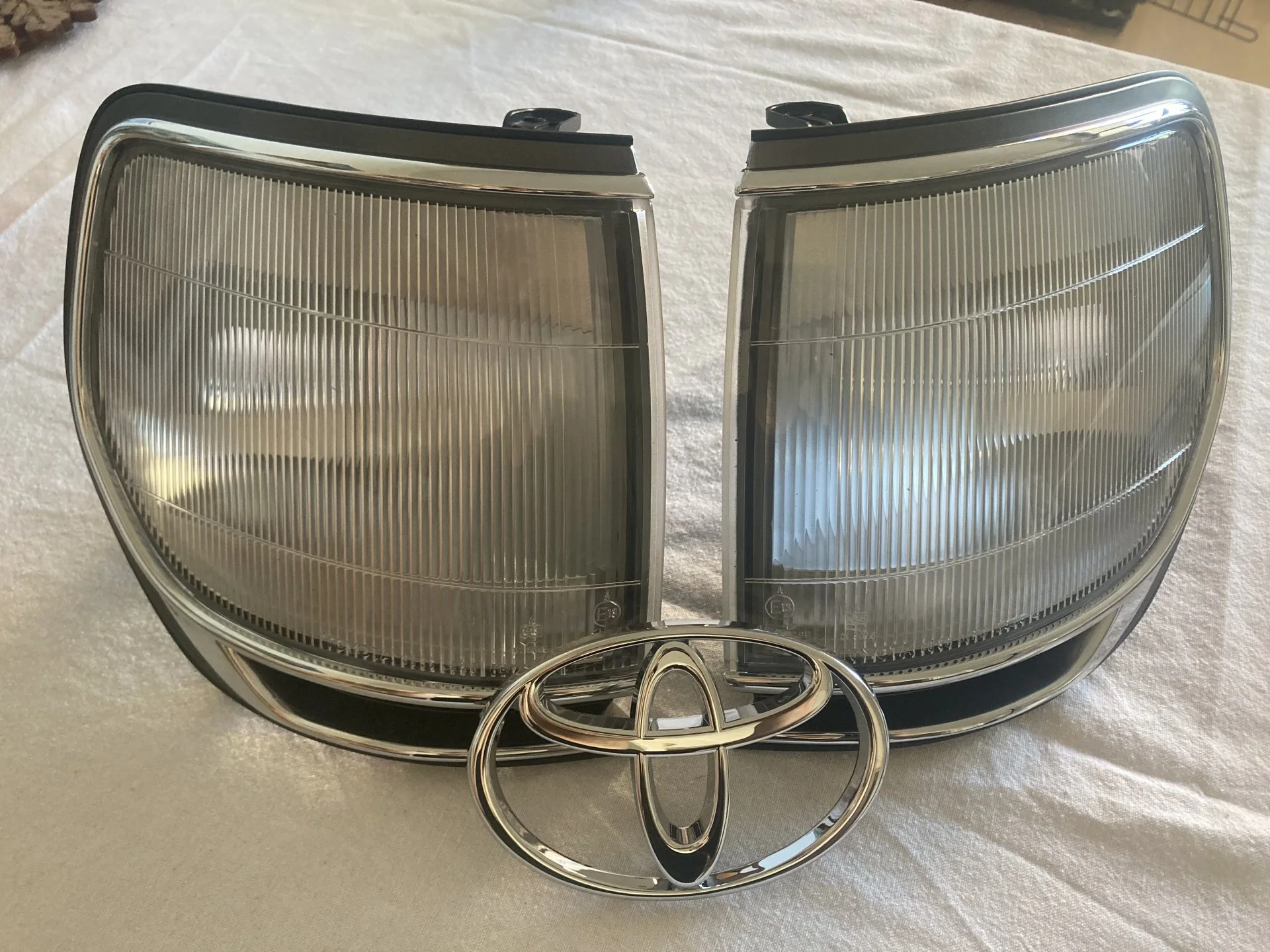

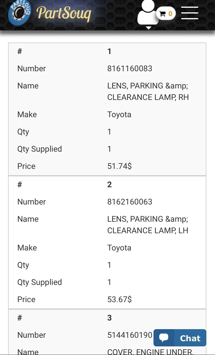

Ordered the OEM corner lights as PO did put some Chinese ones. Also Plasti dipped the grill so bought a new emblem for the grill.

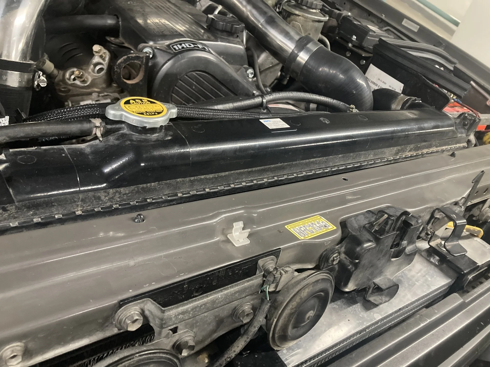

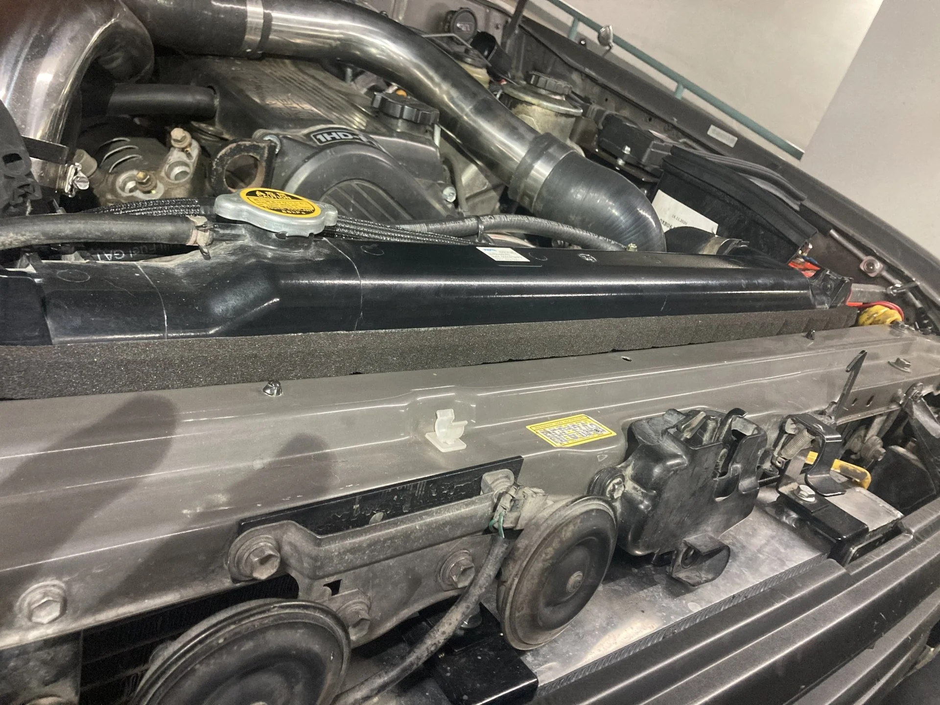

When I received the radiator back in 2015 I did know nothing about the cars, not sure what it was for I just ripped of the cushion on top. Well after six years I bought the cushion on the race car shop and put it back.

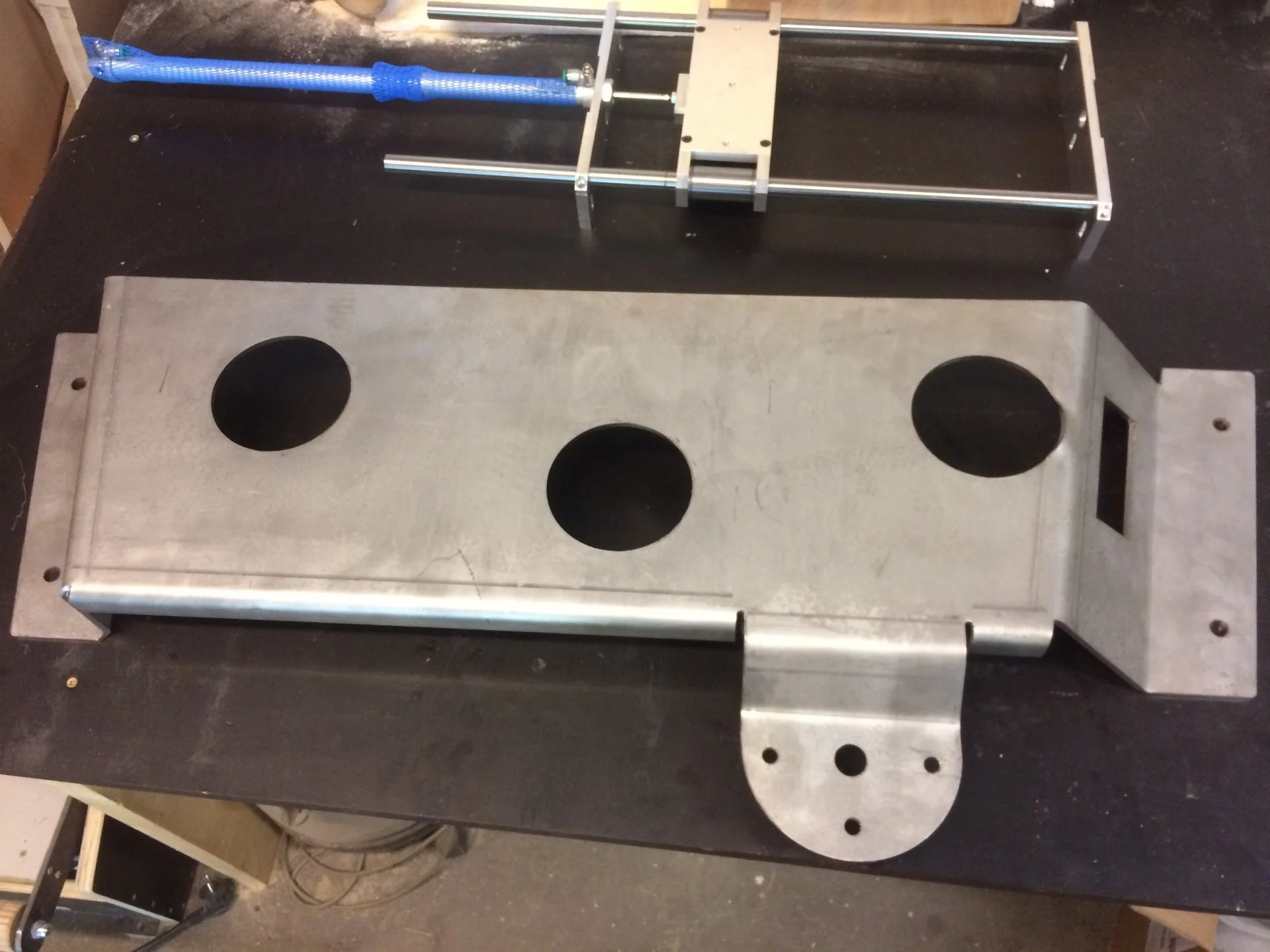

As I am a bit paranoid about what could mess up regarding the LRE tank, I had my friend come over and create the skid plate for the trans and LRE tank. If anybody wants to create the same for the LRE tank, send me PM and I will send the step file for that.
View attachment 2693085View attachment 2693086
I actually replaced mine recently with a 5/8 hose pushed between the radiator and core support.

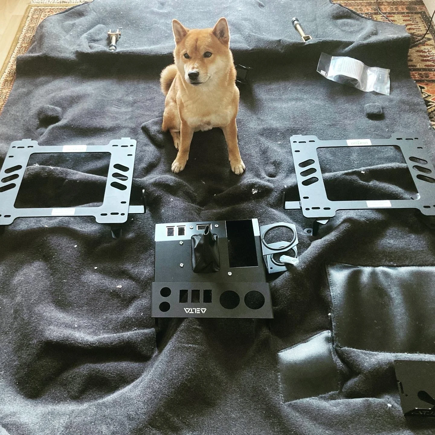

So received all goodies from the US ,waited for the shipped container for a while but it's worthy.
Planted seat brackets
Delta Panhard relocation bracket
Delta shifter console
Heavy duty swaybar links and other stuff

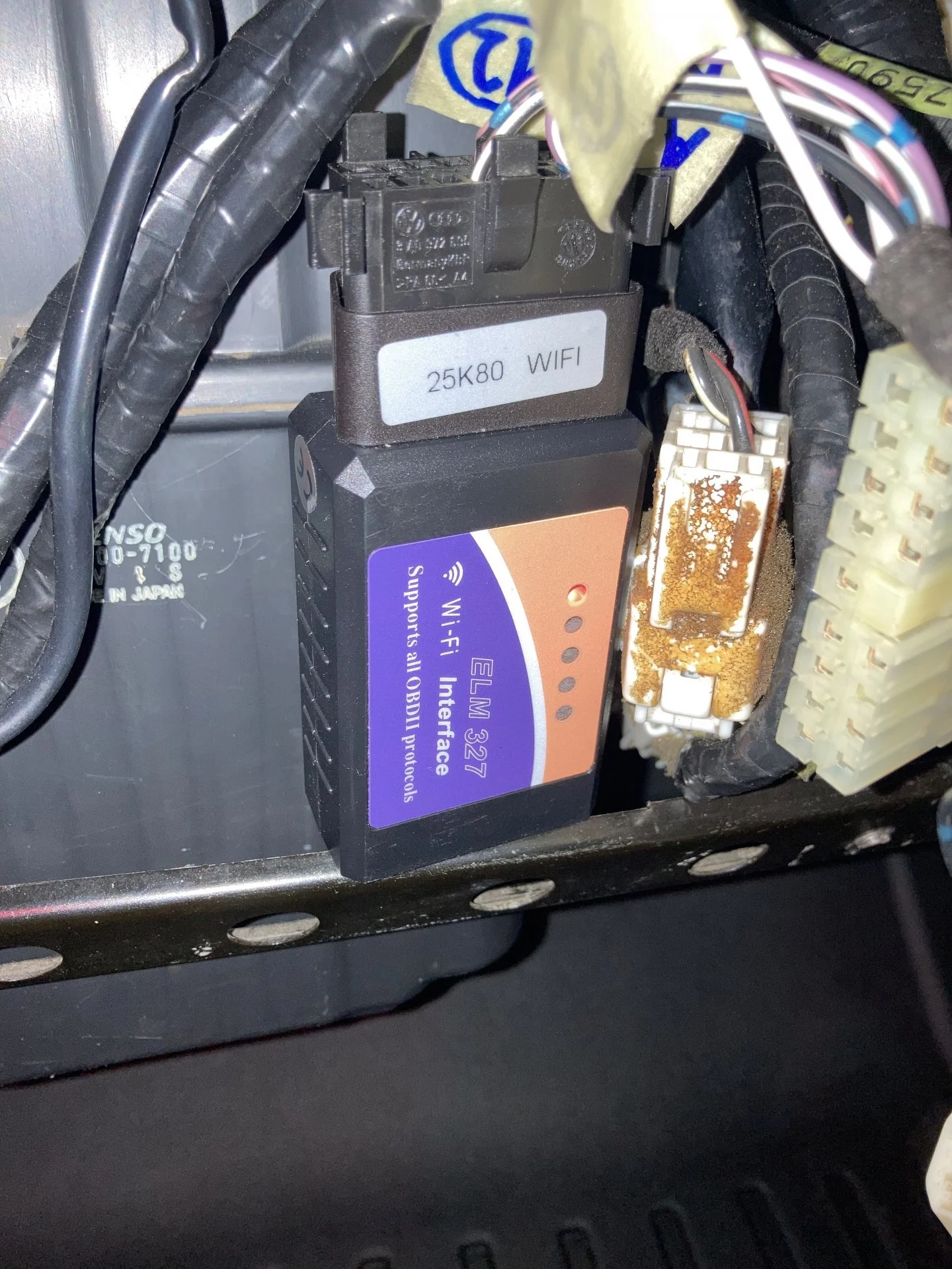

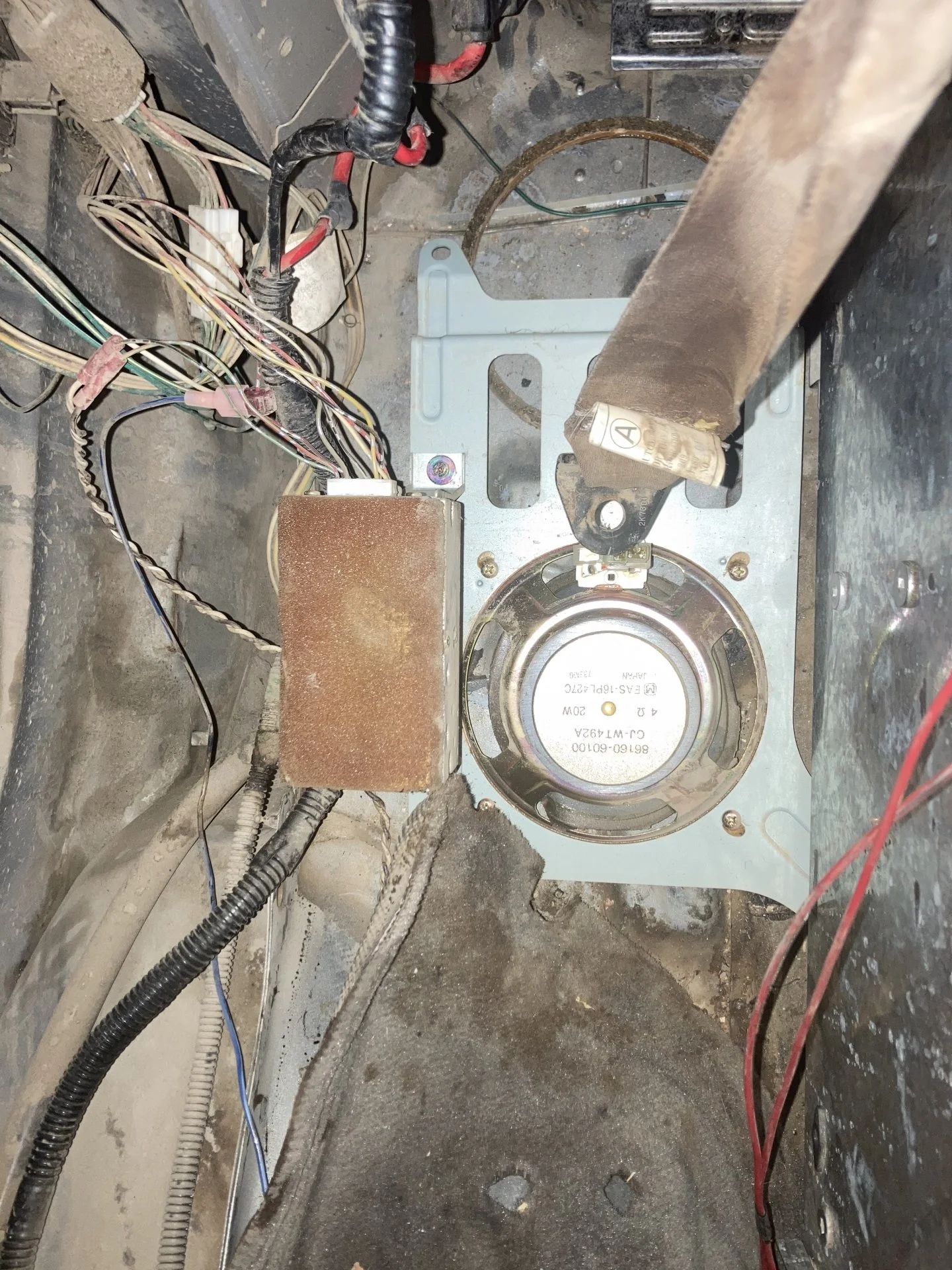

I have a question regarding the boxattached to the speaker,would it be ok to actually remove it as I want to get rid of the speaker at the back also
@Jorgito
That's the amplifier for the rear speaker. You should be able to unplug it and remove it and the bracket entirely with no issue. Looks like someone cut/disconnected and then spliced in a connection (twisted wires) to a new speaker at some point. I can't tell if the other speaker is still around but if you still want to run a speaker in that position you'll want to test/keep the amp. If you don't want a speaker in that area I'd just unplug the amp and remove the whole bracket and speaker(s).

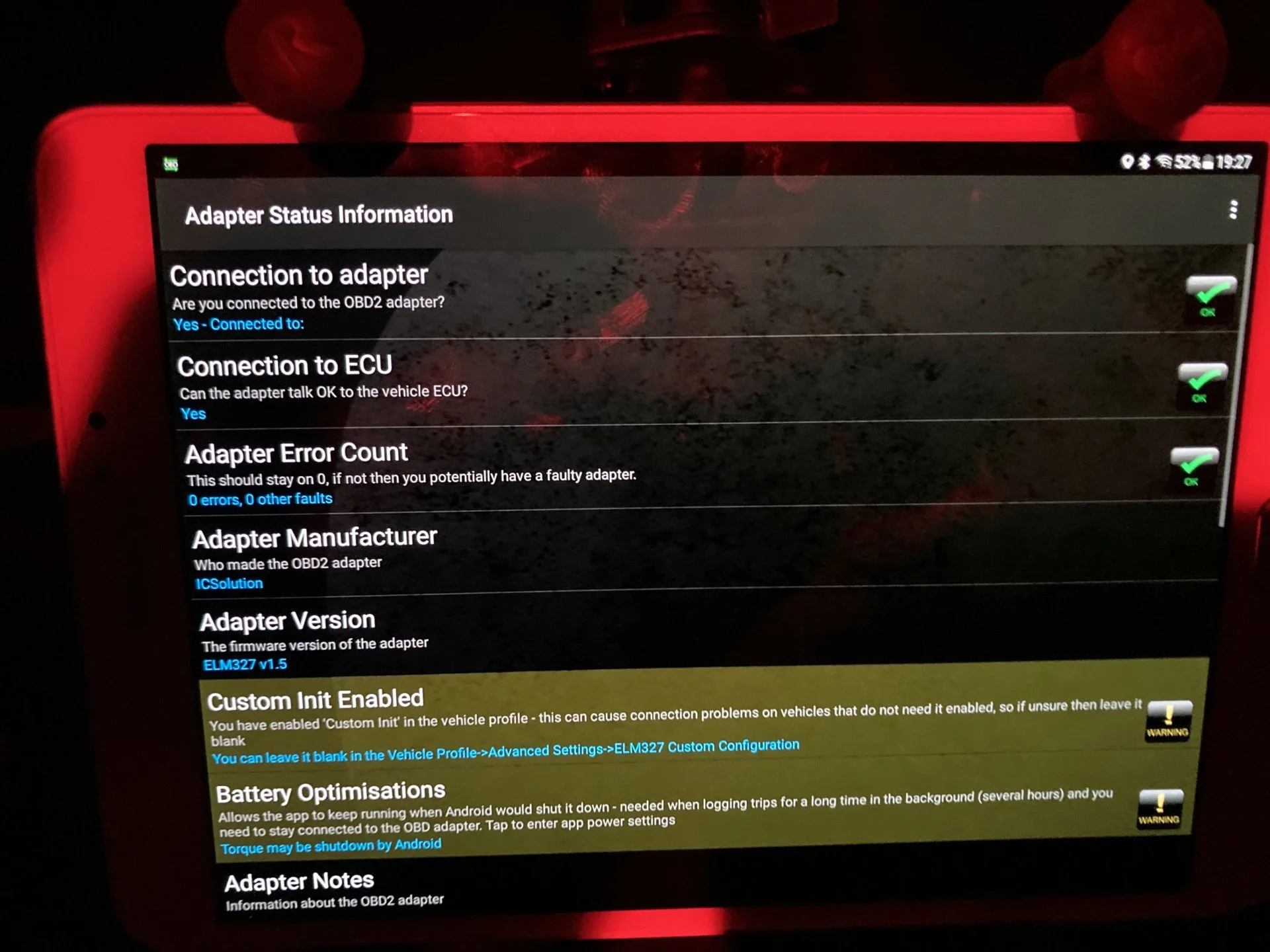

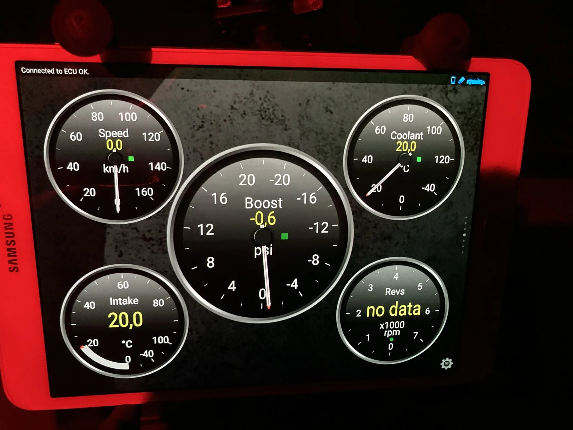

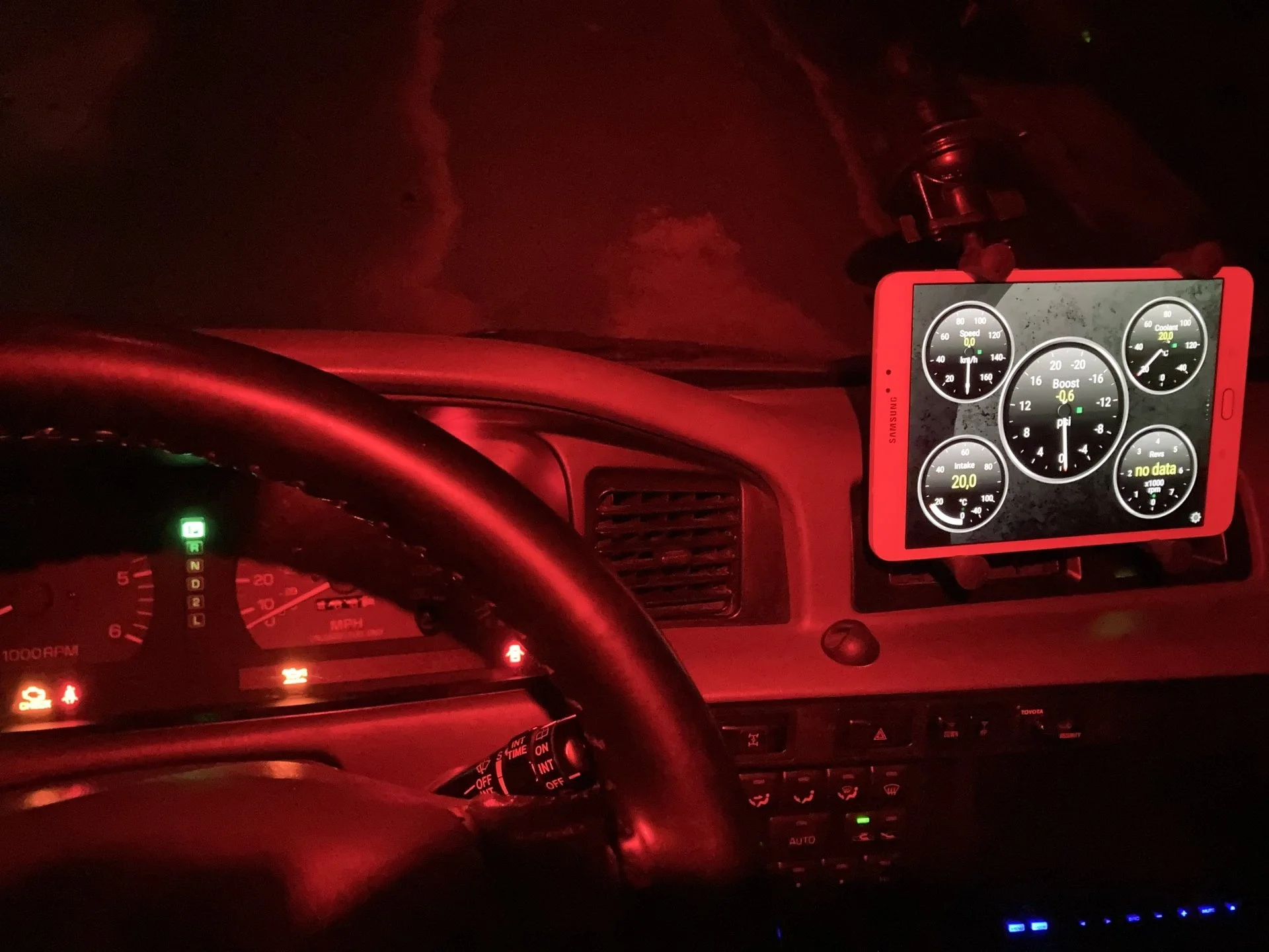

Removed the amplifier for the back speaker. Also had the ECU connected to the torque app and can finally check at least the coolant temperature.
