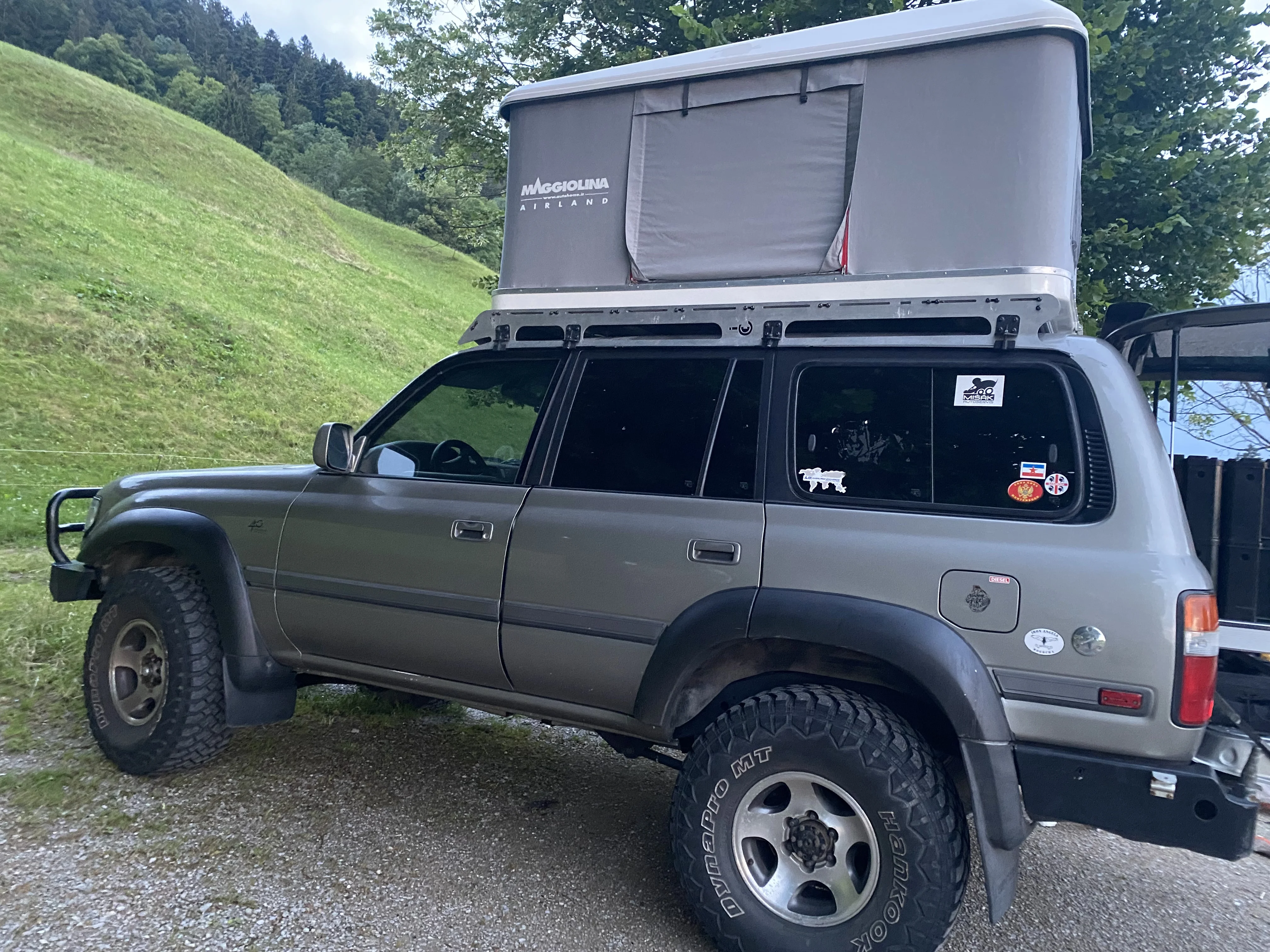

Finished the trip to Sardinia , no issues at all and all went smoothly. Check the sound of the 1hd-fte with 3 inch exhaust what a melody

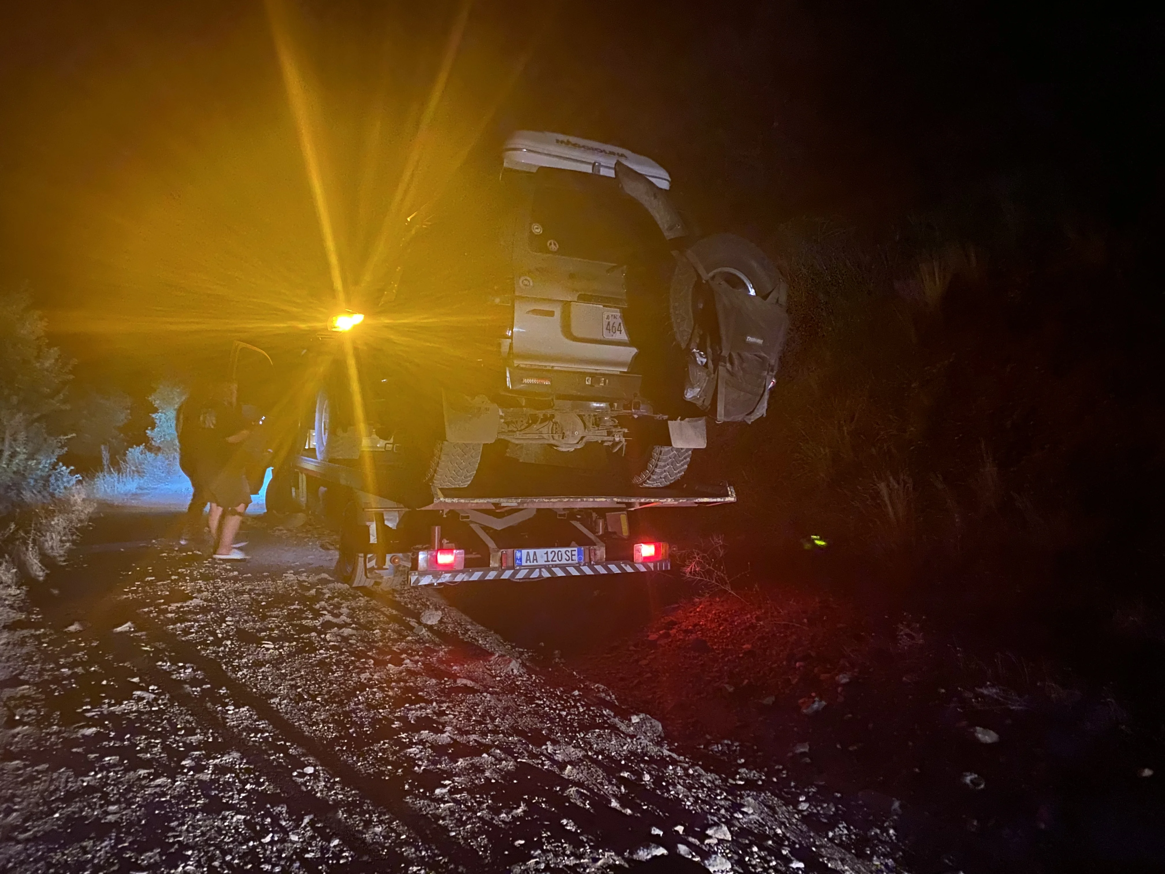

* The engine completely shut down on the descent from the Lura national park in Albania. We had to get towed to the nearest village, at the end it was only the fusible link

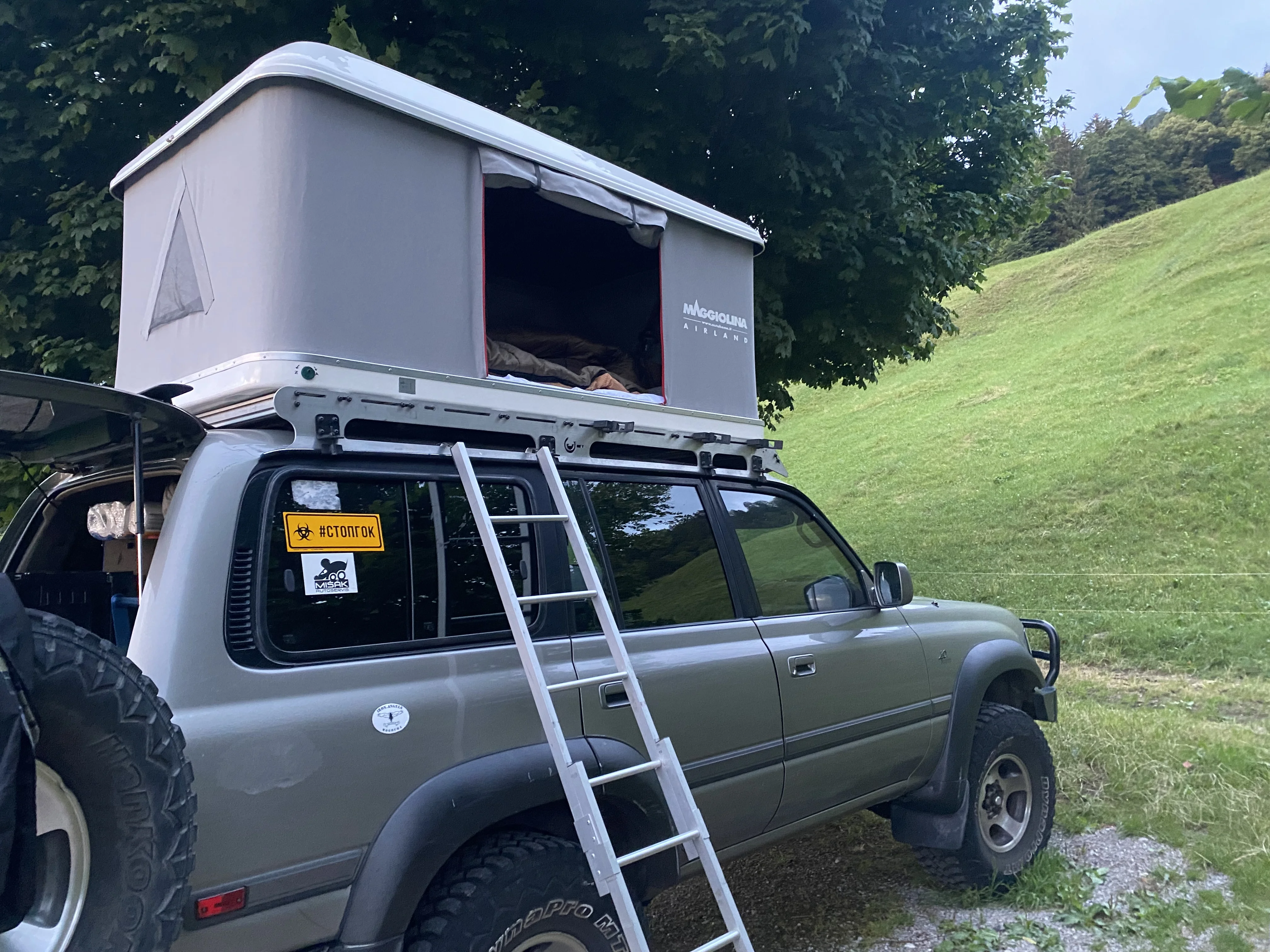

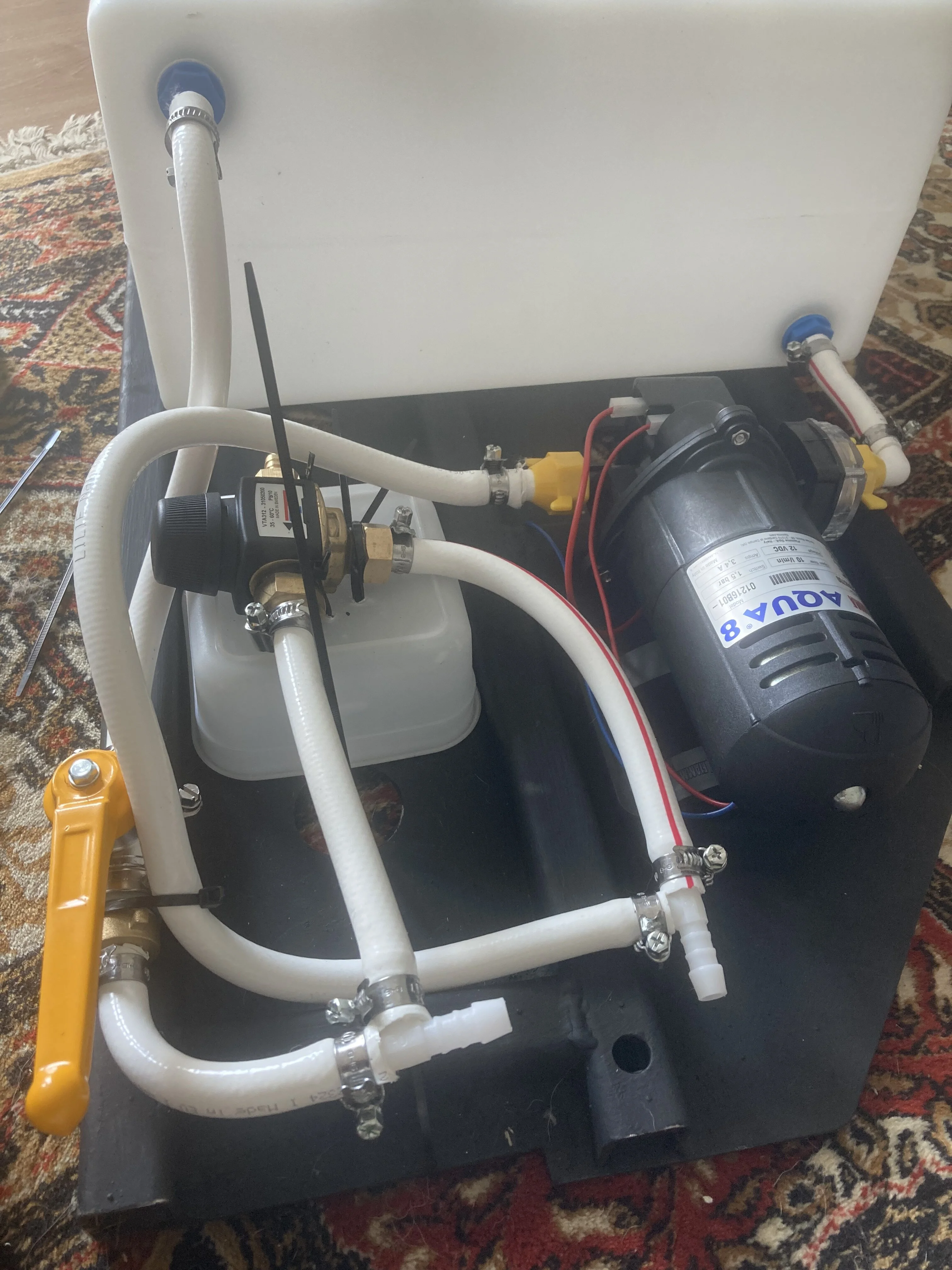

Updated a water system as old was lost :-( Just a couple notes here: • using helton heat exchanger which heats the water using the engine • the water pump output is having a tee where one ouput goes to the thermostat valve and the other goes to the helton heat exchanger - this is the cold water side • the hot water from the heat exchanger goes to the thermostat valve on the hot side • the mixed output from the thermostat goes ro the tee which has one ouptut to the ball valve. This rnables me to open the valve and jist circulaze the hot water back to the tank. The other output is the output to the shower head

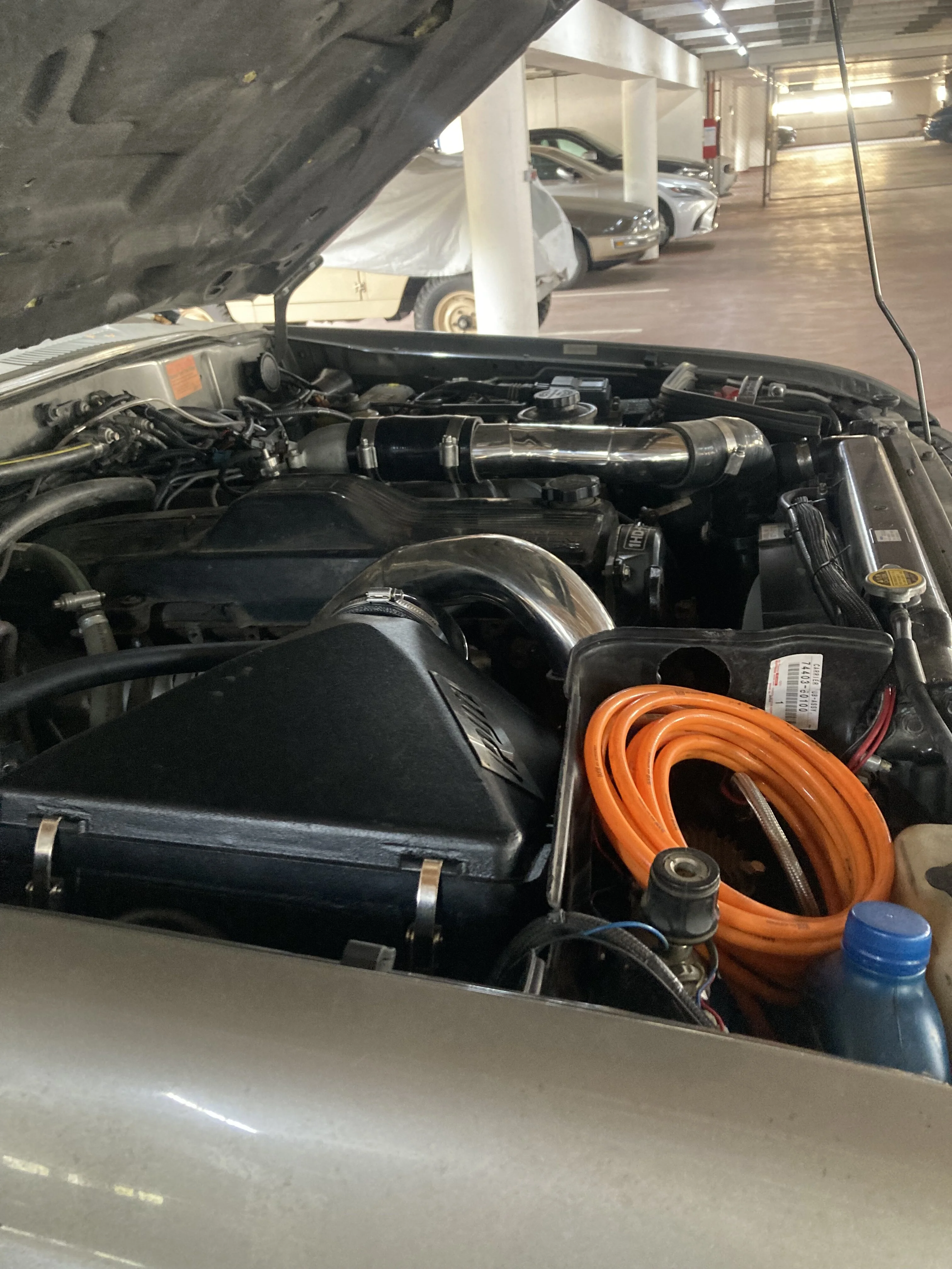

Installed PDI airbox together with the PDI cross over delete. I had to cut the fender a bit as the airbox inlet is too big. Next is the stainless snorkel.

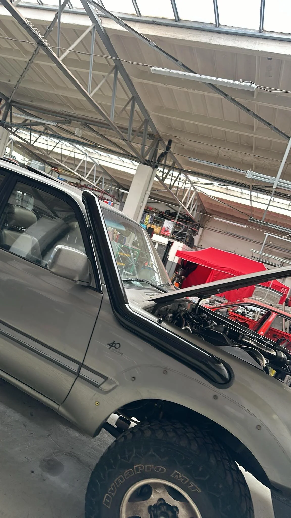

finally putting the snorkel, home made by my friend. This is 4'' snorkel.
The snorkel is painted and finished, looks amazing

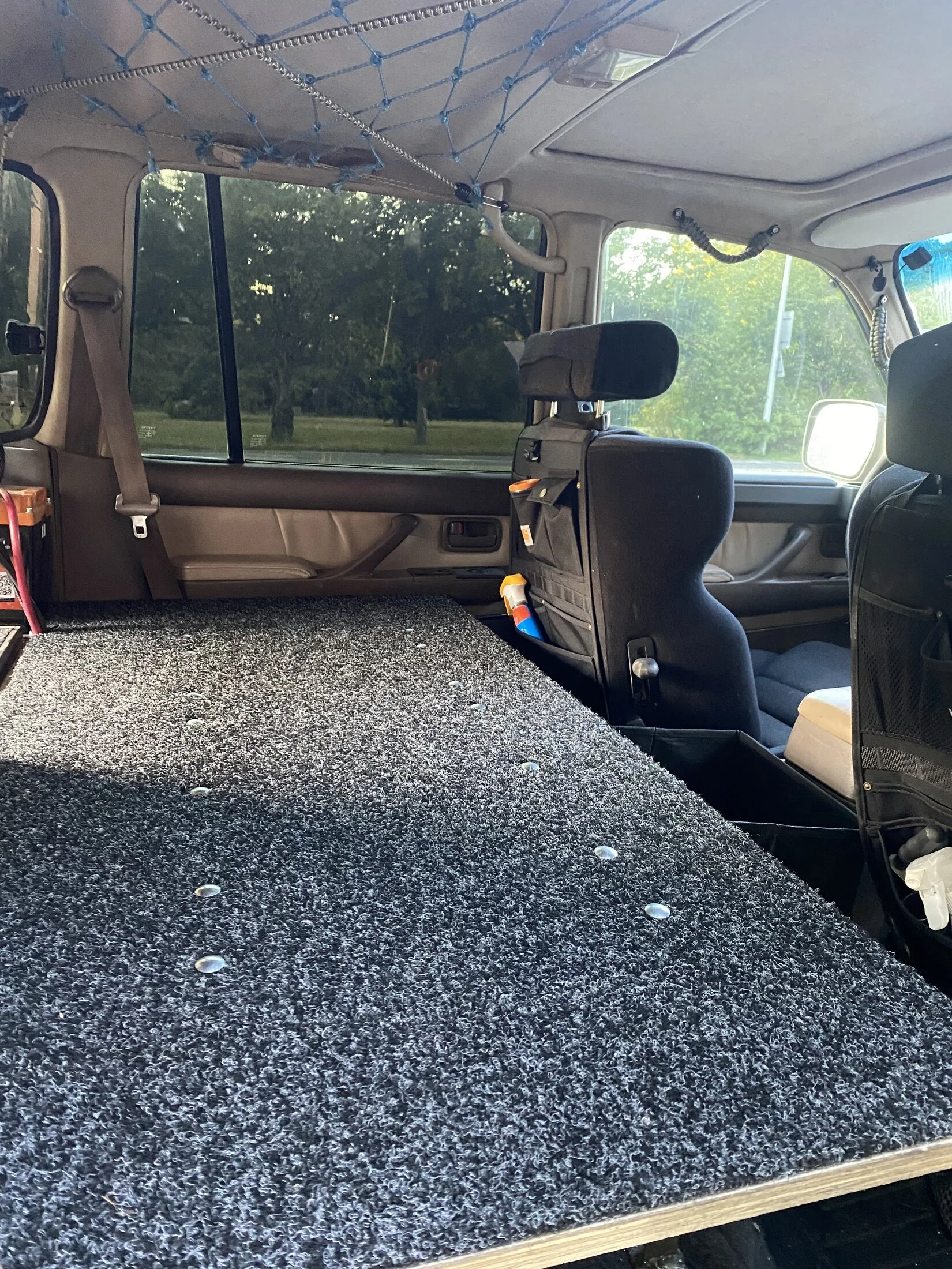

Finally got into installing the seats, feels much bettered than tired original ones. Also wired the unichip and man ehat a difference, all the issues with surging uphill are gone. Finally pushing 20 psi from the green wheel.

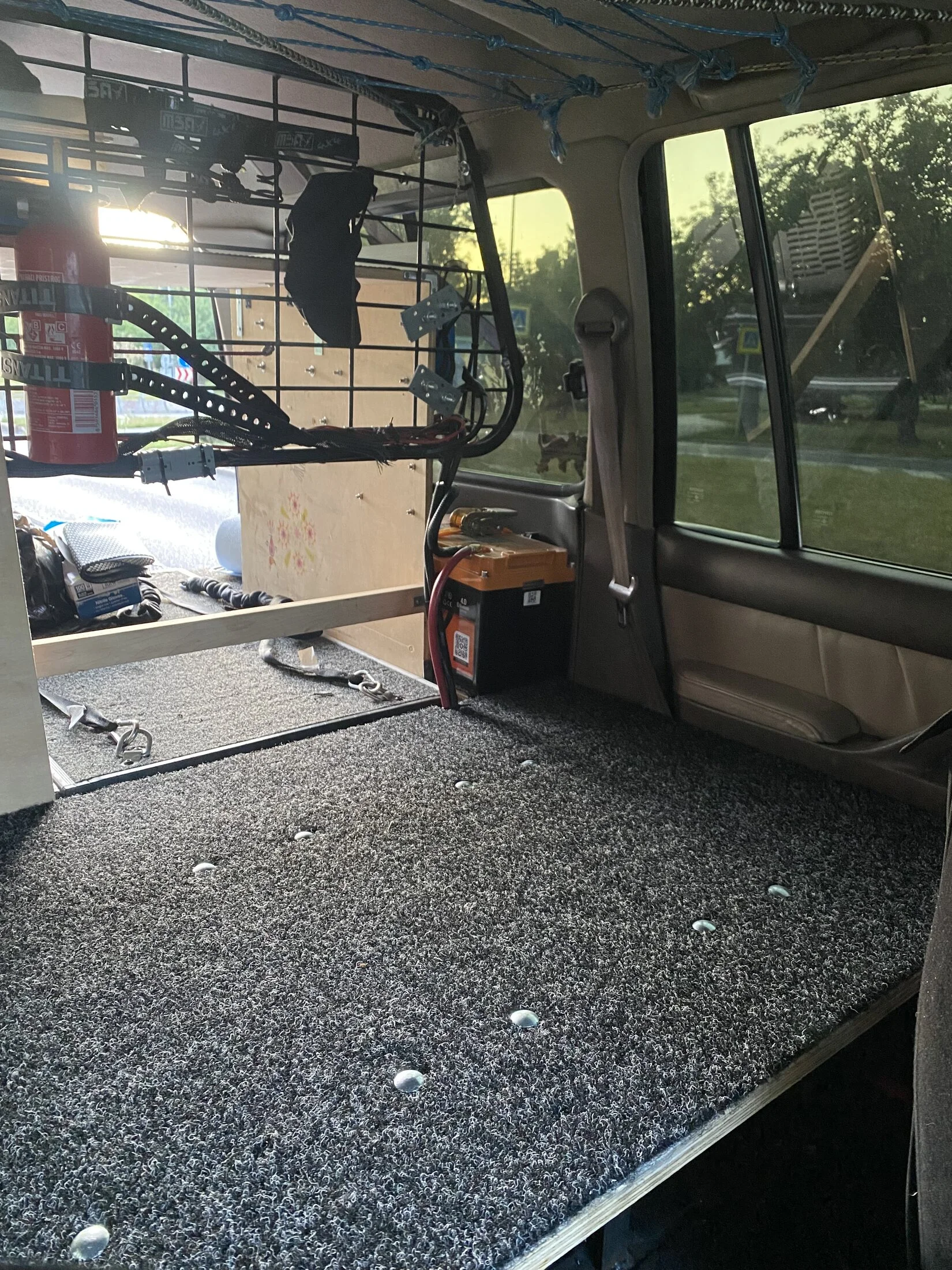

With help from my friend we built the second row delete platform.

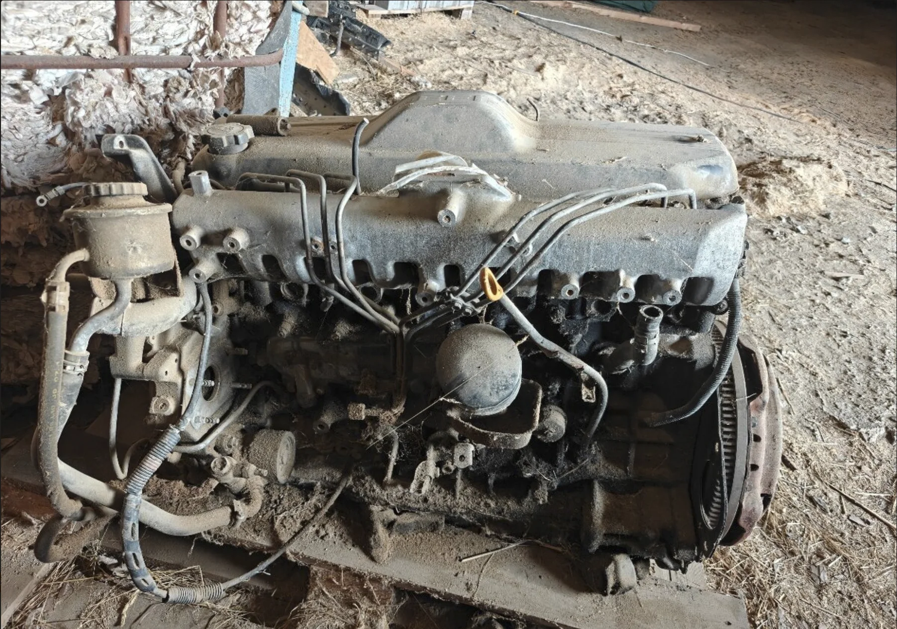

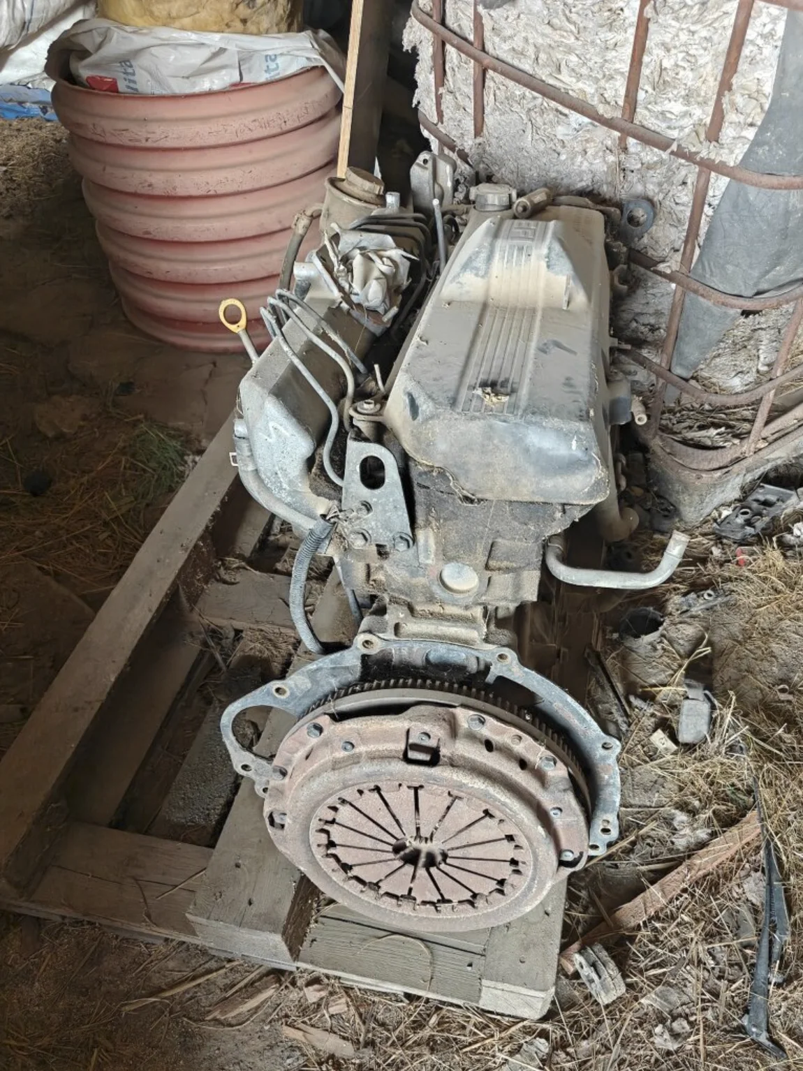

This is going for 2000 USD, thinking of buying that one for backup:
