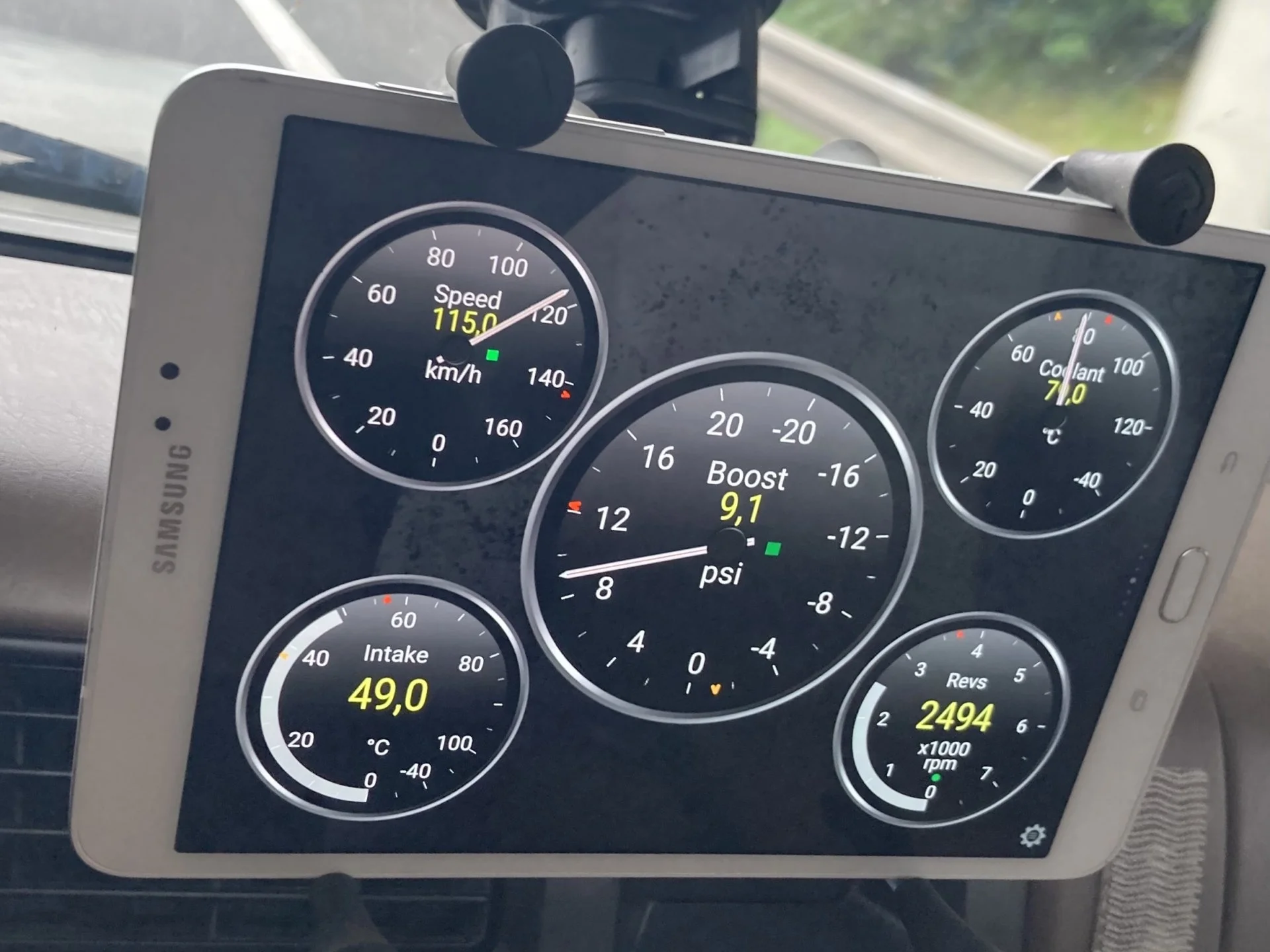

Did not say you were the only one. I keep forgetting you decided to run an auto in this setup. What are your RPMs at 70 mph?

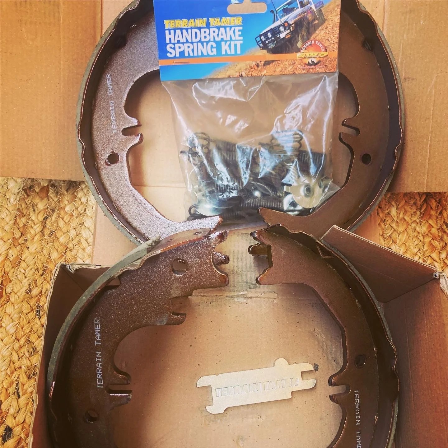

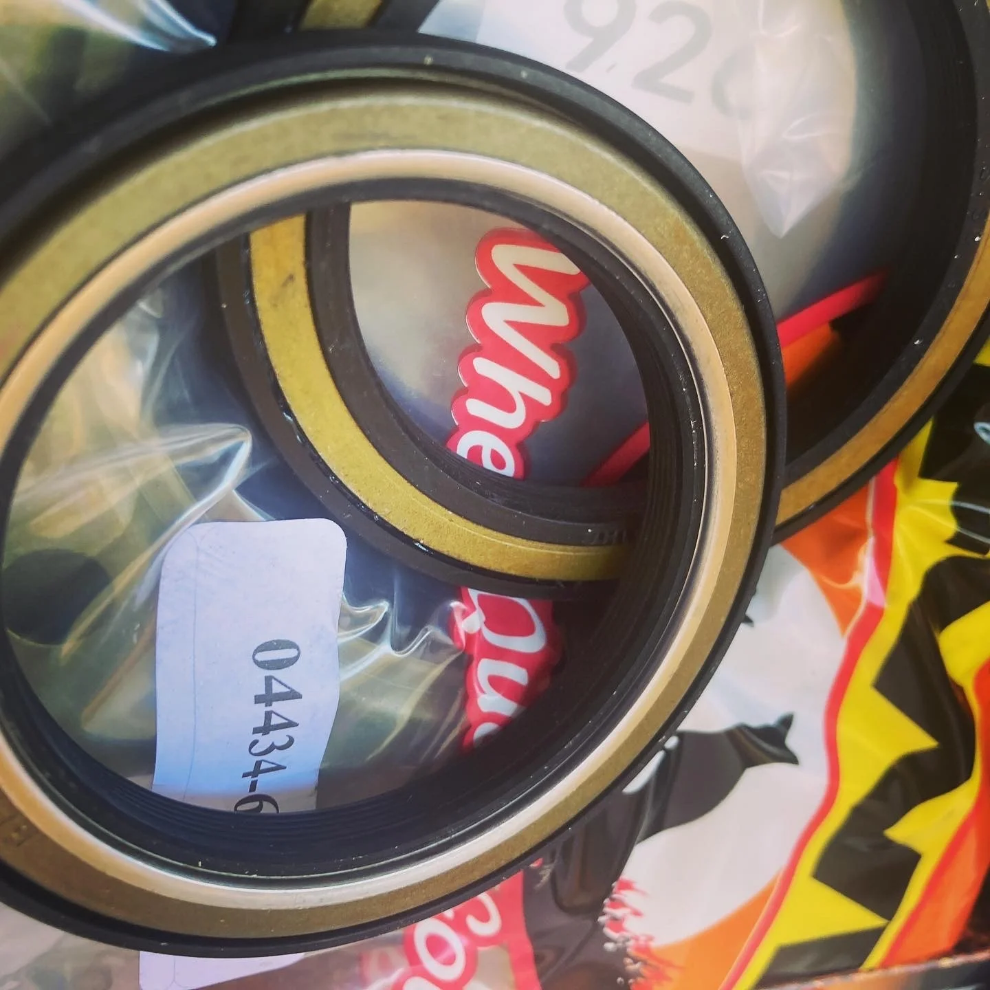

Got terrain Tamer knuckle rebuild kit and hand brake kit , quite surprised by the good quality of the kits
It sits at 2400 rpm at 70mph on flat highway
Interesting. Mine should be around that number with the H152. But not with 4.88s.
Here is the picture from the torque app 115 km/h and 2494 rpm
So the temps are within 75-83 Celsius which I read is standard with the 1HD-FTE engines. New radiator ( 5 years old actually ), new thermostat, new hoses, and new coolant. Also, the viscous coupler is new, quite happy with the temps.

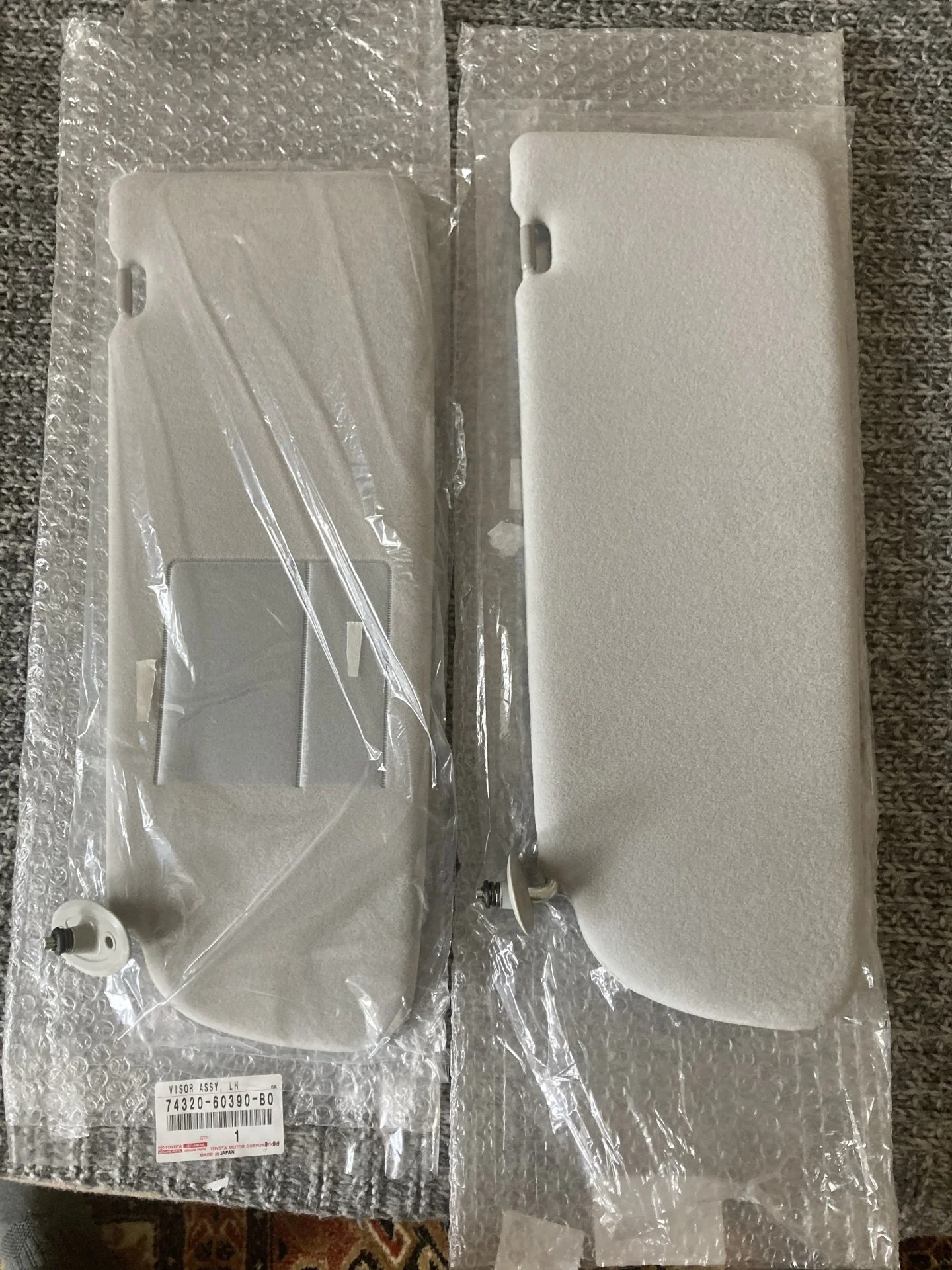

Installed the Delta charging USB ash tray replacement and got new sun visors from UAE

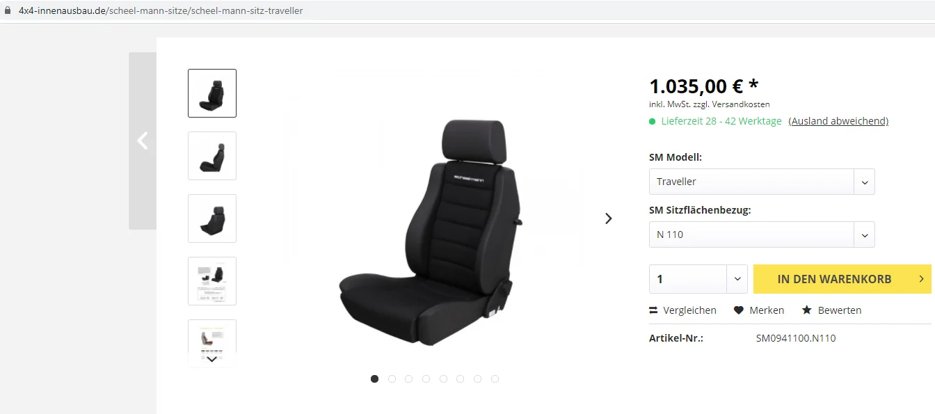

Scheel-manns are not that crazy expensive in Germany, for traveler seat without the extras the price is 1035 euros which is 1200 USD. Already got the brackets so this is gonna happen soon, the delivery time for these is around 40 days ..

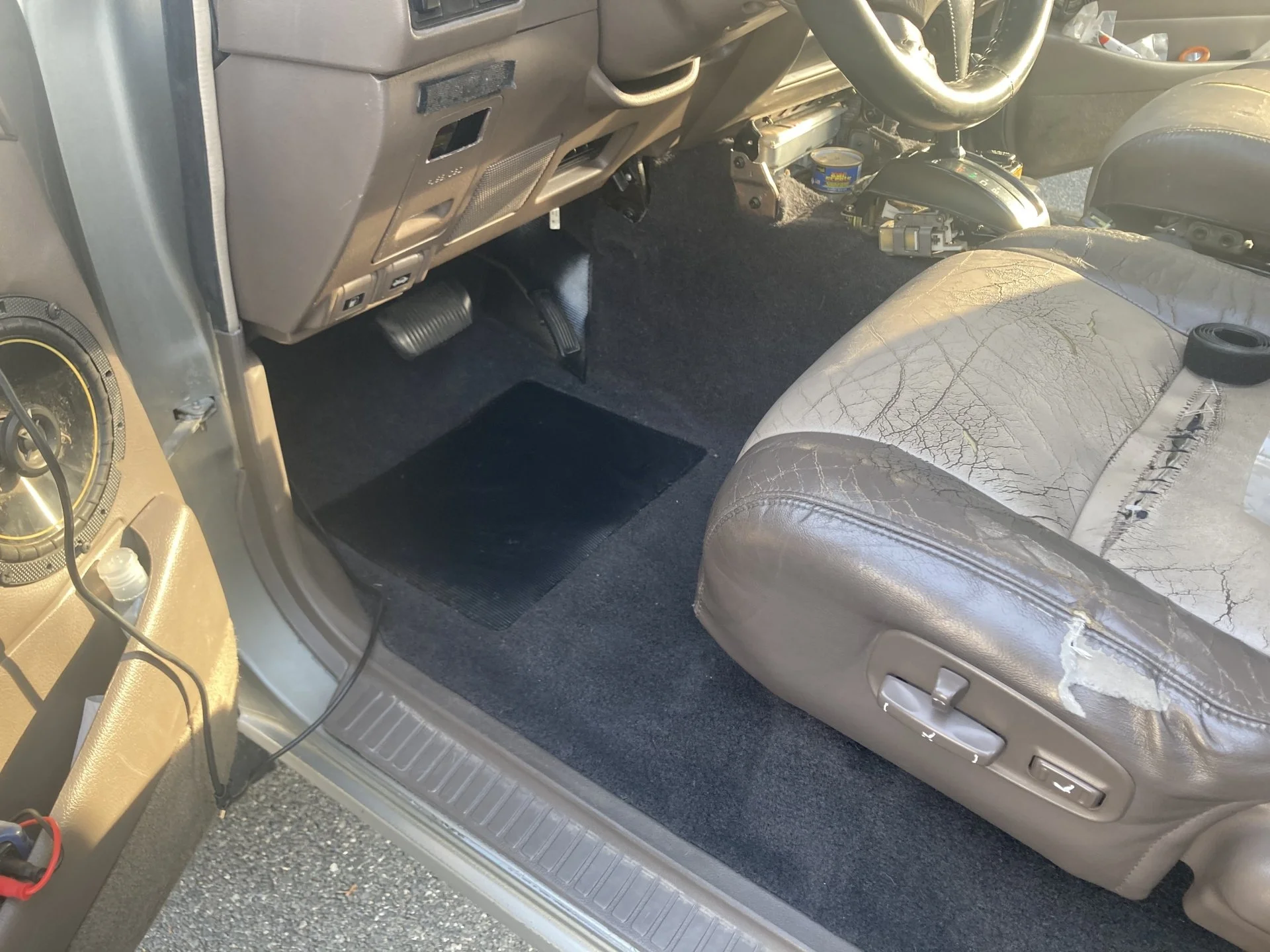

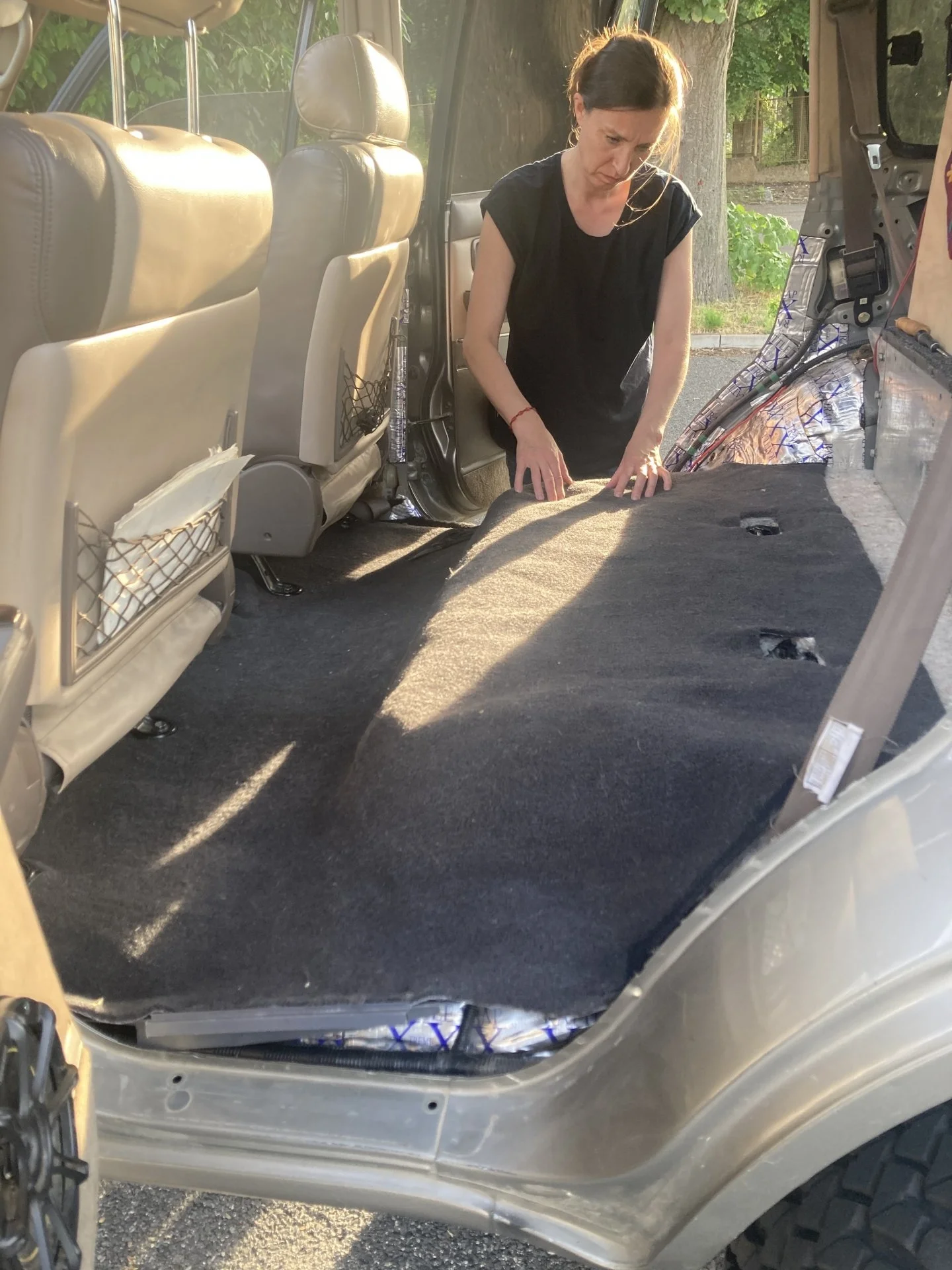

We did put the new carpet from stock interiors ,not very difficult job if you keep your pace slow.

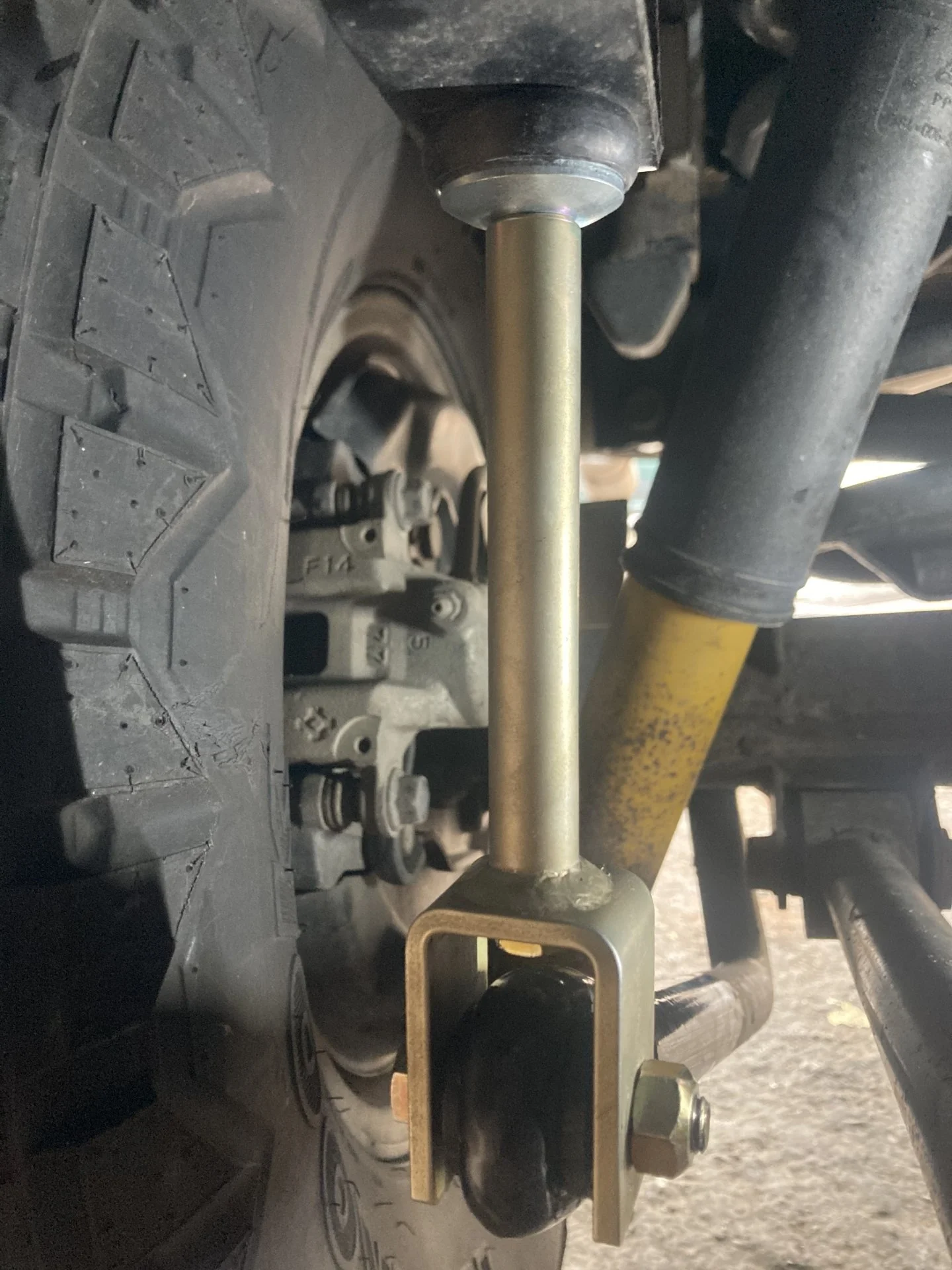

New sway bar links from @landtank also put the heavy duty sway bar

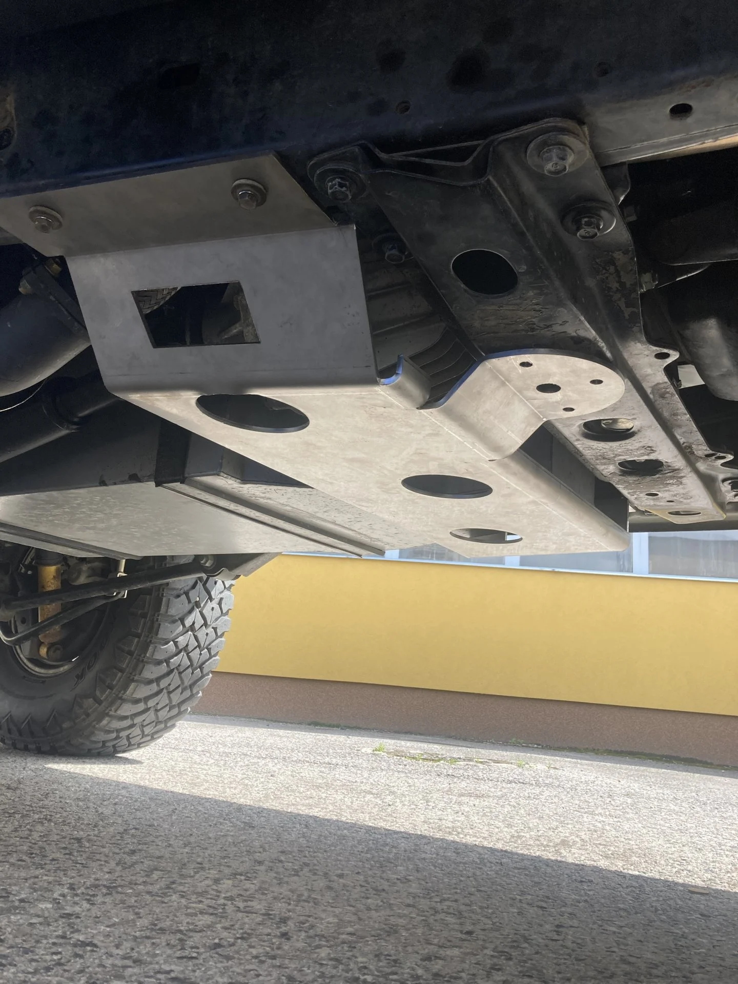

So put the skid plate for the transfer case and lra tank. The skid plate wasn't measured properly and had to cut a bit to line up also there is like 10cm space between the tank and the skid plate and the skid plate is hanging pretty low to my liking . I will have to redo this

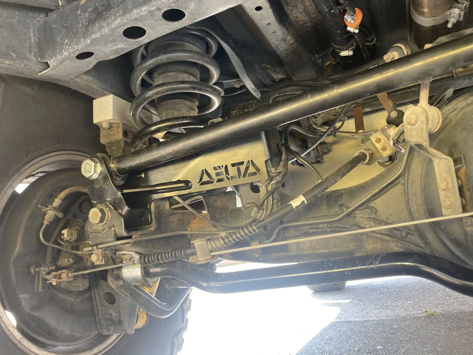

Installed the deltavs panhard relocation bracket and wired up the cruise control. Had little confusion with the wiring diagram

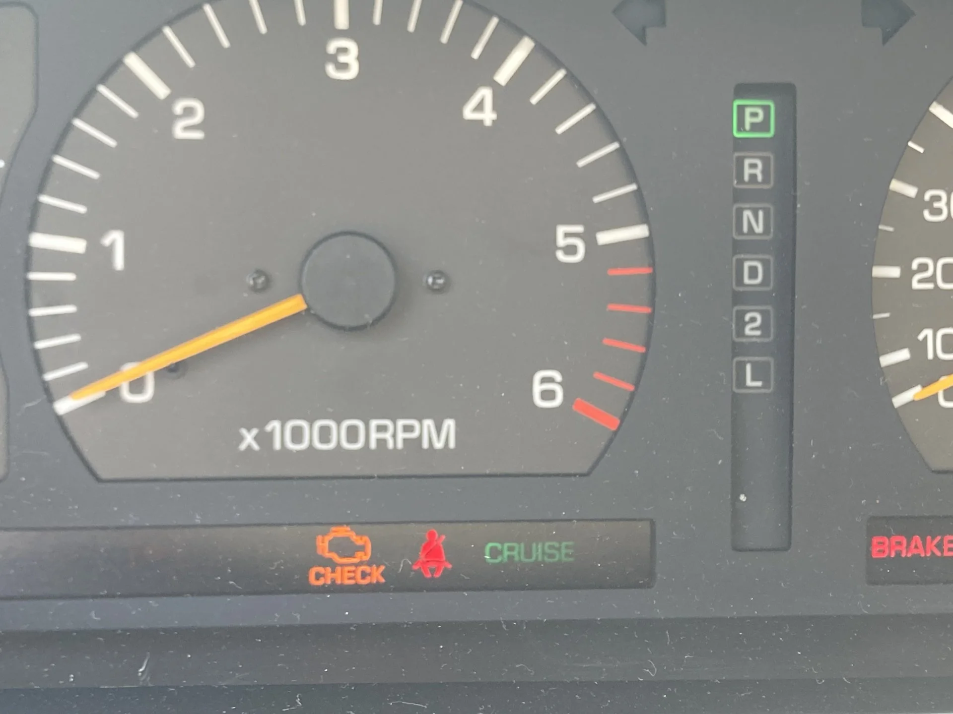

So yesterday went with the cruiser for a short trip ( around 100 miles ) parked and went to the trail, when we came back the car wasn't starting. It was cranking but not catching at all, after a while I realized that the CEL light is missing, turned that the AM2 fusible link is broken. Seems strange that this happened after I wired the cruise control. Fortunately had the spare with me so changed that and we went home. Also, the fusible links eyes are too small for the odyssey battery so had little drama making the eye bigger. I will see if the fusible link will keep blowing or not. I am thinking that maybe some 1FZ ignition-related stuff is hanging free and causing this.

If I am right it is used on both, basically, all in-house electrics stayed from the 1FZ, the modified loom has two ( one 15AMP, second 30AMP ) sources directly coming from the battery ( through the blue sea fuse box ). I think you should just go with the 1FZ fusible links, btw, what did you do with all the EFI stuff ( relays, fuses, etc ). I still have all that stuff in the car.
