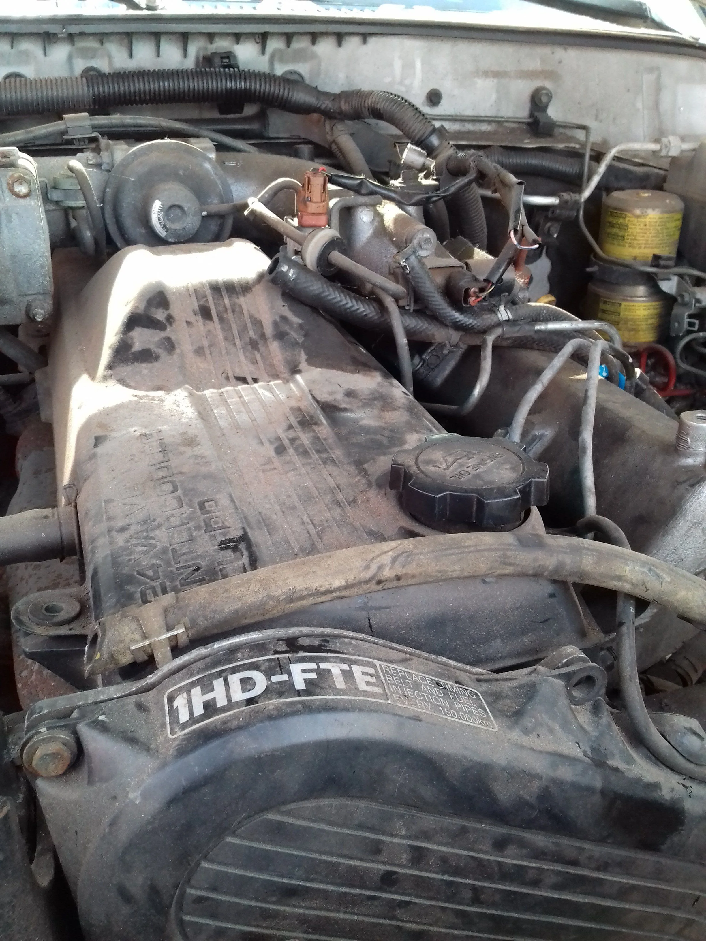

Scored running 1hd-fte from 2000 HDJ100 here in Europe, the price is 3500 USD, so far I have taken the following:
  • Engine itself
  • 4 speed auto with transfer case
  • Spill valve control
  • ECU and ECT for auto
  • Engine harness
  • Under bonnet harness
  • Dash harness
  • Pedal

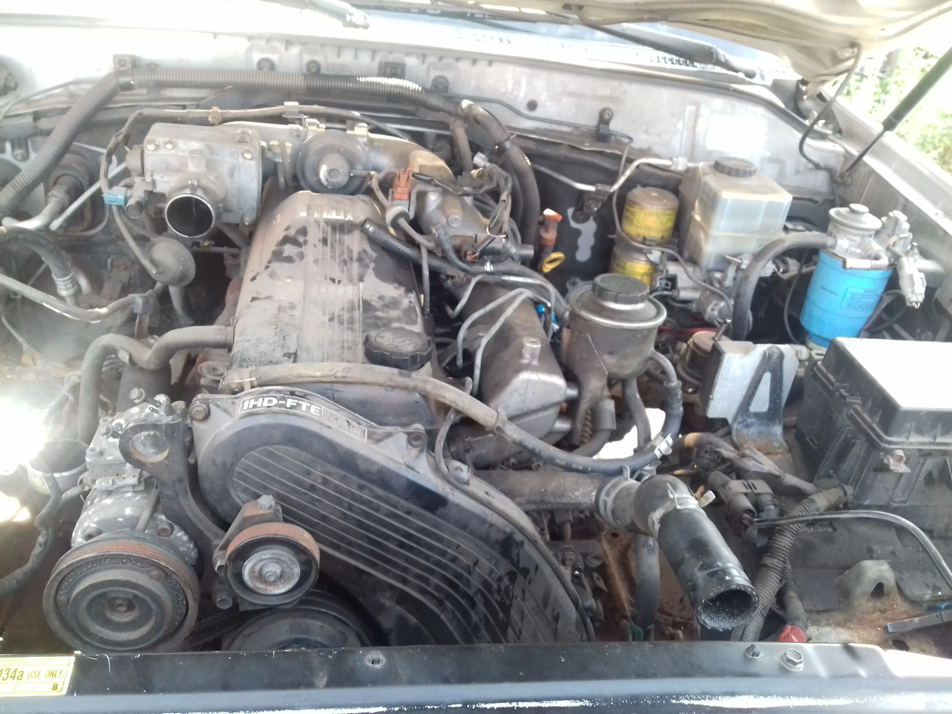

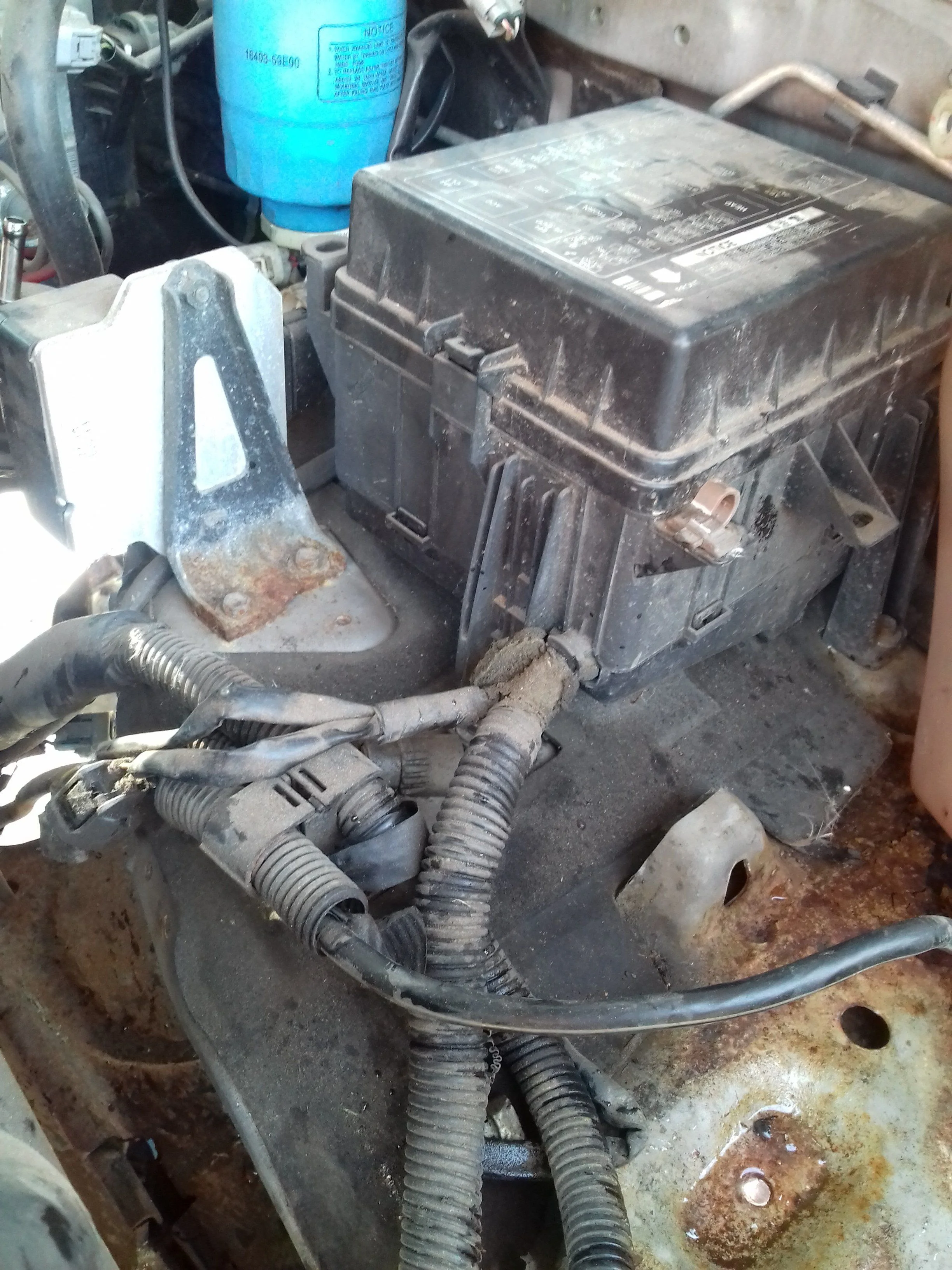

The 1HD-FTE engine is out and I shall start working on it from the next week, still did not take the 1FZ-FE which is also happening next week. Then I am sending the dash, engine loom and under bonnet loom ( from 1HD-FTE) and engine loom ( from 1FZ-FE ) to thrashlux from LCOOL.

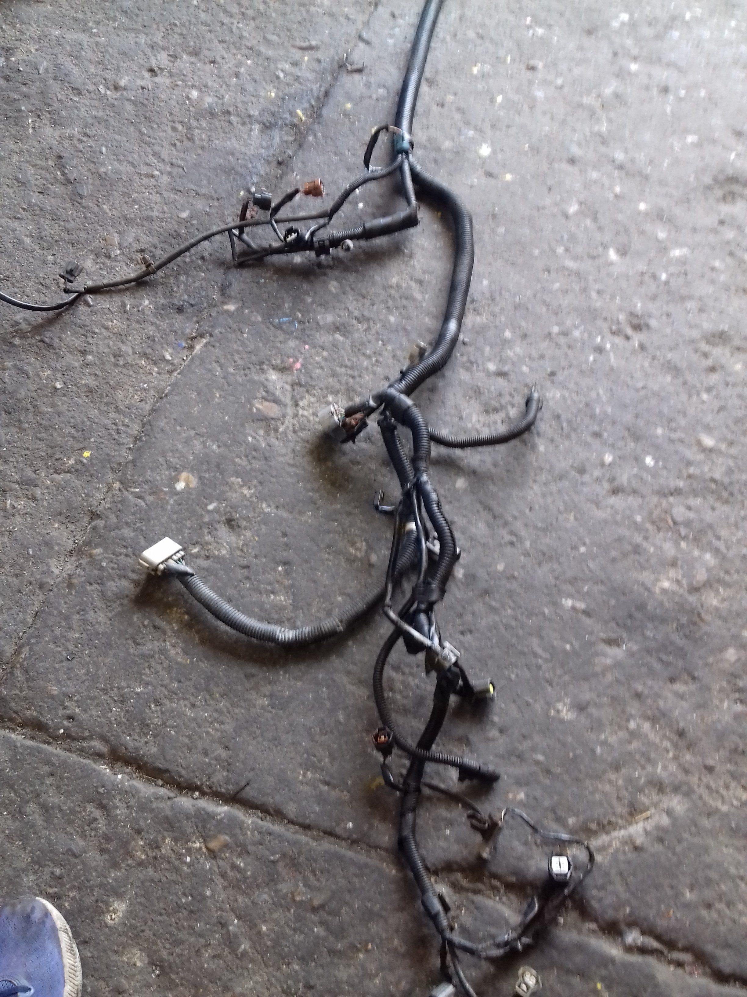

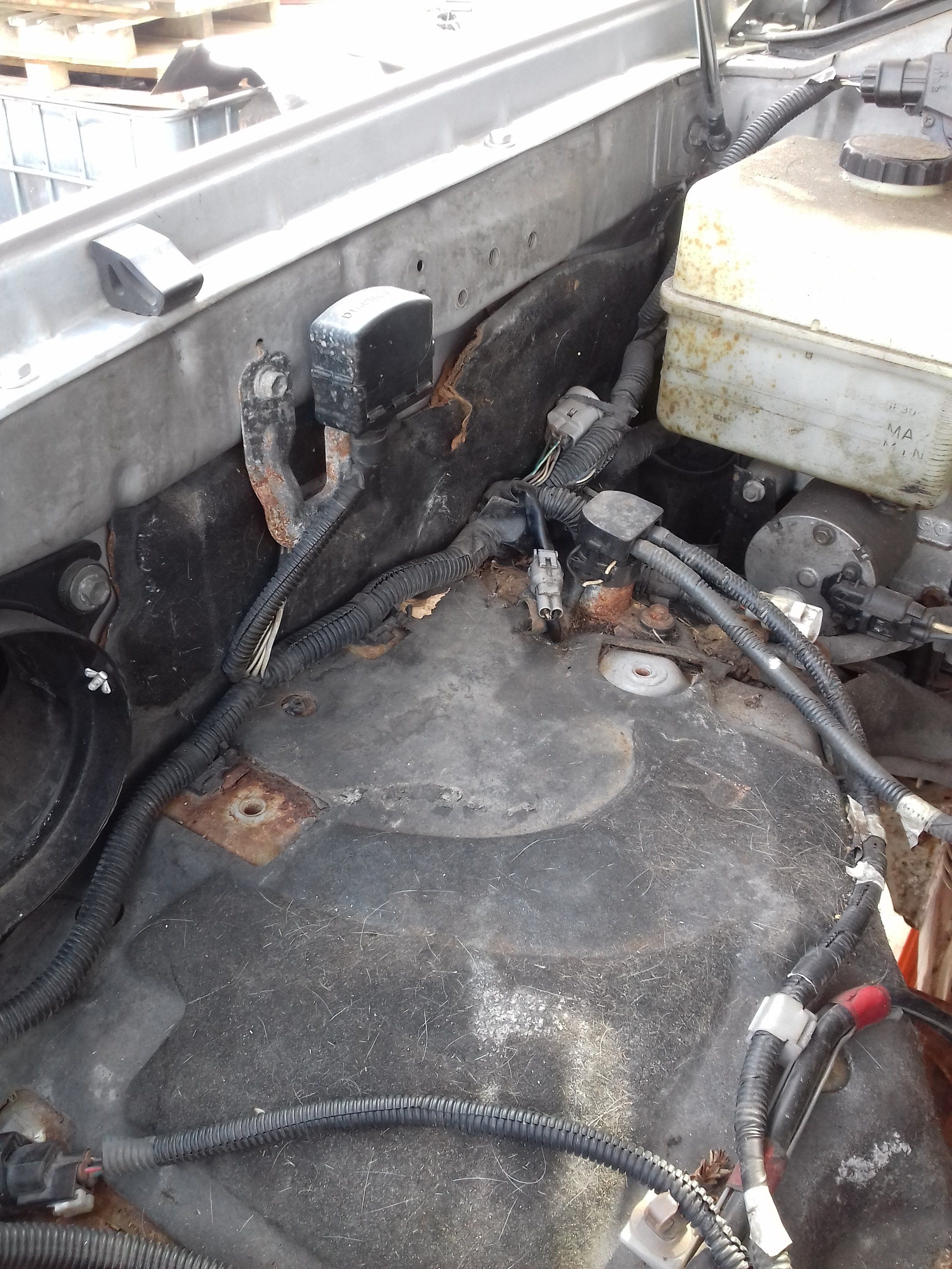

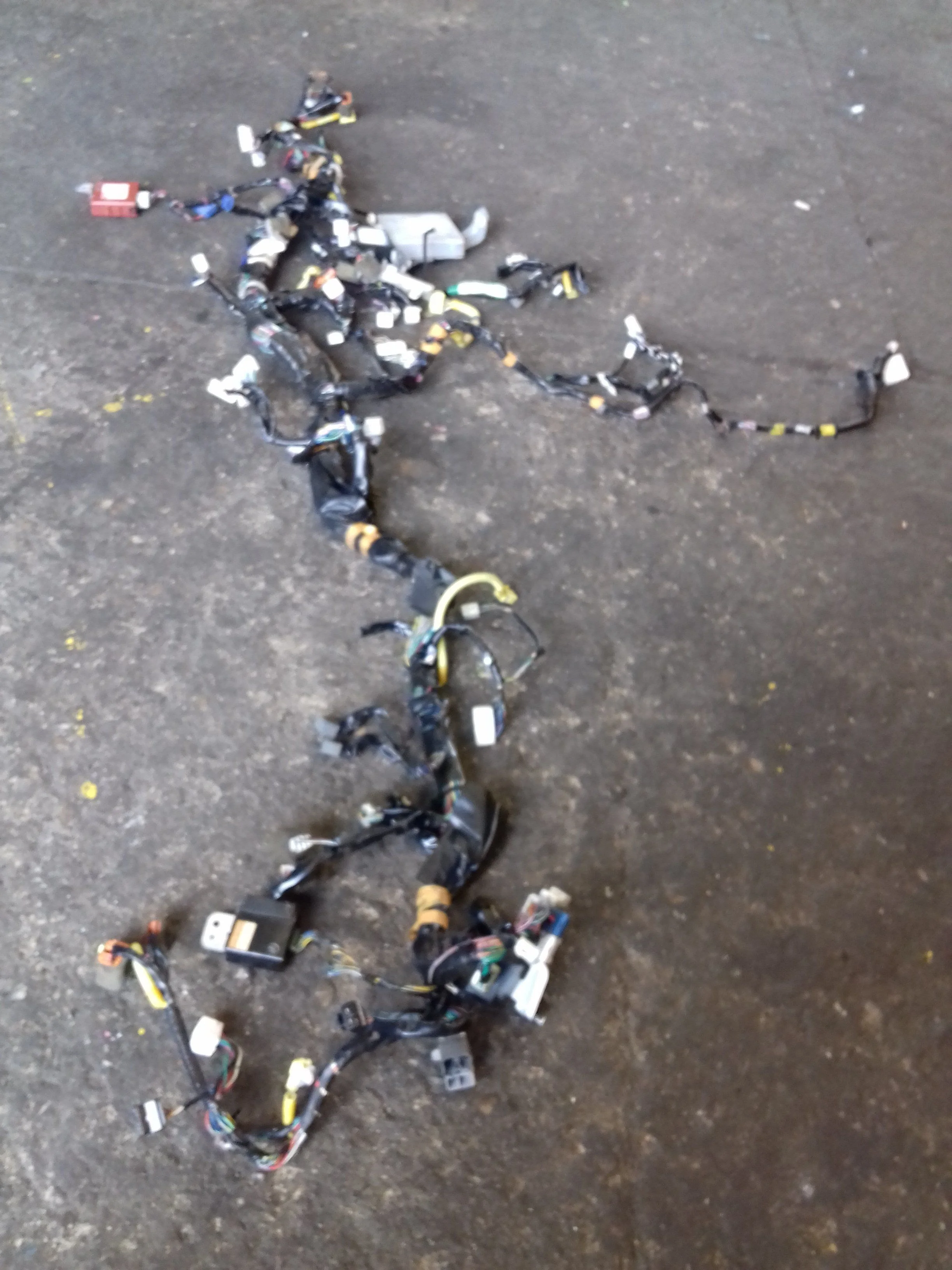

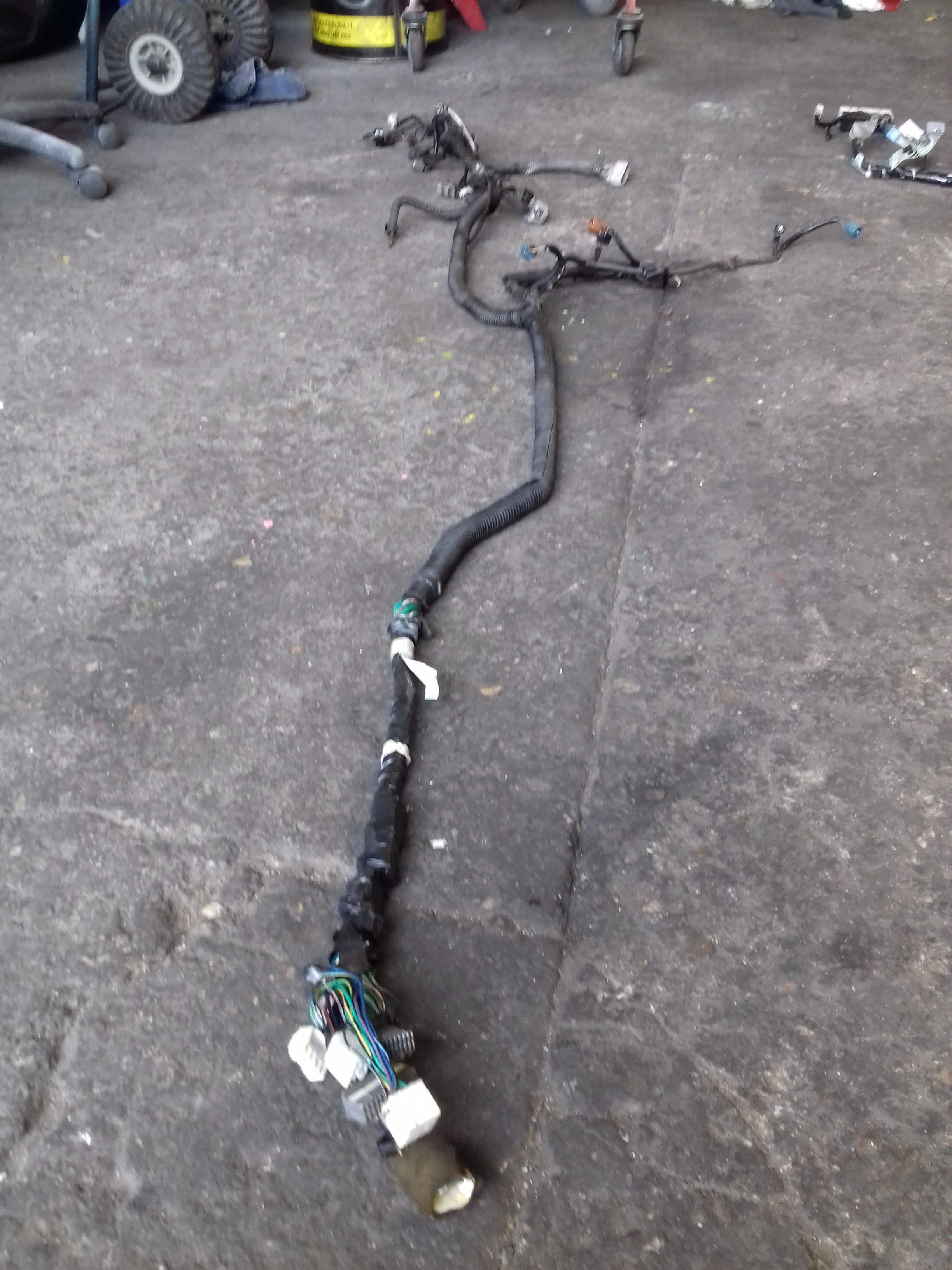

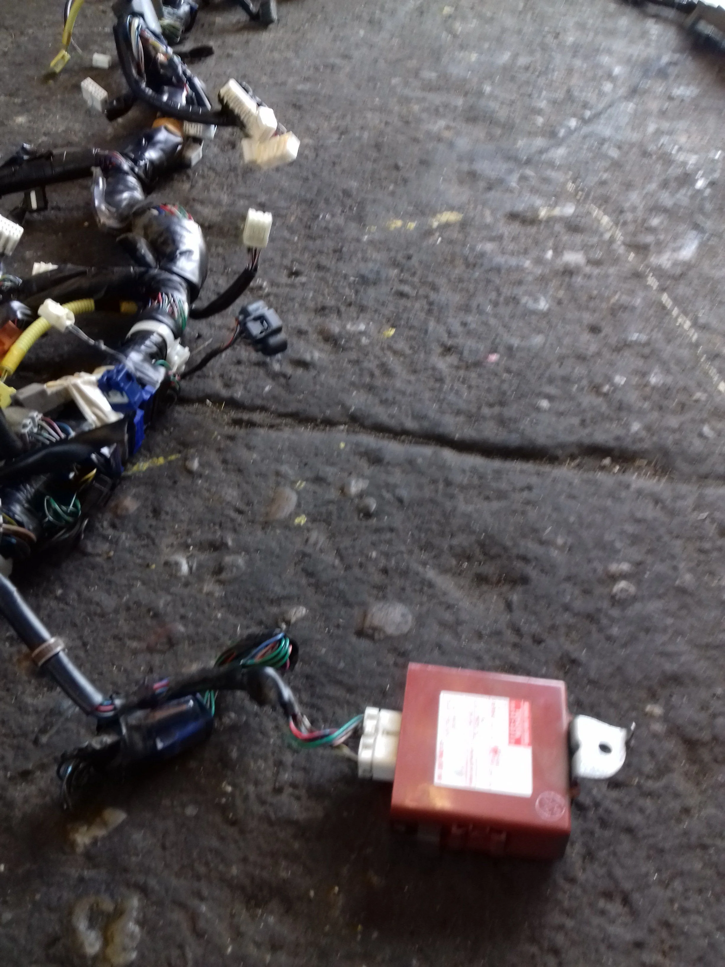

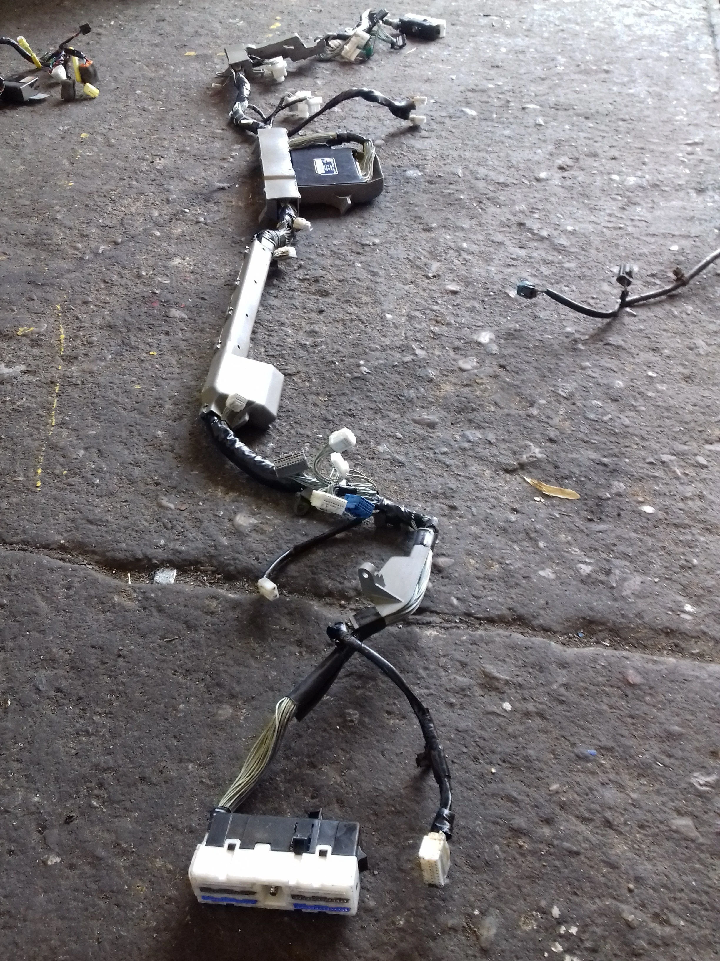

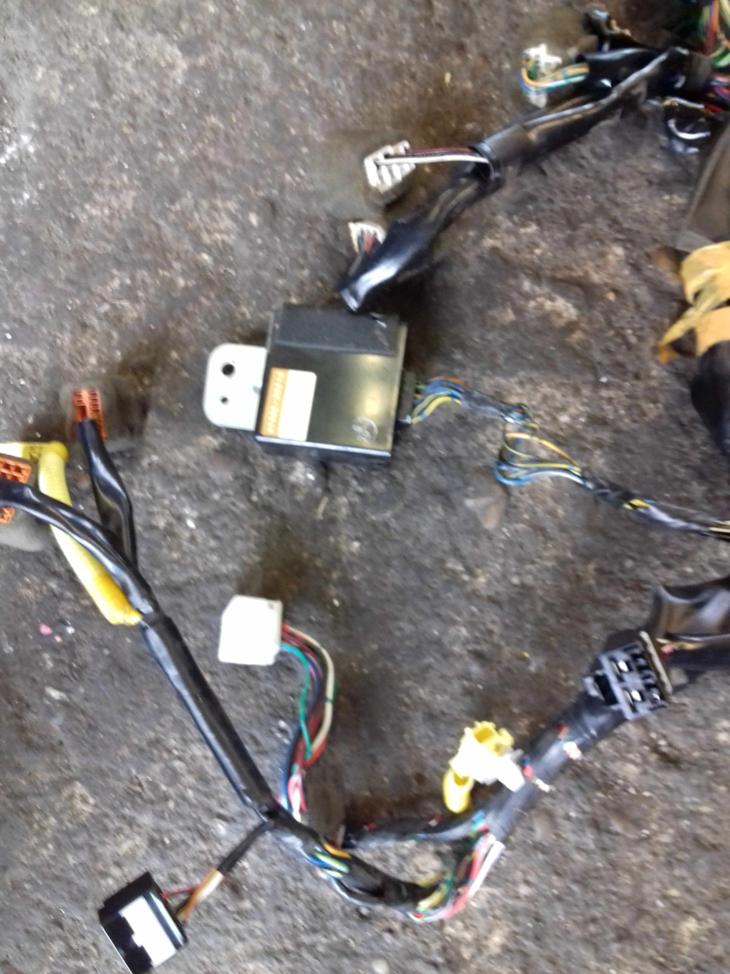

There is a lot of wiring on the 100 , got all the loom from the dash + engine:

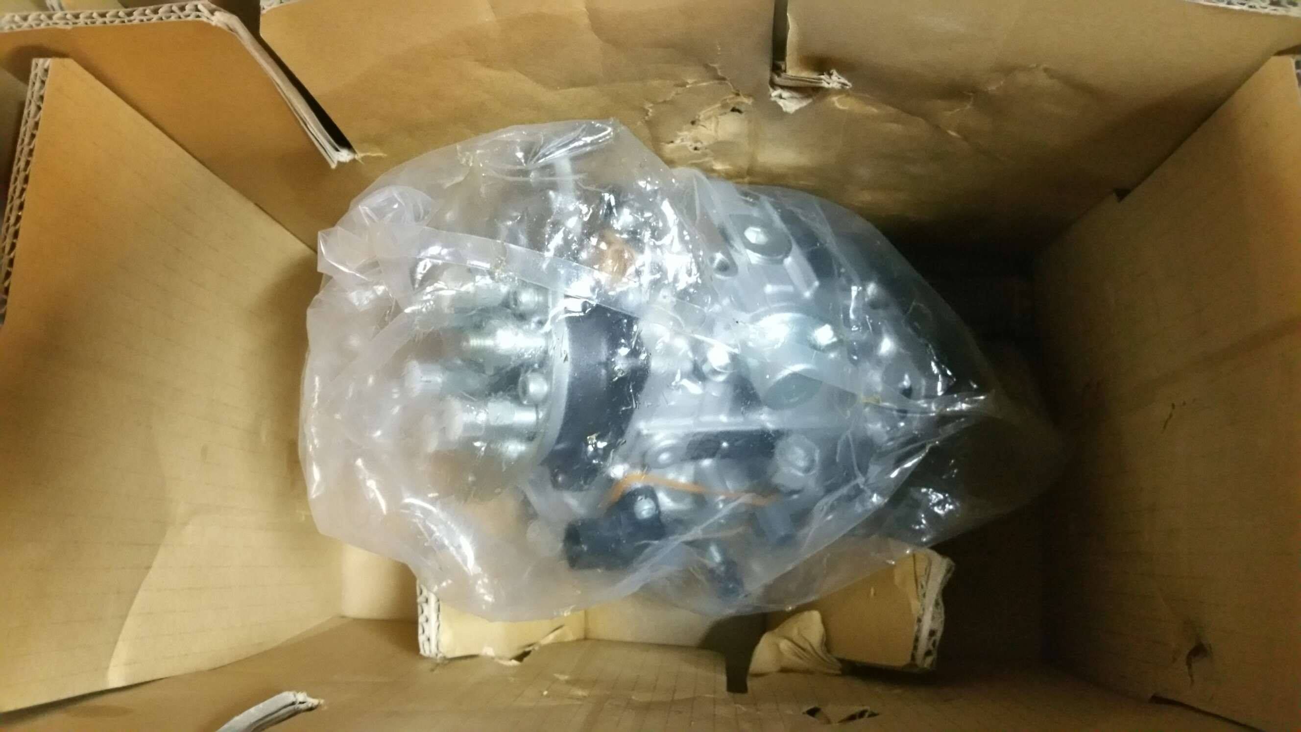

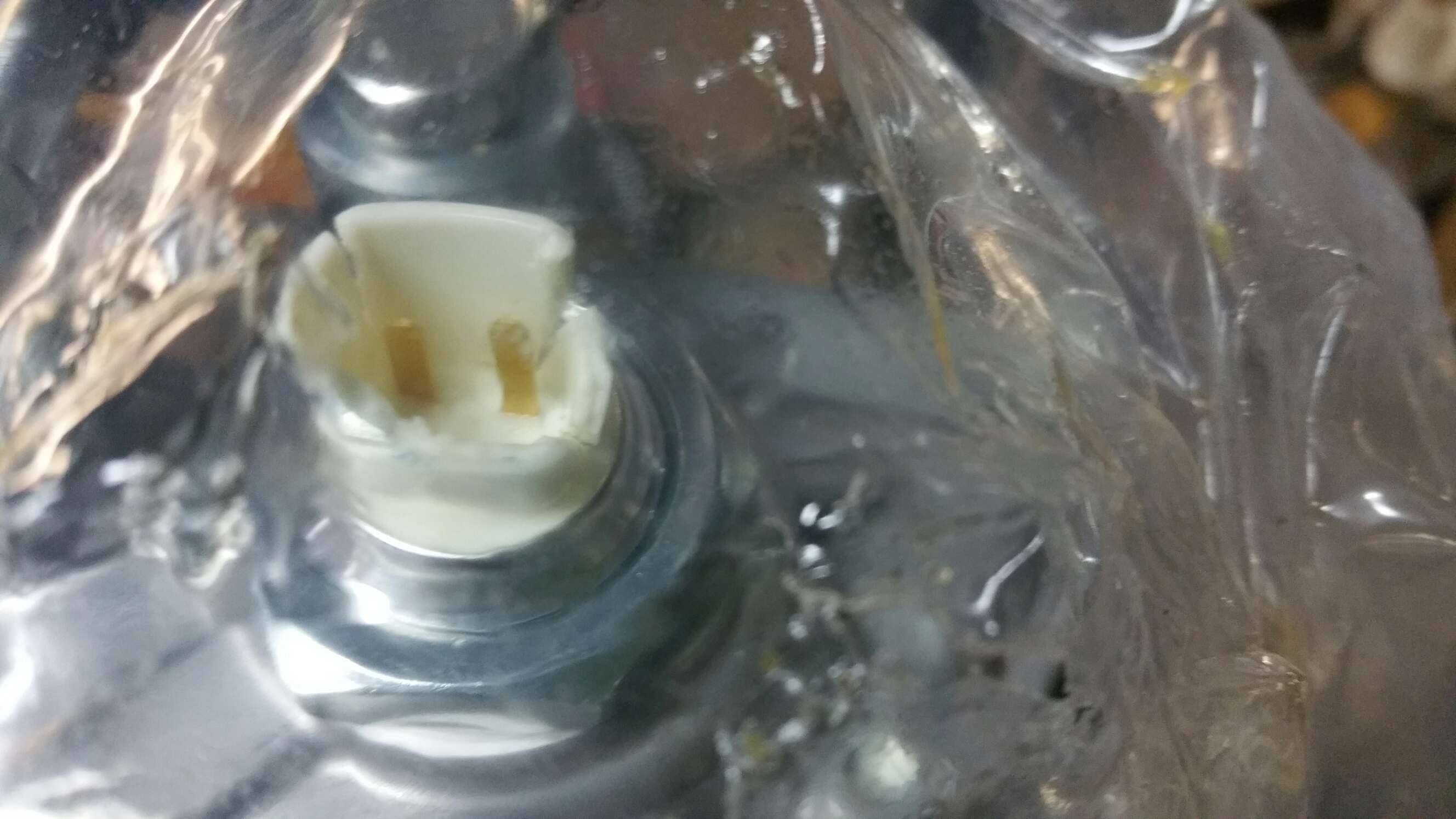

A bit of update, I was waiting for the fundings, bought a new pump in Australia but the guy did a very poor job securing the pump, the result is that the speed connector broke, I am still debating if I shall keep it, the new pump from partsouq is 4300 USD. I bought this one for about 3500 AUD.

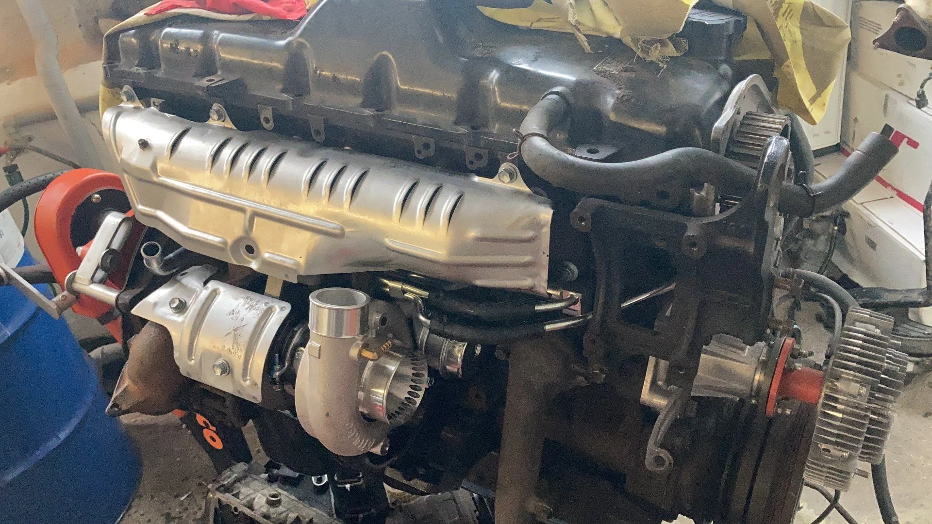

Turbo bolted , new injection pump also

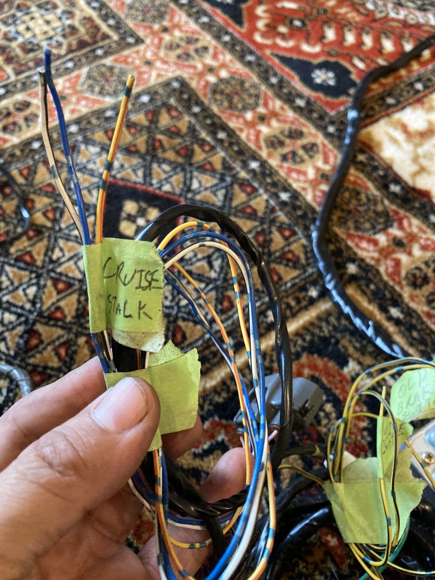

The loom came from Australia, it's labeled pretty extensively and the guy doing the loom is just a treasure to work with

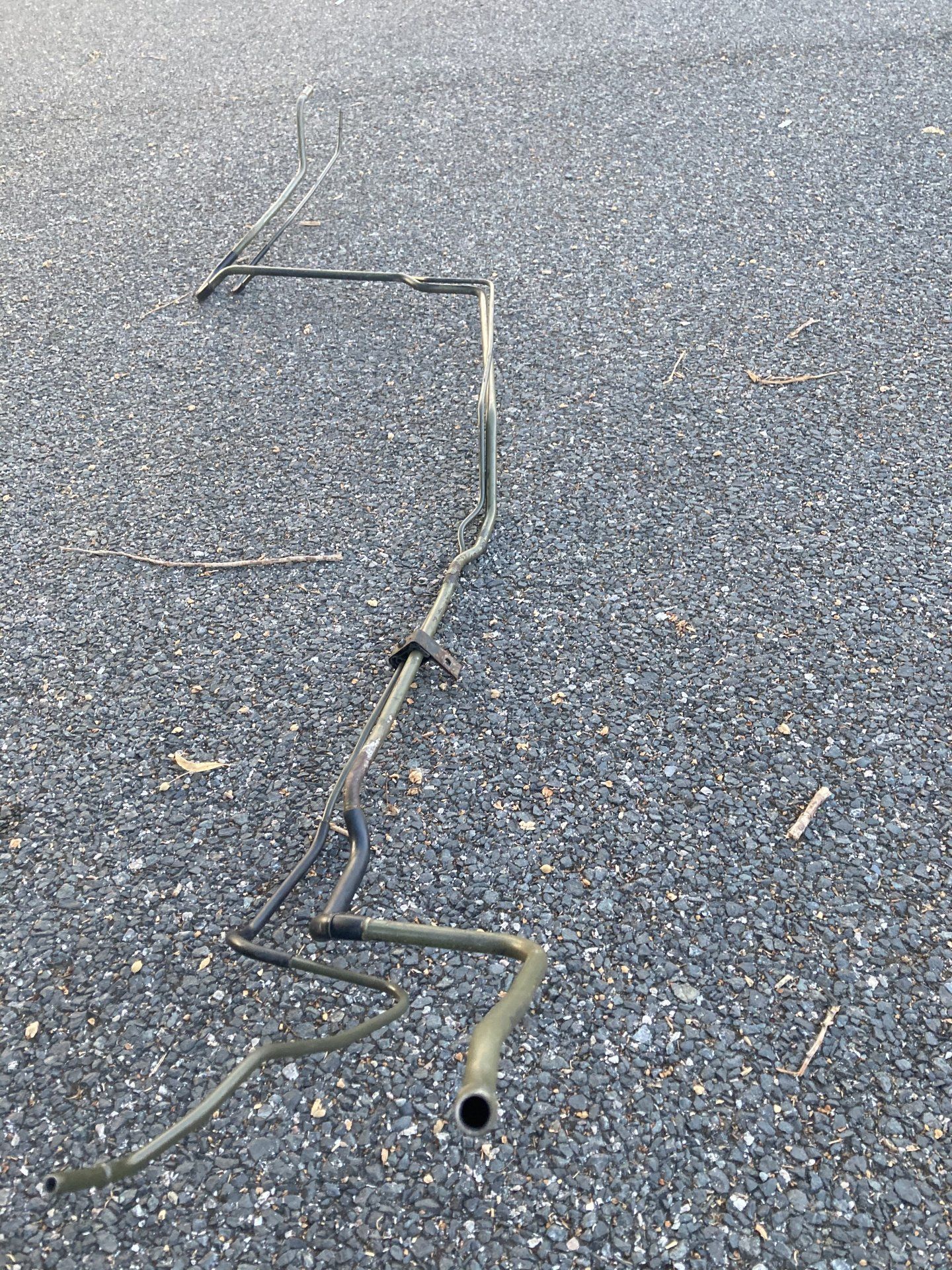

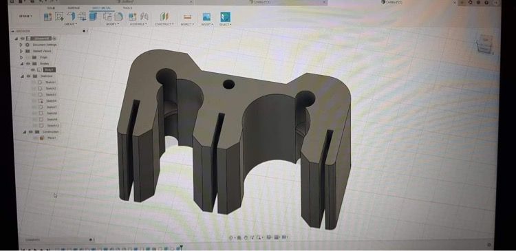

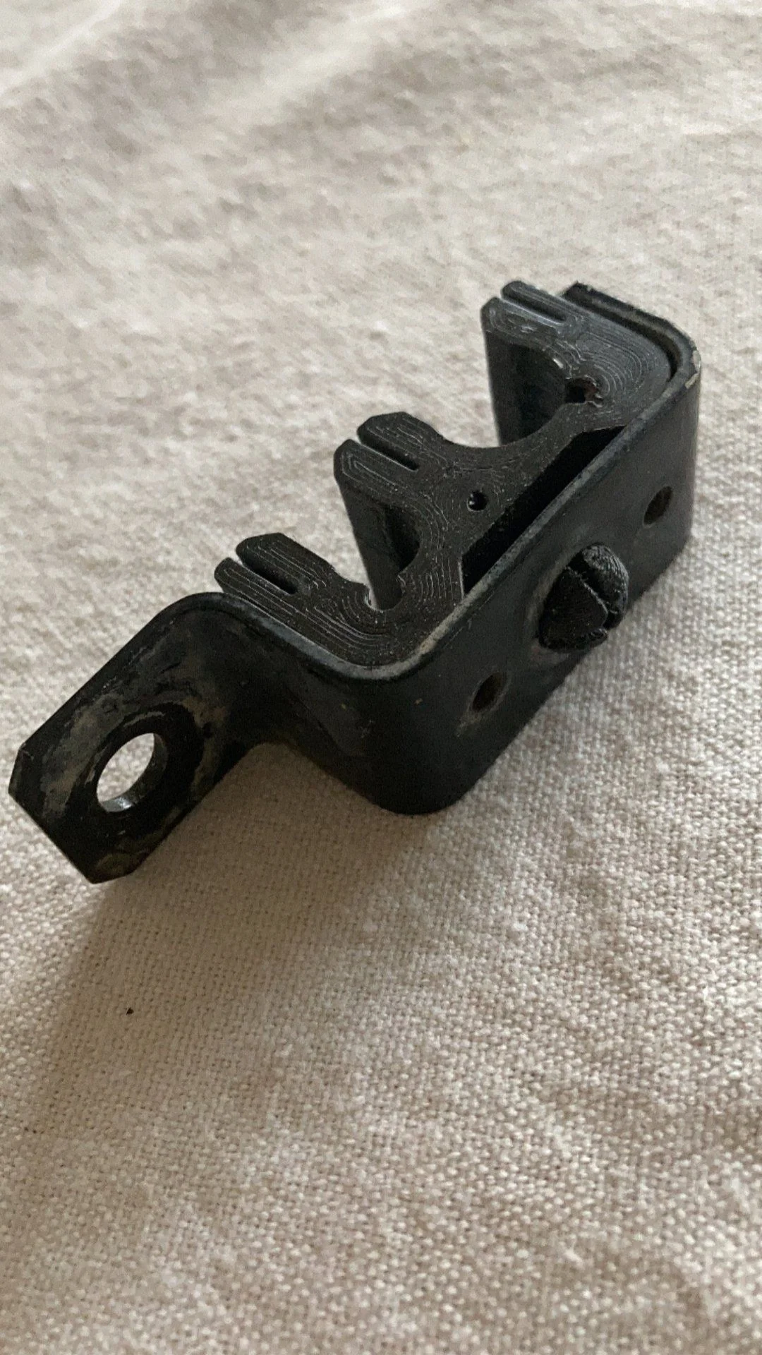

Also having to clean the hdj fuel lines, unfortunately the isolation in the brackets is broken and will be 3d printing them tomorrow as it's not possible to order them. I wasn't sure if the lines are the right ones, obviously, the HDJ80 came with two different sizes of the lines one 10mm and 12mm. This one pictured is 12mm OD while the Aussies on the 1hdfte conversion facebook page mention that the line actually needs to be 12mm ID. I think that I will stick to this one 12mm OD as it's not easy to get one and to make a custom one seems a lot of effort. Regarding the 140l LRA tank it came pretty well packed and I am now modifying the diesel pickup as the pickup tube and float arm needs to be extended. I have one rusty fuel tank inlet and i am still not sure if I should work on that or just buy a new one from partsouq.
So I had my friend create the holders for the fuel lines as they are not available from Toyota anymore. Also I will be reusing the fuel line from the 1fz as return. The engine is basically prepared to be dropped in.

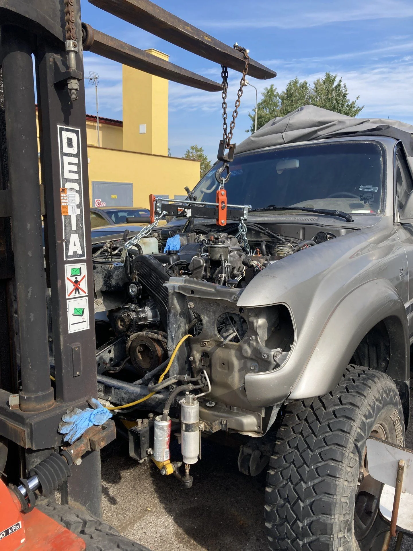

Engines in, I only have issue with the shifter of the transfer caee, it is actually hitting the right side of the shifter hole
