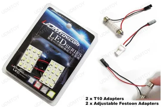

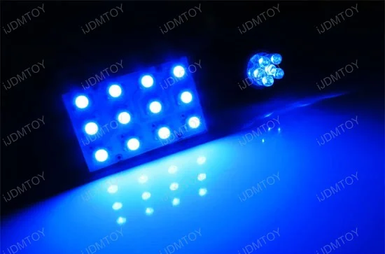

Eric I have replaced my front and rear domes with two of the wafers in each and added these to the interior of my cabinets. You can velcro these anywhere in your truck and you only need to cut a very small slit for the wiring. They are super bright (my wife calls them obnoxious)
Order them online or most Autozones carry them with adapters for any dome light but you do not need to utilize the adapter you can just run wiring direct to the wafers.
