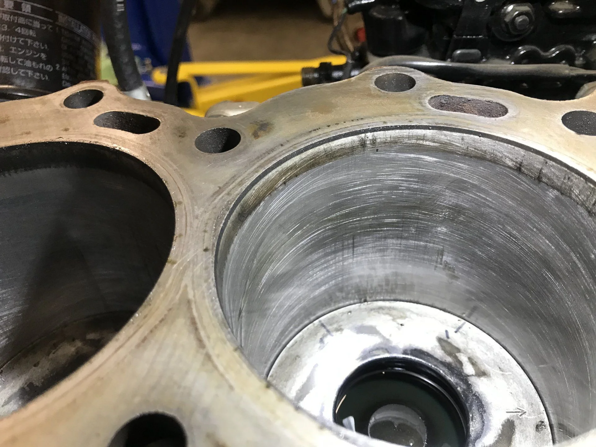

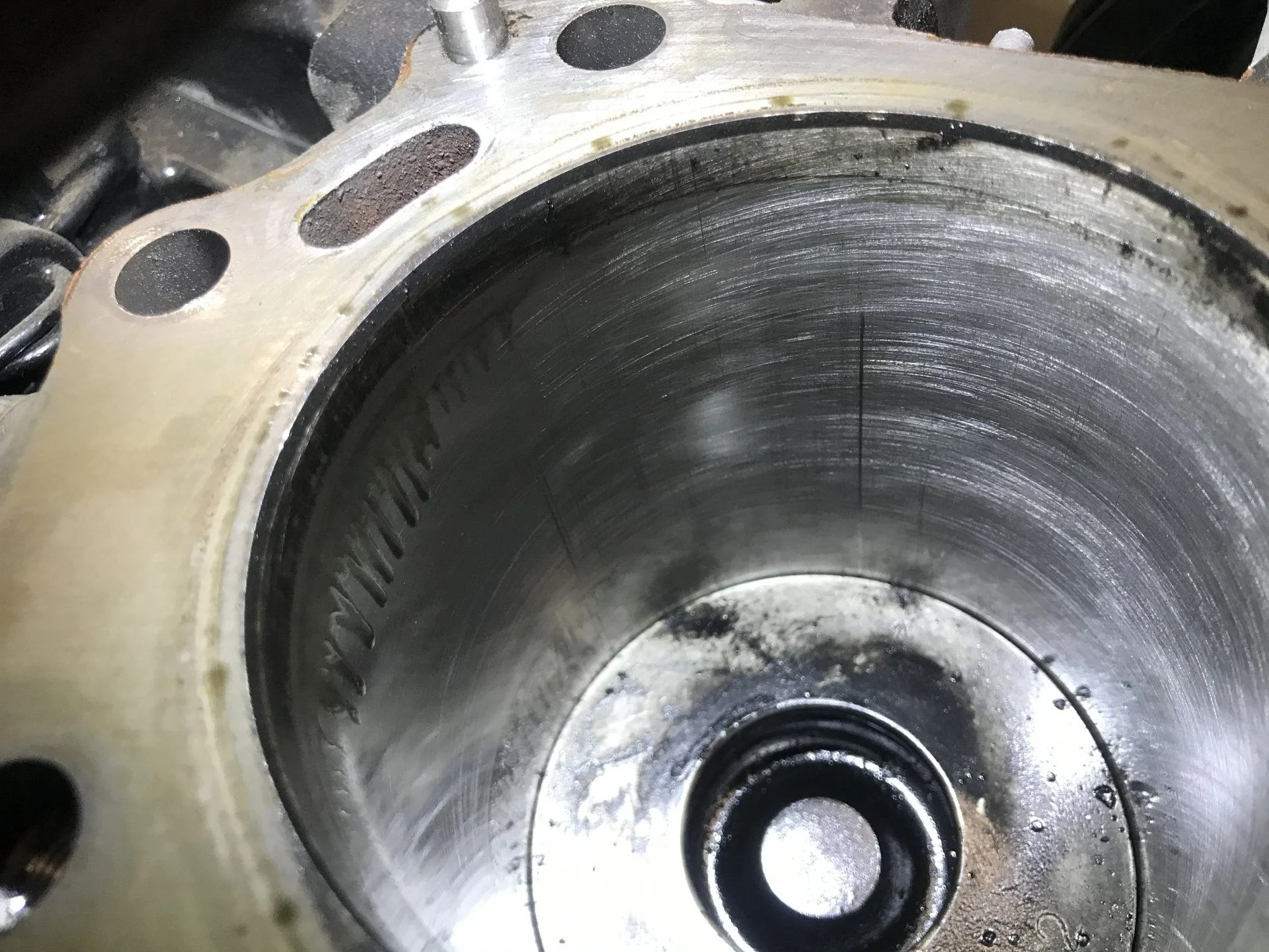

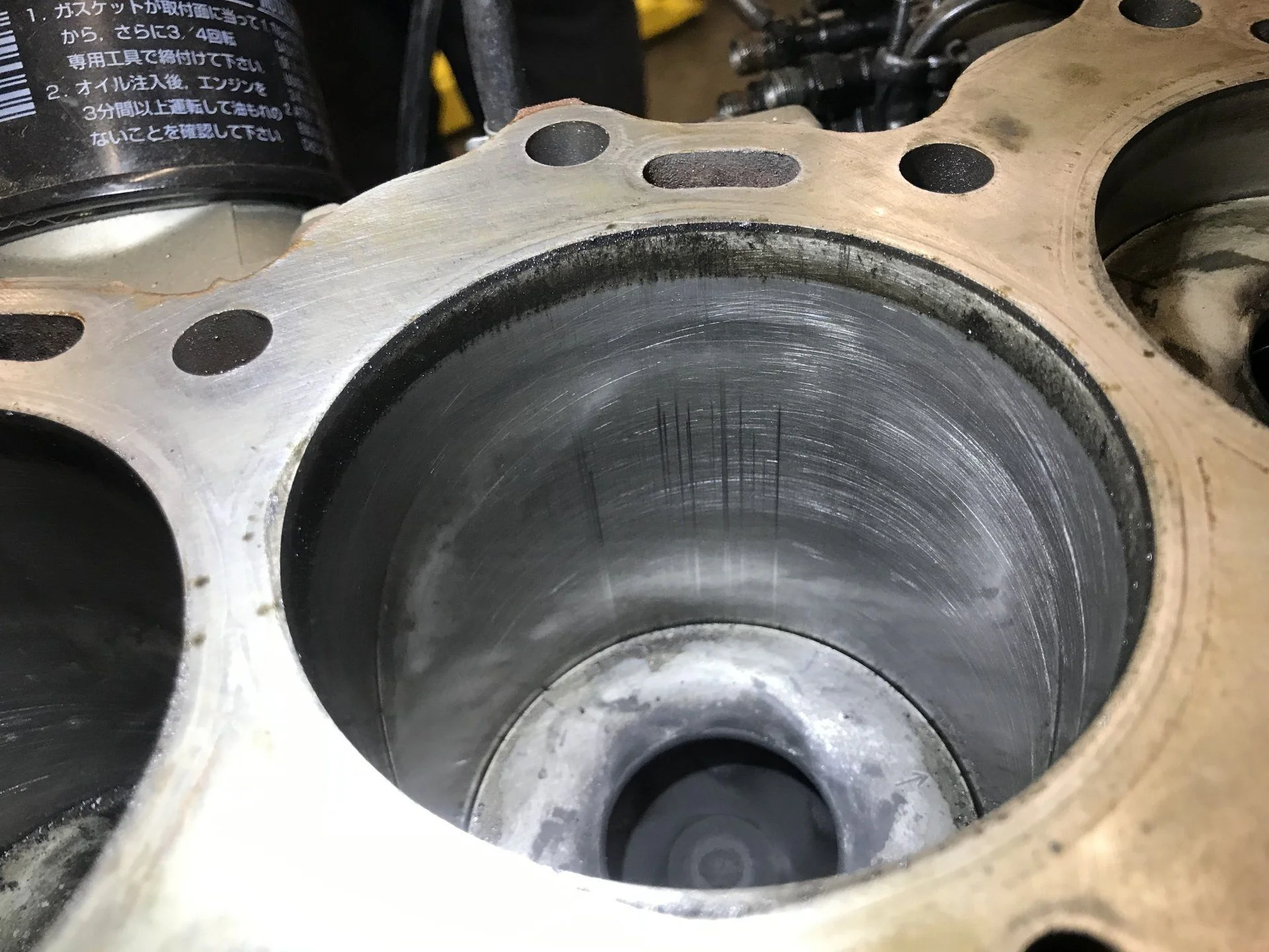

Scoring in the bores and on the piston skirts.
@Onur and myself ran this 90-120 seconds total. There was debris in this engine.

We are still checking rings but it appears these bores are tapered. So at most it got a hand hone.

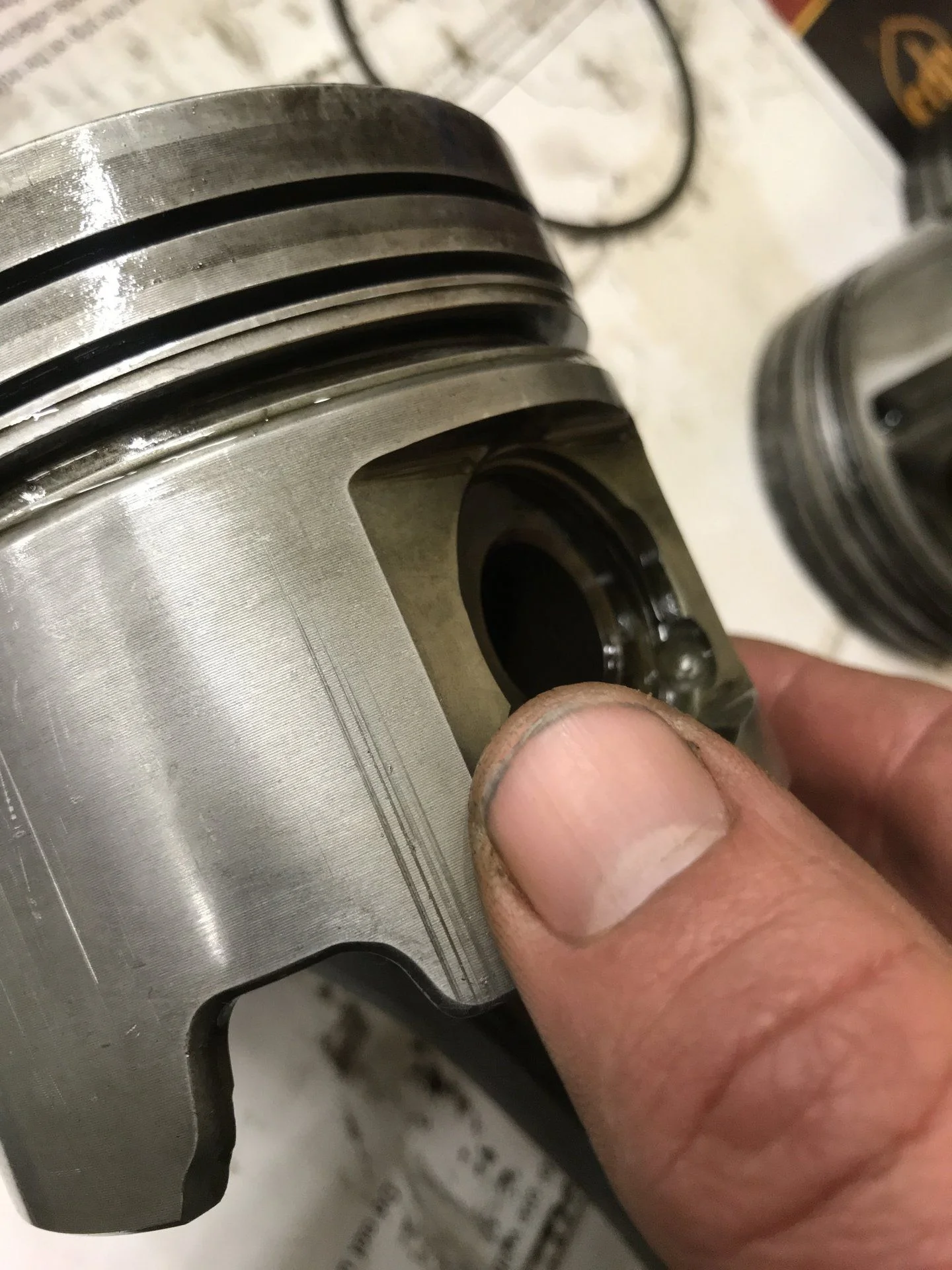

First up, I am not posting any of this to throw anybody under the bus or call them out. We know nothing about this engine’s previous life and we don’t even know how many miles are on it. It came to us rebuilt, to give John confidence and piece of mind it was decided to compression test it, it tested low, best cylinder was 370psi and lowest was about 300psi. We know very little about what it received in the rebuild other than what we see and what John has informed us of. I also would not post any of this without asking the customer and or being asked to post it.

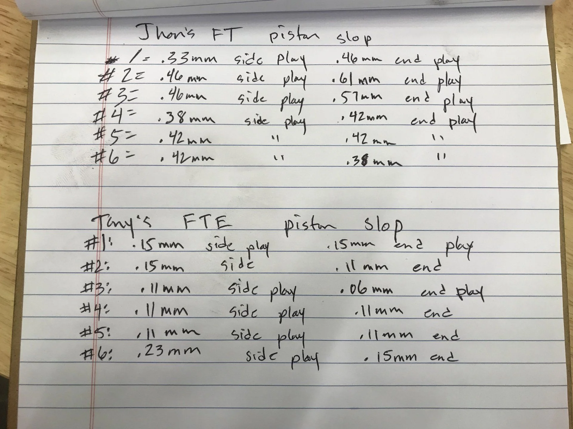

Here is the piston slop on this FT.
Now here is another clients FTE that recently arrived from Germany. It has 230,000kms or so and has never been opened up until we cracked it open. It also tested low on compression.

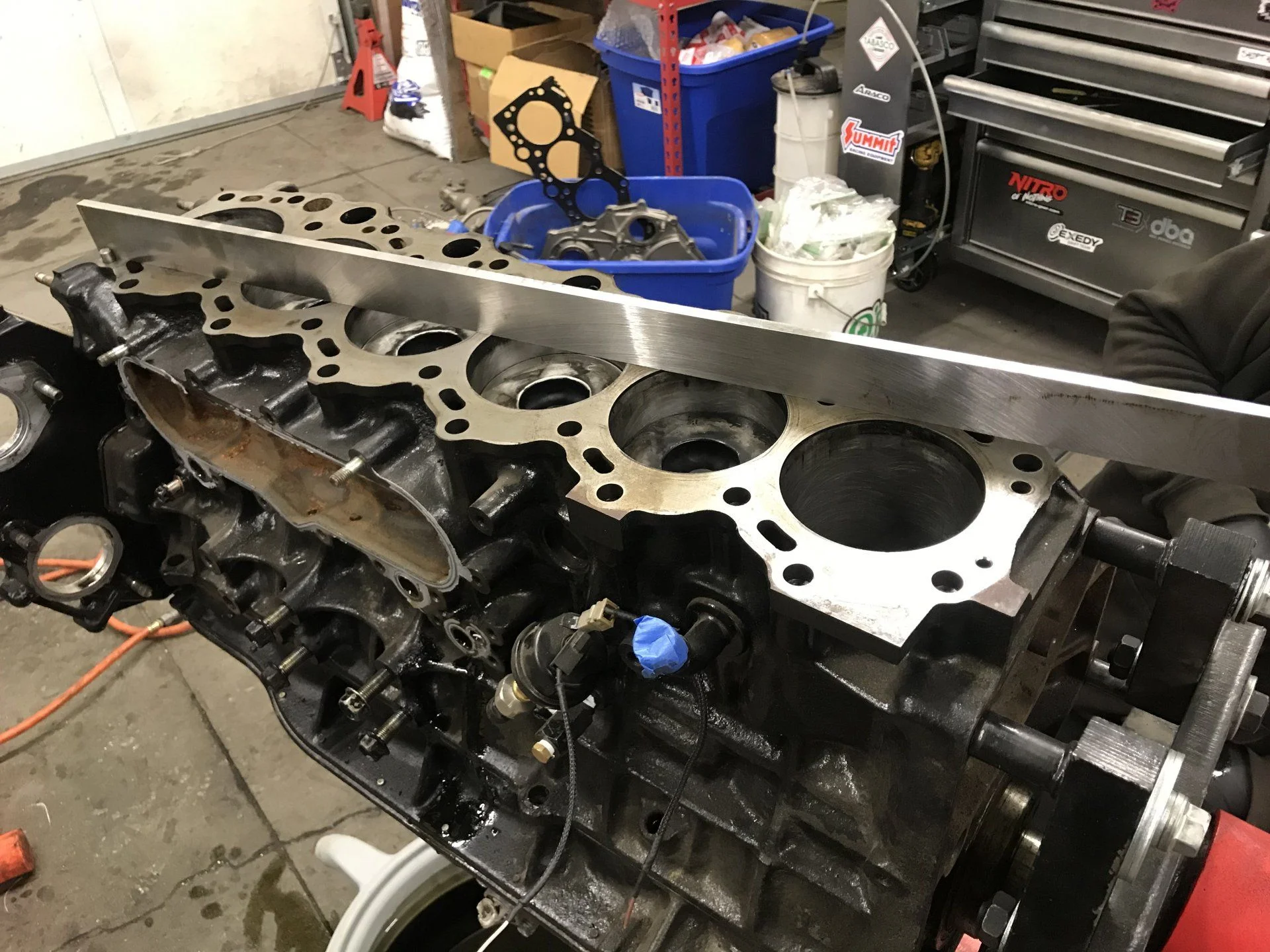

The top of the block checks out and is within specs.

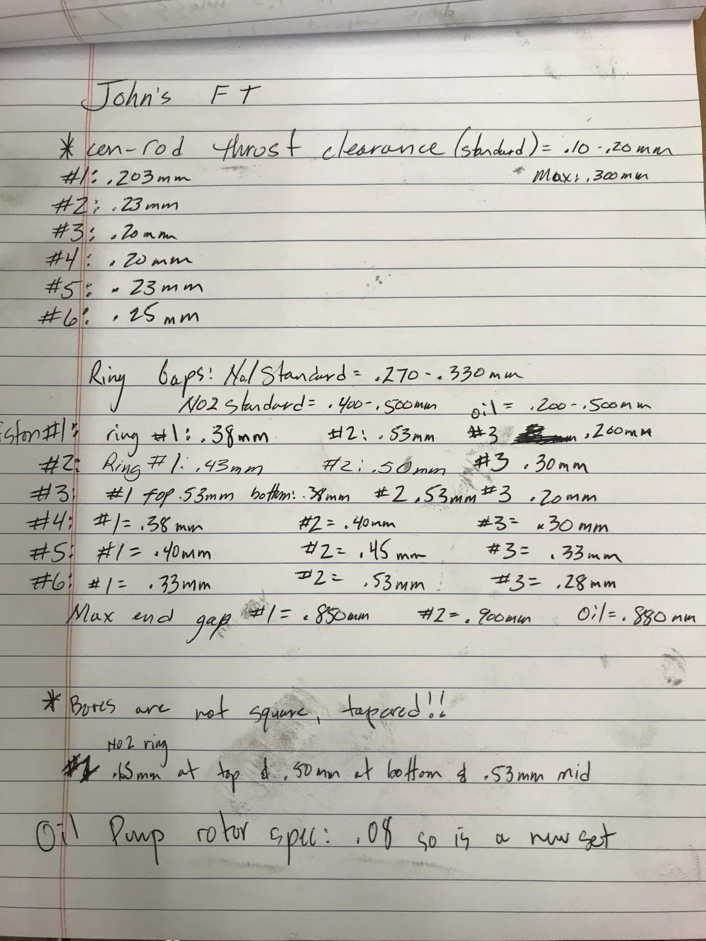

Here is our conrod end play numbers and piston ring numbers, all tested as per the FSM.

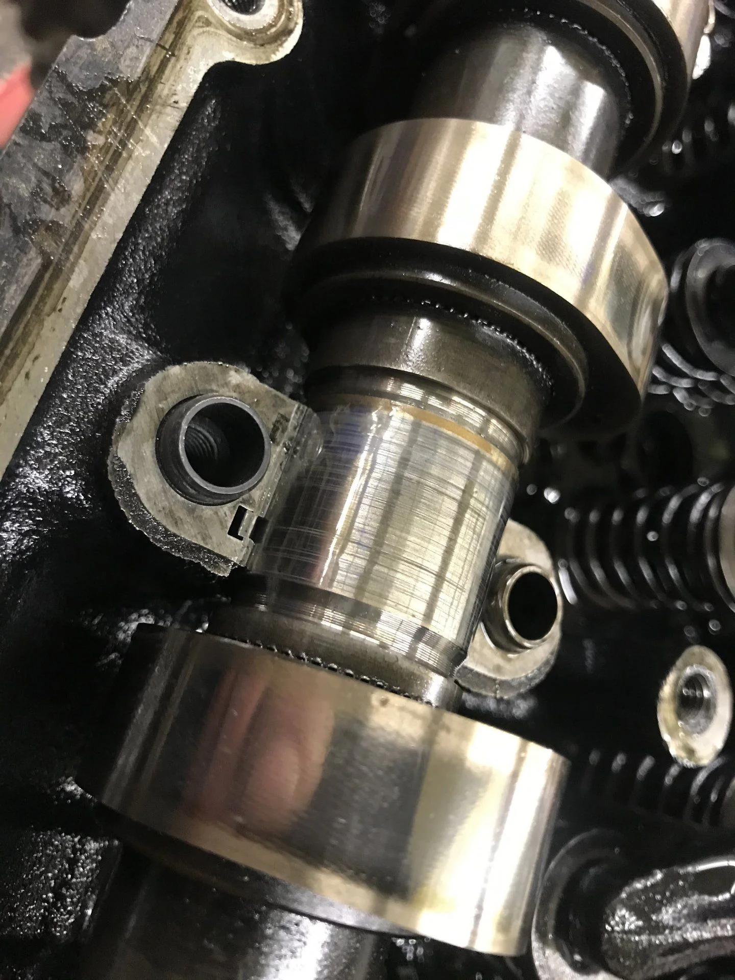

So the conrod end play is within specs but is on the low end of the specs. The rings are within specs but are all over the map, this is just end gap test and specs. Out of curiosity we checked the rings bottom, mid and top of the bores, you can see some of that in our notes. What we found is the bores have a slight taper to them which shows they are at the most hand honed. That is normal wear and tear but not what you expect to find on a freshly rebuilt engine. On top of this we have the scoring in the bores and in the piston skirts, we believe because there was debris in this engine upon and after assembly. There is also scoring on the BEB, less than cam caps but still there. The crank did not receive a polish or anything else. The oil pump rotor set does check out good, in fact it is probably new as the specs are at the top end, like new.
We could continue with checking specs of the piston ring gaps on the pistons, wrist pins, piston bores and so forth. The head is with my head guy and until he goes through it we won’t know what he finds.

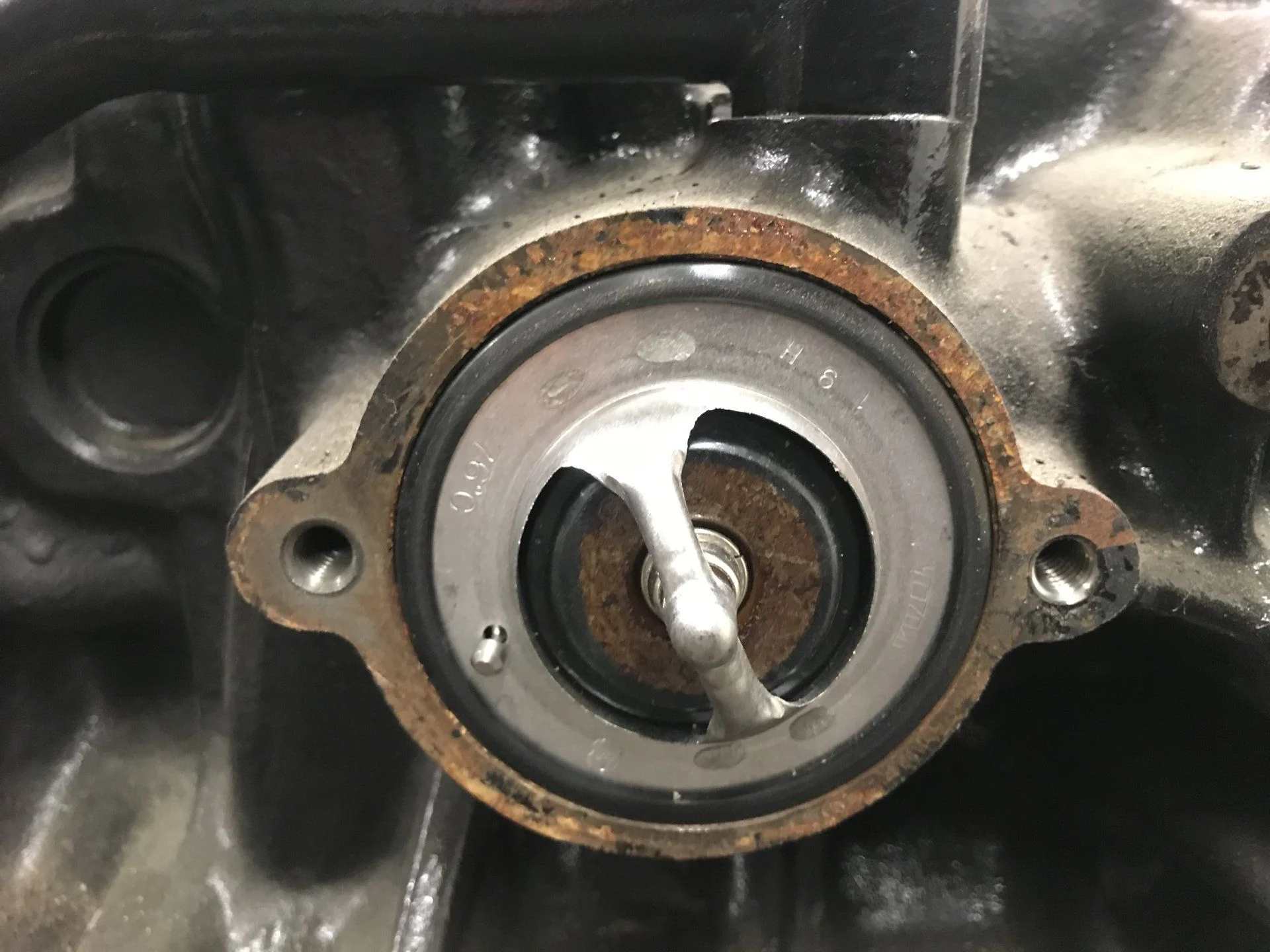

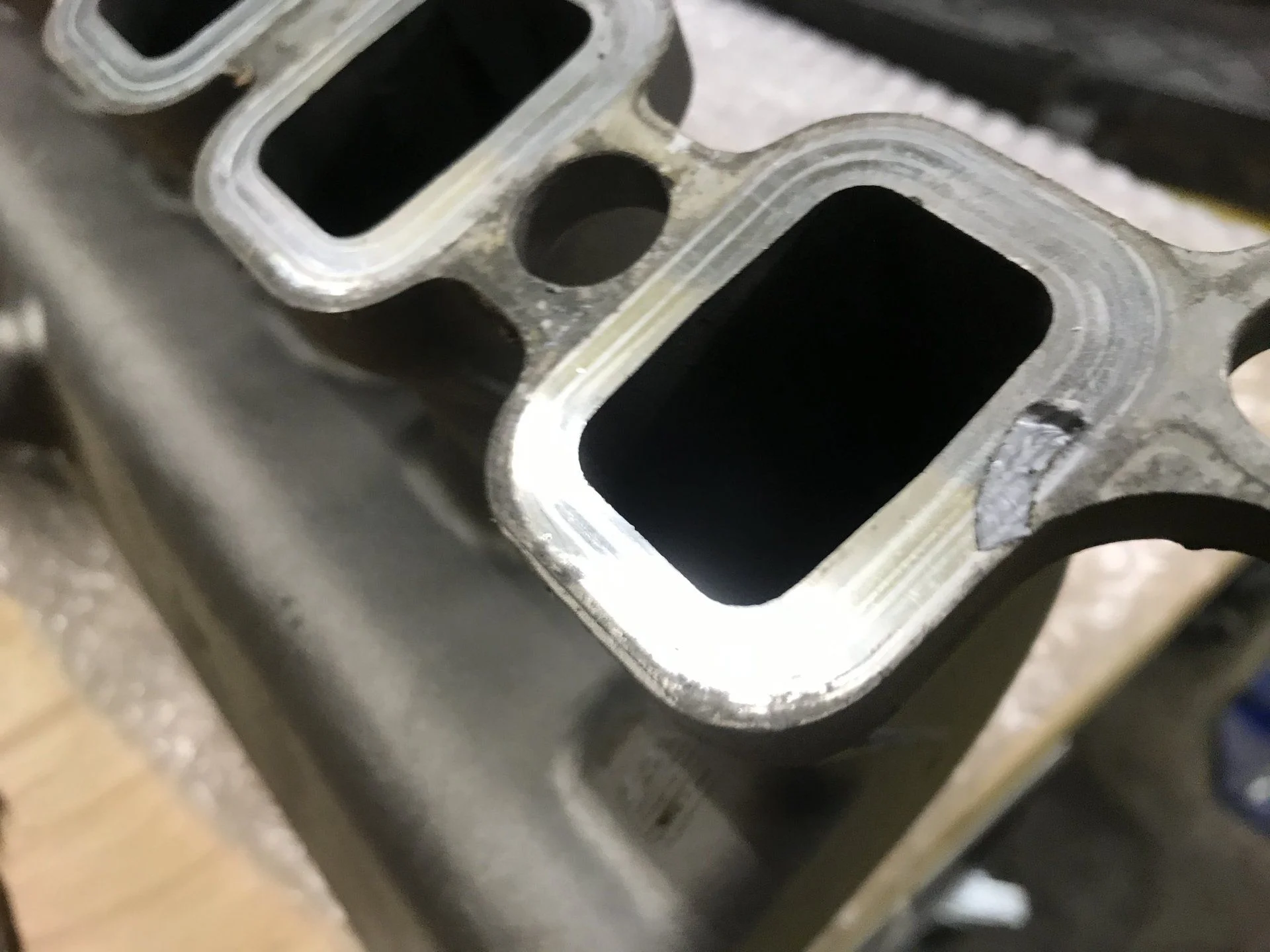

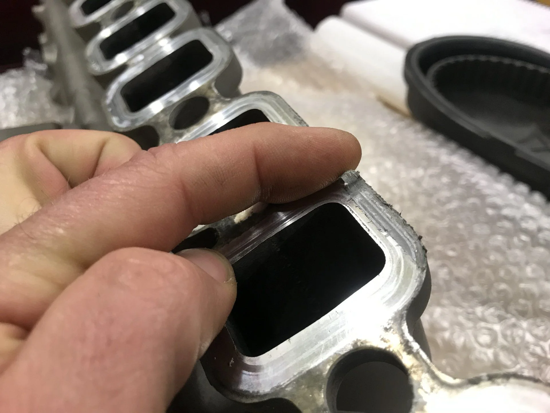

These pics are just to show general overall lack of attention to detail and sloppiness. If you don’t know John, he is the kind of guy who never wants to cut corners and he always wants it right and he is willing to pay for it. So for me, this is just sad to see.

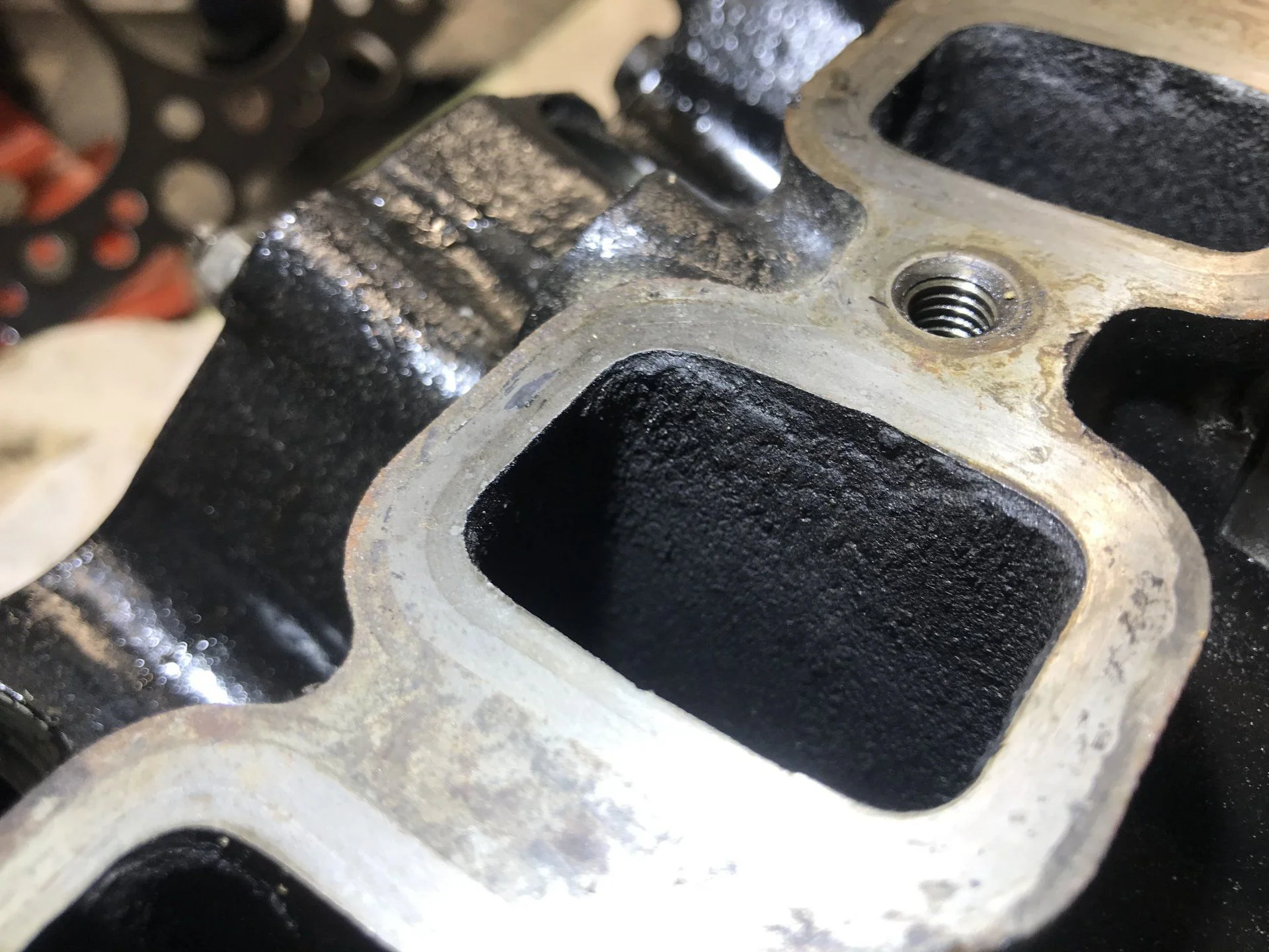

Duct tape left in intake manifold mating surface after painting.

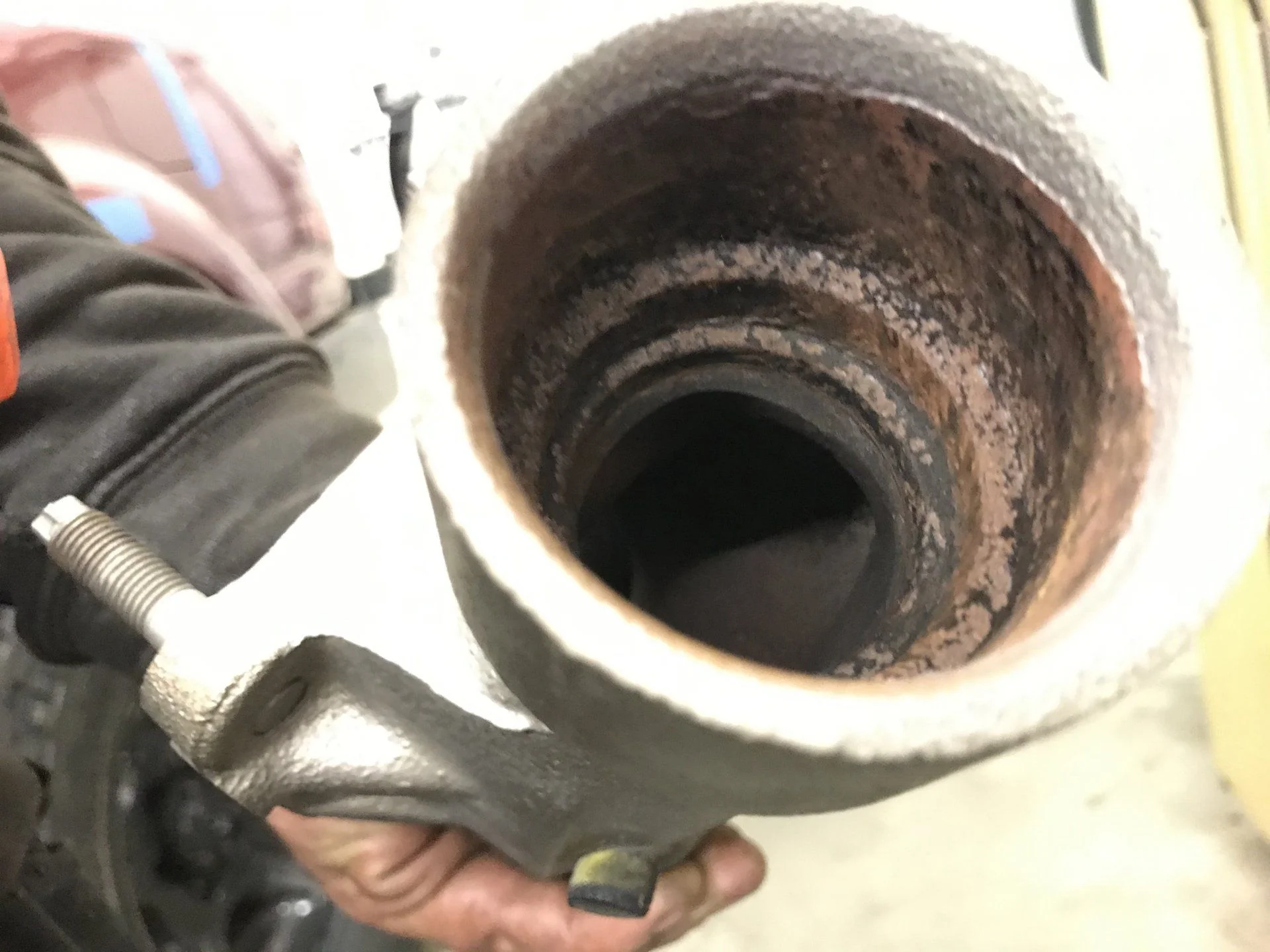

Exhaust manifold not cleaned out properly.
Thermostat not installed correctly, hole is supposed to be up top.

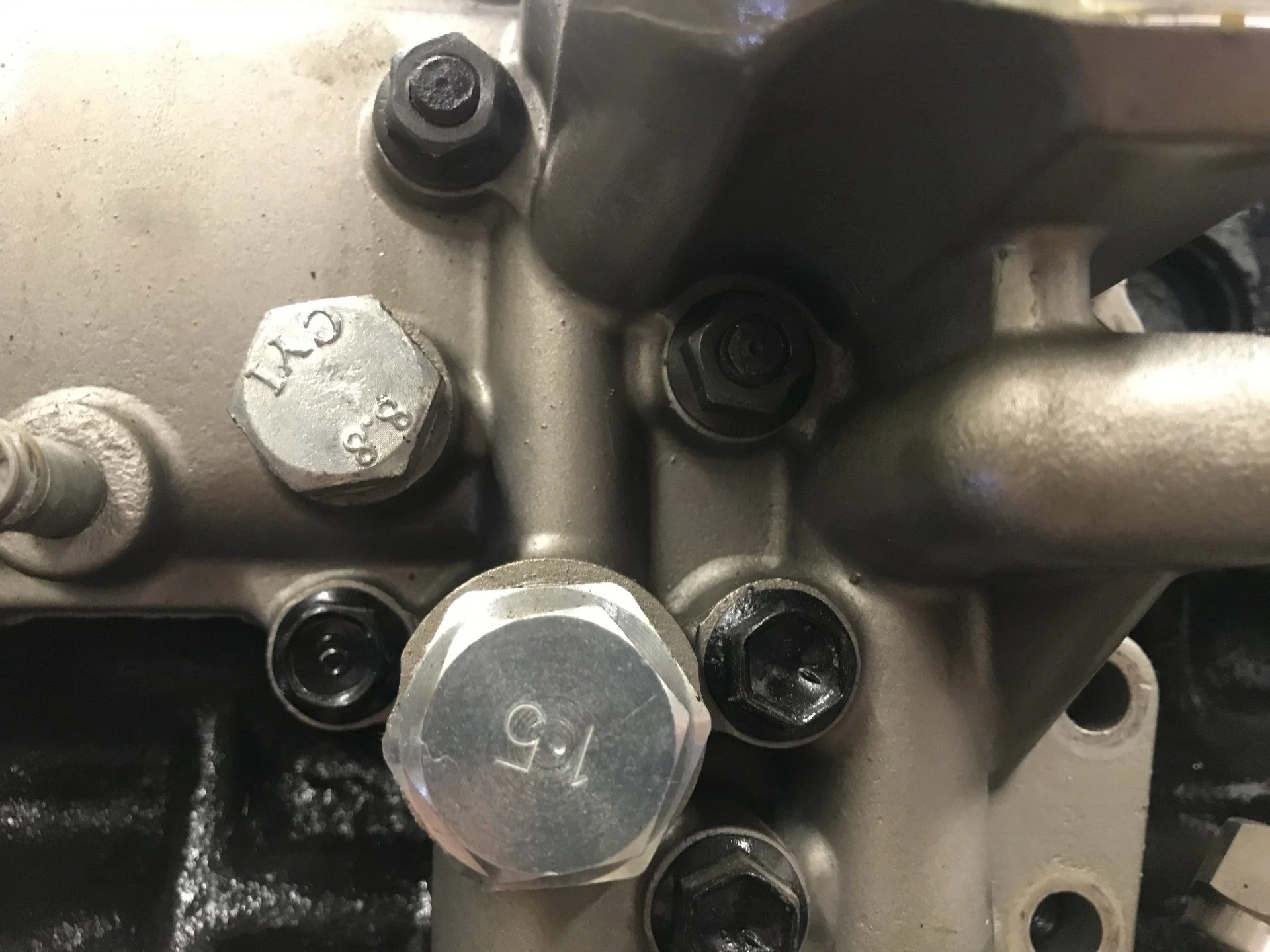

Hardware store bolt where there should be a OEM plug on the oil cooler cover.

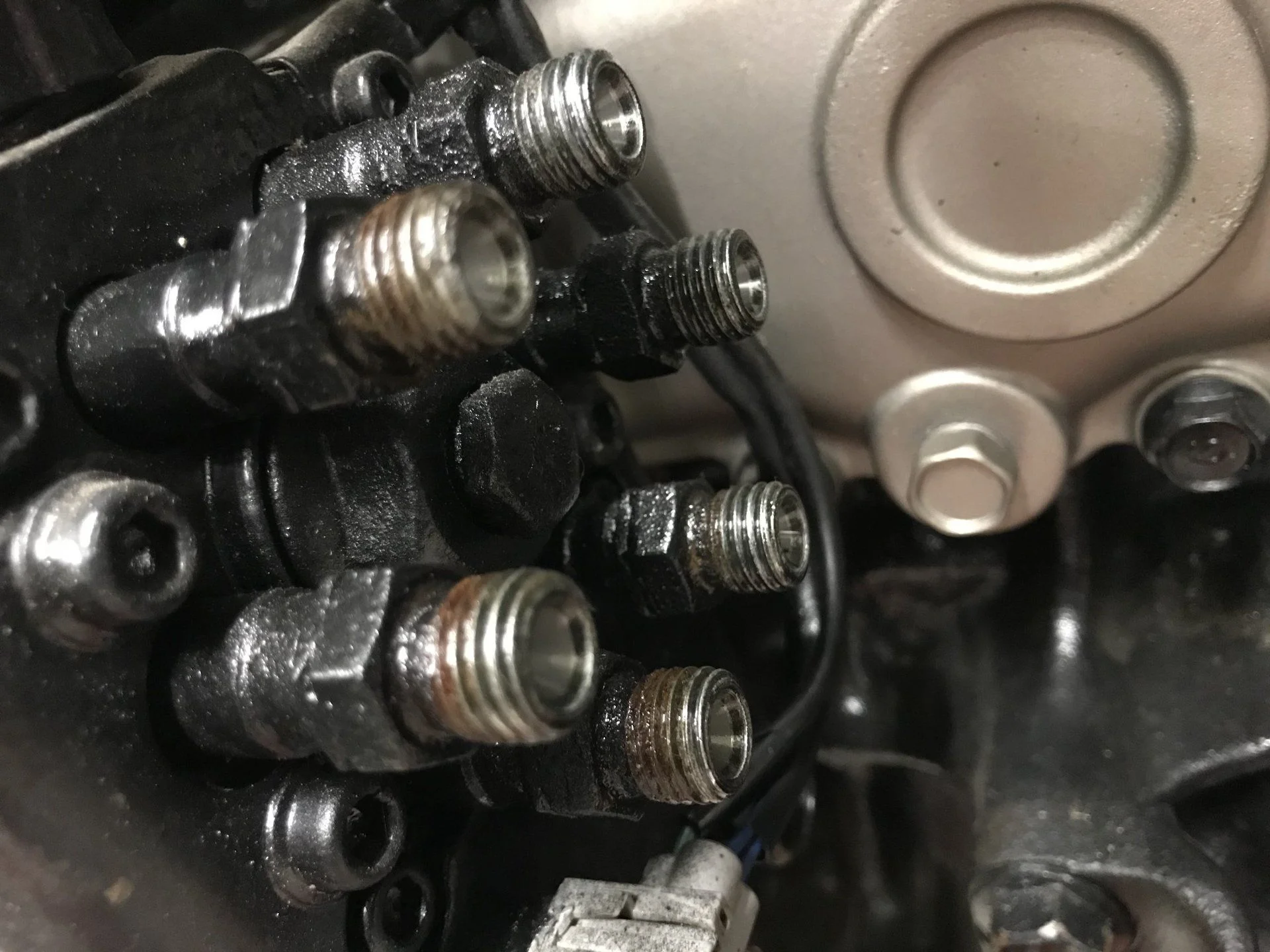

The injection pump was supposedly rebuilt, I am not even saying it wasn’t I am just showing what we see.

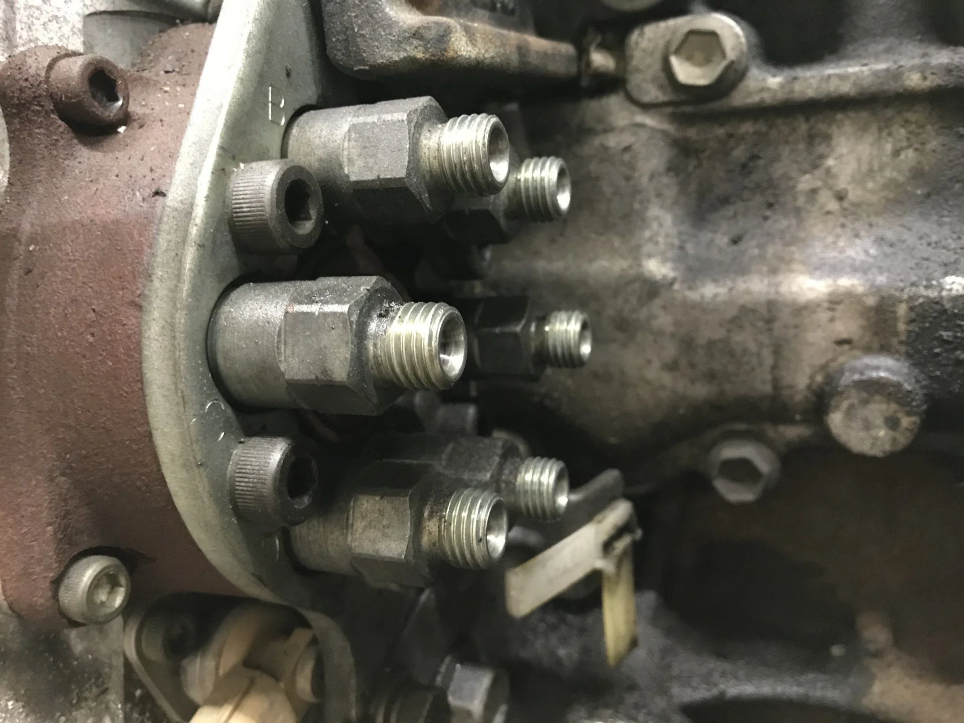

Here is the IP on another customers FTE that we believe has never been touched.

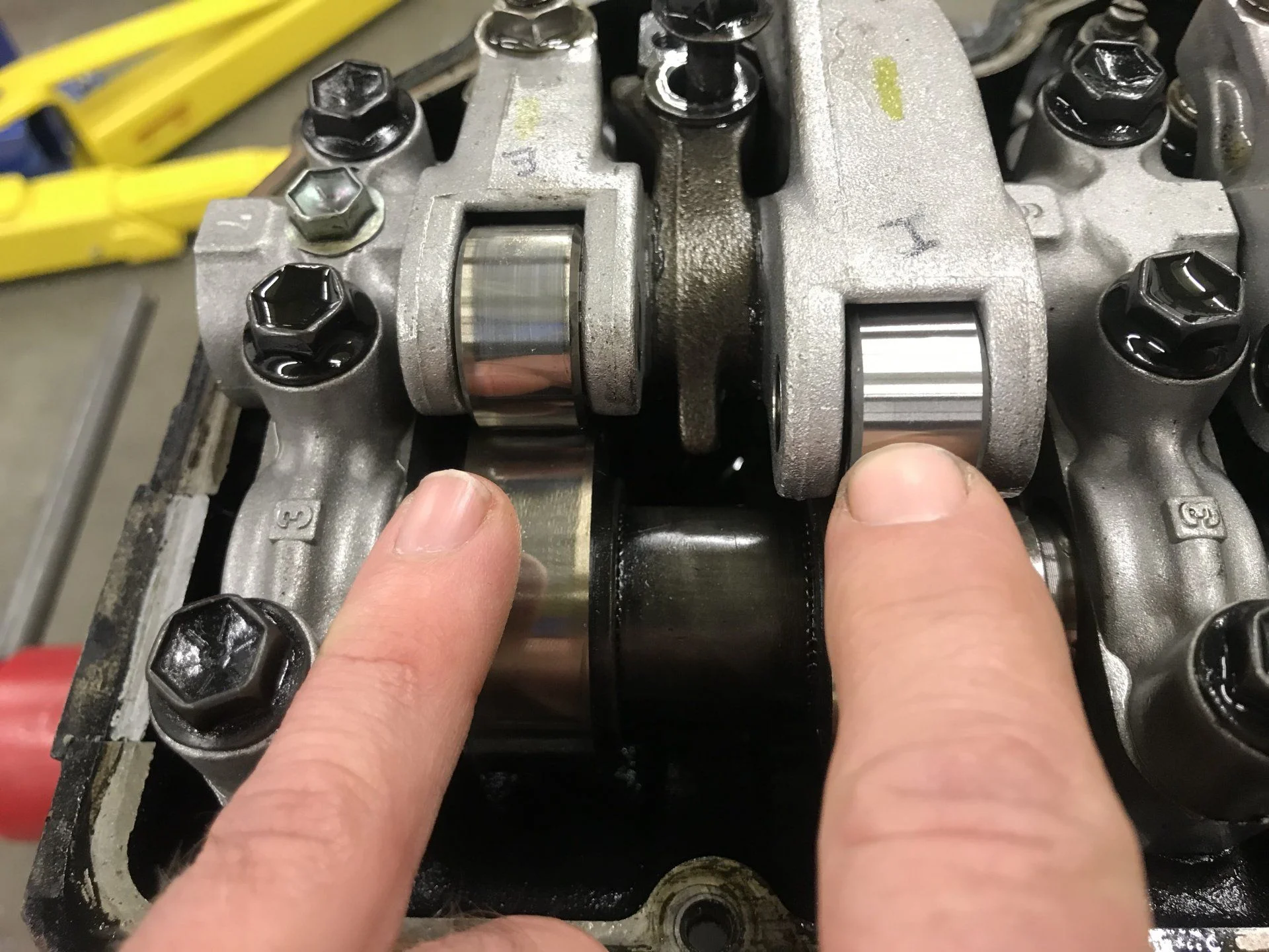

On the head, the large roller arms on the rocker appear replaced but the small arms do not.

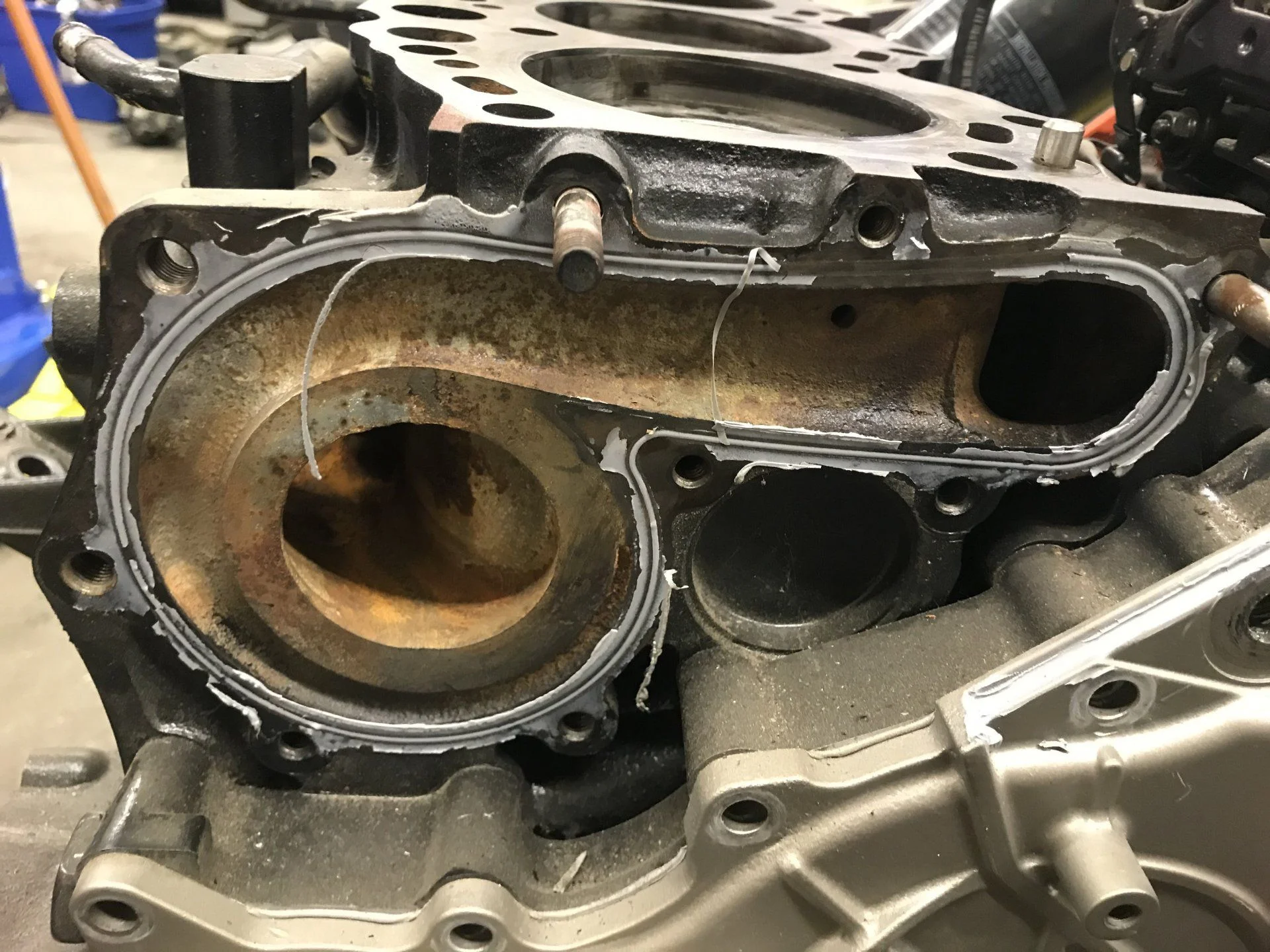

The water pump, oil cooler cover and spill tube all had silicone on them. Why??

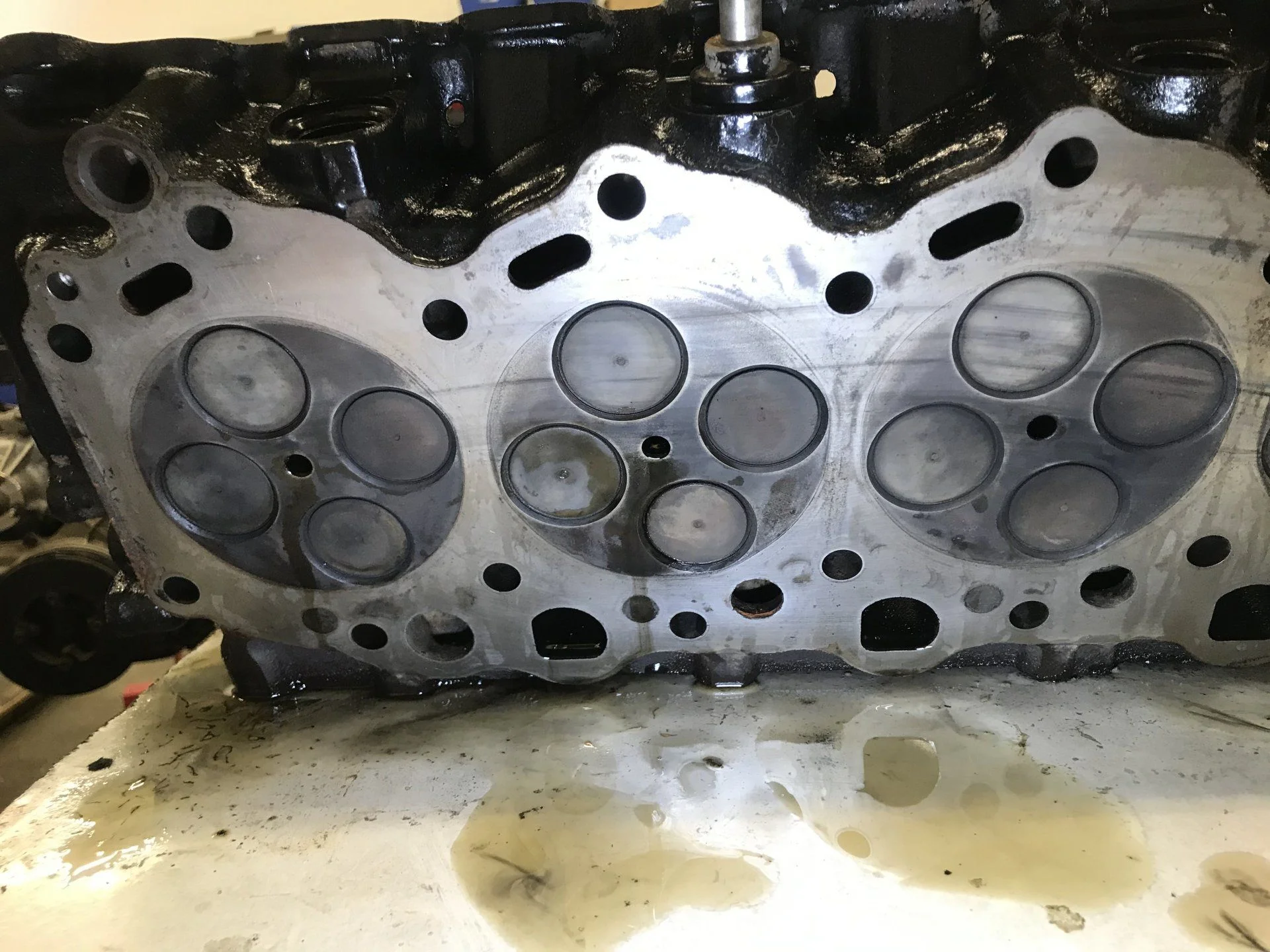

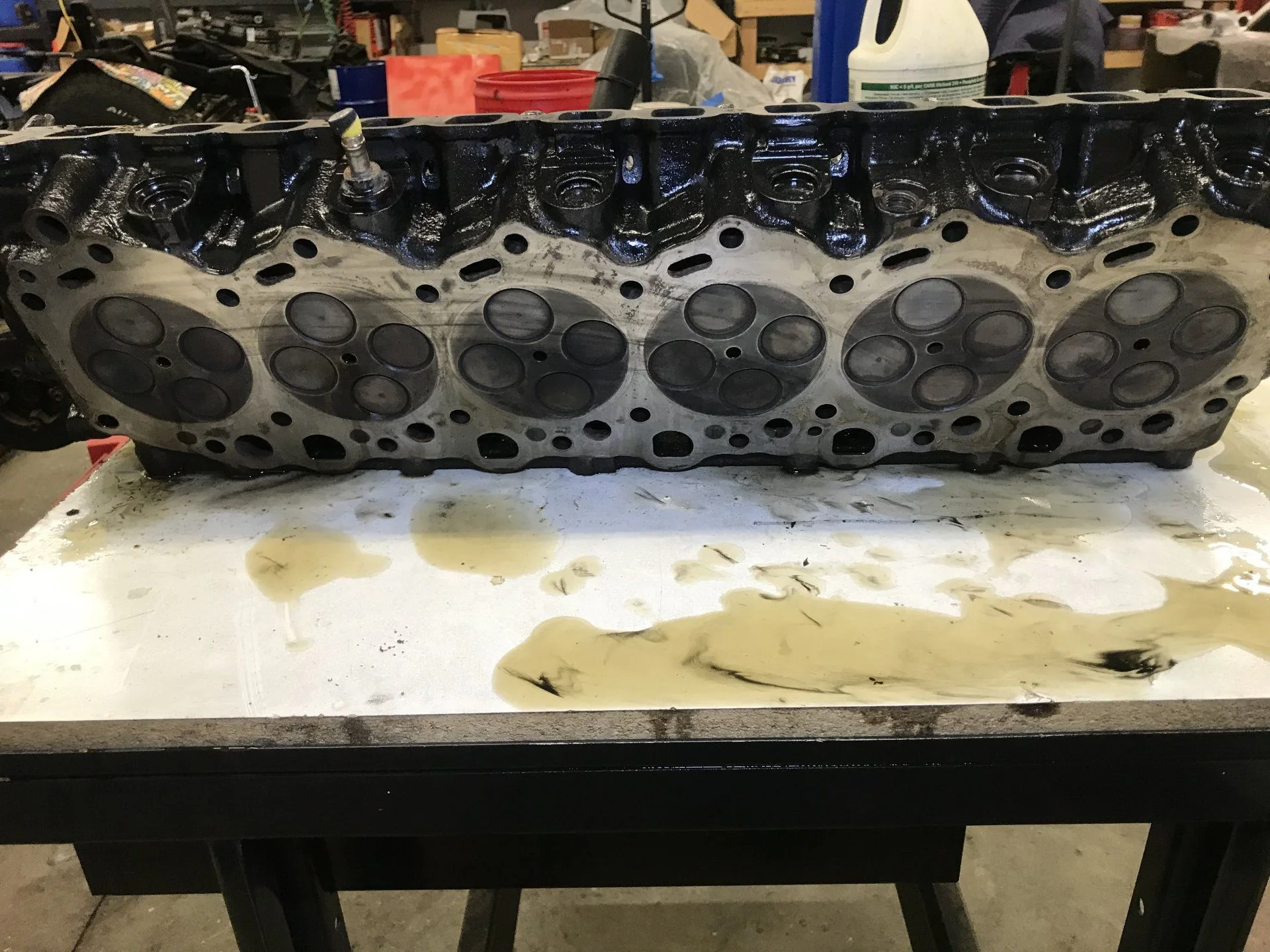

The head, like I say more to come on that in a week or two.

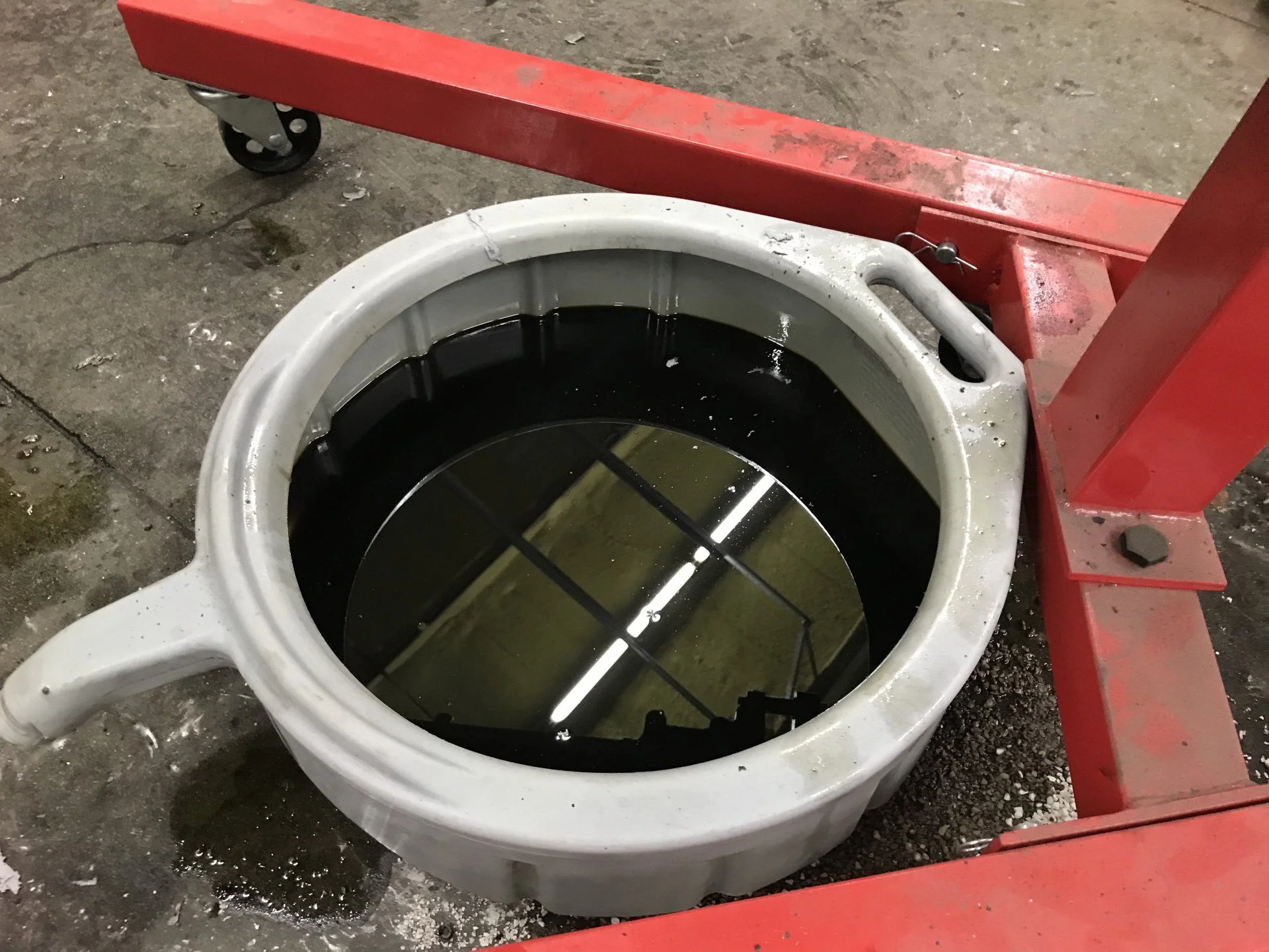

Oil after 2 minutes of run time since rebuild.

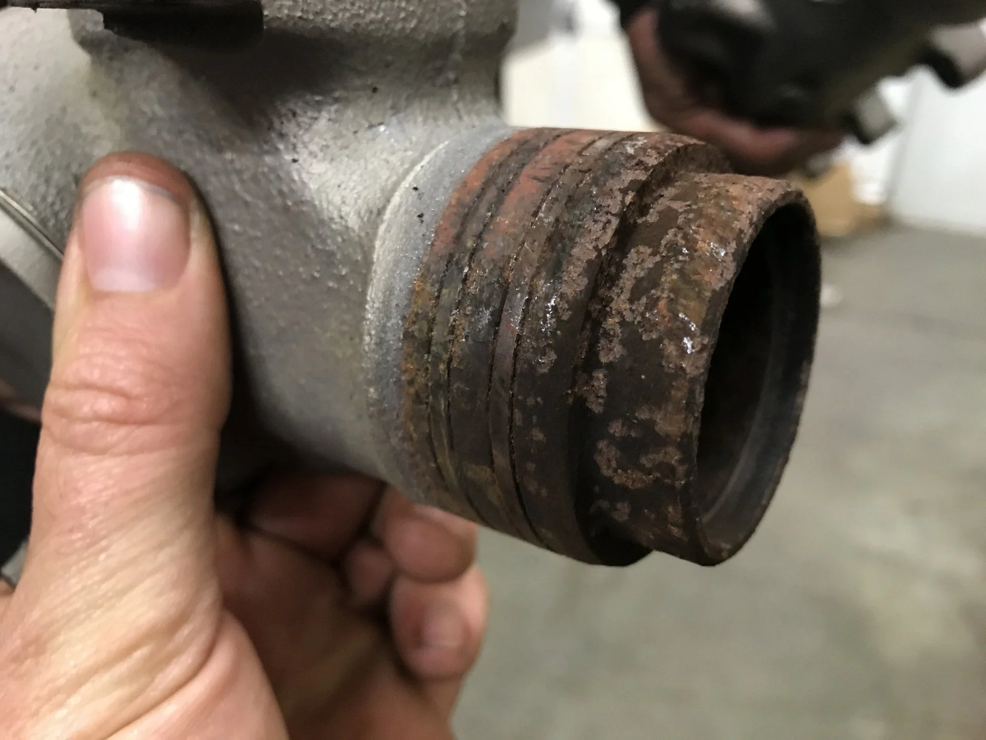

Exhaust manifolds is a two piece design, it obviously was not separated, rust removed or new gaskets installed.
