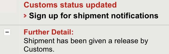

Friggin government just wanted their taxes. Hit us with some duty today, paid them and it’s released and coming our way. 😛

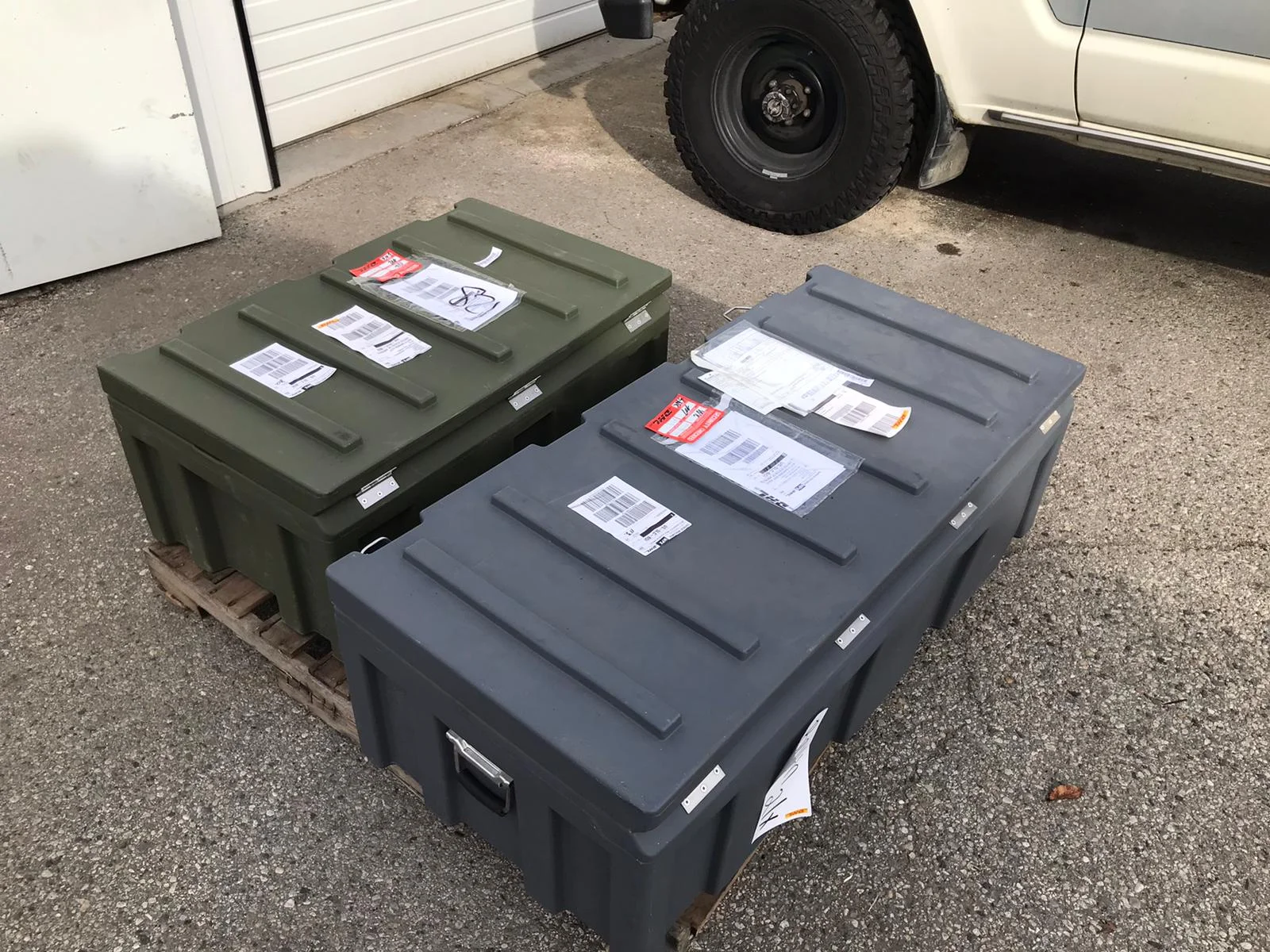

This happened today. We now have a complete HDJ80 manual transmission cluster. With 0 miles
My banker also informed me that she is now the “go to” person at my bank for currency conversions and international wires. Sent a lot of yen to Japan today for a brand new FTE short block. Hard time finding it but it’s been located and should be heading our way via DHL express in a day or two.
