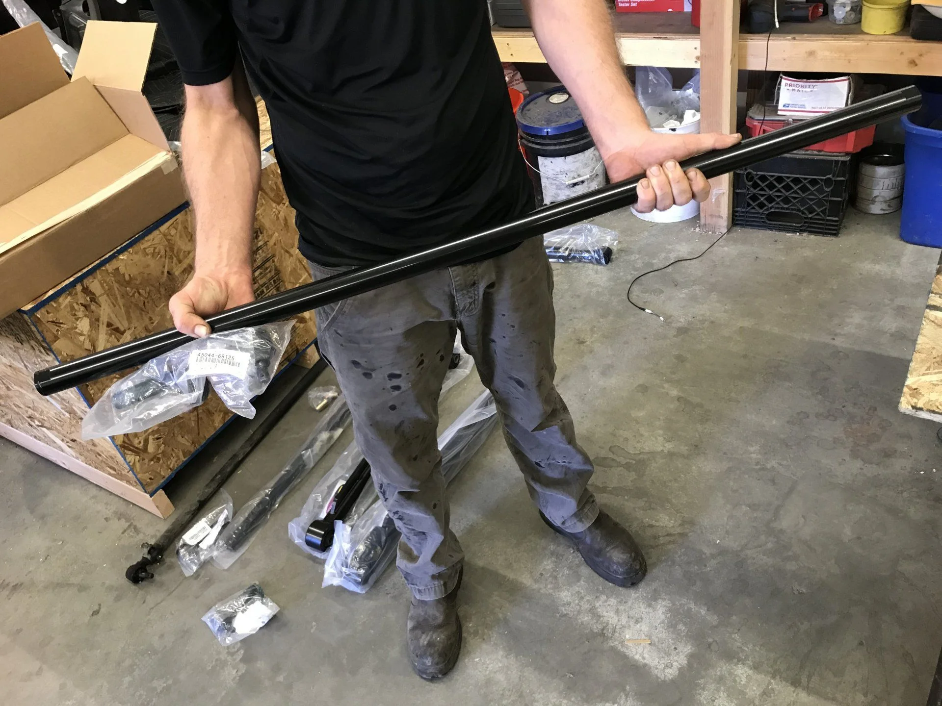

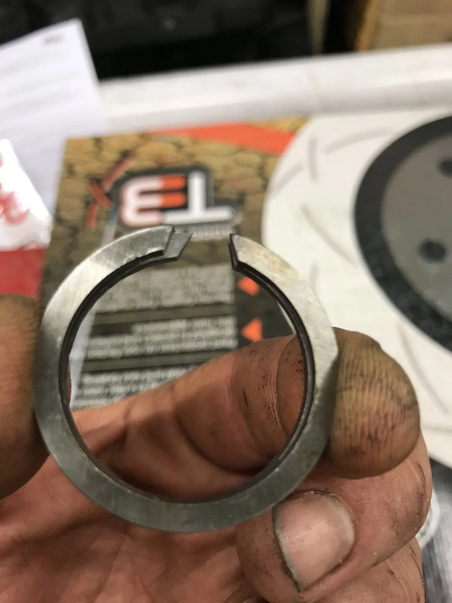

The axle c-clips, old vs new.
You can see the old is “stretched”. While I don’t feel this is a huge deal, it’s the little things that make a difference in my opinion.

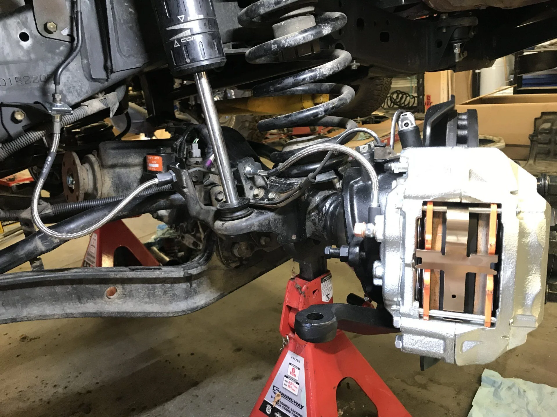

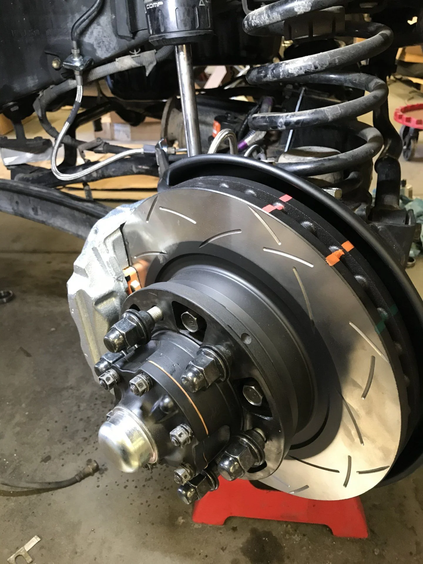

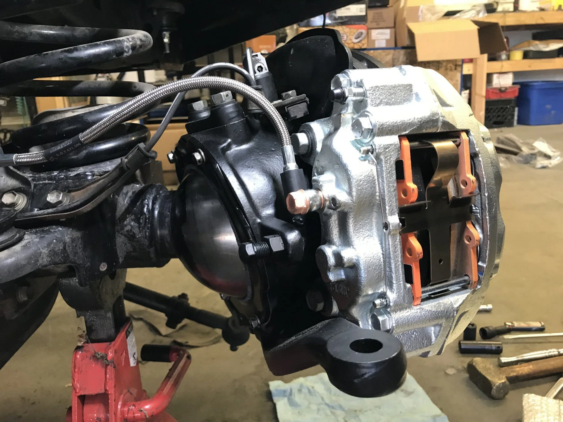

Replaced brake caliper bolts and obviously the brake line at caliper bolts.
Front brakes and brake lines all done.

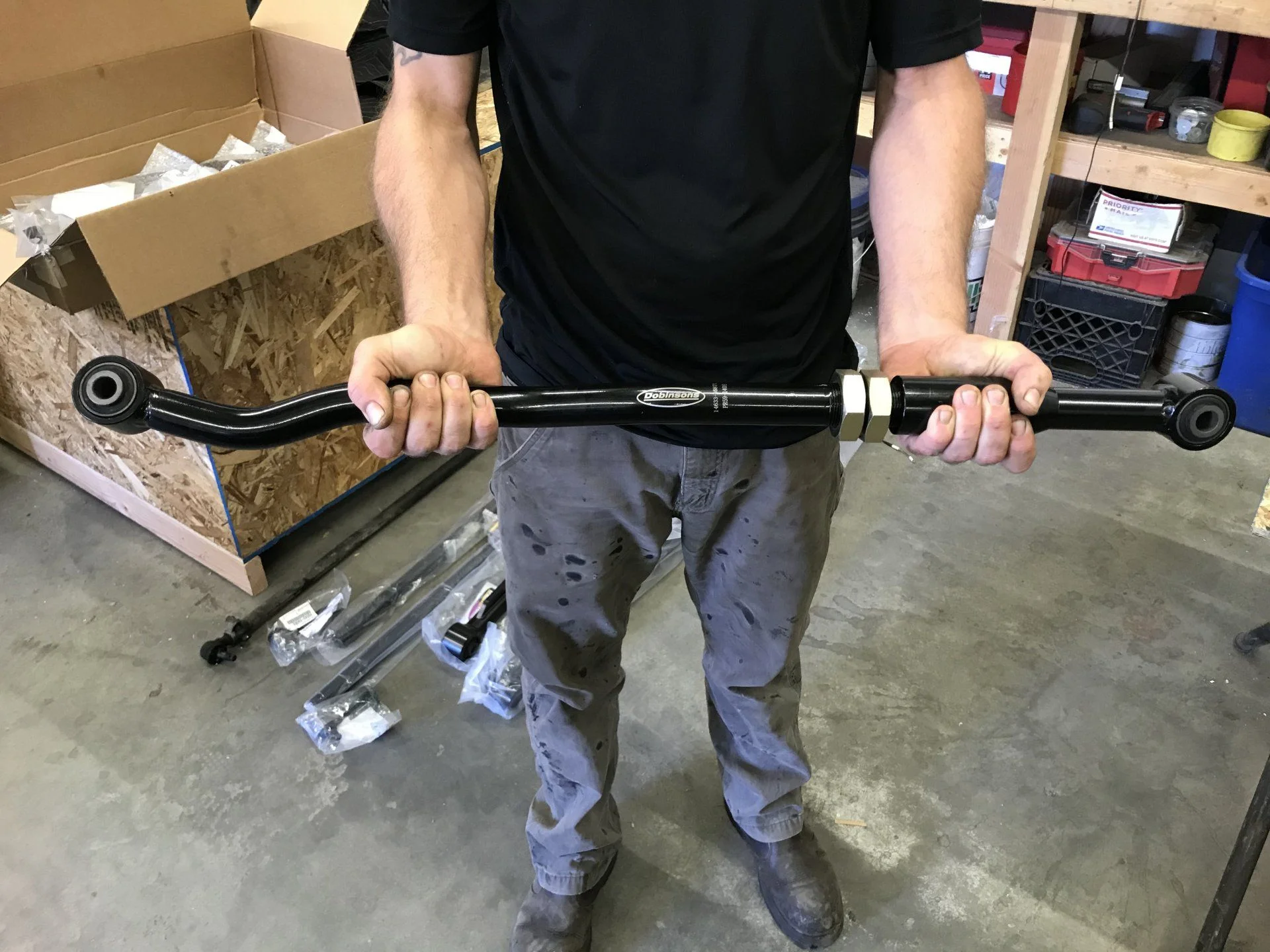

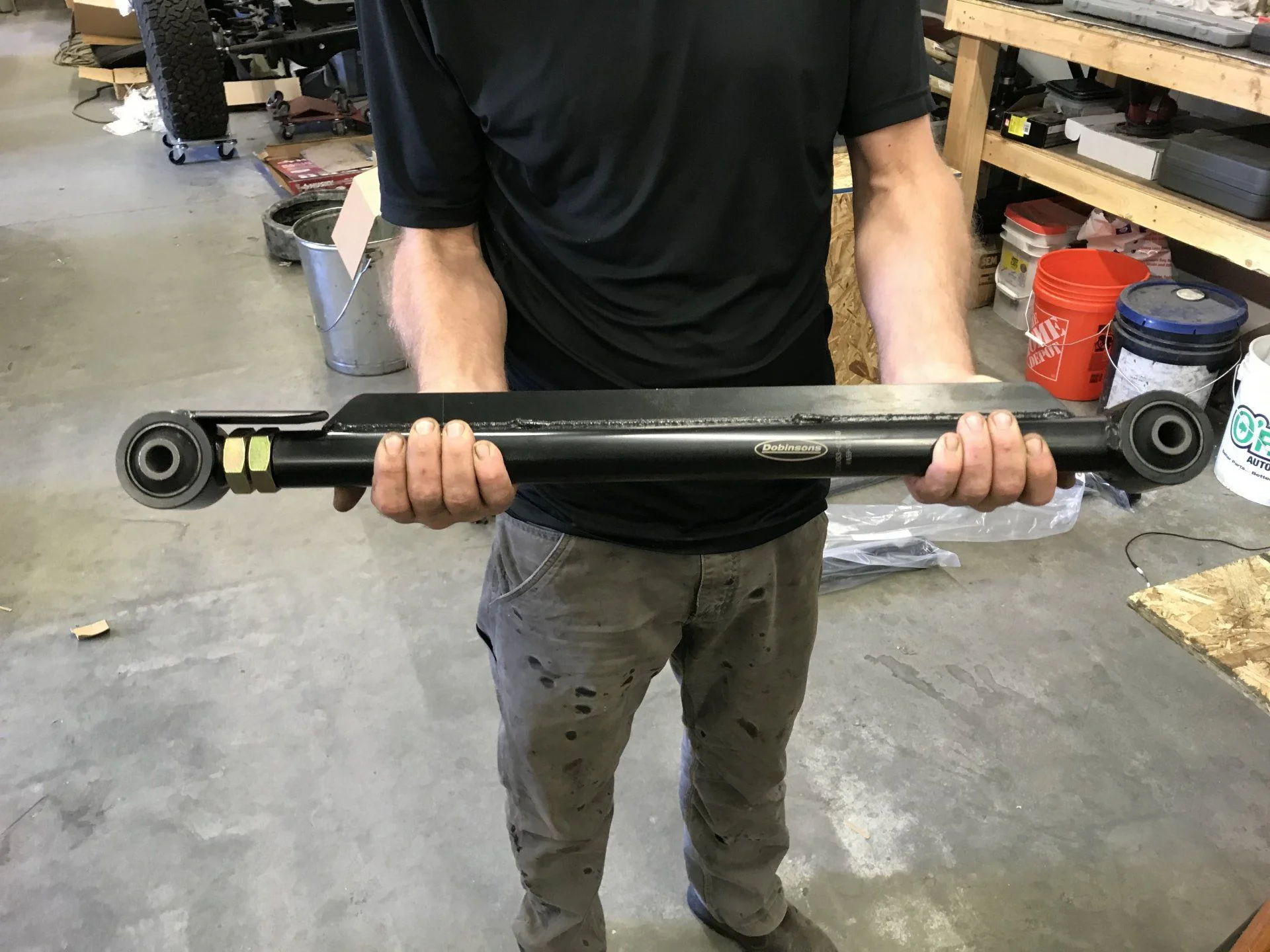

Dobinsons adjustable panhards, Dobinsons rear lower control arms and SLEE heavy duty tie rod & drag link.

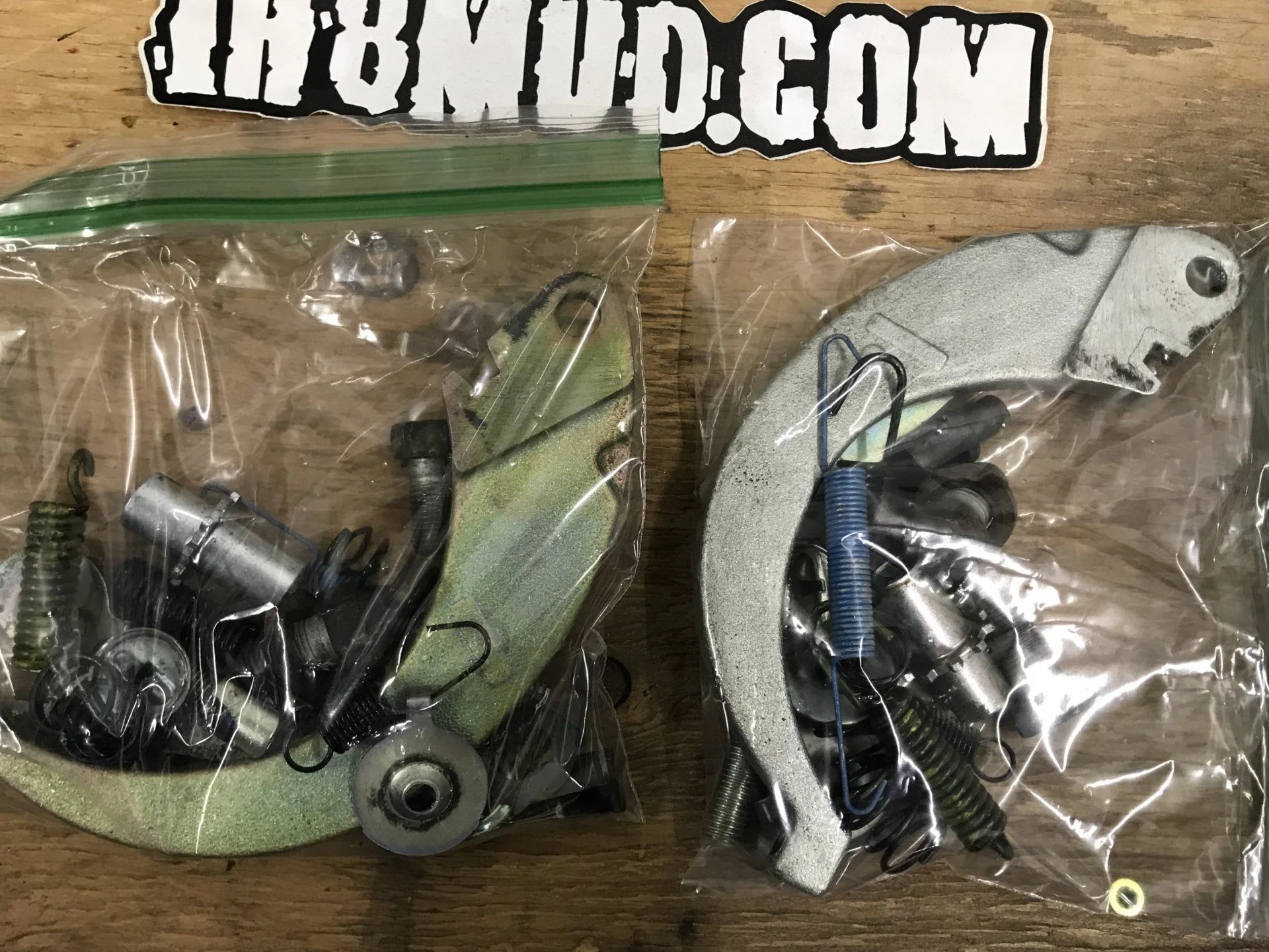

Rear ebrake torn down, all parts cleaned and ready to rock and roll.
Still need to clean the backing plates and pull hubs for rebuild.

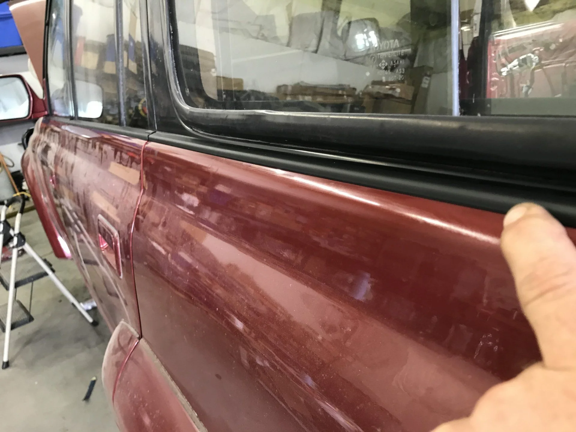

New window squeegees installed all around.

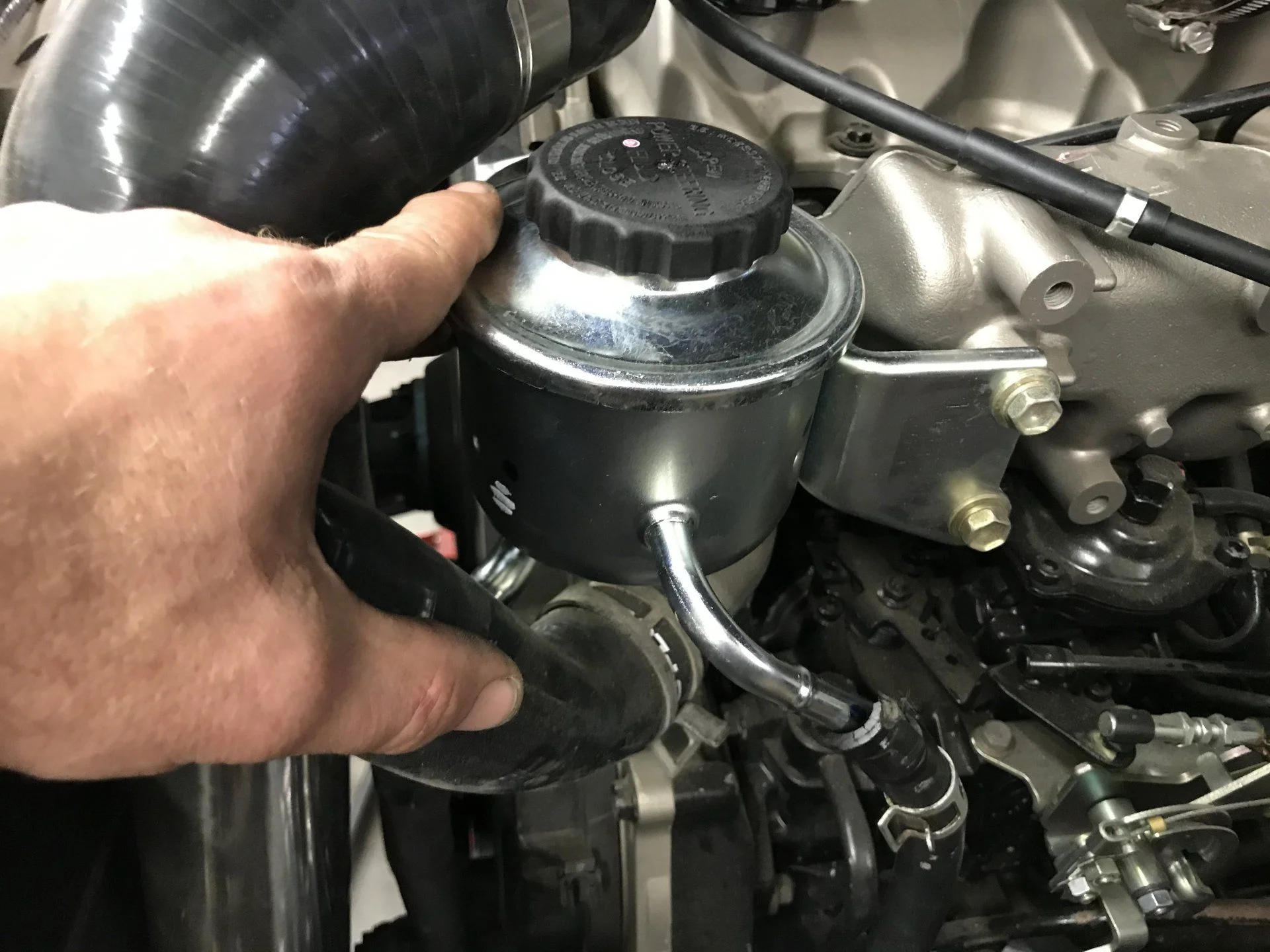

New P/S resi installed today.

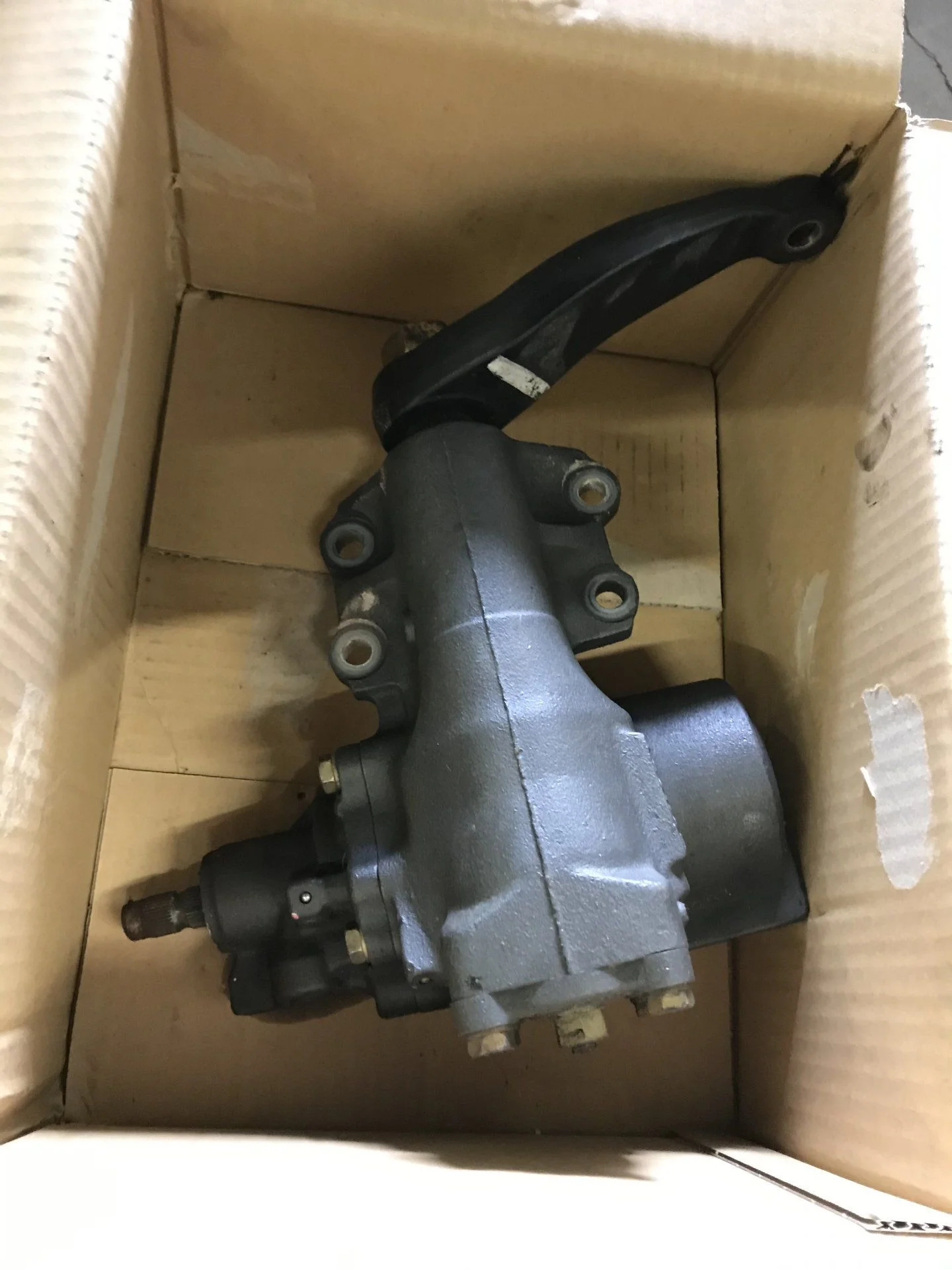

Steering box pulled, we got 105 upgrades coming and then it is off to RedHead for the full meal deal. 😁
Cheers
want to trade that one for a box that doesn't look brand new? :lol:
