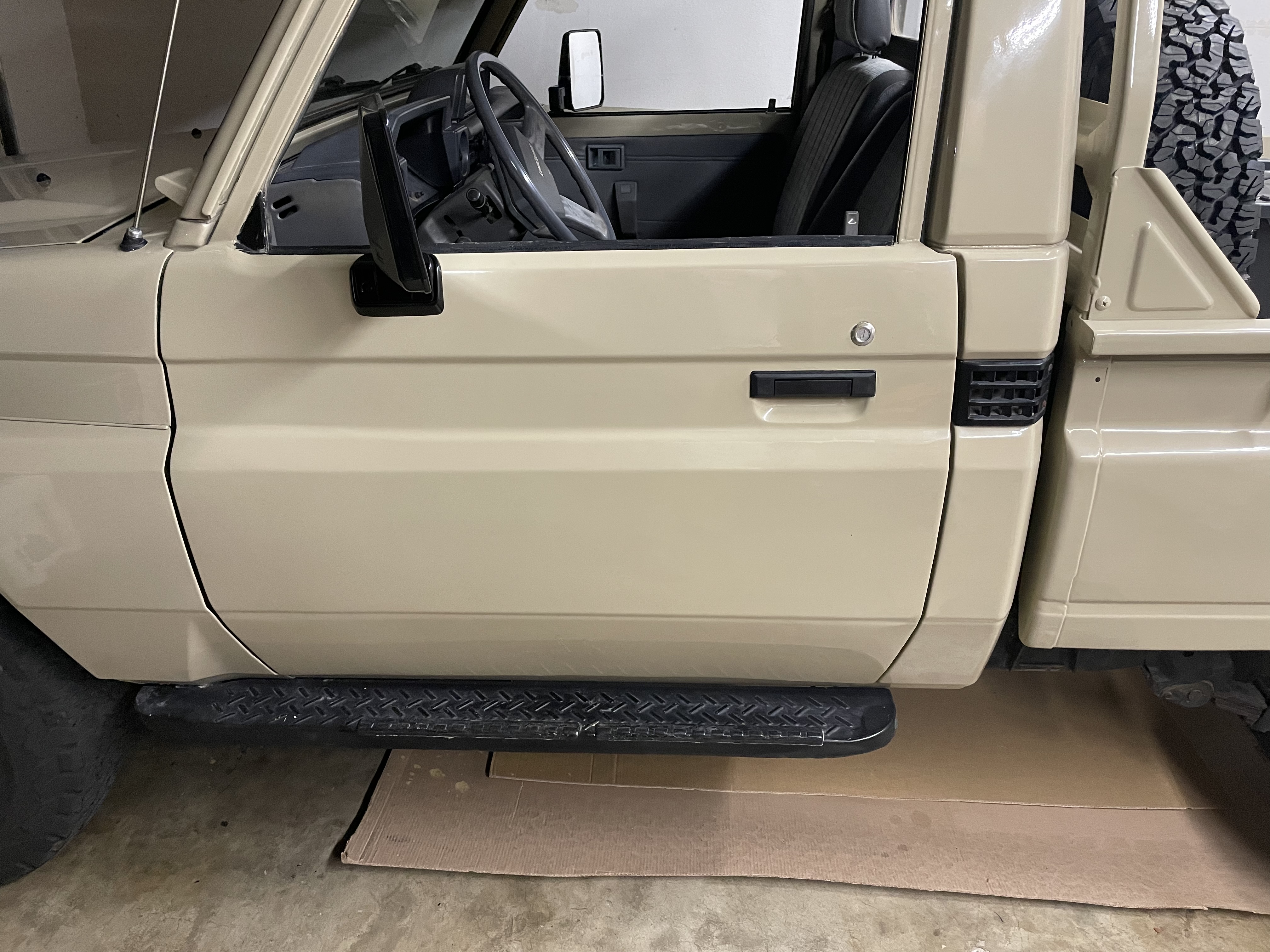

When I first purchased the truck, the interior and exterior door handles were the wrong color. The PO had just swapped brown for the interior door handles, and the exterior chrome handles had been oversprayed with beige because they didn’t mask anything off.
I hate chrome, but I really hated the oversprayed handles.
Today I swapped to the “correct” colors. These are just cheap made-in-Taiwan replacements for a 1st gen 4Runner, but they work and look 1,000x better IMHO.

I had considered plastic dipping my chrome door handles but I think you just gave me a better idea. Gonna pick me up a set of those.

The interior door handles are for a 1995 to 2000 Toyota Tacoma.
EBay Interior Door Handles
The exterior door handles are for a 1984 to 1988 Pickup, or 1984 to 1989 4Runner.
EBay Exterior Door Handles
I found them all on Ebay. They come in a variety of colors.
I also ordered window cranks using the same strategy. Mine cracked when I removed them to install the door handles.
NEW PAIR Window Crank Lever Handle GRAY FOR Toyota Tacoma, T100, Pickup, Corolla | eBay - https://www.ebay.com/itm/234041512328
The lock knobs are available as well.
Pair Door Lock Knob Surround Pull Fit Toyota Hilux LN85 LN106 LN111 1989-95 EZ
Awesome. Yeah, I had seen them before, and considered buying them, but wasn't sure about fitment. Your post solved my concern!
Full disclosure, my exterior handle installation did require opening the mounting holes on the steel door skin about 1/16” with a grinding burr.
I expect this was due to body filler used on the door during repaint, and tolerances in the manufacturing process for the cheap door handles. It didn’t bother me, but wanted you to know.

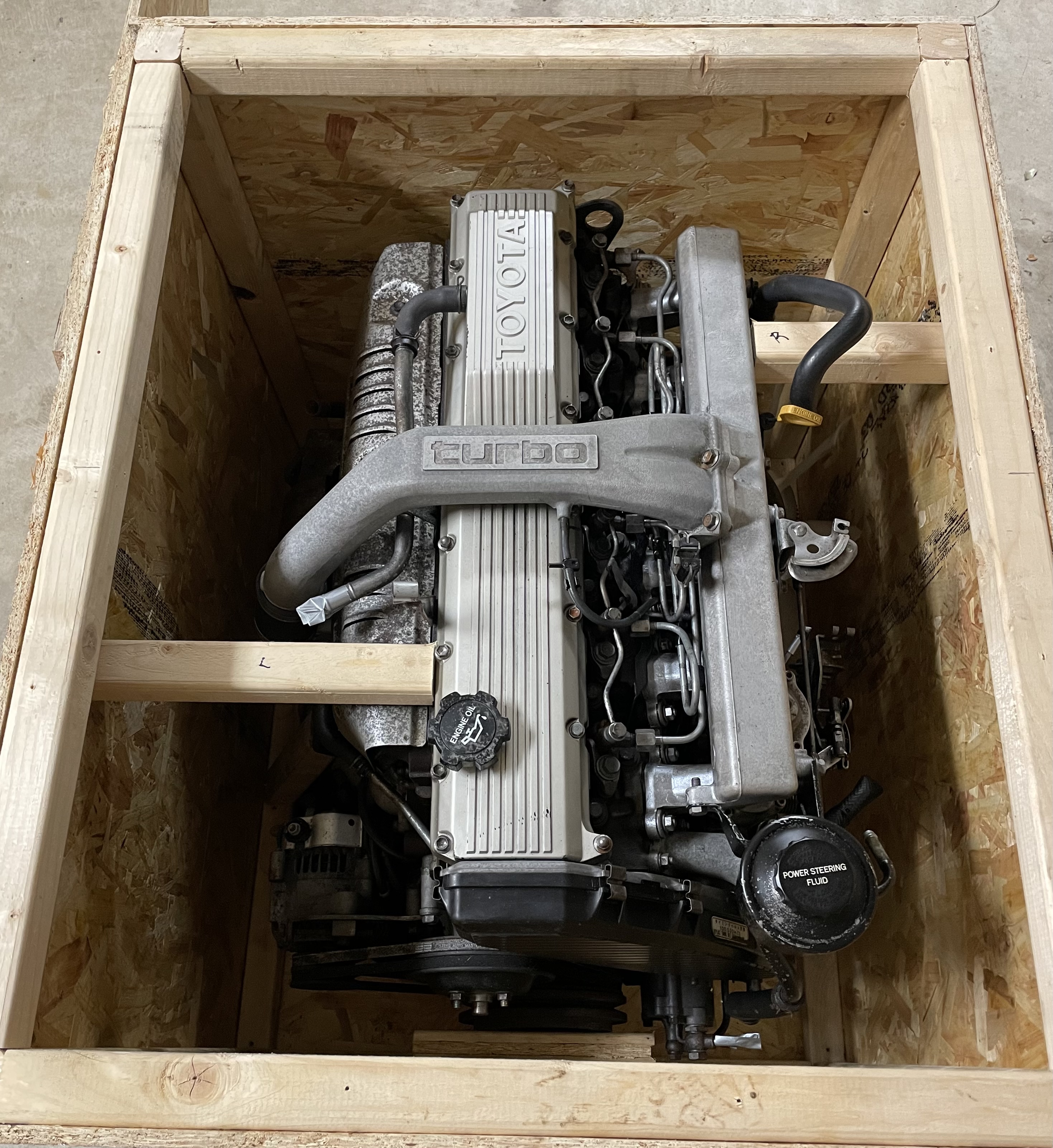

You can know the exact date of manufacture by looking on the RH side of the engine block, back by the #6 cylinder and you should see some numbers. Same with the bearing retainer, which will be up front by the oil pump case. They should be within 6-7 days of each other.
The freeze plug at the top of the block below the head should have a handwritten date on it-- if it's still there. That will be the month day of final assembly. That's the final freeze plug they install into the block.
