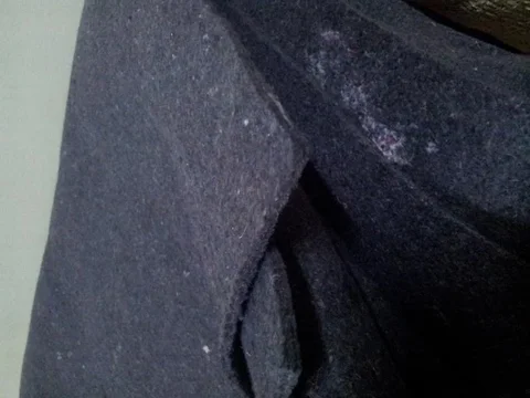

the so called Wool insulator...
hope it works to help deaden noise and reduce heat
the guy said its fire resistant and semi water proof.....so....i did a quick test....using my lighter and its great....didnt expect that when i saw the material..... will do a quick wash test on a small piece to see how water proof it is...but in any case....our Sun here will dry anything out.....add water and our HOT summers.....and i end up like im plate in a dishwasher...loooooool
made up of two layers with a very thin layer of something in between....not so sure its clear in the pic...but take a look at the corners....very light weight....and very strong surprisingly.
