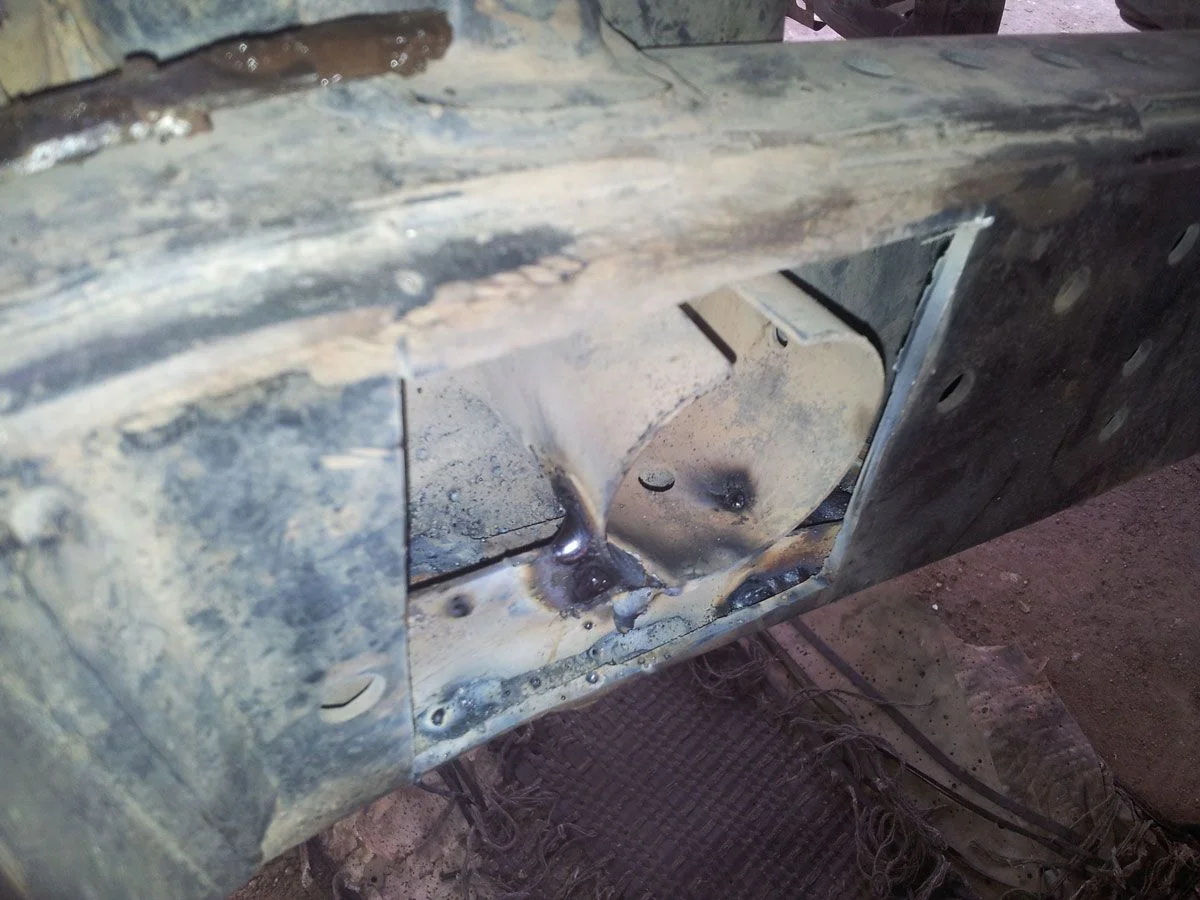

here is the current state the weld on the chassis is at...
he said after filling the inner weld...he will re-open the old 'external' weld , drill holes at the end of the crack and then weld again.
does this sound solid @BILT4ME ???

I am a little disoriented on the picture, but obviously, he has used a cut-off wheel to cut a hole in the frame to access the interior parts. This will allow him to weld the cracks from the back side and to weld in the cross member from the inside. On the next plate he cuts out, have him drill (4) holes in the corners of where he wants to cut out, then run the cutoff wheel into the drilled holes. Square (or "pointy") corners cause a stress point. On the current cut-out hole, have him radius the corners of the HOLE before welding the plate back in.
It appears he is going for full penetration (FP) welds by welding from the back side as well as the front side. However, he will not be able to weld the cut out plate from it's back side. That one MUST be a proper FP weld.
Is the piece INSIDE the frame a piece of angle iron he is using as a backing plate? If so, that's good, he is getting a FP weld by back-gouging and welding with a backing plate inside.
The welds look like E7018 stick and that is probably the best rod for this project.
More pics always help!
@BILT4ME ... the pic is from the front of the cruiser looking down towards the left side (from where im facing) chassis..
Out of respect for the age and experience of this welder...i found it maybe disrespectful to go deeper in and take photos...
but as u described... this is what i think he IS doing...except the drilling holes for the corners of course.

I understand completely. That is a very extensive project on the weld repair and it looks like there are a number of locations. One thing you may want to consider (if it's even possible there...) is to have the frame checked for straightness. Maybe just a dream, but who knows. otherwise, you can use strings / tape measures to see if it is square with a bit of ingenuity. The you can use backyard tree mechanics and a winch / Hi-lift to tweak it into shape.

I'll admit, I was not expecting to have him cut a giant hole in the side of the frame, as that seems counter-productive...
I too was surprised to see that opening. ..but he said for that specific location. ..it would have been impossible to maintain any other way. ..because of cylindrical thing at that point (in photo).
