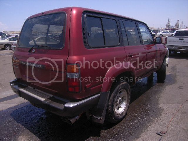

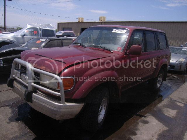

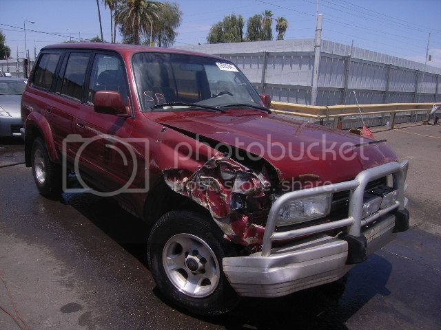

Purchased my first FJ80 from an auto auction in Arizona in October of this year. It's a 1993 Land Cruiser with 64,722 miles on it and factory lockers. It had been wrecked in the front passenger side and has a salvaged title. The auction said it started but didn't drive due to fender and bumper impacting passenger tire. I didn't have a chance to go view it in person before the auction date so I bought it without inspecting the damage before hand, just going off pictures. I ended up getting it for a good price which I thought was cheap enough to risk whatever unseen damage may exist. Here is a picture as it sat when picked up from the auction yard:

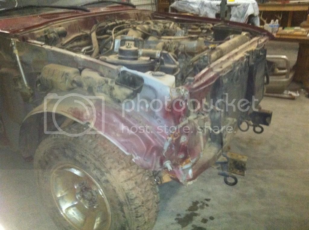

Once I got it home I pulled all of the damaged bits off and created a list of parts needed to bring it back to pre-wreck condition:
*Passenger Fender
*Hood
*Bumper
*Passenger Headlight, corner light and blinker light
*Valance
*Passenger side core support baffle
*Passenger side fender apron
*Power Steering Gear box (Sheered the sector shaft when wrecked)
*Relay Rod
*Front Lower control arm (bent)
*Axle Housing (turned out the axle housing was bent)
*Rebuild kit for axle

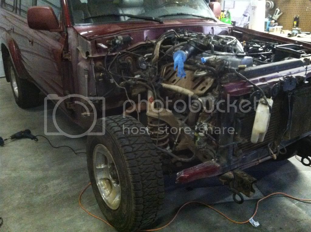

At home after puling everything apart the first weekend:

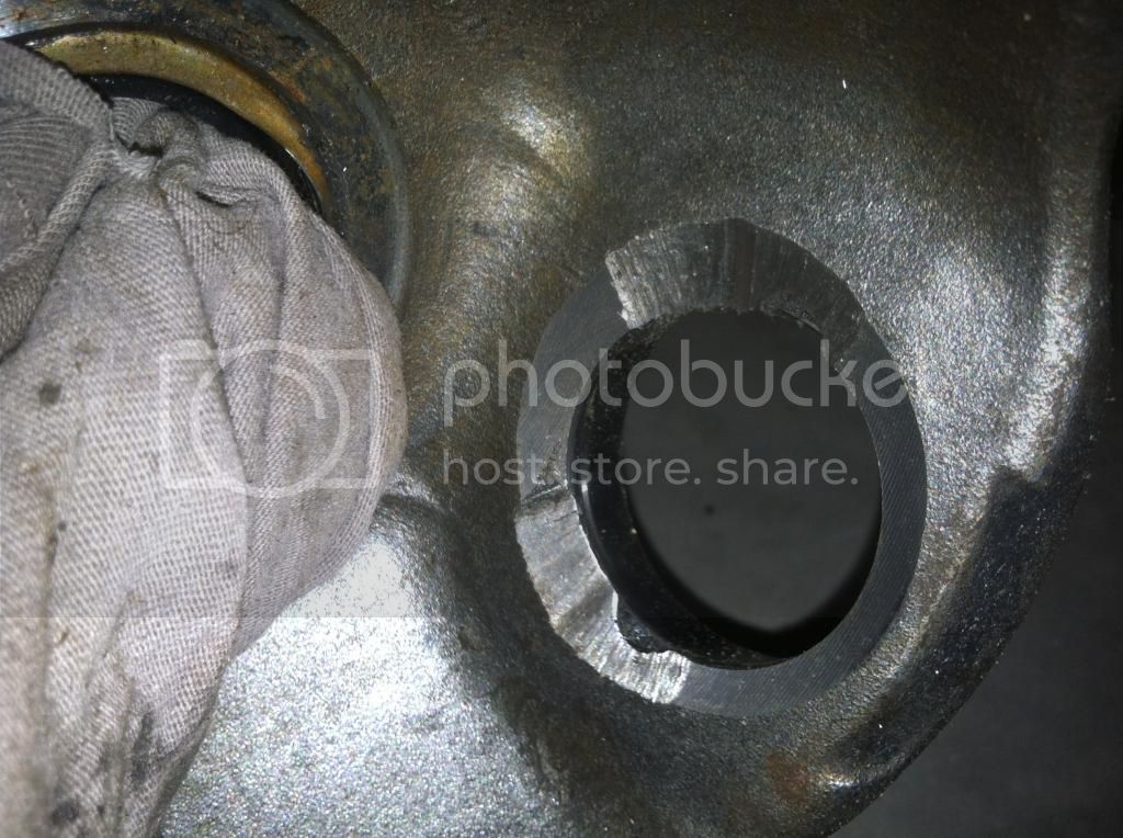

Someone ground down the backside of the bearing races a little bit, maybe to help get the old one out, not sure...

strange that the axle is clearanced in there, but it should be fine, there is still enough meat to keep the trunion bearing race in place. it looks like the steering arm wasn't tight enough and the abs ring on the birf ground it down, or that housing is also bent.

The ground area is on the new, straight housing. I plan on pulling the bent axle next weekend. Once I have the rebuild kit in hand I plan on taking both axles somewhere to have everything moved over.
I feel better knowing the ground area isn't a show stopper.

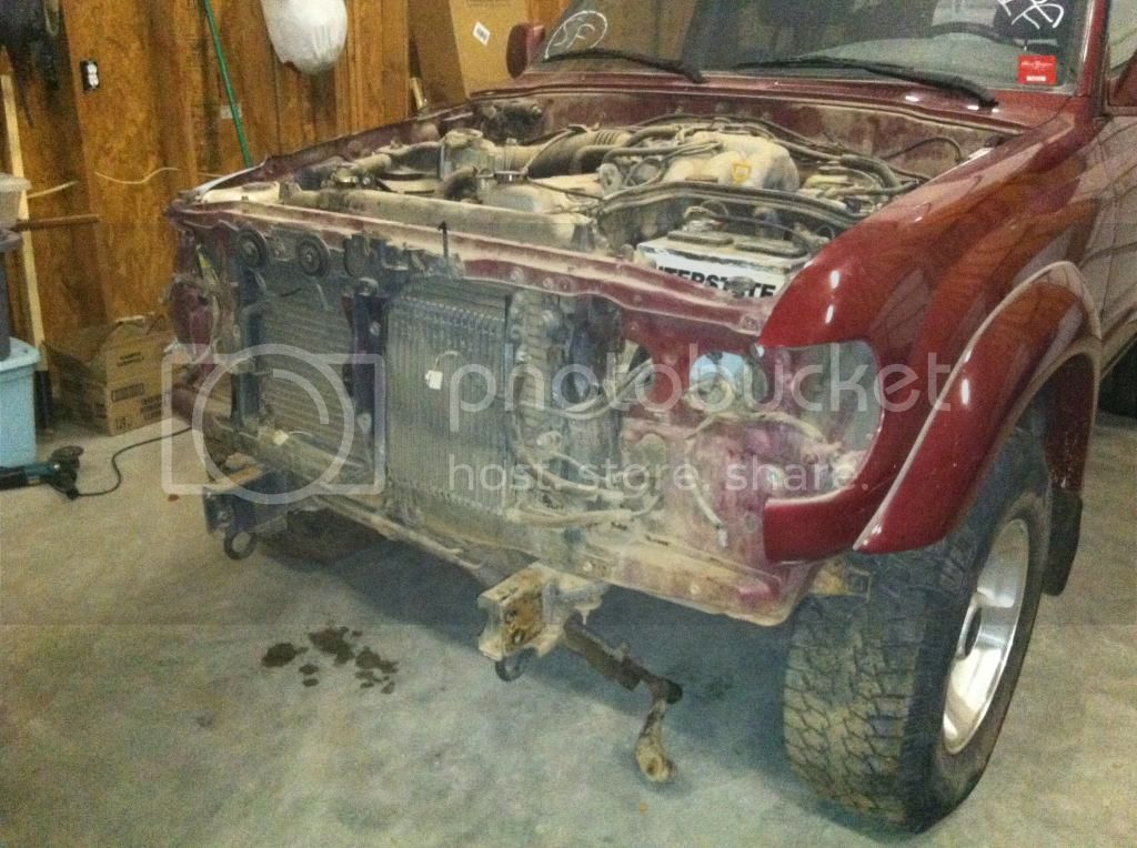

Old fender, fender apron and radiator core support baffle removed.

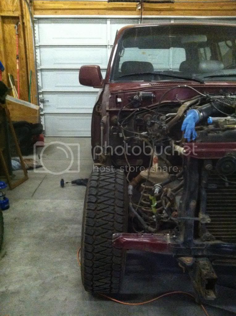

Passenger tire is definitely not straight. The cant of the tire and leak out of passenger side knuckle lead me to conclusion that axle housing is bent.
New baffle, fender apron and fender installed (thanks Tools R Us for fender and fender apron)

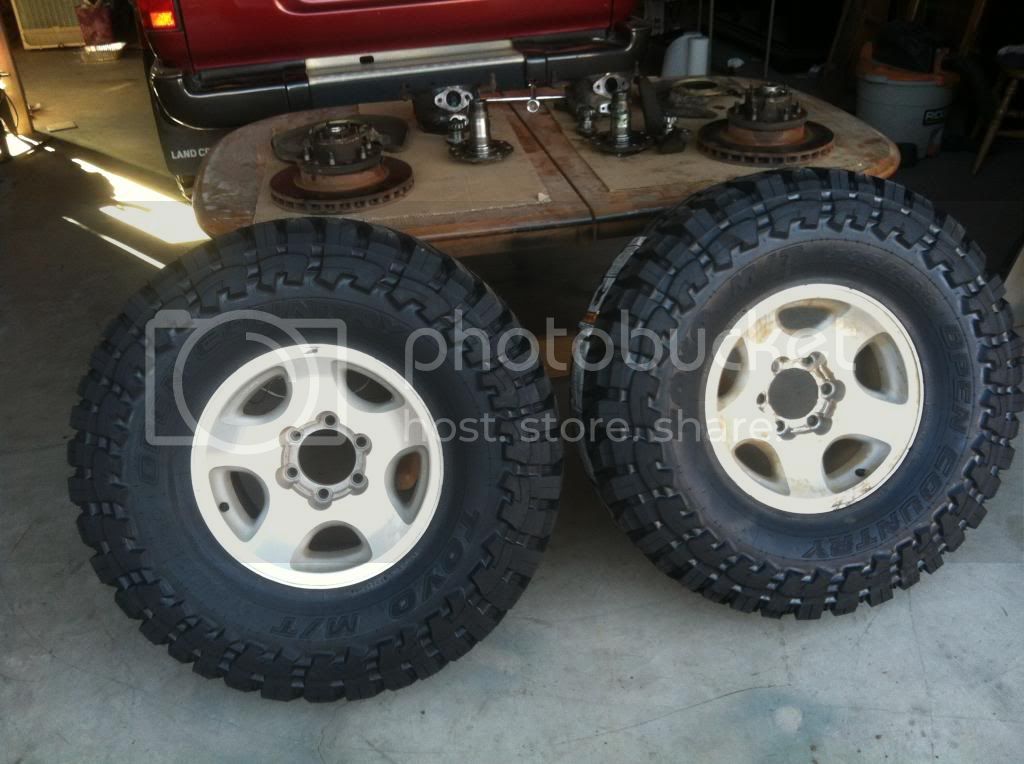

Parts are starting to roll in. New tires mounted this weekend. Toyo Open Country 315/75R16. Put the rears tires on, they fit but look like they'll rub like crazy of you were to take off road. Need to order lift today, OME 2850J Front Coils, OME 2863 Rear coils, long shocks and Slee caster correction plates. Plan on making my own bump stop and sway bar extensions.

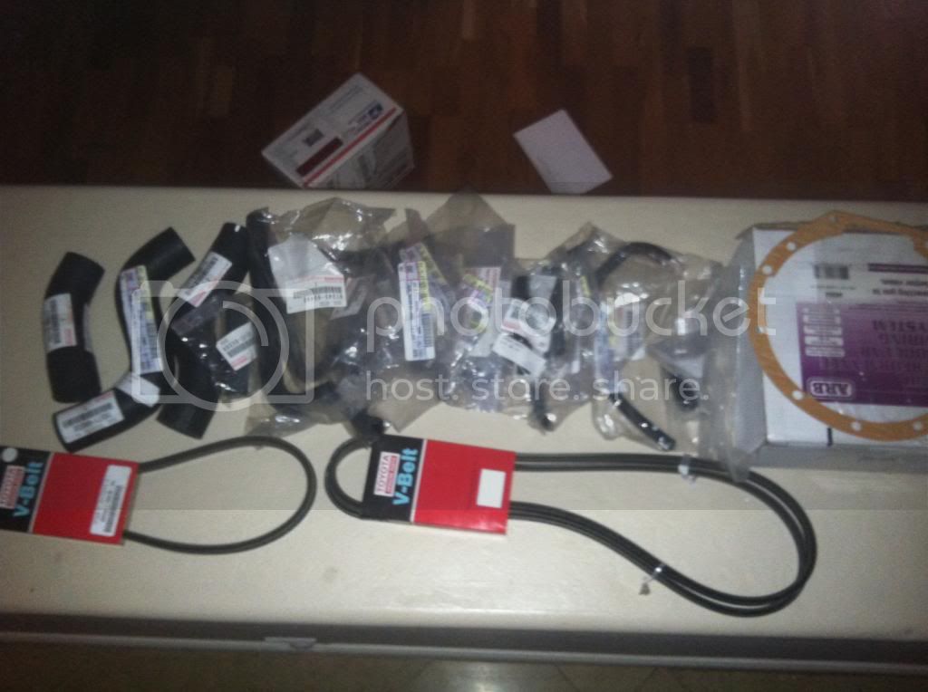

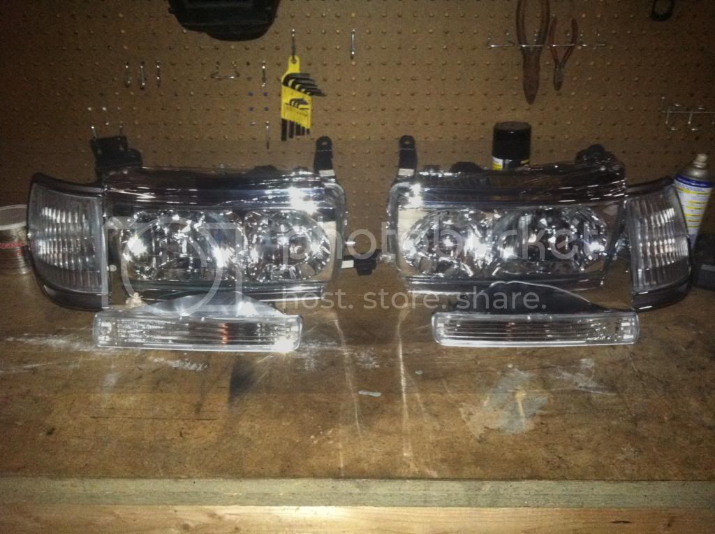

New headlights, corners and turn signals arrived too.
Ordered belts and hoses and they should be here any day now.
