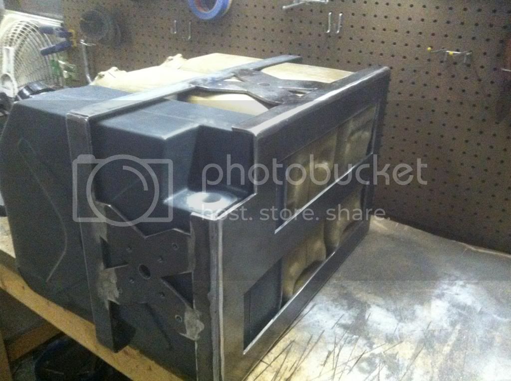

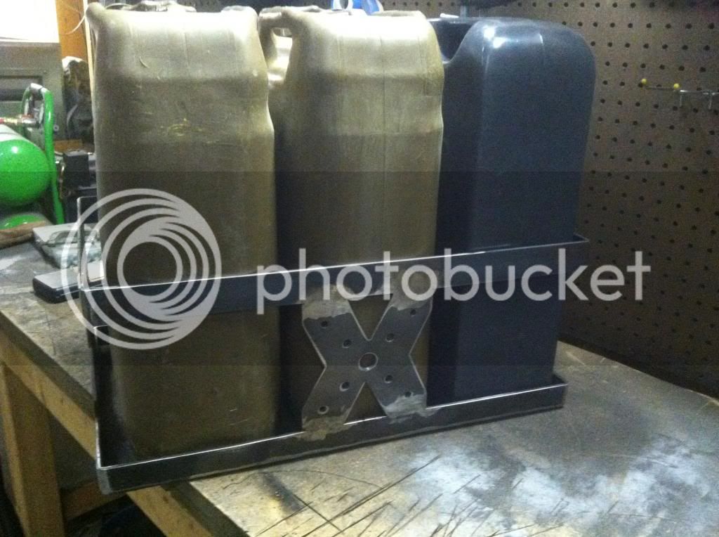

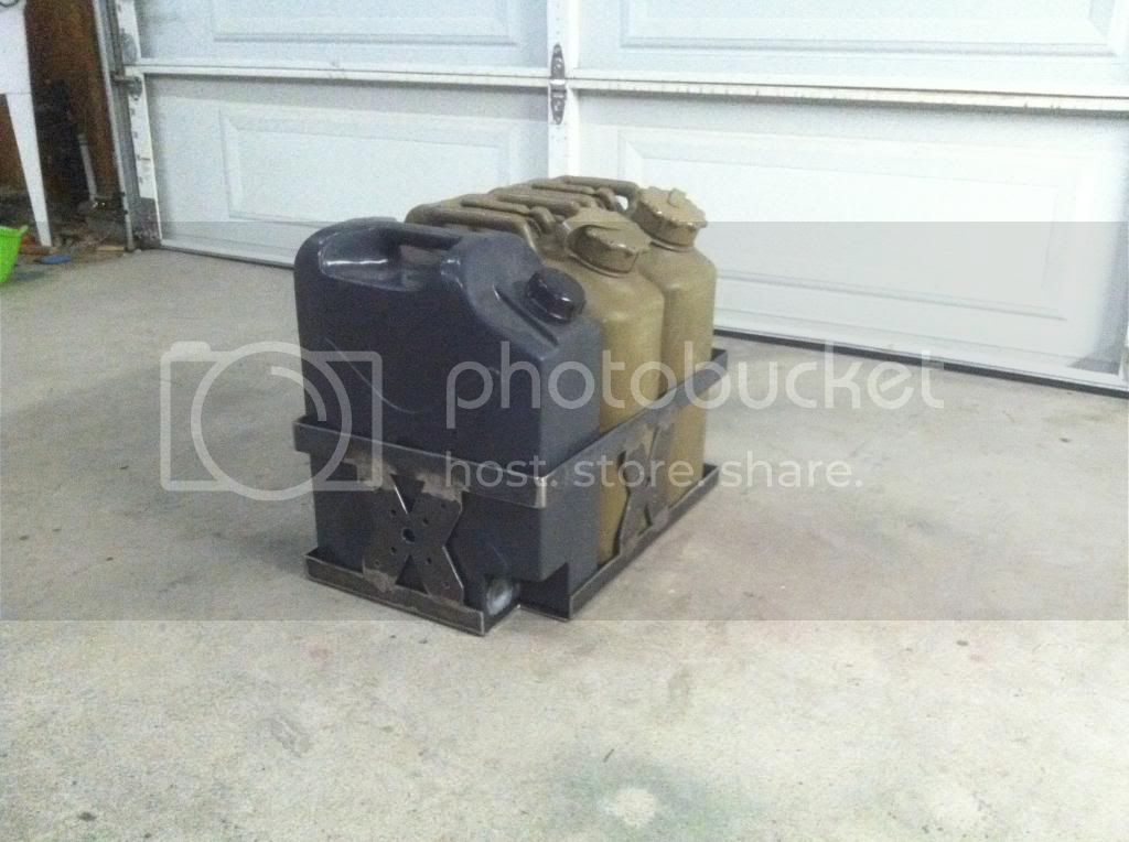

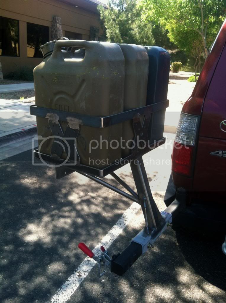

Starting on a fuel carrier for driver swingout. 3/16" steel so it's pretty heavy but should be fine. Wanted to be able to use contents of jerry cans without removing them from carrier as much as possible so using a Front Runner water container with spout at the bottom. A space was made in the carrier for the spout. Using 2 Scepter fuel cans as well. Left a little space on the carrier to store a shaker siphon hose. Plan is to open swing out and refuel without taking cans out of carrier. Should be able to finish it up tonight. Need to order more bed liner to coat it.

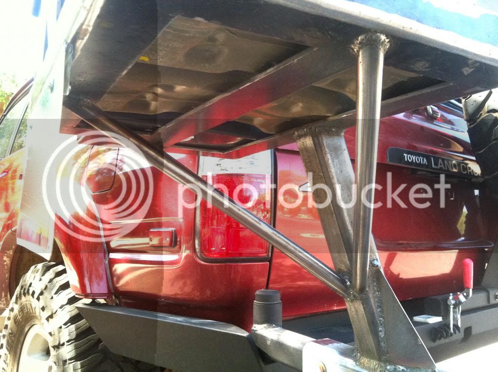

Did you ever figure out your clunk noise from the left front during body roll? I have the same noise and think it may be in the front axle. Also that rear bumper looks nice, I really like the design.

Bowtiestang posted a nice build thread on his bumper and I basically copied it. I'm really happy with how it turned out.

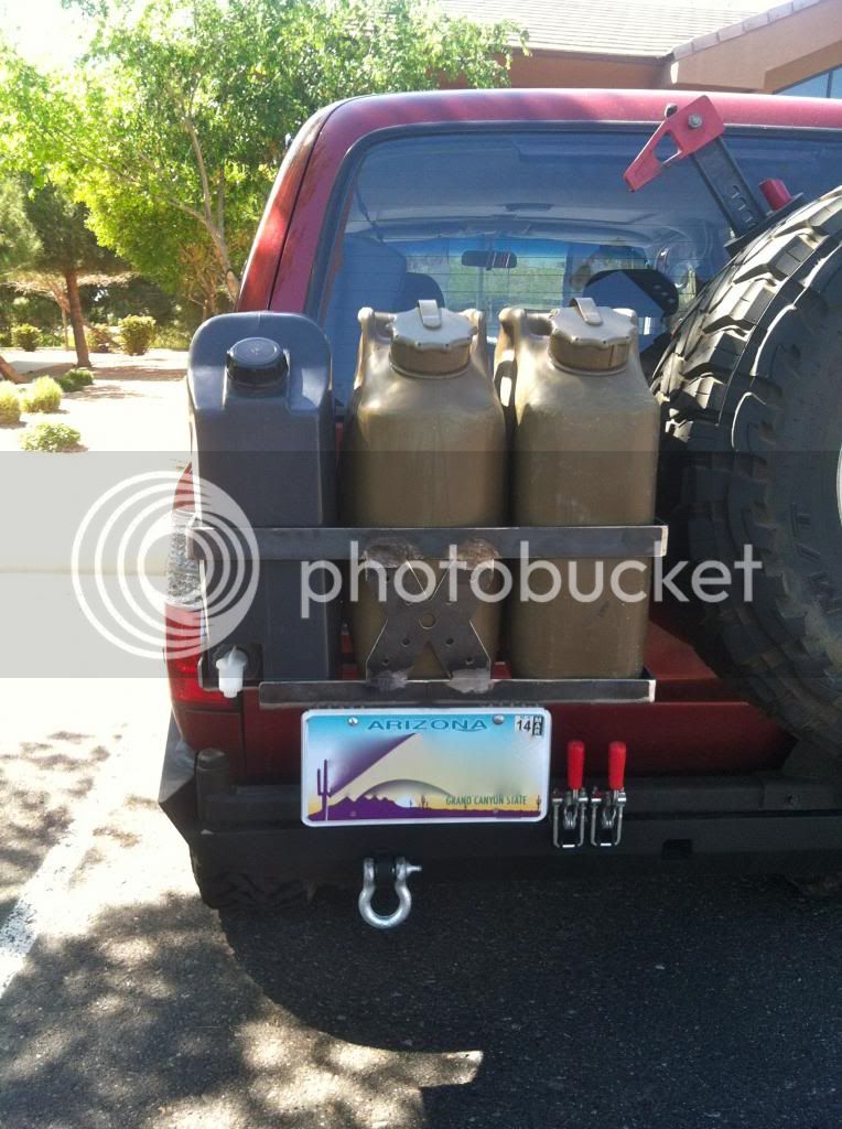

I like the cut out for the spicket! Are you going to make a top bar for theft protection/securing down?
I thought about it but considering it's fairly heavy already I decided to give this a try:
http://www.lockstraps.com/purchase/
Should be here Friday, it has a steel cable running through the strap to keep someone with a pocket knife from cutting the strap... We'll see how it works out. If it's not up to par I'll make something to run between the can and handles.
I successfully put 10 gallons of gas in my 80 with a shaker siphon. Takes about 3-4 minutes to empty each can.
