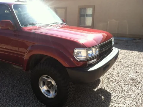

Finished front late last night. I've been working on this thing starting at 8 or 9 at night and finishing around midnight.
Pulled it out and took it for a drive around the block.
Lift done, Slee doesn't have any extended brake lines in stock so I'll be ordering those early next week. Scheduled a level III inspection for tomorrow so I can get the the OK that it's road worthy. Picked up a 3 day tag and drove it to work today. I have the front sway bar out right now so it has a little body roll around corners but rides pretty well. (Hope to have time to knock out the extensions one night this week) Hood and valance haven't been painted and aren't high on my priority list so not sure when that will get done. Plus it's driving my wife crazy that I'm driving it around like that, "What will the neighbors think!?!"... haha :hillbilly:
I have one major annoyance that I need to deal with. The hood latch cable is stretched out and when you pull it doesn't release the hood. So need to order a new cable and get that installed. For now I'm driving around with only the hand release latched to the hood.
Some pictures:

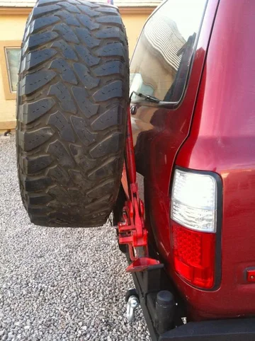

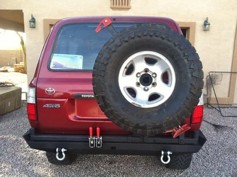

2. Built a rear bumper with dual swing outs. Tire carrier done, working on 3 jerry can holder.

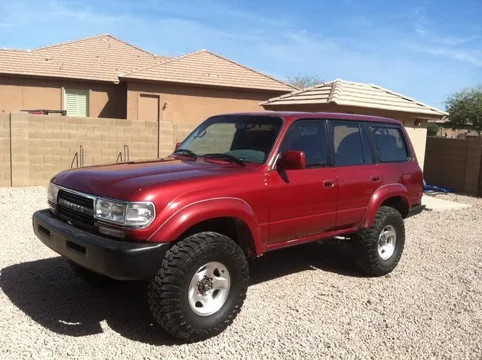

4. After a year of driving with a mismatched hood and front valance I finally made up my mind to just paint to match existing paint.
I spent a lot of time going back and forth considering bed liner. What made up my mind to not do it was coating the rear bumper in bed liner, the stuff is a b**** to keep clean. So having that issue over the entire vehicle would suck.
I painted it myself and this was my first attempt at automotive painting. I bought everything from Space Age paint supply here in Mesa they were extremely helpful in getting me setup with everything I needed. Spent 140 bucks on paint, reducer, clear and catalyst. Picked up $20 harbor freight HLPV gun and inline filter keep the air dry. Everything went fairly well I should have shot the clear at a higher PSI the orange peel was really bad, had to wet sand from 600 to 2500 and it still has some issues but I'm happy with it. Had a mobile detail shop come out and buff the entire vehicle. Looks great now and the :princess: isn't embarrassed to ride in it anymore :hillbilly:.
