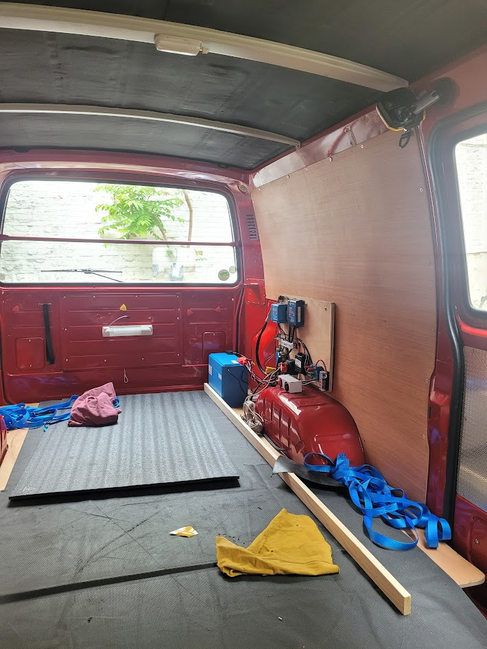

Electrical Panel back in
Put the bed back in.
The final bed won't be made like that at all (floating structure and rock'n'roll type) but makes a good template to build the other furnitures around, particularly the sideboard cabinet that will contain the electrical, all plumbing (including gray water tank), and wardrobe.

Started working on the side cabinet, still a very "early" version of it but at least the Electrical Panel will be slightly protected.
Then removed it to assemble it outside.
And now that I have the exact outside shape of the cabinet I built a cradle for the battery. Horizontal was a bit tight with the lower ventilation (that was the firetruck watertank overflow... and in the future will be use for the heater) so I ended-up putting it vertically.
Used inserts so everything can still be removed if I want to used it as a van.
Put an extra cork layer in the cradle to limit vibration of the battery and also cold transmission through the floor.
A little tight on the wiring in this position but works.
