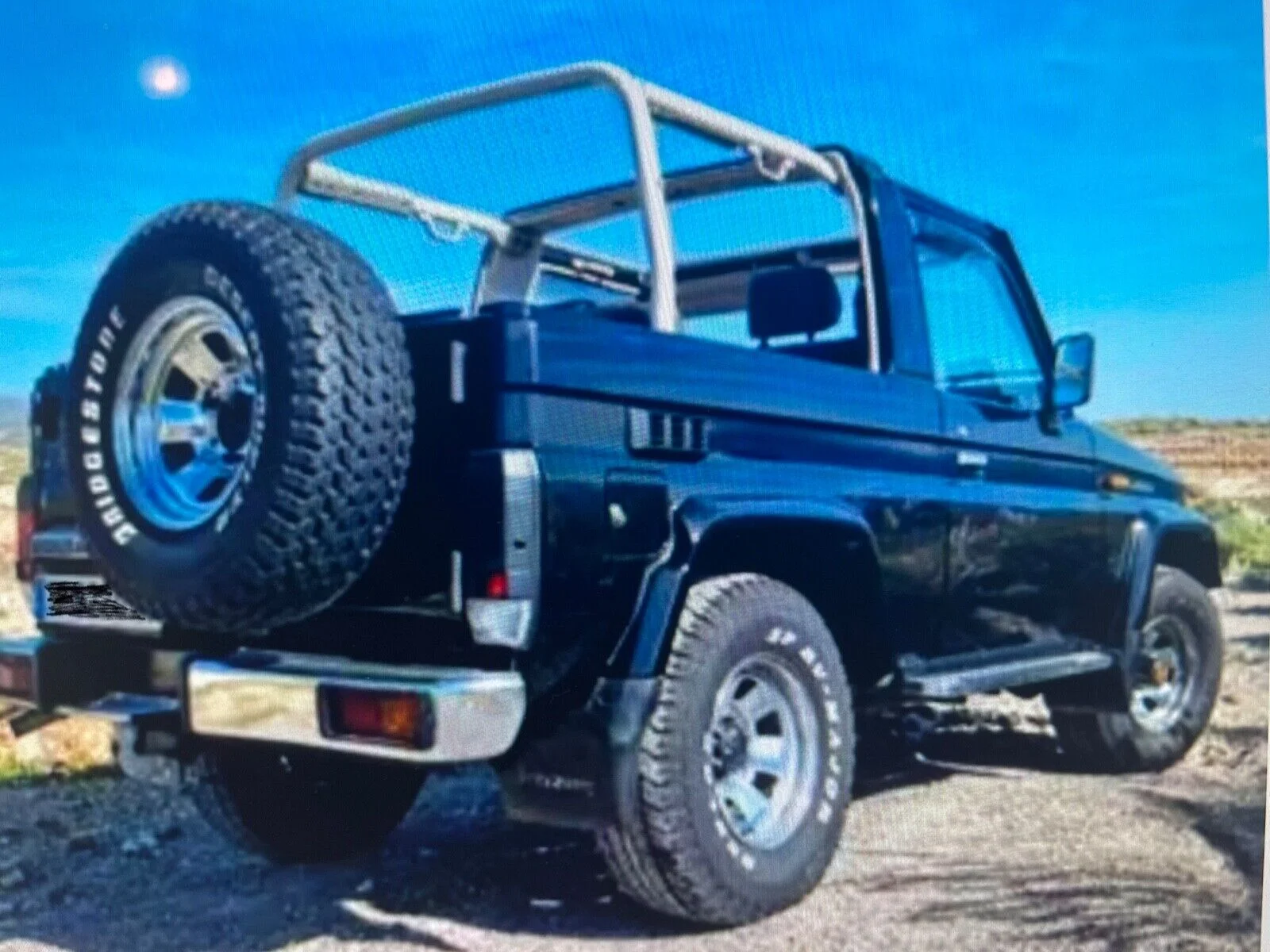

How it was bought in Maldives. Owner put top back on for shipping to US (but obviously didn't bolt it on).

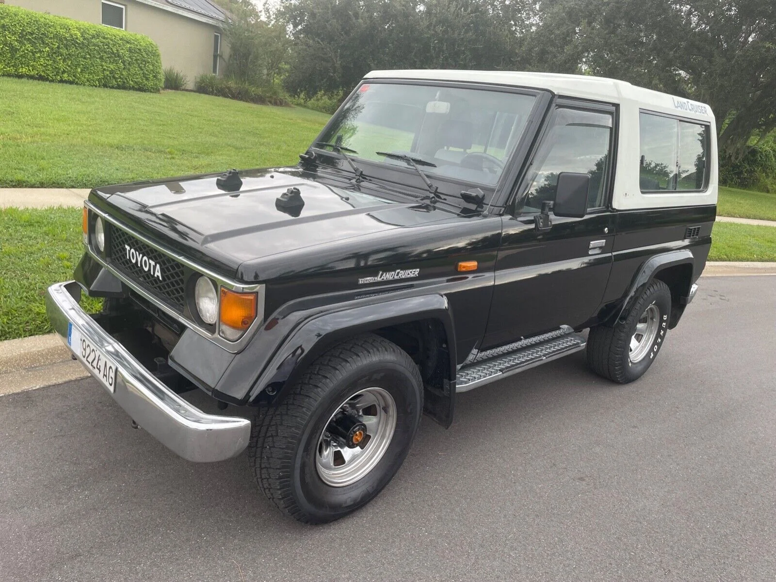

I greased the drive shafts and set front tires at 29psi and the wobble seems to have gone at 55ph. Tires on front are fairly new (see pic above).

From the photo it looks like you have at least 3 brands of tires on the truck, that's what made me think that. Plus I just think any kind of vibration is 99 times out of 100 tires.
Have fun and good luck!
Yup, spare is different than rears. Fronts and rears are matched sets, fronts look pretty new and rears still have decent tread left. Set fronts at 29 and rears at 35 but manual calls for 41. Will still get them balanced this week.

Does it have rear half doors on it now…doors without windows?
I had a soft top custom made for $2,500 a few years ago.
Full doors and windows - I took the windows off for now until I get another hard top. Running it like a Safari wagon.
So I guess with factory removable windows, it started out as a soft top.
