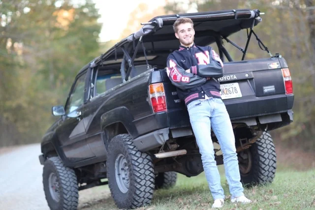

There is a thread on the Razrs in this size:
These are huge for 33s. The Coopers they replaced are 31x10.50 and measure 29” tall on the truck.

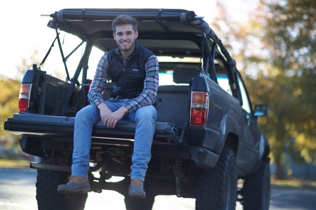

17th Birthday present is a 5th OE Toyota Steelie and a 33x10.50 Maxxis Razr.
We will start a 5-tire rotation and plan to mount the spare interior cargo, vertically, on the Driver’s side.
