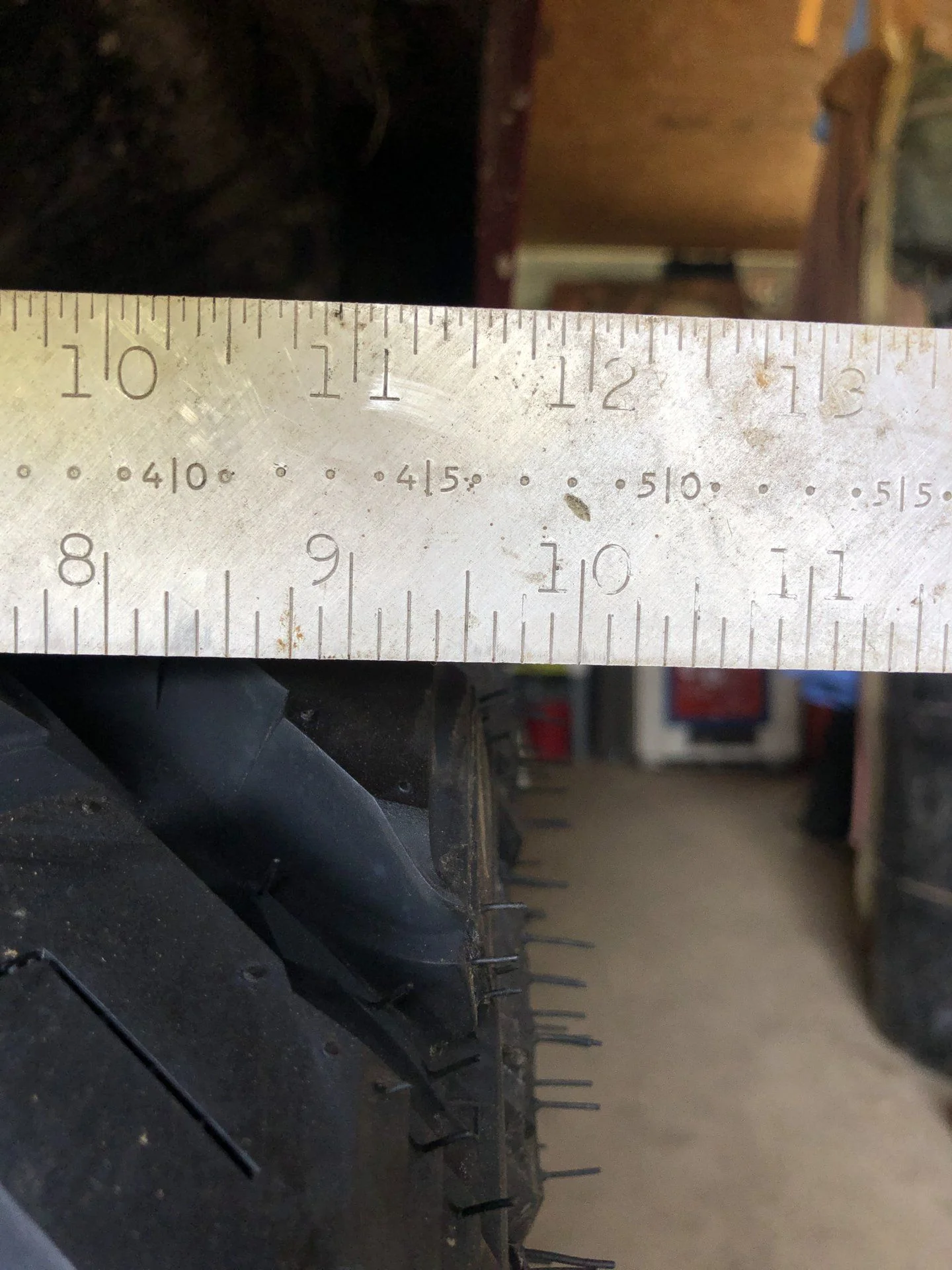

This makes me remember I owe the thread some measurements.

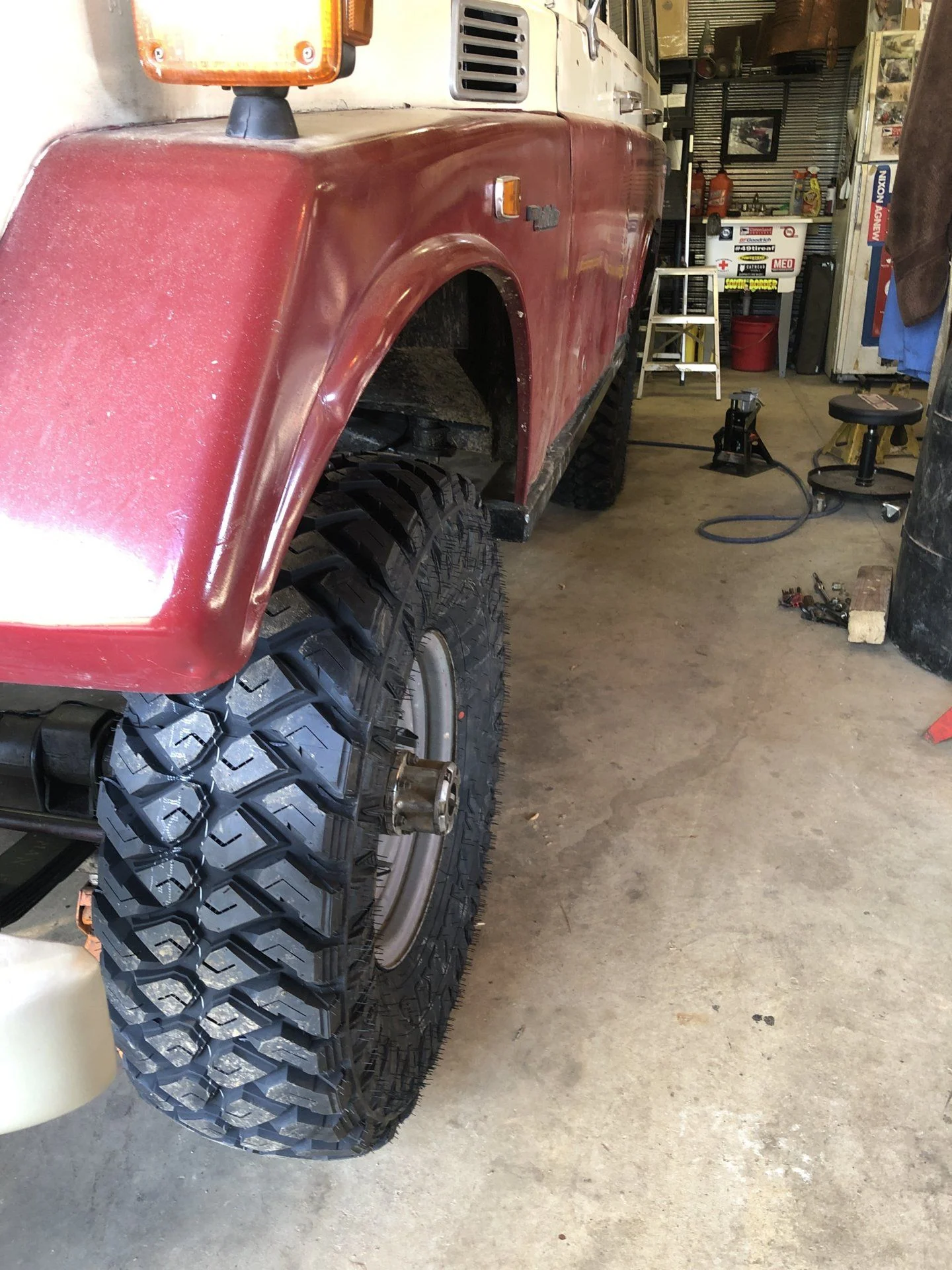

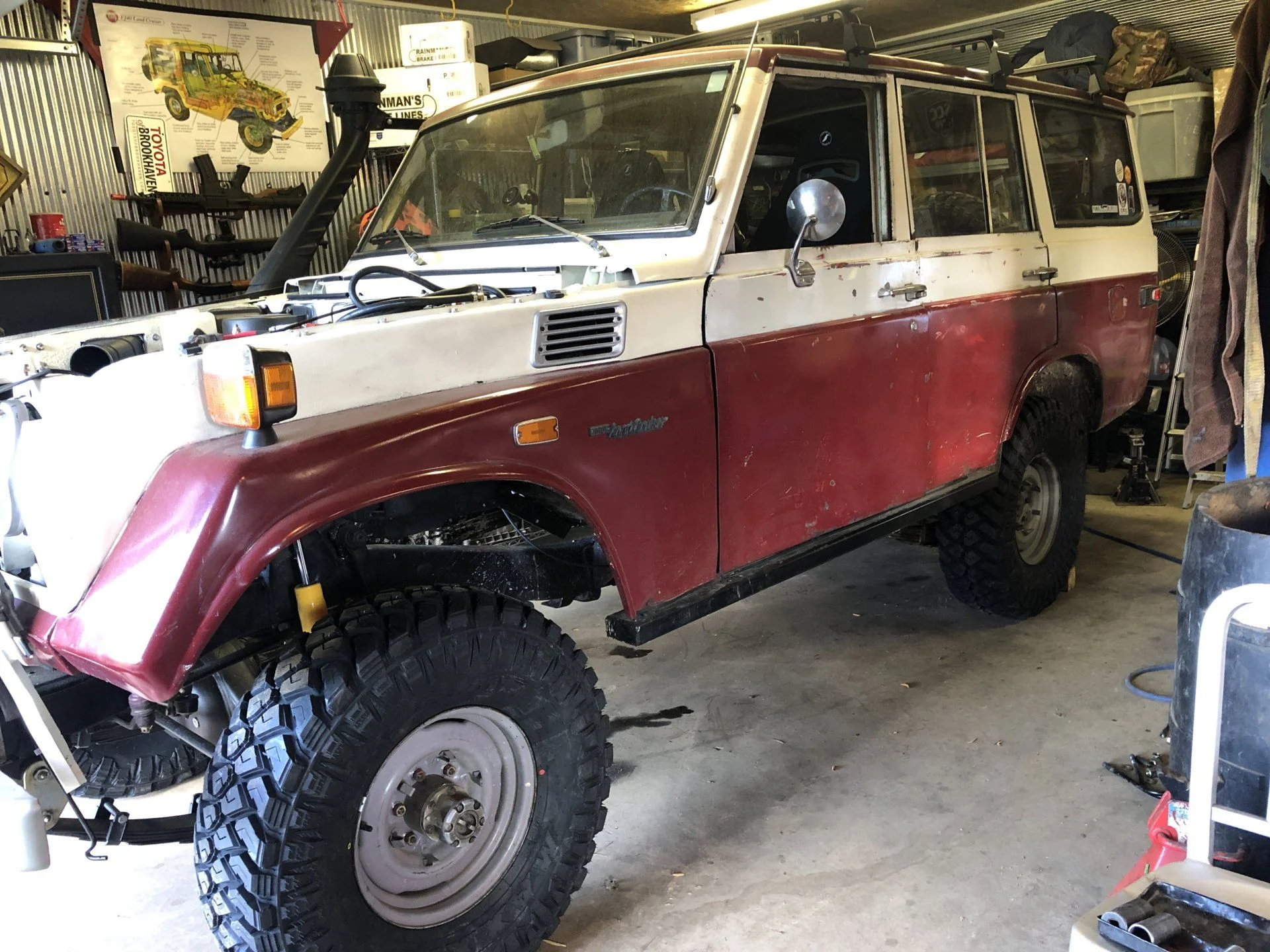

This is mounted on a 15x6 Cruiser OEM wheel at 32#
The height is impressive. I have to check but this could be a full inch taller than my KM3.
Edit. I just checked. This is a 33x10.50 KM3 on 15x7 OEM Cruiser wheels

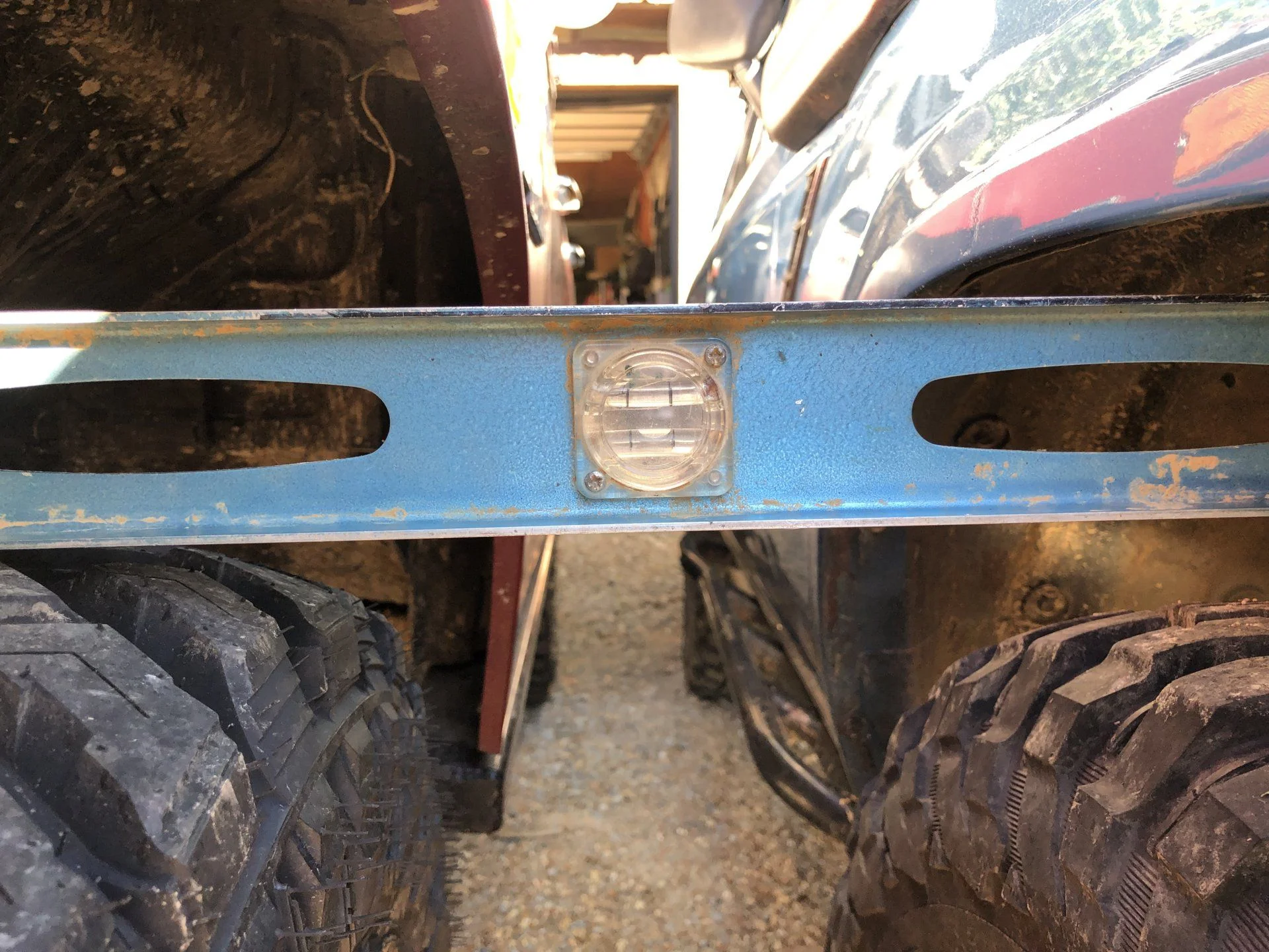

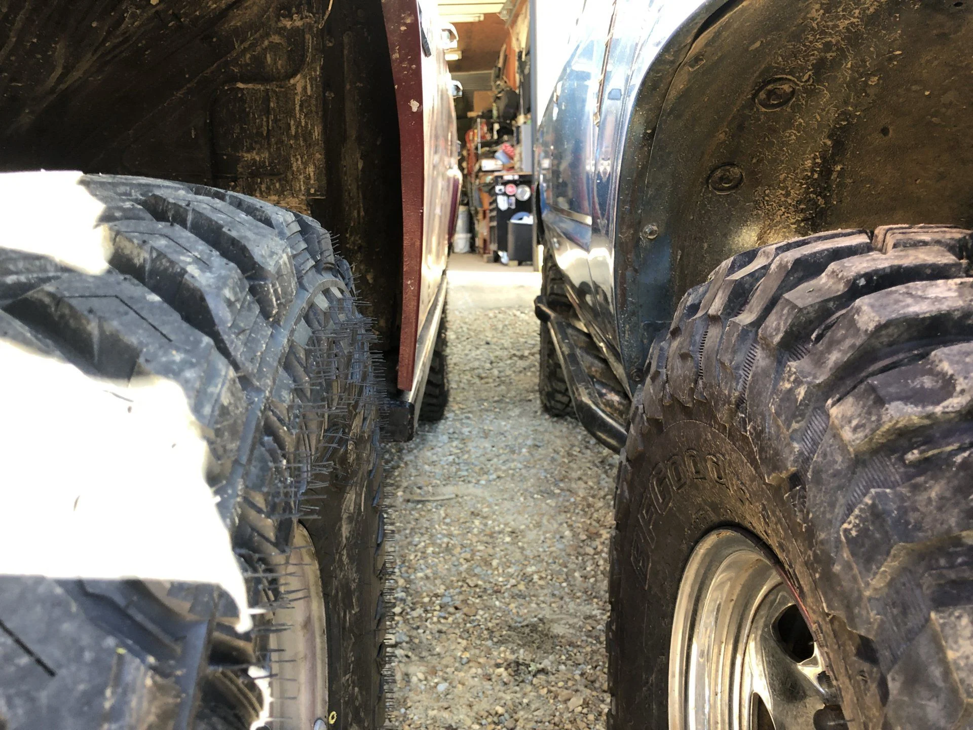

Got a good first drive in.
These tires drive nice and true.
At 32# they make more noise New than my KM3s do with 8000+ miles
The wider tire and heavier tire work the brakes a bit more

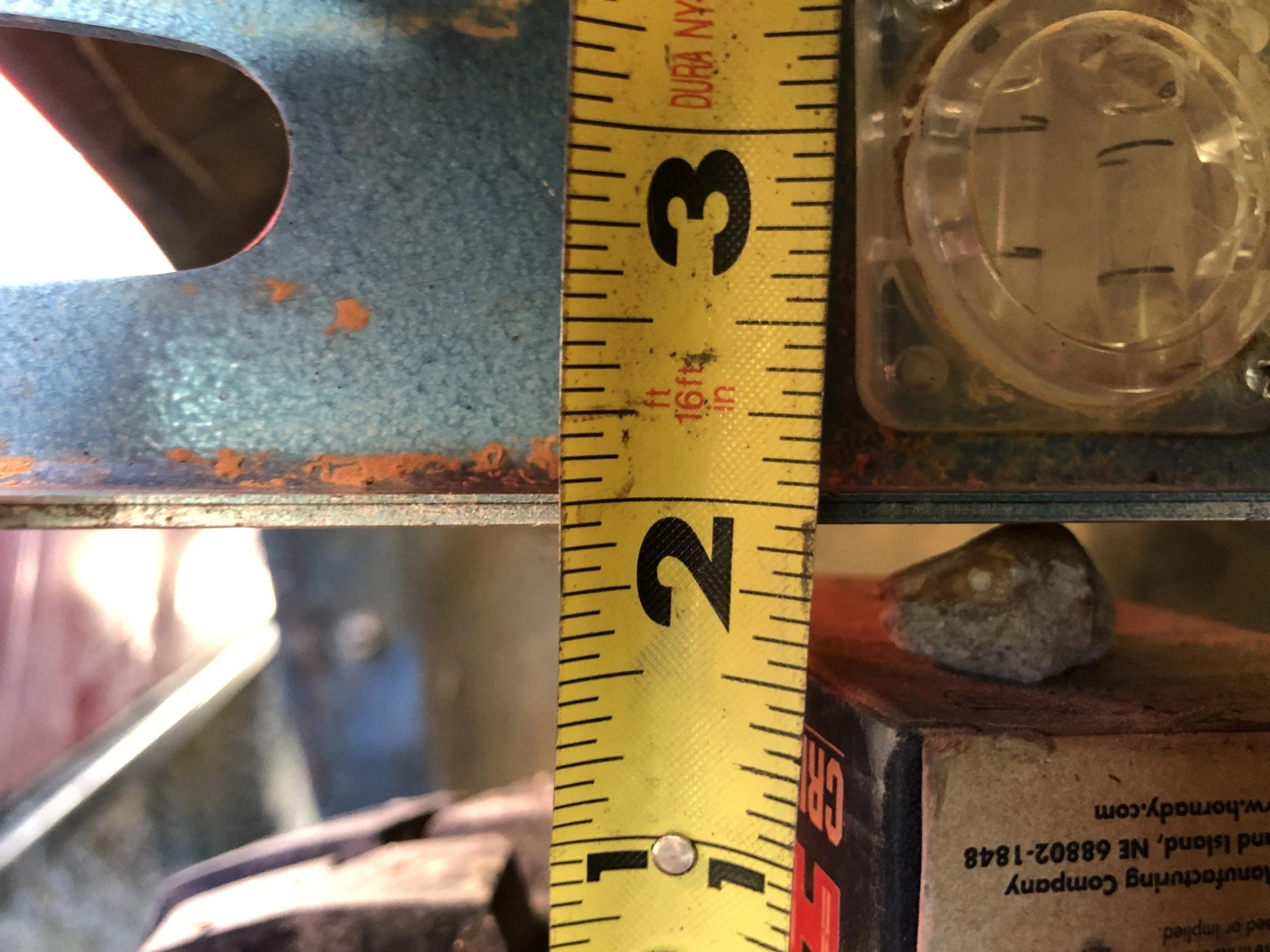

That said, they are truly 2” taller than the comparator.
That’s a lot.
The Maxxis are much bigger. The only downside so far is that they are bigger and heavier, therefore you get all the things that come with more rolling mass.
