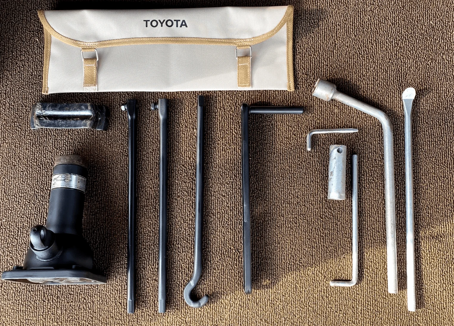

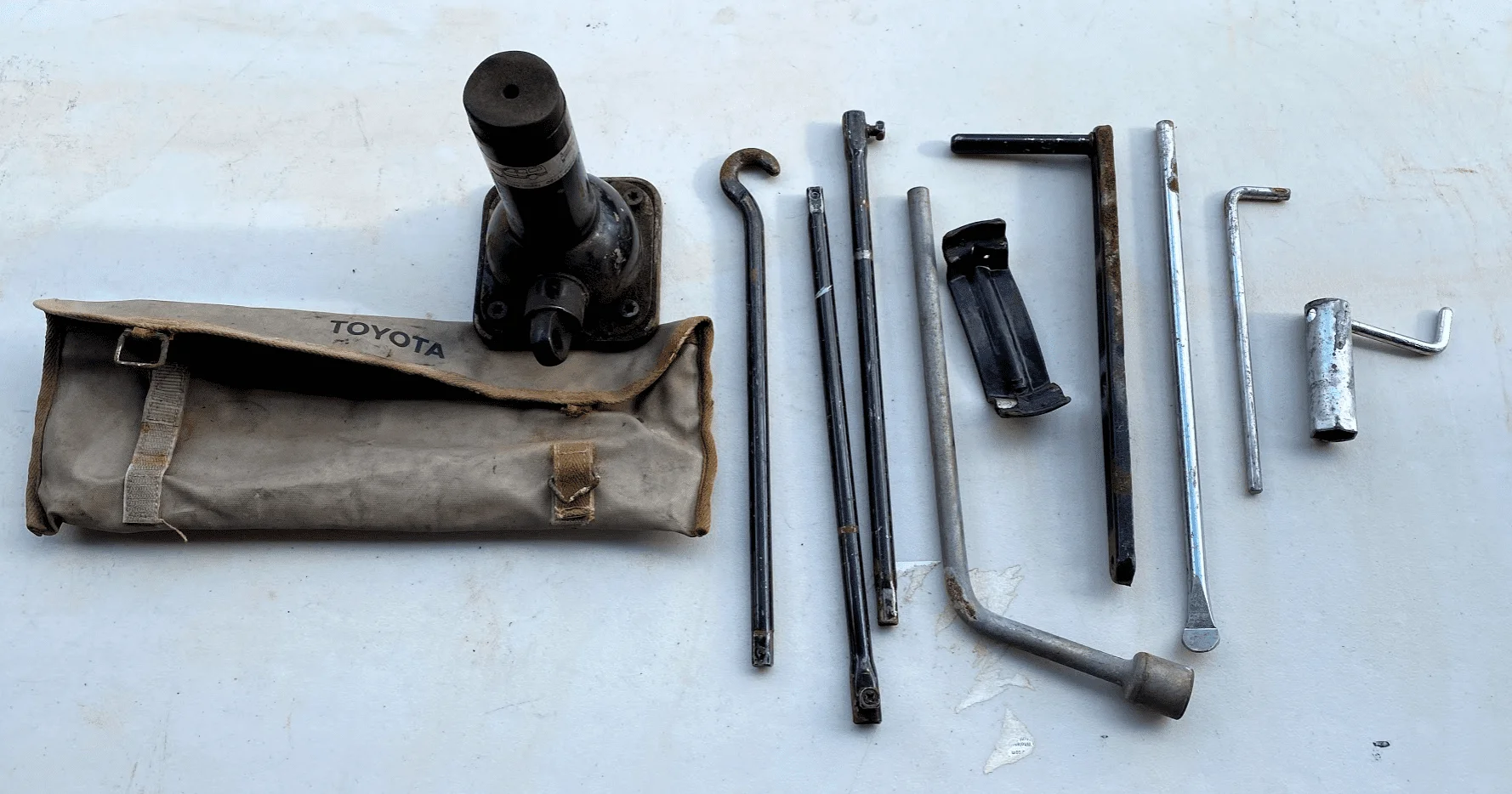

Finding jack tools at a somewhat acceptable price has been a challenge. If you've been following along, "acceptable price" is a target that tends to creep higher and higher! I've had an ebay alert set up for this one - and finally had a hit for $150. The set seemed to be in decent shape and complete (I think...), so I bought it 5 mins after it was listed :cool:. Aside from the gnarly bag - all good! Anything missing here?
There was some rust on everything so I sanded, primed, and re-sprayed all of the black tools - good as new! Next, I bought a new bag from City Racer. Here's a before and after:

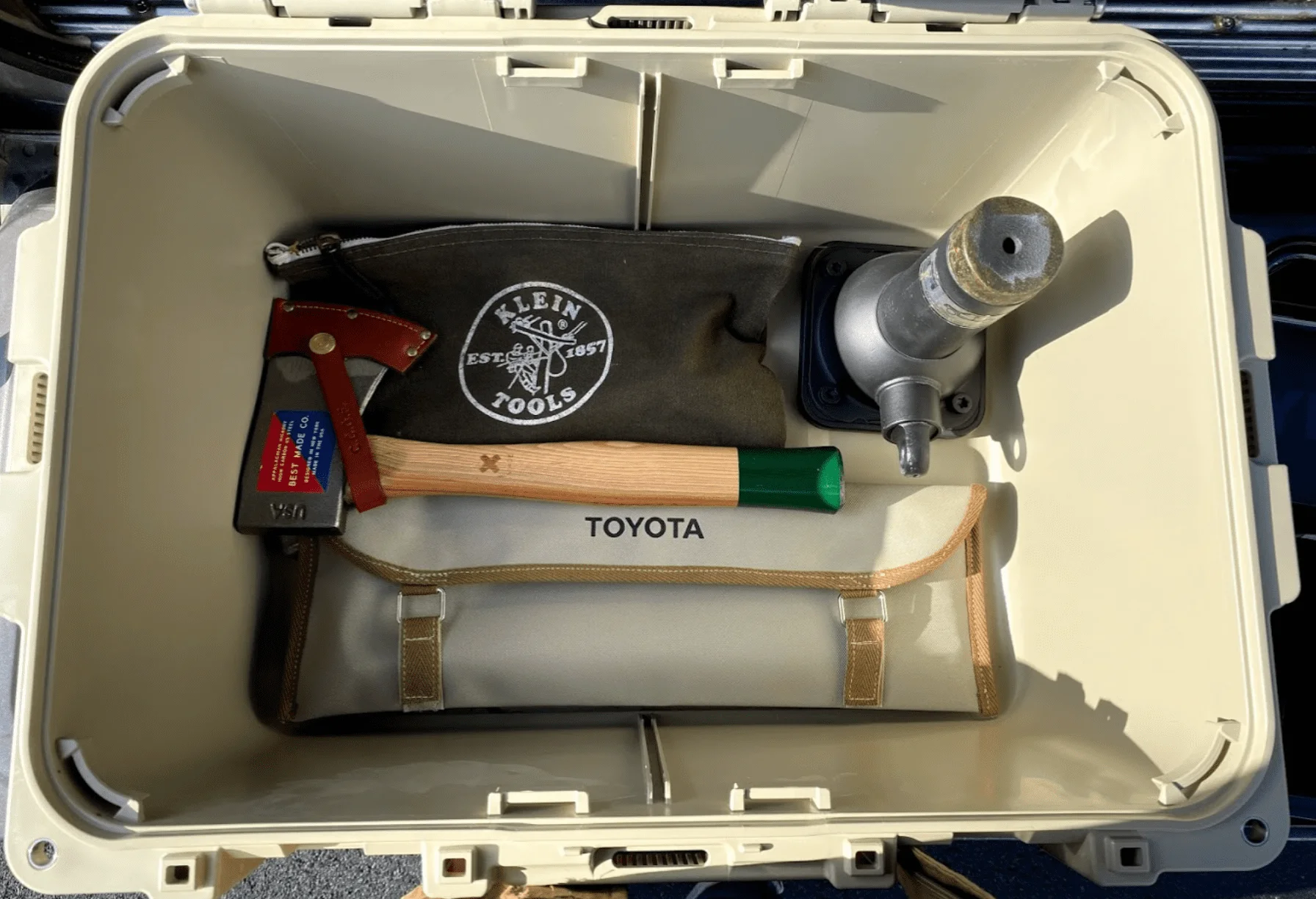

Their new home is a very overpriced (there's a theme here...) tool box. Also living in here is another overpriced tool (hatchet that I'll never use) - rec'd as a gift and needed somewhere to put it. Just cosplaying as Jack Carr I guess...

The Weekend Chief didn't come with a tool set/jack tools. Aside from the bragging rights of owning an original tool set, the lack of tools also made lowering/removing the spare very annoying. PS - Bragging rights are ALWAYS more important....form over function over here!

Their new home is a very overpriced (there's a theme here...) tool box. Also living in here is another overpriced tool (axe that I'll never use) - rec'd as a gift and needed somewhere to put it. Just cosplaying as Jack Carr I guess...

There is a free and custom designed storage spot for those items just to the left of that high dollar Yeti box, y’know.
Only you will know it’s there...very sleeper stealthy hiding spot.

just noticed, that is a sweet Best Made hatchet, I've got one also, though it lives near my kindling pile

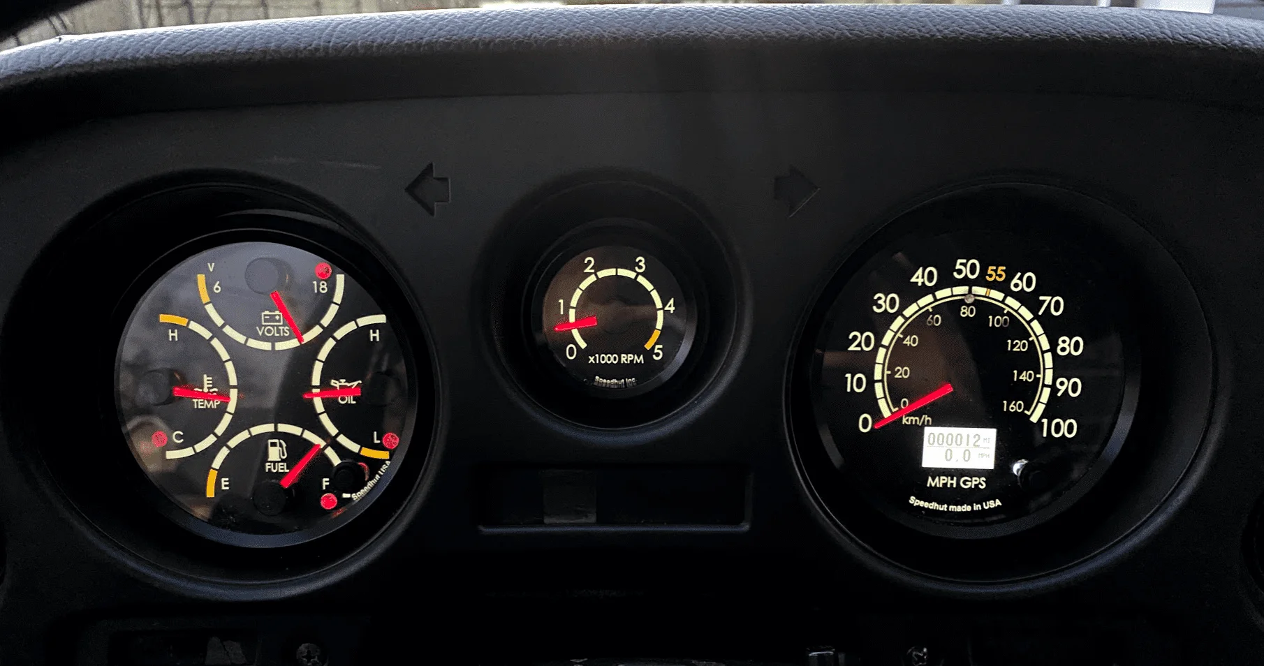

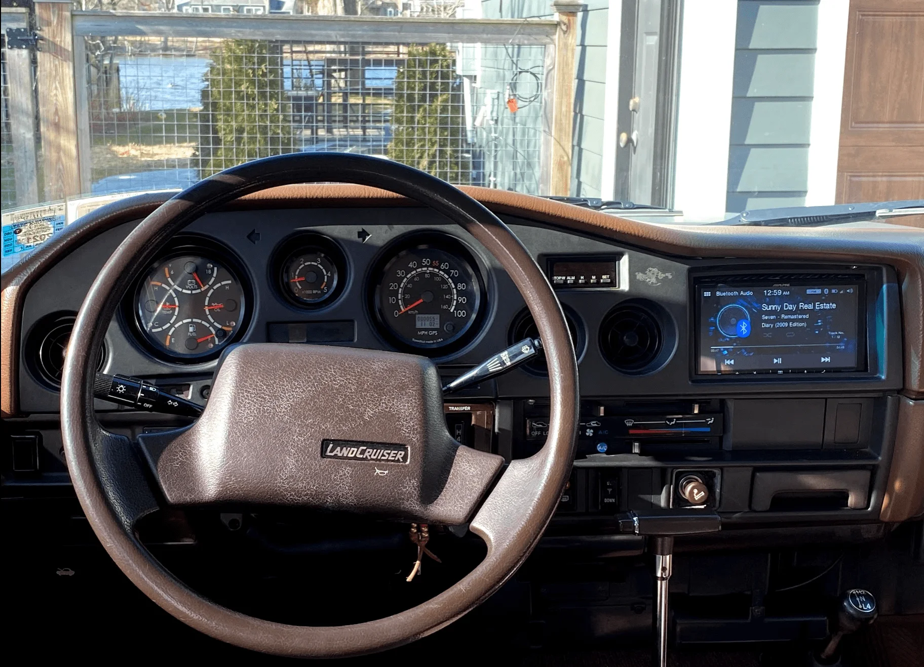

Installed my new Speedhut gauges, courtesy of @FJ60Cam - love how they came out. I prefer the vintage look of the 60's cluster, so this was perfect. I went with the GPS speedo and so far, so good. The placed the receiver on the very front of the dash. Also went with the floatless fuel sender.
It's really nice to be able to see my gauges at night - the backlighting is great compared to original. The dimmer fit nicely where the original knob lived. Also pictured is the Alpine iLX-650 that I recently installed - still need to tweak the angle of the brackets to make it fit perfectly.
Also - notice my busted check engine light...does anyone have a lead on a new lens? The light works fine, just need a film/lens that isn't busted.

Oh wow, those are the best 'vintage' looking aftermarket gauges I have seen yet!...very fj60 looking. Cool.
Gauges are simply perfect! Nice choice.

Any details on installation, or wiring, or if any calibration was needed to get these gauges going?
Question - is there a way to keep your current mileage when swapping gauges? Or do they always start from zero?
I believe you can have your current mileage pre-programmed by Speed Hut, @FJ60Cam?
Adding my electrical wizard @gnintz for some details on install.
Re: calibration, still playing with the fuel gauge. More to come there!
On the fuel gauge, you can use the stock sender and calibrate to ‘empty’ and ‘full’, but the in between is not linear and doesn’t always match the actual level.
We’ve started recommending the Tanks, Inc floatless sender, which installs in the stock sender mount (if you drill new holes in the sender flange), and uses one of the pre-programmed Speedhut ohm-ranges.
If the stock sender gives you trouble, give me a shout and we can get you fixed up with the floatless sender.

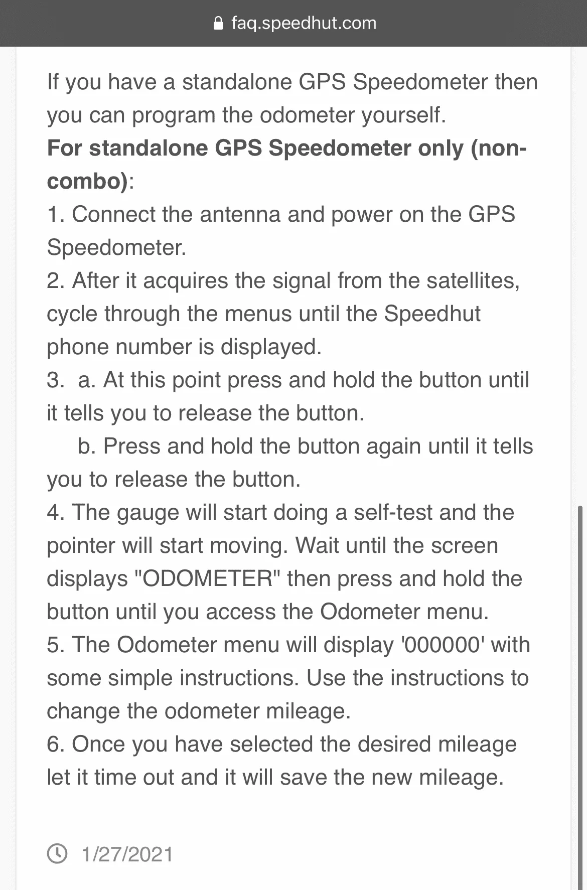

You can definitely program the mileage:
Had a few minutes this morning, programmed my "real" mileage, per the above instructions...very easy. Went from 70 miles to 248K 🤣
Also filled up the tank, so I was able to calibrate the fuel gauge. I did actually add the Tanks Inc floatless sender...so I used the pre-programmed setting. Took 1 minute.
