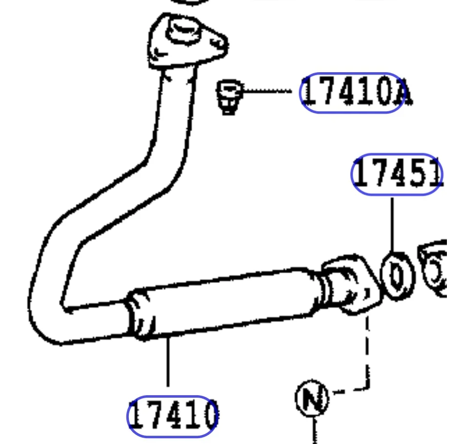

I still have my factory exhaust and there isn’t any flex pipe in it at all.
Interesting. My factory exhaust clearly has a flex pipe in it. (17410)

Here’s my down pipe which appears to be oem to me.
The rest is still on the rig and no flex sections.
