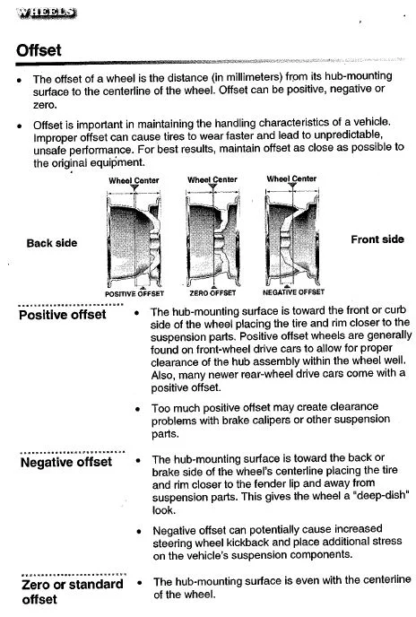

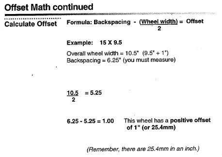

@FJBen I will delete if you request me to do so, but here are some scans from training material used at Discount Tire many years ago. Maybe it will help.
View attachment 2982130 View attachment 2982131
No thats great information, leave it up here. I've pretty much understood the backspacing/offset info, but it gets very confused online and lots of mis-information.
So my understanding is my OEM Rims are 16x6, but that is the inside measurement of the rim, so add 1" for rim lip. So 7 div 2 = 3.5 with zero offset which cruiser dan stated. I've heard 3.5~3.75 would probably be ok without spacers, but 4 and up probably won't work without a spacer.
If you can find them. The 17” rims that I had on the PZJ70 that @Honger is also using will work without spacers using a skinny tire. The BS on them is slightly less than 4” as I have found by physical measurement when I had the set. I would have actually kept them and used them if my HZJ77 didn’t have flares. I noticed you have flares so it may look funny to you.
According to their website:
It is available in 16" and 17" diameter and 4" to 11" wide. The direct offset range is from -25 to +50. It can be fitted on big 4x4 vehicle's PCD, therefore the adaptation possibilities are very large.
So in theory, you could order a 17x7 (8" overall width) and have 4" backspacing. Throw some -12mm offset and boom, 3.5" backspaced 17" rim that will fit 285's. I've sent an inquiry in to see about the custom orders.
