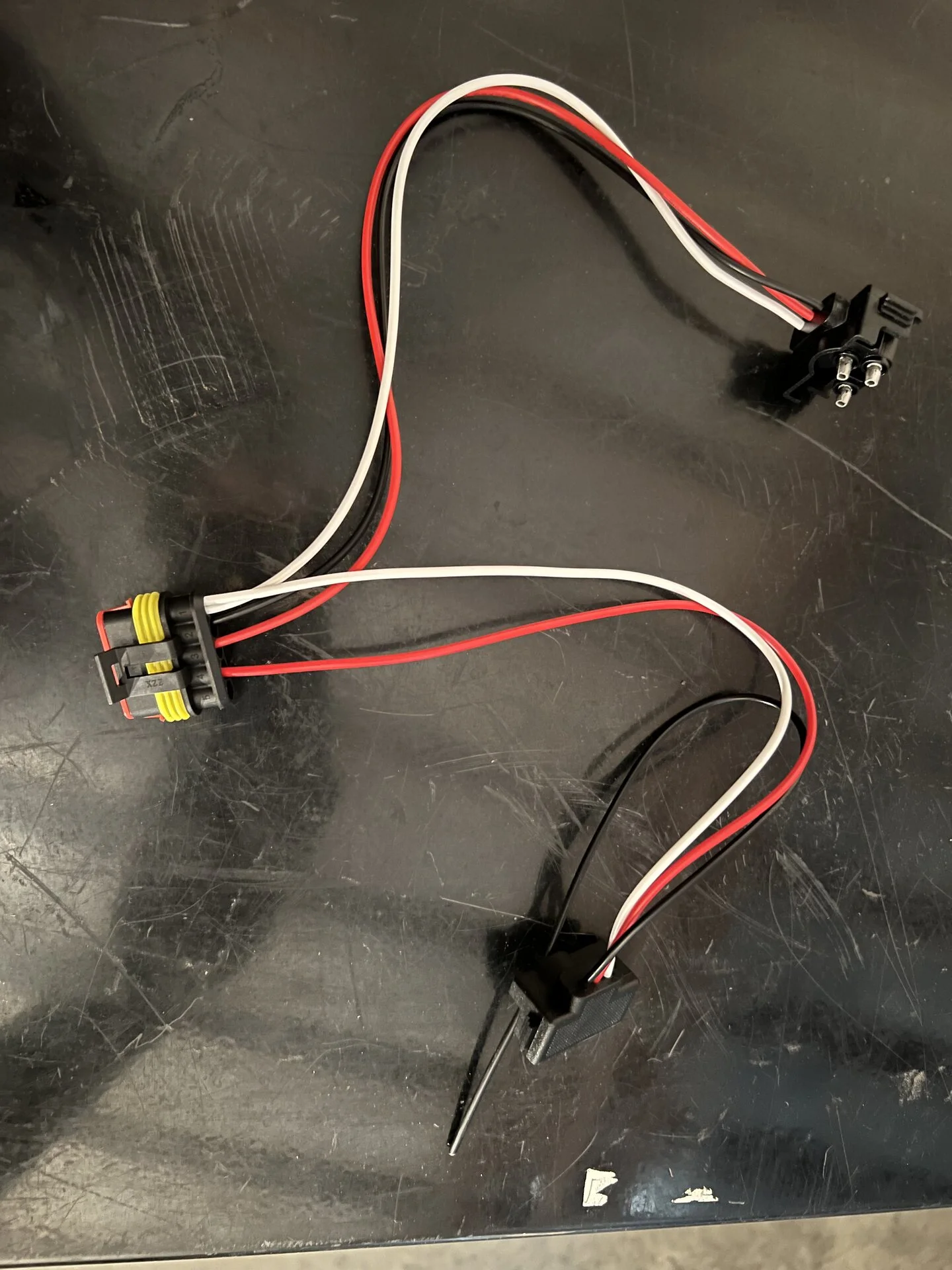

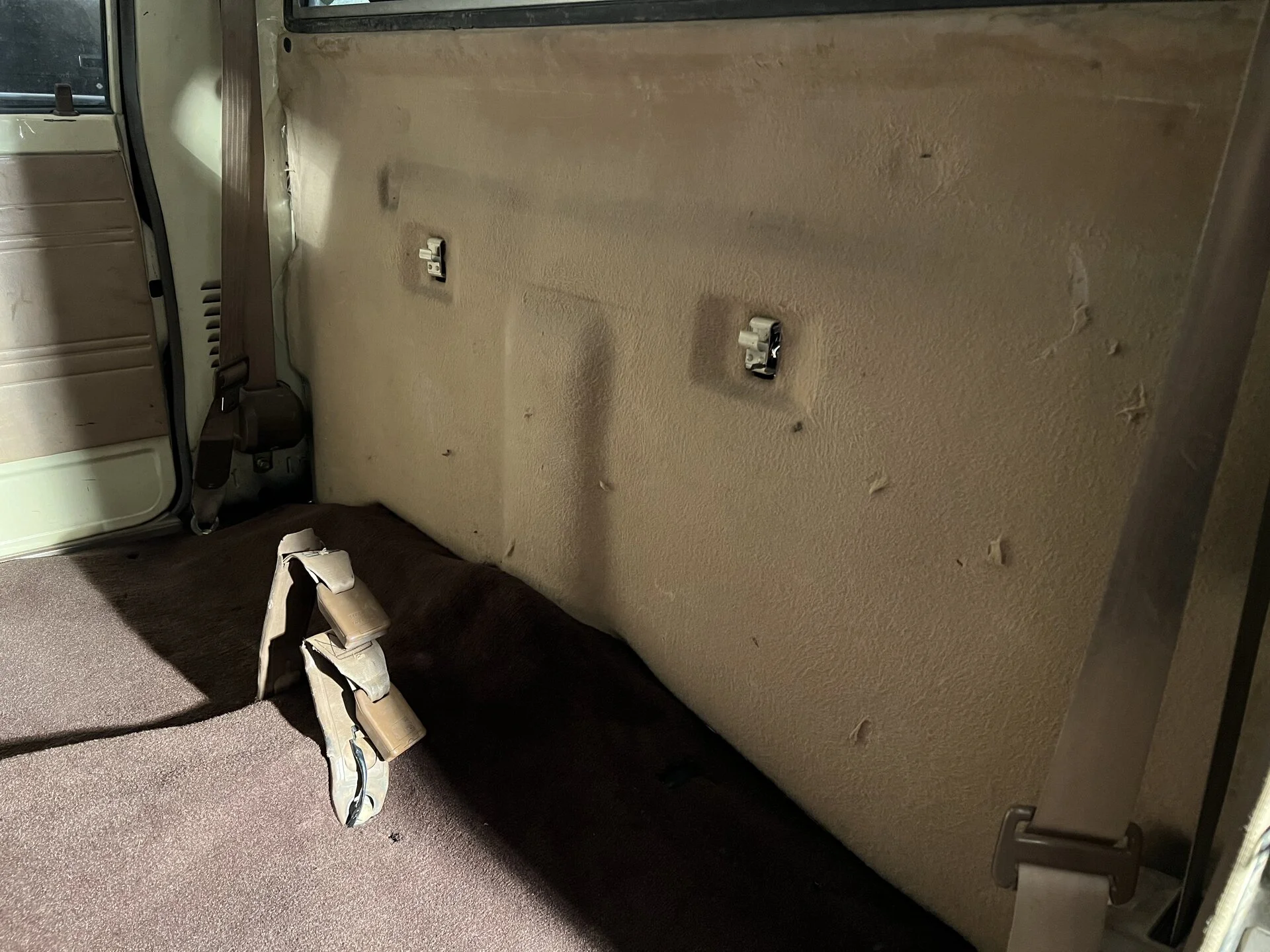

Carpet is in and the back panel was shampooed to clean it up. All that’s left is to cut the transmission hole out which I’ll wait to do until the engine is back in. I also made an adapter harness for the flatbed. I changed the Toyota end to the same style of connector. The only wire missing is for the reverse lights because it’s built into the light itself. I do still have to run the reverse light wires to the transmission itself as I’ve never had them working since converting this truck to EFI.
Are you planning to combine brake and turn into a single light? I did that on my flatbed and used a taillight converter and load resistors for the flash.
After burning up the cheap taillight converters every few years, I added some relays to take the load out of the converter.
Brake and turn signal will be separate lights. It’ll be the same setup as I had before. This harness will plug in to the factory harness and keeps everything working on the stock wiring.

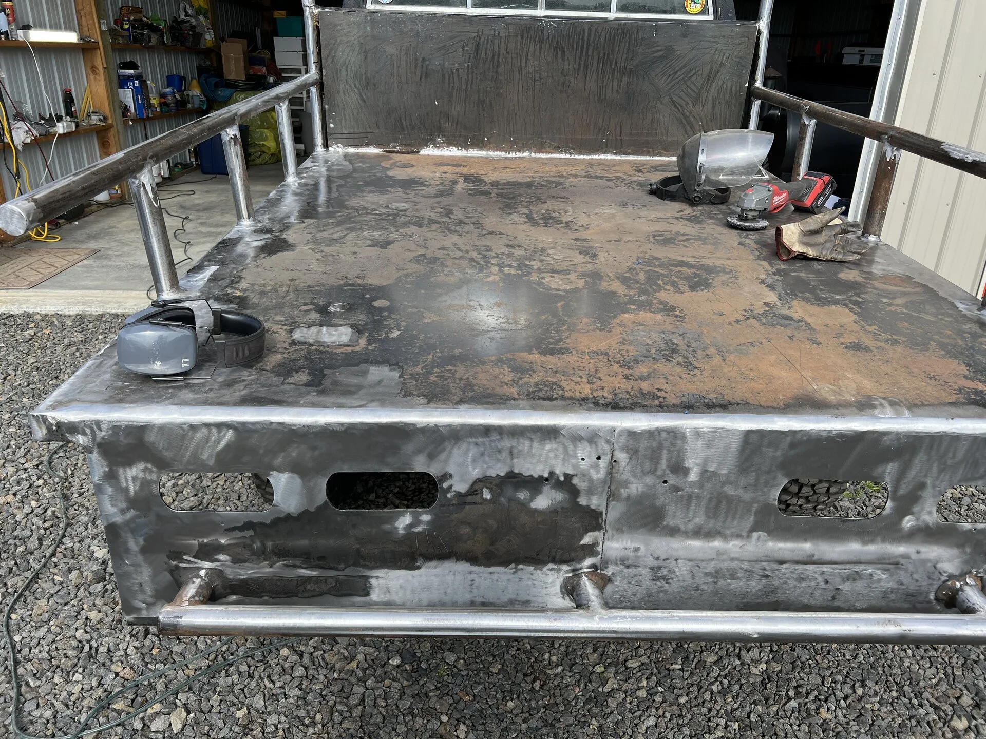

Work on the painting of the flatbed has finally started. My plan is to use epoxy primer and Monstaliner on it. Last time I used Monstaliner I had issues with it not bonding to the undercoating I had applied (my fault, they weren’t compatible) so I decided to take it down to bare steel and start fresh.
All in all it took me about 12 hours to do the whole thing. I used paint stripping wheels on a grinder for it and then a die grinder to clean up the welds. I have to give the cordless Milwaukee grinder props. I’ve been using it for this whole project, sometimes burning through 7 batteries with the only rest being the time to change the battery and it’s had zero issues and is still like new. It does eat through batteries though. I’ve got two of the 12AH batteries and I mainly use them and while they’re charging I’ll use some 5 AH and 3 AH high output batteries.
Still need to sand with 120 grit but I first plan on sanding with 60 to clean some more of it up.
It wasn’t the most enjoyable but it was satisfying watching progress. I did it in little areas so I could see results and not overwhelm myself with the amount that was left.
One thing to note about those paint stripping discs, they do get the metal hot. I’d be a little bit concerned on thin metal that it may warp. The steel on this truck is 11 gauge so I wasn’t worried. Below is what I used, they were cheaper than Home Depot or my local welding supply and lasted forever. I don’t think I burned through a single one to where it wasn’t useable for a different project.
I have cordless grinders, but I also have a 7" corded grinder and a couple 4.5" corded grinders. The cordless ones are fine for a bit here and there, but I reach for the corded ones if I have a larger project like that. Remember that those batteries have a limited number of cycles.
A corded grinder would’ve been a lot better and definitely put a lot less wear on the batteries. The only reason for running a cordless is due to this shop not having power. Currently to run the lights I have a 100’ 15 amp extension cord running to the shop or I have to run a generator. I usually reserve the generator for running my little welder.
That does make a difference. I saw the cord running under the truck and the cords on the wall and figured you had power available.
Haha there’s a bunch of extension cords running from a heavy duty surge protector to have power throughout the shop but I try to be mindful of the amount of amps I’m pulling when running all the different things. I’ve avoided using a coffered angle grinder since the good ones pull at least 11 amps.
