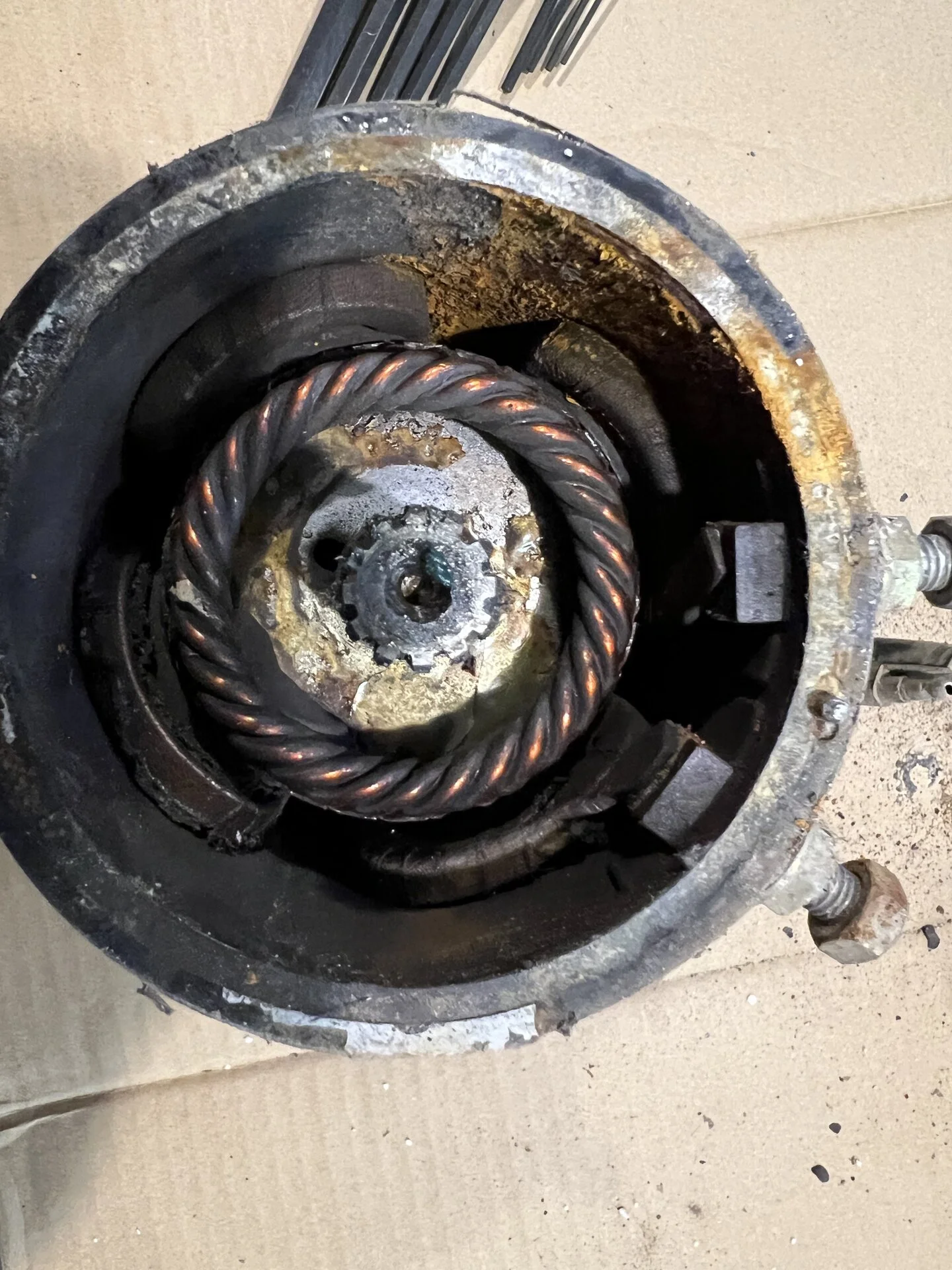

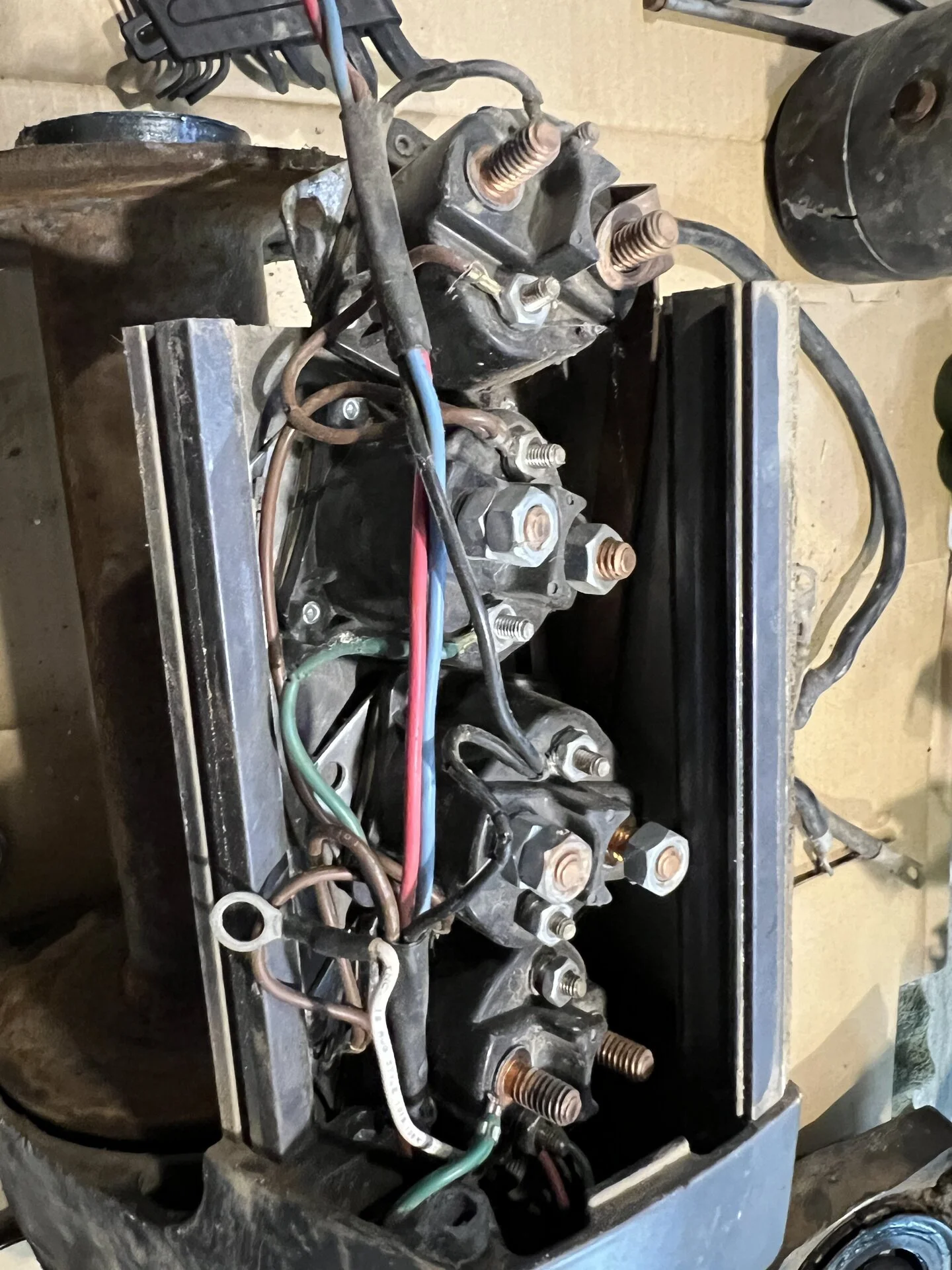

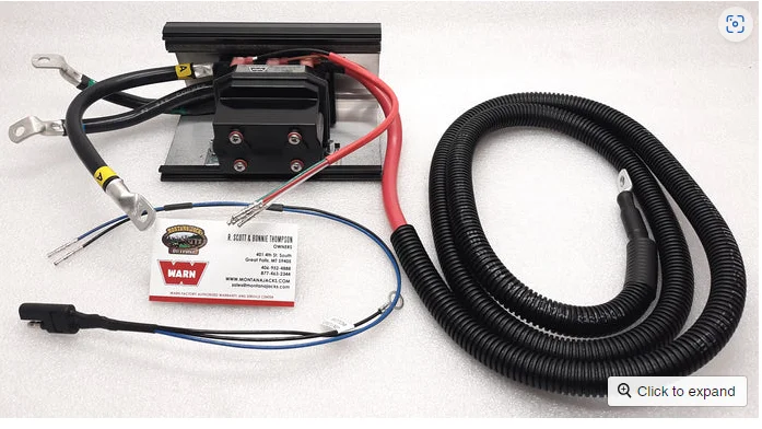

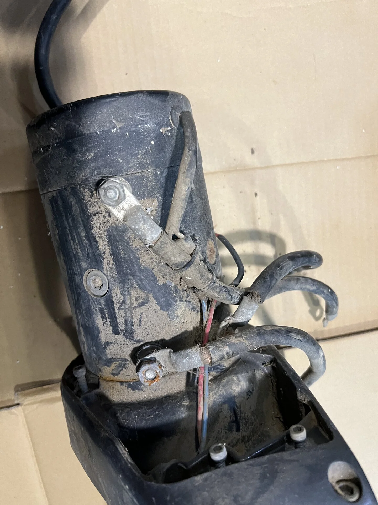

Finally started working on the winch I've stored for way to long for this project. I dug into this winch years ago, has some issues and gave up due to the cost to fix it and being a high school student. Its a Warn 9.5TI, it has no rope, apparently needs a new motor as the end cap is cracked, two of the solenoids are toast (the small terminals are just spinning on the nut are just pinning) and it's missing two bus bars. I know on the 8274s you can upgrade to an Albright connector, I see warn has this option for the Warn 9.5cti 9Upgraded model), does anyone know if this would be a direct plug and play?
My thoughts are I should be able to replicate this kit with an Albright and save a bit of money (Kit is $300 from Warn) and a genuine Albright can be had for $60. The thermal indicator is separate from the winch solenoid wiring which is nice.
I am going to strip the winch down angain and clean is thoroughly as it was sitting outside during a move and is roached. It looks like water made its way into the winch motor at some point too sadly. Plus I need to fix my screw ups of bolts not being tightened or missing in general.

edit: I was able to find just the V rings themselves which is what I needed. They’re Warn 63542. I couldn’t find that number on the parts diagram which made it harder to find

@Mudder as far as the winch thing. short answr is yes. all these winches are essentially the same. Definitely the same wiring. not sure if the Albright fits in the "integrated" part though.

I was hoping you’d chime in for the winch, your winch rebuilds are always amazing to look at. I have a super winch contractor on my 8274 I’ll mess around with before I order an Albright. Worst case is this one gets for new solenoids and I move on.

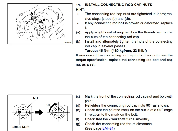

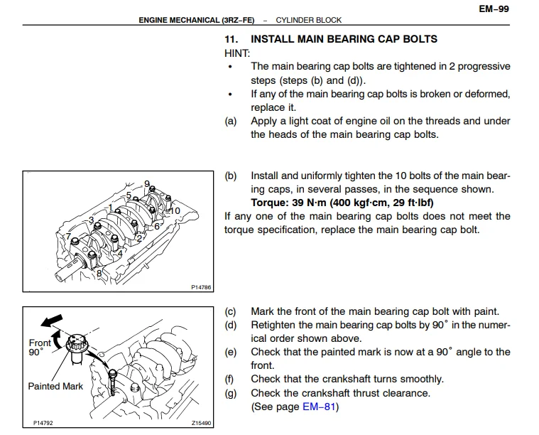

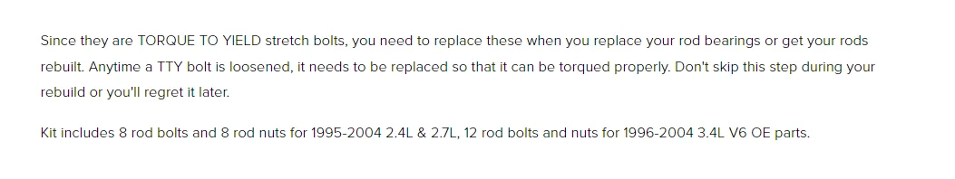

I'm wanting to start assembling the engine so I can clean up some garage space. Due to the condition the block was in I wanted to pull apart the crank bearing caps and rod caps to apply some assembly lube since it may be a few months before I start this engine. Looking at the Toyota FSM it states you can reuse the bolts as long as they meet the specs, however 22re performance says the the connecting rod bolts are TTY for the 3rz. Does anyone know the truth if the connecting rod bolts and crankshaft bolts are TTY? I'm not opposed to buying new bolts but I also don't want to if I don't need to.
1998 4Runner FSM
22RE performance Website (Connecting rod bolt and nut set — 22RE Performance - https://22reperformance.com/tacoma-engine-rebuild-parts/3rz-rod-bolt-and-nut-set)
1998 4Runner FSM
the exploded view is fsm should say. but generally when you're torqued in 90° like that, theyre TTY.
Well Damn. It's either order new bolts for a couple hundred or full send and hope Toyota coated them good enough. The FSM states to apply fresh oil to all sliding and rotating surfaces too.

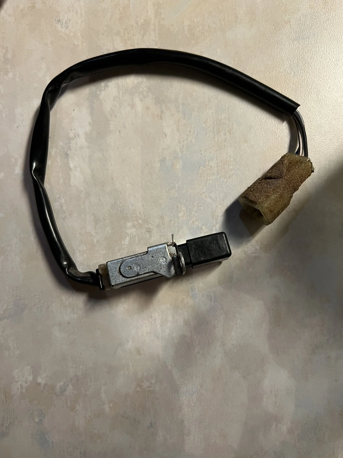

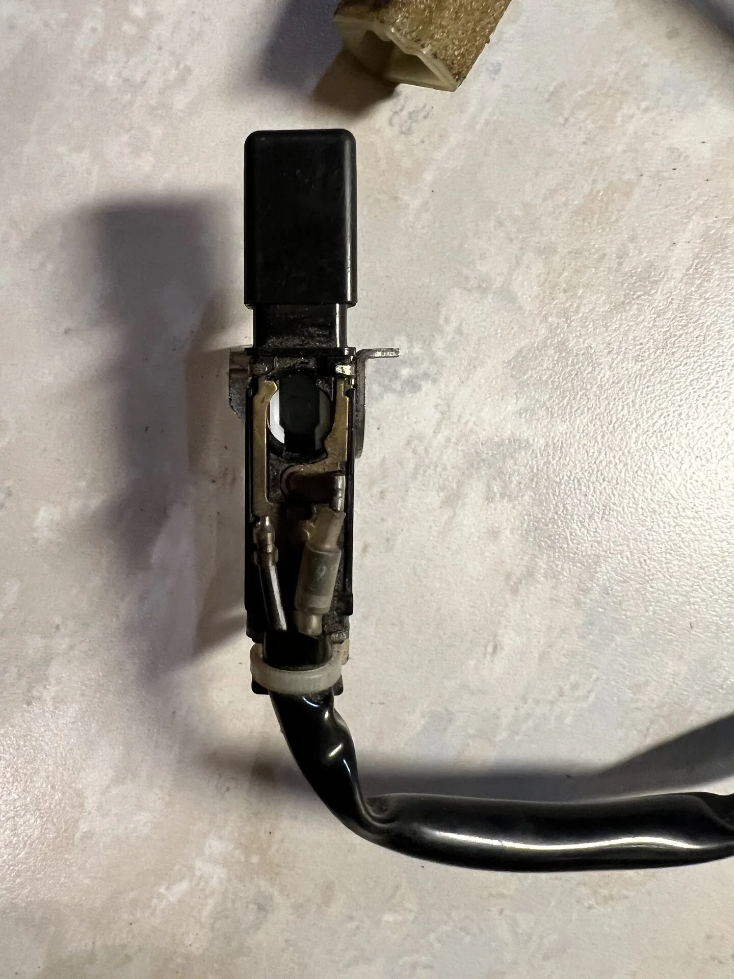

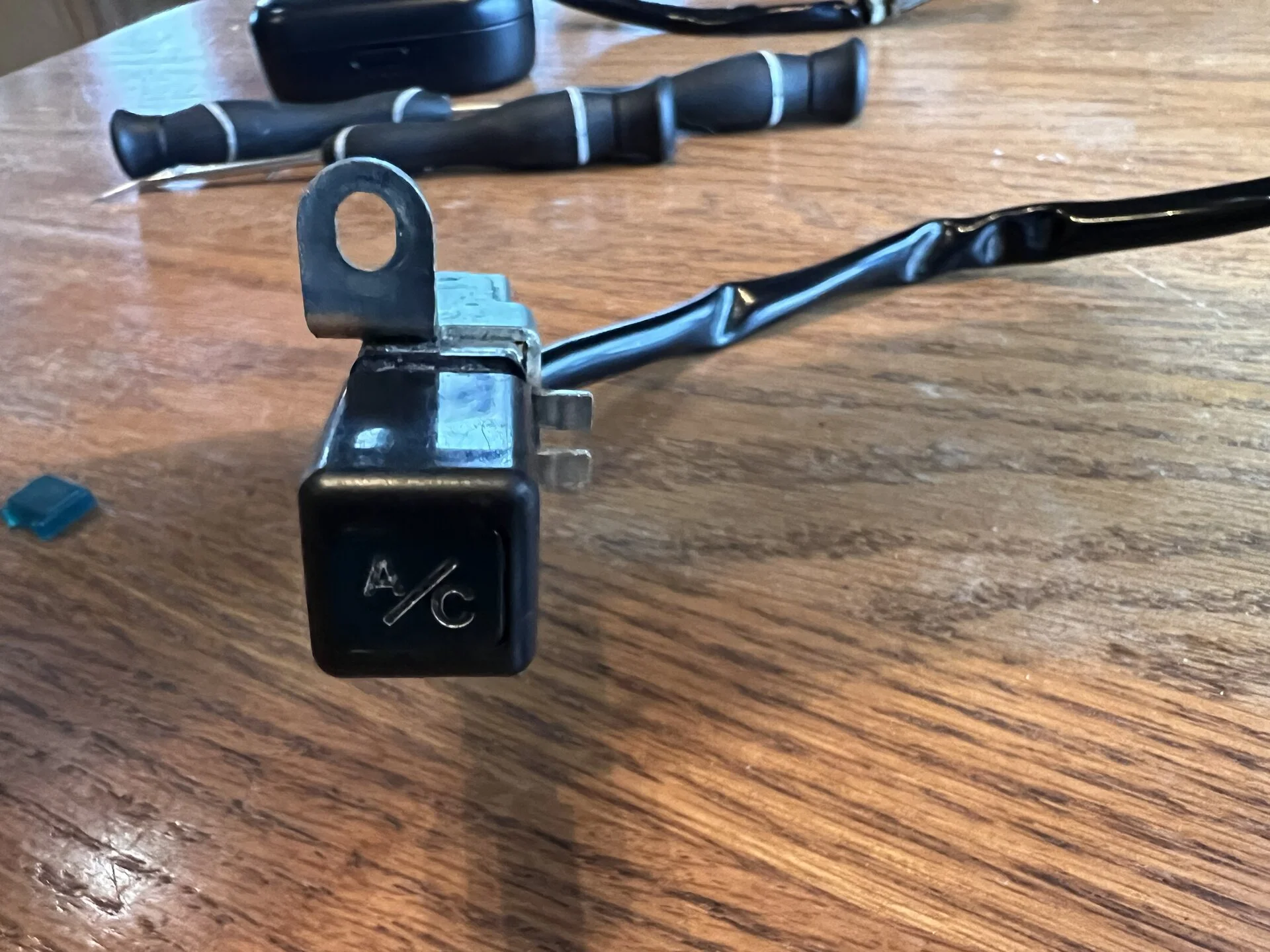

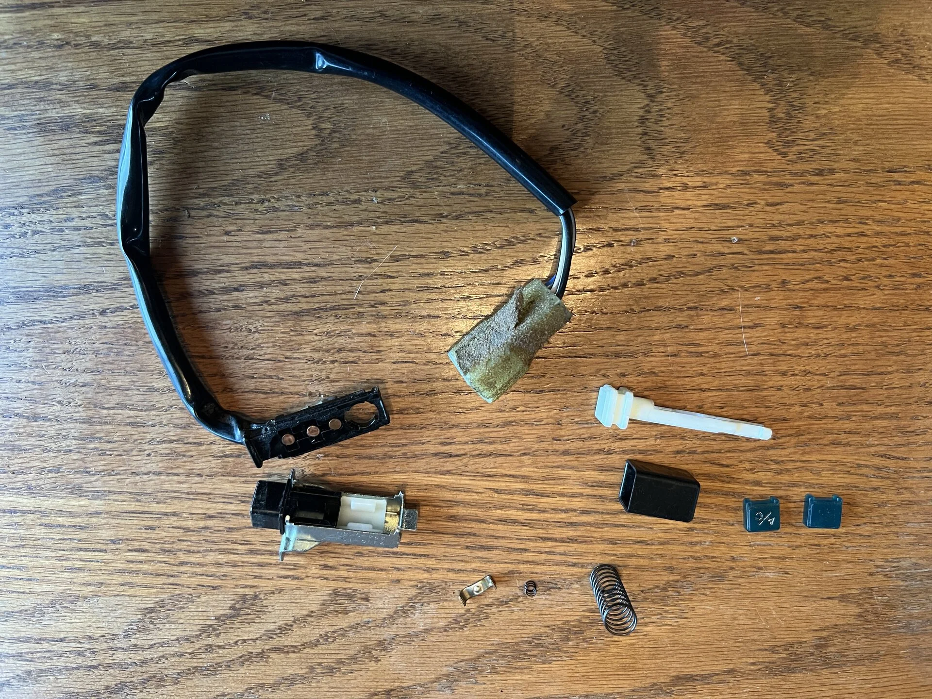

Does anyone have any insight on how to remove the push button section from this switch? I broke the original one I had and I want to swap the green cover over to the new switch (the old one still had AC wrote on it and the new one doesn’t). I tried putting a bolt in the hole at the bottom and that didn’t get me anywhere.
I figured I’d ask before I try more and break it and have to buy another one.
Yup, that is what you have to do. I thought I had remembered pulling it apart years ago.
Switch fully disassembled, you can see the plain green plastic cover next to the on with AC wrote on it.
Contact switch and plate installed, don’t forget the big spring as well that pushes the button back out.
Fully assembled with the other green plate in. Took me about 15 minutes to do it all making sure I didn’t break anything.

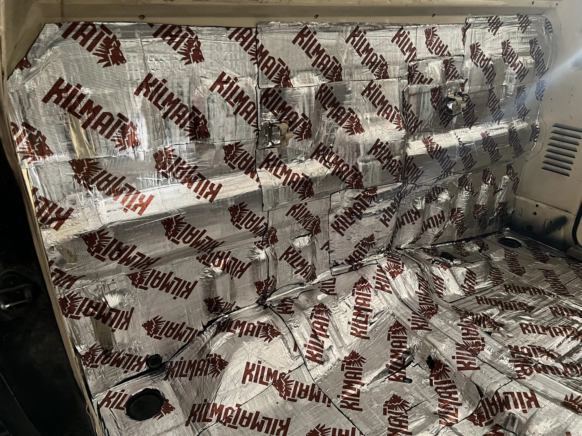

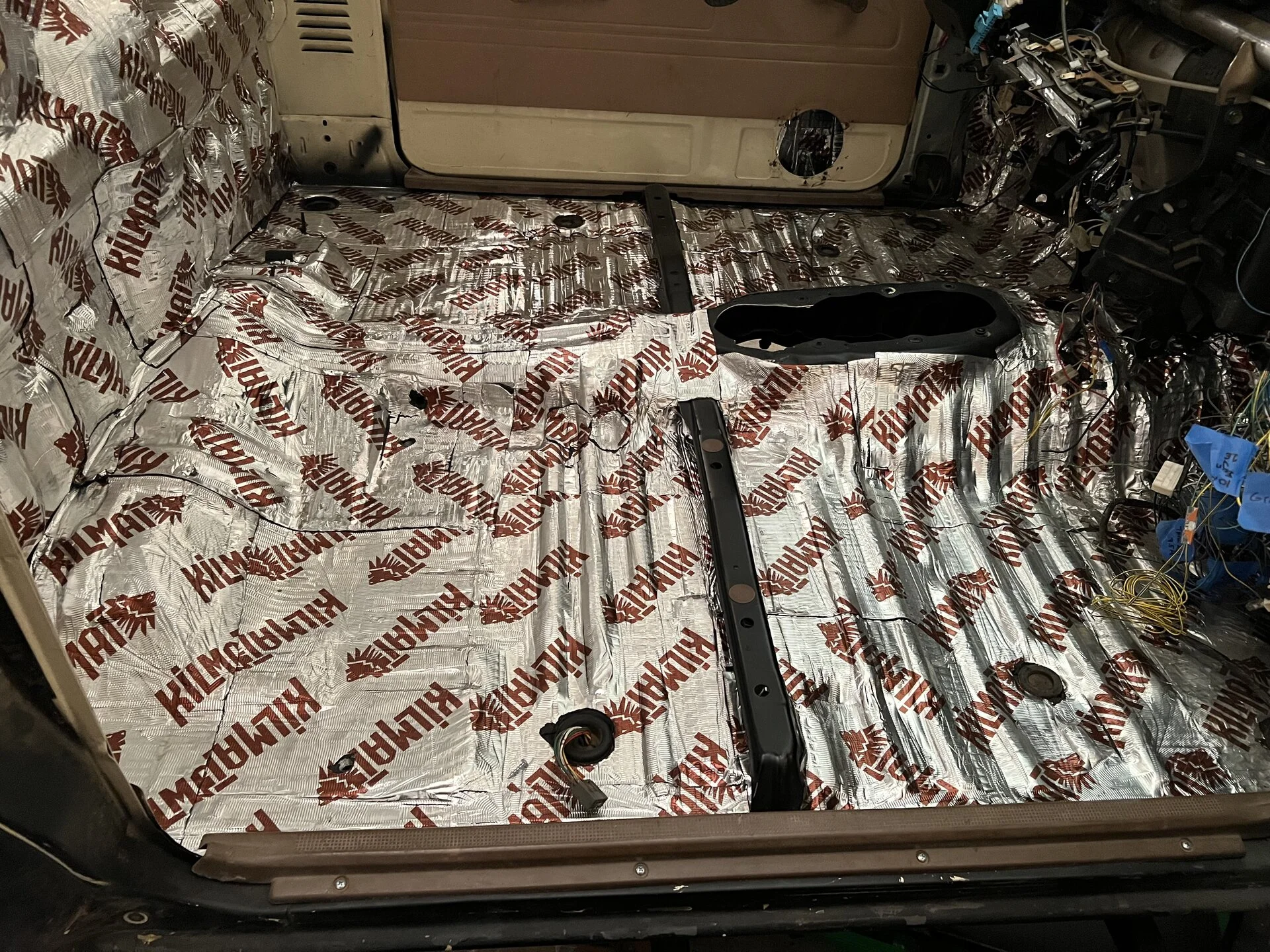

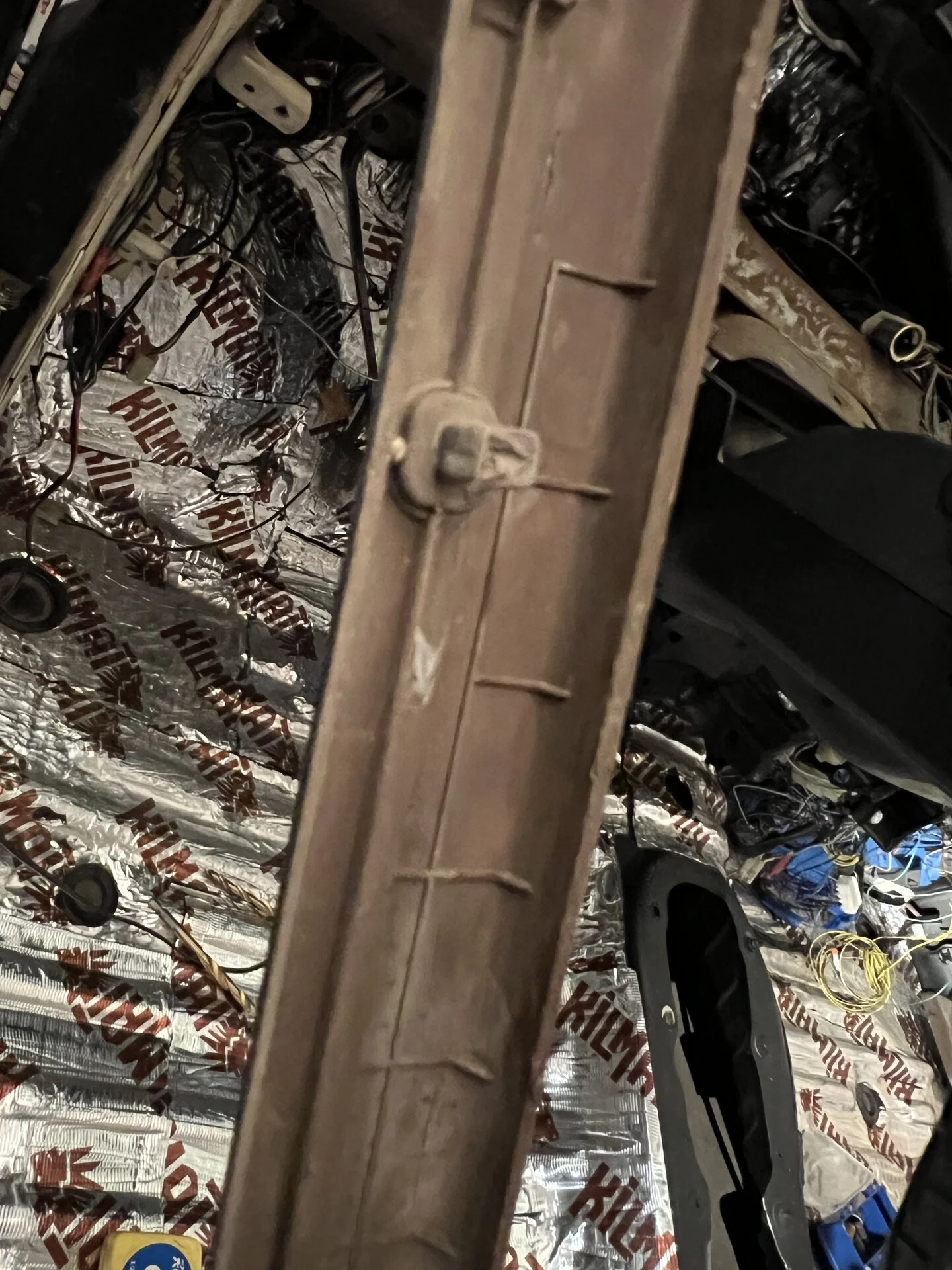

Ended up getting a bunch of stuff installed today. New brake lines from Marlin, finished the sound deadening, and fixed the bottom door trim.

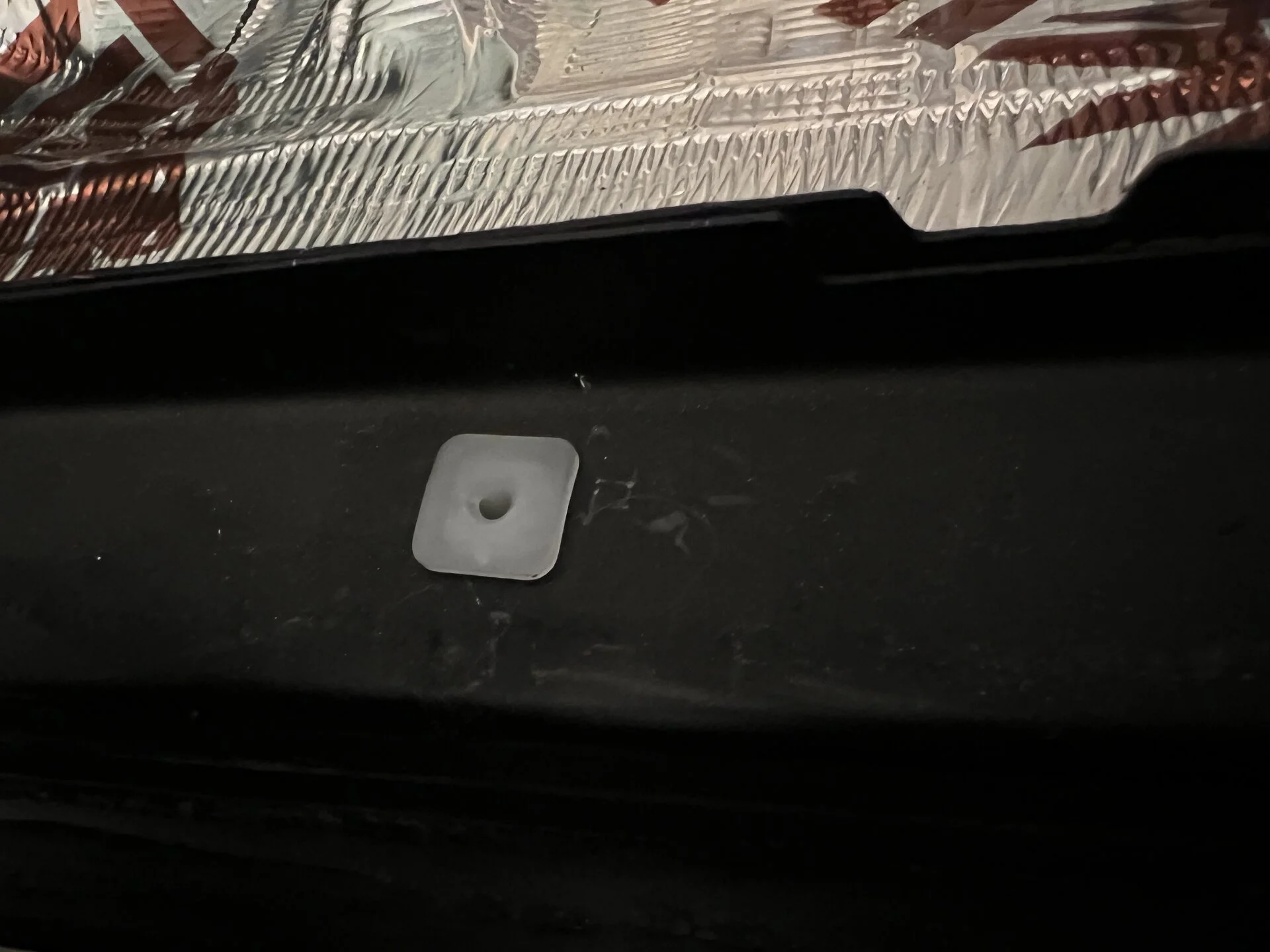

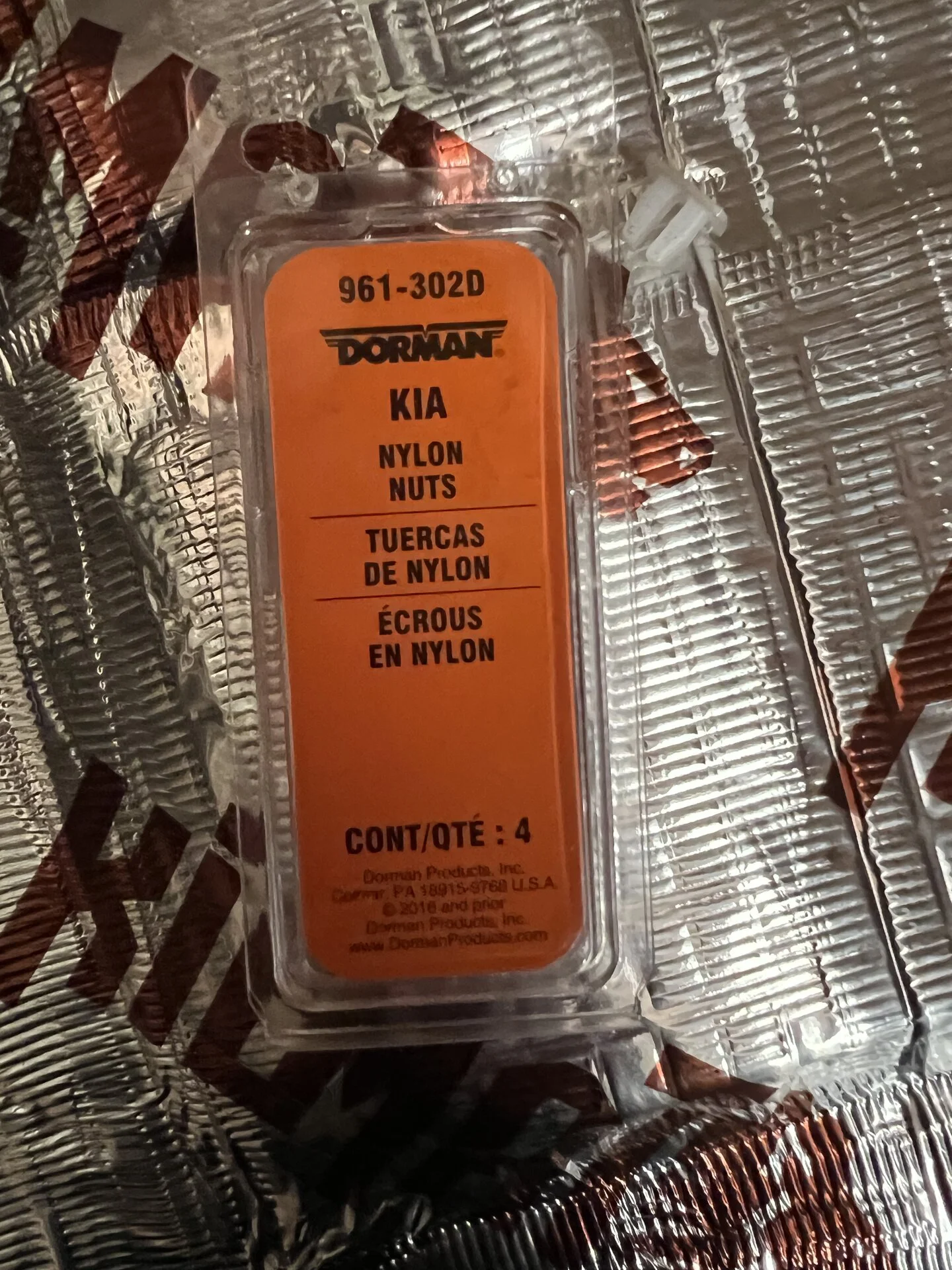

For the door trim, I ended up cutting off the old plastic and used a dremel to open up the holes in the door seal do that the new nylon nuts fit.
Cut all four of these off
New nylon nut installed
The nylon nuts I used. These are what my local auto parts store had in stock.
This truck better be nice and quiet after all this. I did inside of the doors as well, it took me 54 sq ft of material to do it all and I had none left over from it.
I like the nylon nut fix. Thanks for posting that.
Is a box of that Kilmat heavy? When I removed the OEM sound deadener from my floor I threw it all in a plastic trash barrel as I chipped it out. I was shocked at how heavy that trash barrel was. I thought I MUST have some steel or something I don't remember throwing in it. Nope, it was just the sound deadener.
I also know how freekin loud it is in the cab without it so I don't know what I want to do. Carpet helps but its not really enough. I put new carpet in my 88 with thick carpet mats and it was still pretty loud inside.
@aztoyman, the box was pretty heavy. They claim it weights .5 lbs a sqft, so what I should weigh about 27 lbs. I’m hoping between this and the new carpet this truck isn’t nearly as loud as it used to be. I had the exhaust dumping right past the rear axle with a steel flatbed and factory vinyl flooring. I haven’t used kilmat before so I’ll be curious how well it does hold up.

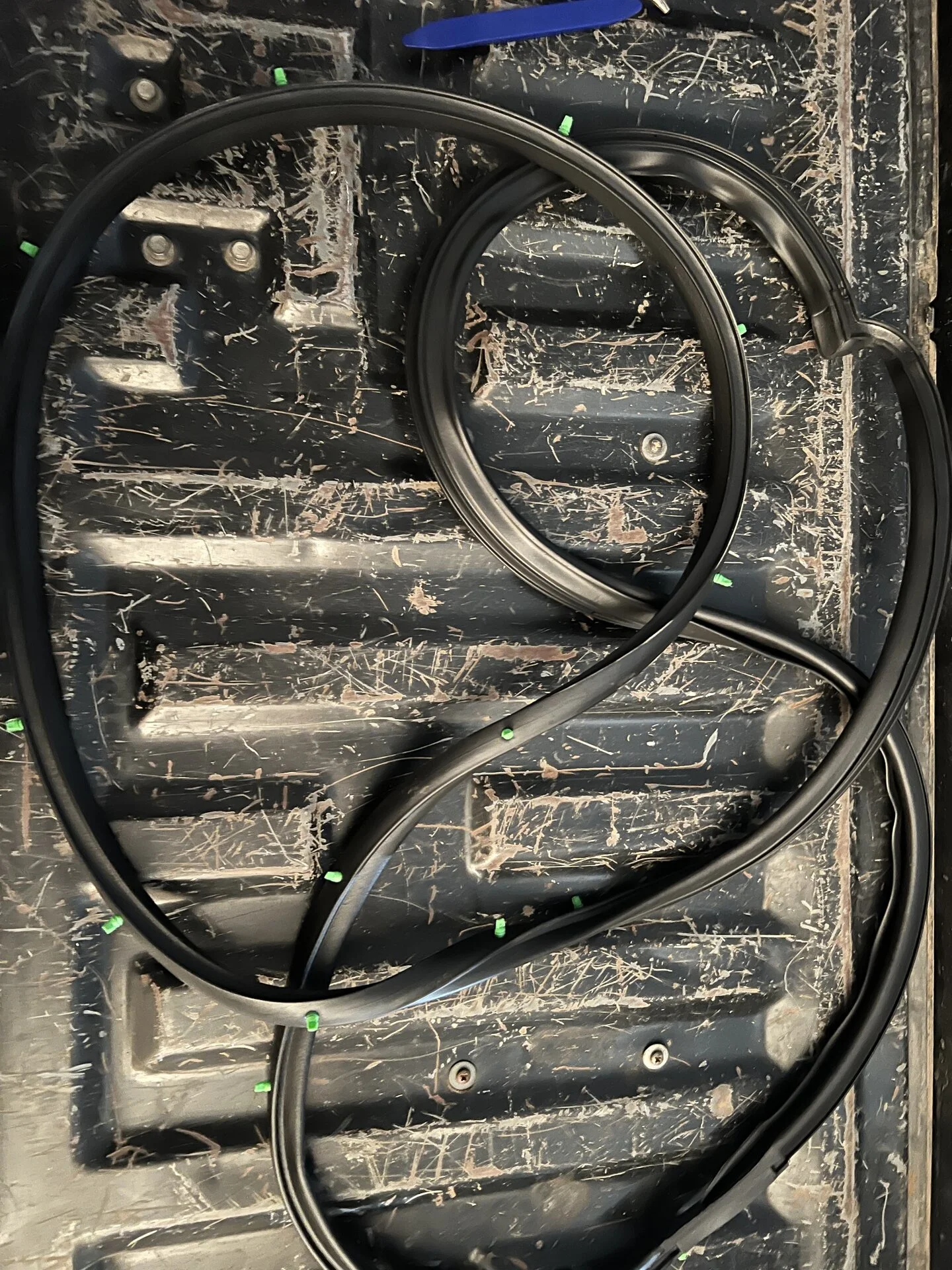

Ordered new door seals from 1A Auto. I’ve bought some mirrors from them in the past and was happy with the quality so I hope these don’t disappoint

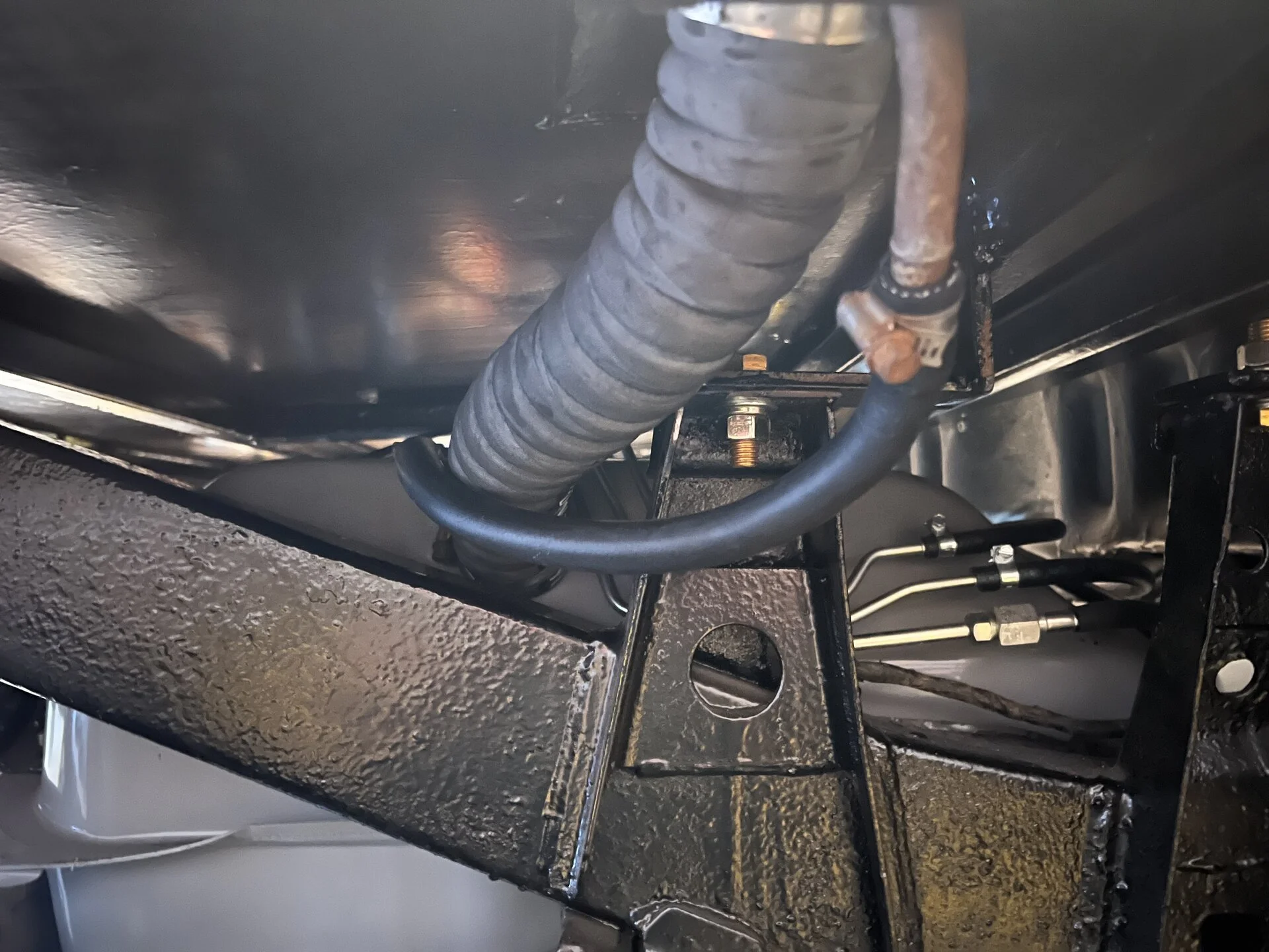

I also got the new filler neck in. It’s generic 2” hose (stock is 1 7/8 but no one has that around here and shipping was a deal killer for me). I’m hoping it fills better this time. I had a s*** angle last time and ended up having to drive up on a block of wood every time I filled it.
I also ordered some 2” rubber grommets. They don’t fit super well so they may get changed out if they keep falling out once this thing is going down the road.
