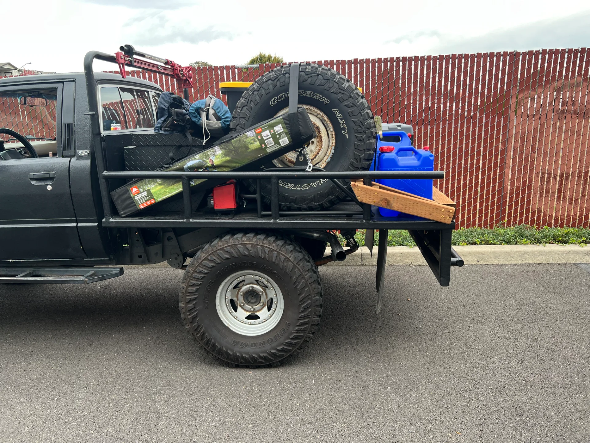

I also built a ghetto wooden “tailgate” for the flatbed. I wanted something for CTW to help hold gear in the bed on the way up without only using ratchet straps. I’ll have to get a photo of that later and I installed the 315 cc injectors. Those just got put in today but already seem promising. At idle STFT (while it’s still learning) is barely +10% which is similar to what I’ve observed from stock injectors and the truck being N/A. Once I get some drive cycles in and it can learn the fueling I’ll report back with more data. I did a nut and bolt check of the exhaust and it’s holding good. The only issues I found were from the exhaust shop not having a damn clue. I had watched them use a 13mm short socket on the O2 sensor nuts which are 12mm and genuine Toyota so I knew I’d be fixing that.
