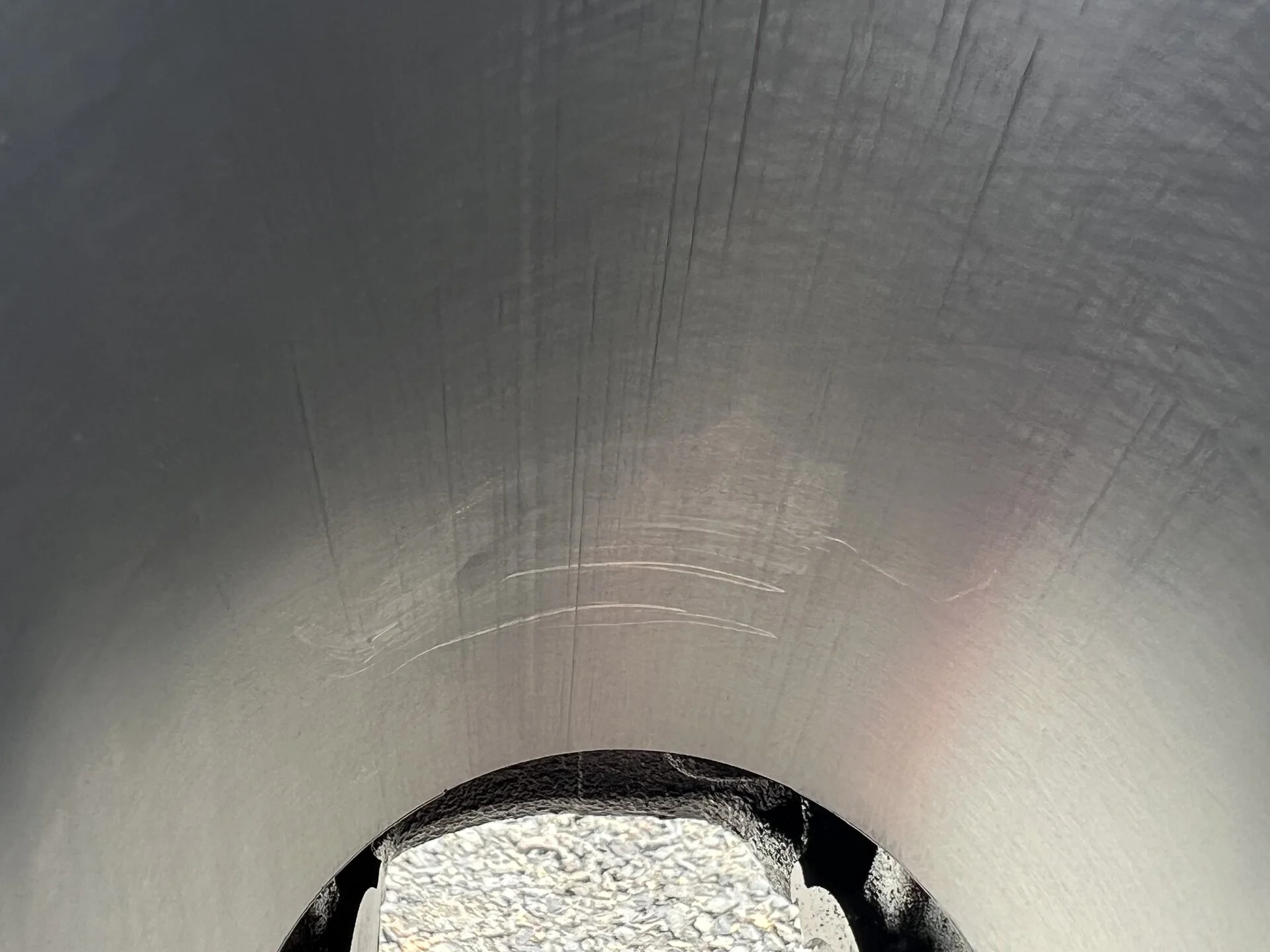

Because I’m an idiot I’m going to try and ball hone it to see if the grooves will clean up (highly unlikely) if not I’ll probably buy a Toyota short block as they only run 2800. The machine shop was willing to bore the block but not do any assembly whatsoever and by the time I added up new parts to put in a bored block to was close to the same as a short block.
Well, to no one’s surprised the ball hone did not work. I can still feel some of the grooves on cylinder 3, because of that it’ll be a new short block from Toyota. I did get the new fuel tank in so I’ll be getting the lines ran and I can use this engine as a mock-up if needed.

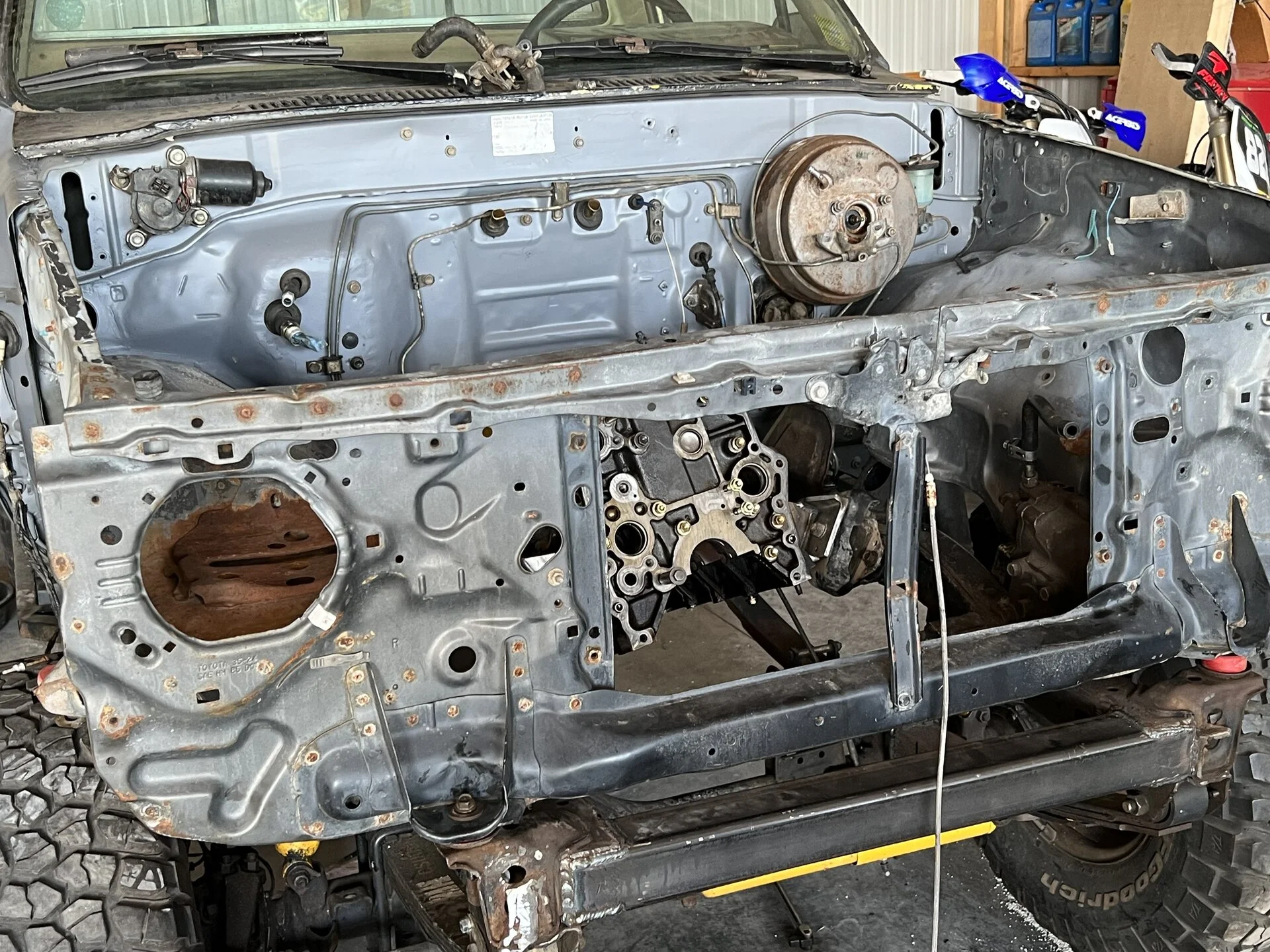

Front cross member is burned in. Used some 2.5x2.5x.250 square tubing. I’ll figure out mount holes for a bumper later. If anything I’ll just weld the damn thing on anyways. The front clip is just sitting on there for now. It’s going to take some work to get it sitting right it seems. I may end up pulling it off and comparing it to the original front clip.

It appears that the front clip from the 88 may need to have some metal cut out around where it mates to the upper portion of the cab. I’ll confirm this tomorrow if I can. I do appreciate the offer if I need measurement.

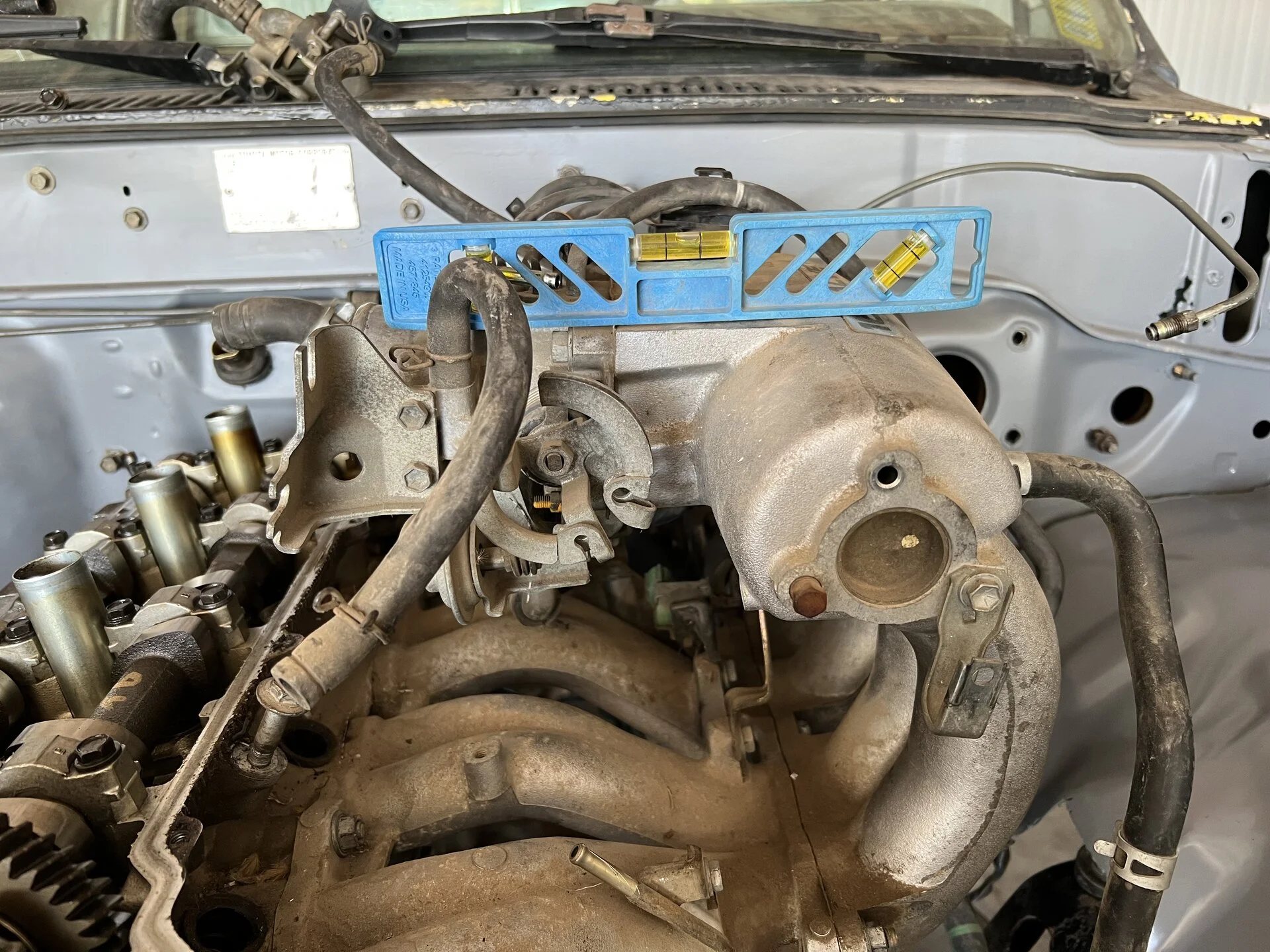

After looking at more 3RZ swap photos of the engine, it does appear that the engine itself doesn’t sit level but the intake manifolds should. I feel like an idiot not realizing this if that it is the case.

If I understand you correctly, yes, the engine sits canted towards passenger side just as it did in the donor truck. 5 degrees. That makes the bell housing line up correctly to the trans without having to clock your trans if the motor was sat vertically - along with fitting a tall engine in there im sure.

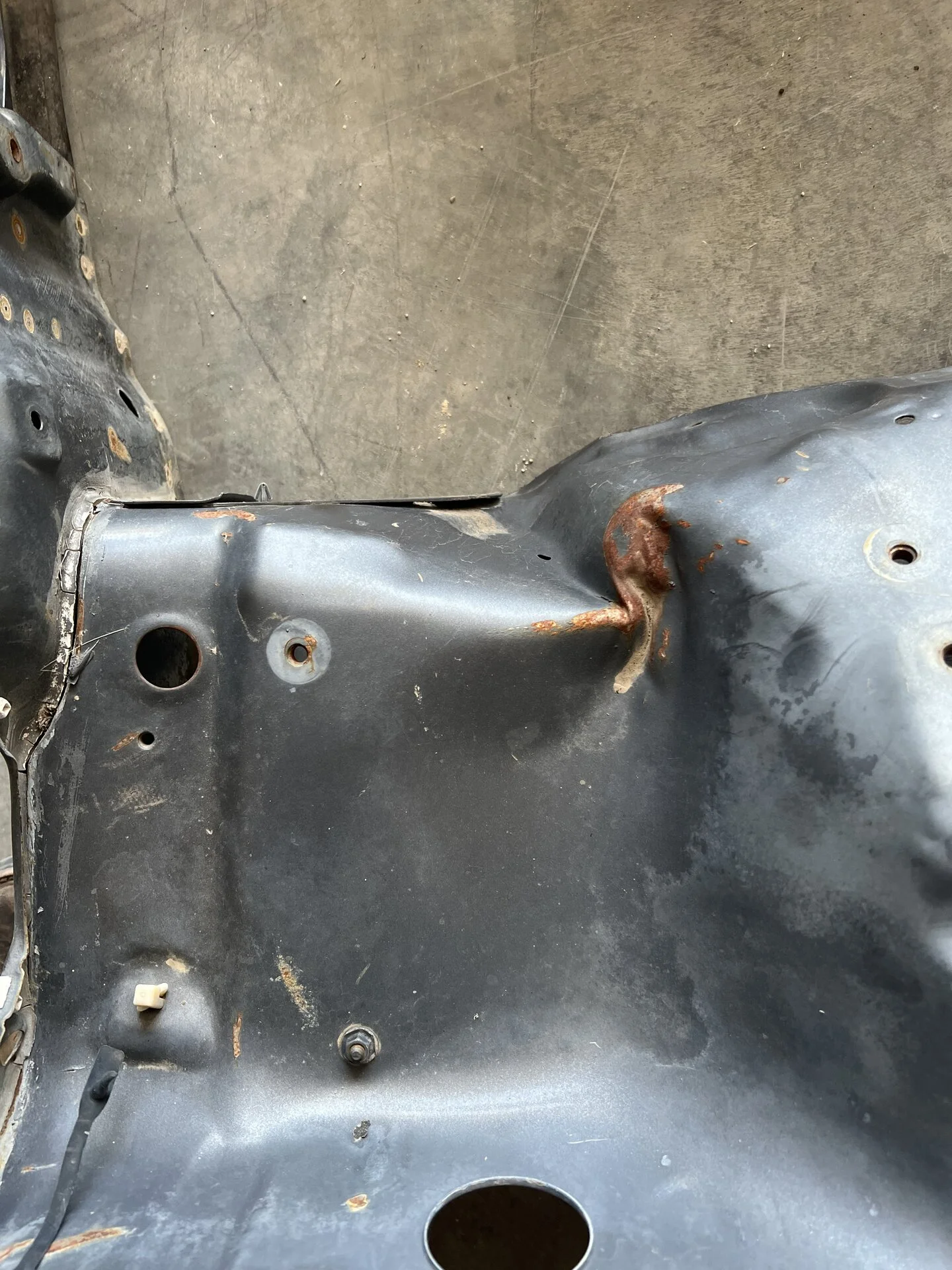

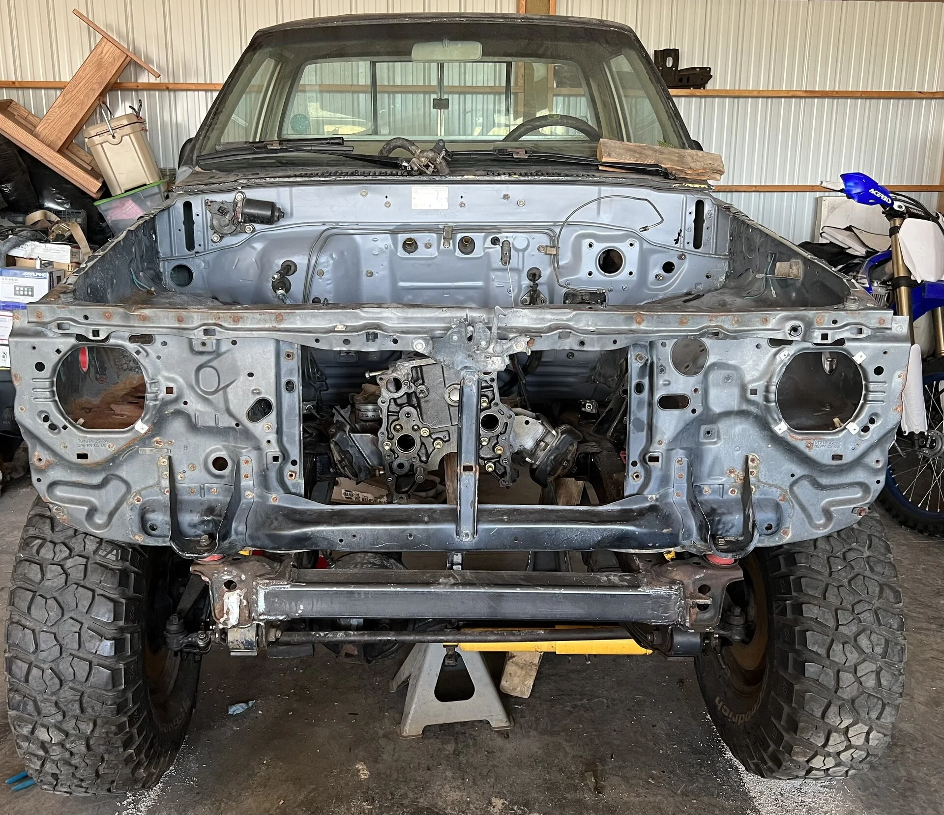

Well the front clips is welded in. It fit like s*** and the welds look like s*** but I’m not about to buy a new cab and the cab this clip came off of was trashed as well. There was some damage to the inside that I got out as good as I could from it being in a wreck as well. I only have an initial picture, next time I work on it I’ll get an after picture of the damage.
Before
After, still not the best but it should work.

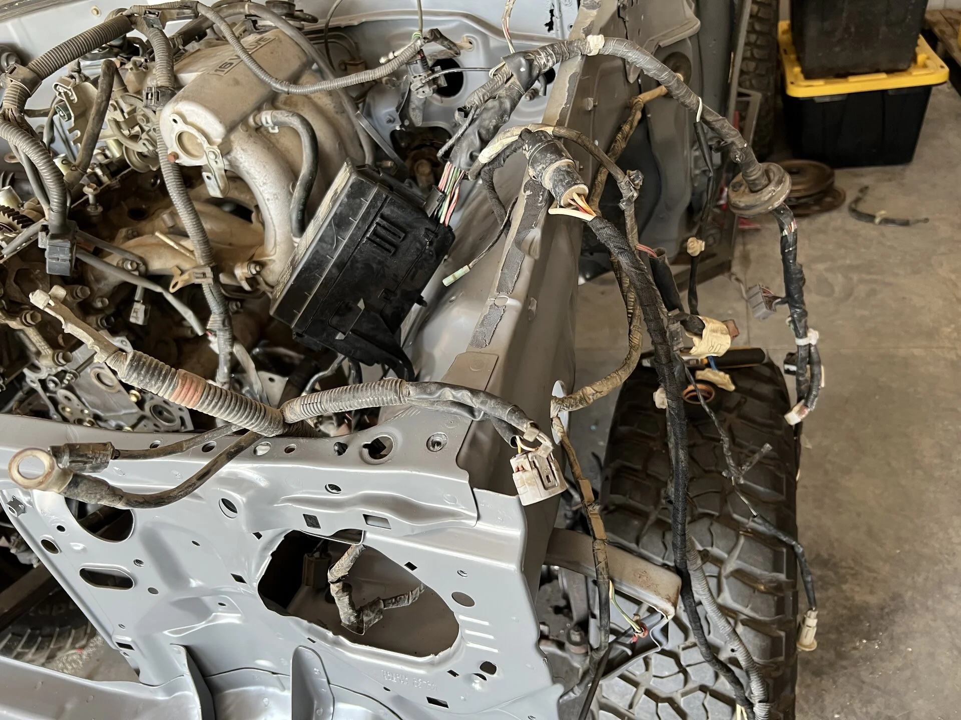

Front clip is painted, battery tray removed, and the 3RZ is “in”. This is so I have a clue where this spaghetti of wiring goes so I can start figuring it all out. It’s mostly labeled from but a few have fallen off. I did get a level in the intake manifold and I am happy with it. The supervisor even signed off on it!

That being said, for the engine bay wiring I’m wanting to remove as many unnecessary circuits as I can. I’ve read some of the 3RZ swap thread on Marlin Crawler and a few on Pirate but I want to be 100% certain so I don’t F it up. I struggle a bit with wiring as it always feels daunting.
I do plan on using both the 3RZ and 22re fuse boxes in the engine bay.
From the 22re, it looks like I can remove the factory alternator wiring and use the 3RZ stuff, is this correct or will there be a dash light thrown?
From the 3RZ engine fuse box, it looks like I can remove the head light wiring. And for the starter wire, is there any “special” way to connect that? I know for the old 22re wiring I had to use a starter solenoid from a Ford Bronco due to voltage drop issues with the wire. I’d like to avoid those issues this time.

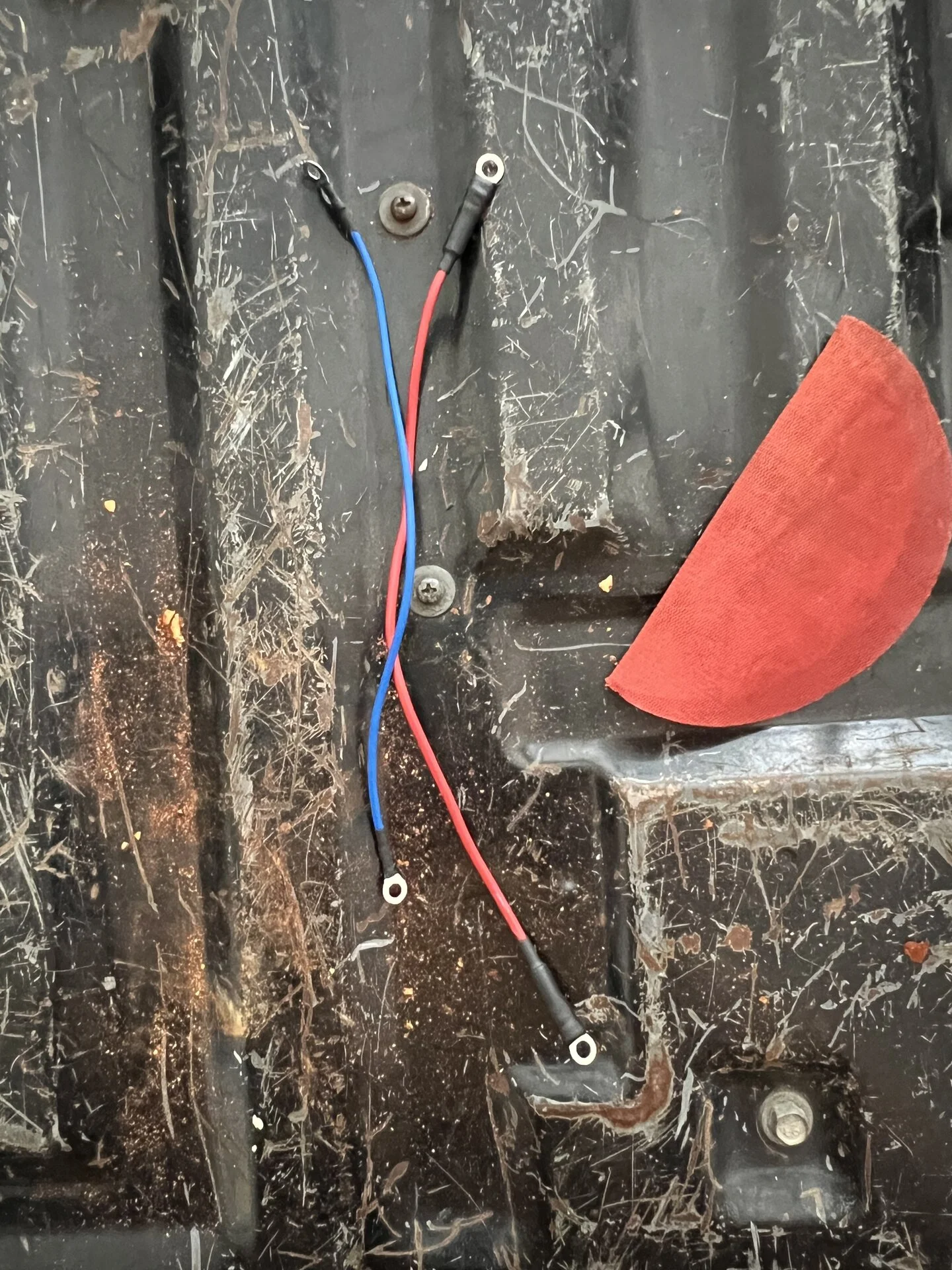

I did get the fuel pump bracket mounted but I ruined the hose from the metal line to the fuel pump assembly so I’ll need to figure that out. I did have to make a new hot wire for the fuel pump as the supplies one was way too short.

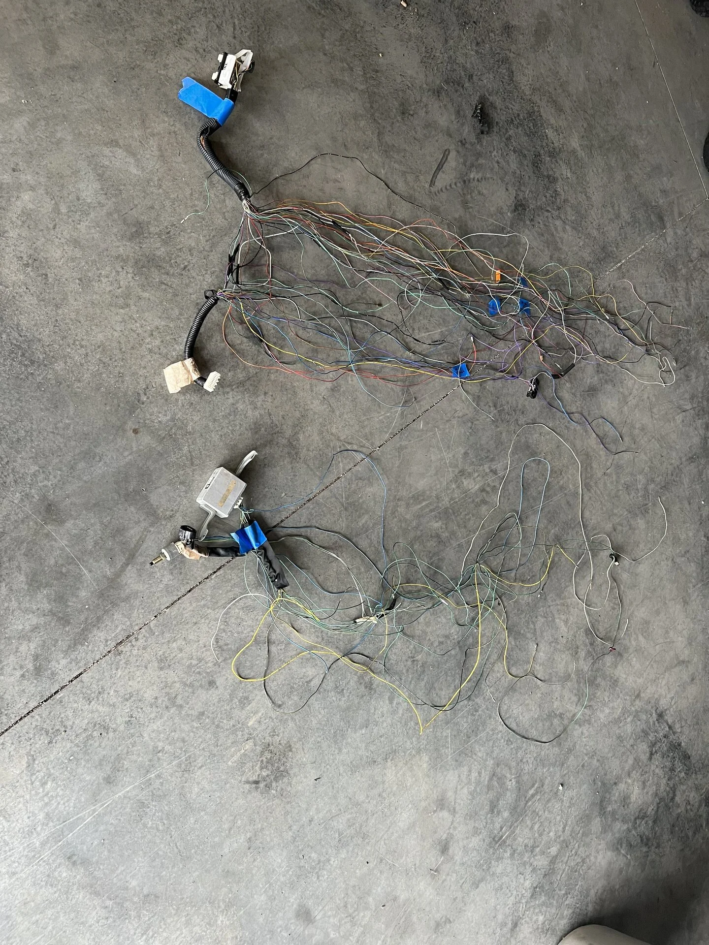

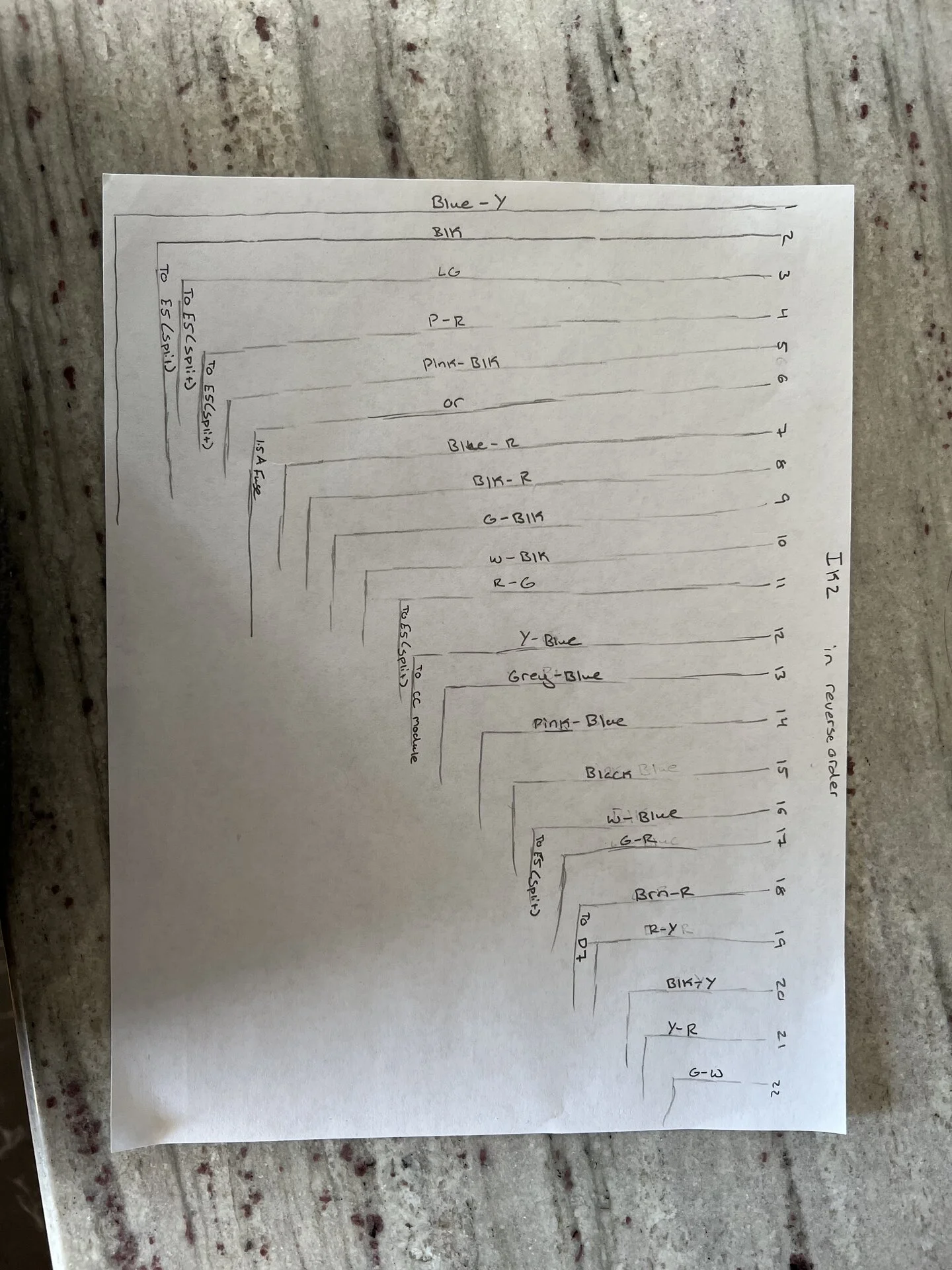

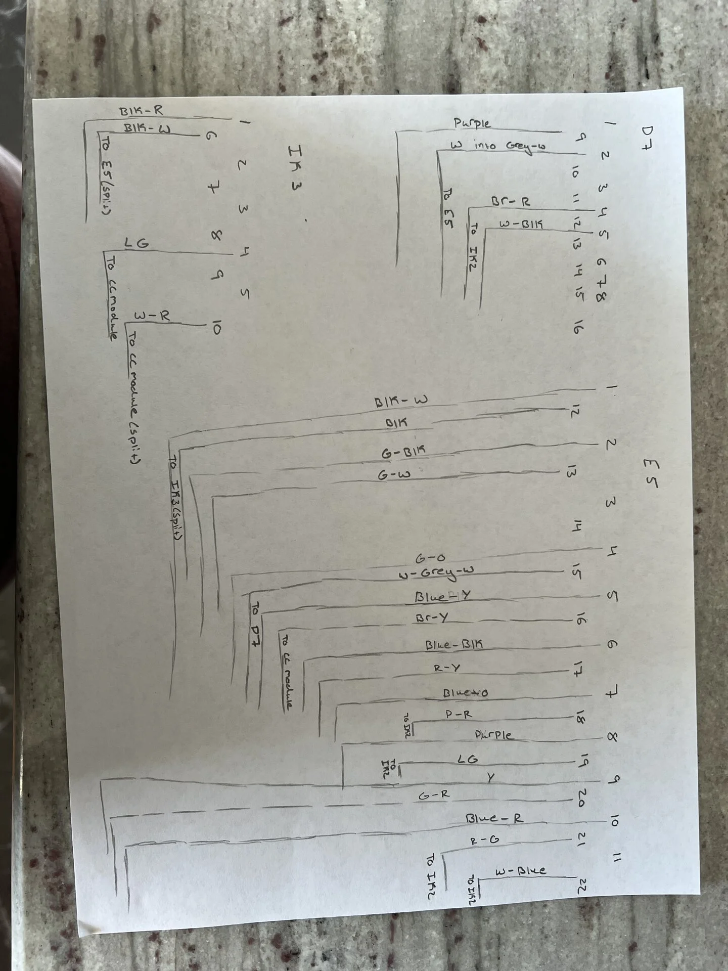

IL2, E5, D7 and all the cruise control wiring is pulled. I depinned all the wires from their original connectors. I’ll remove that wires I don’t need once I have them identified.
This is a work in progress, but posting it here in case something happens to the photos or papers.
