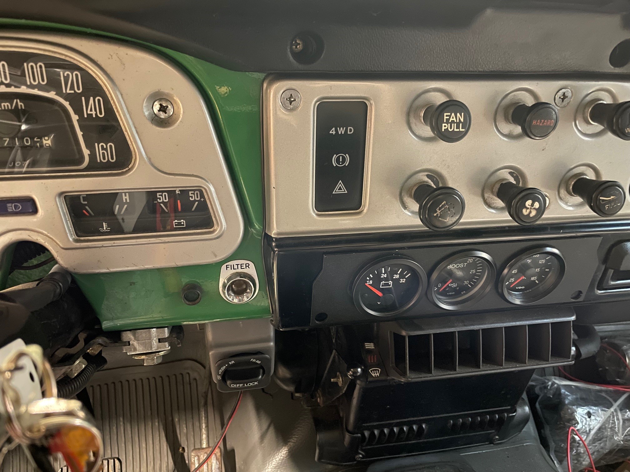

I installed a simple USB-B and USB-C charging port. I wanted one without any LED indicators or and lights at all. Plain and simple to match the simplicity of the 40. This piece is made of aluminum and seems to match the style very well (installed below cigarette lighter). I made a small sub-harness to wire these and be able to easily remove it if needed.

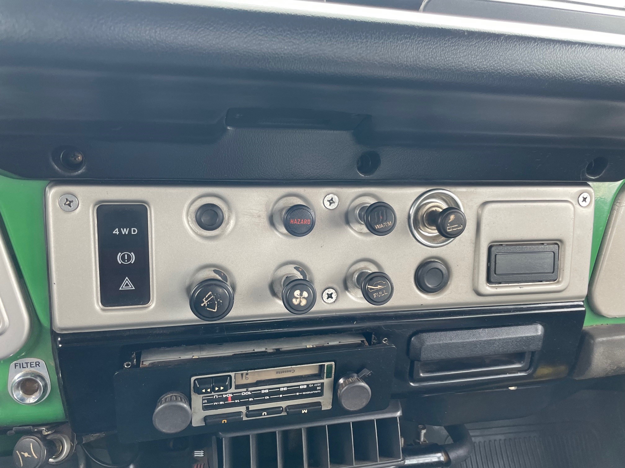

I wanted to use factory switches to trigger the ARB compressor for the lockers, and also for the lockers themselves. Ofer @ofer bruhis donated a factory pull-type switch to trigger the ARB compressor (the FAN PULL switch on the upper left), so went ahead and installed that:
(THANKS OFER!!! @ofer bruhis )
Also, bought the "correct" knob for the pull switch from Red Line Land Cruisers, only to find that the threads are different than the ones on the factory Fan switch :bang: . Will have to address that later. Kudos to Red Line Land Cruisers for making these for us.
Finally, for those using a VDO EGT gauge, when you buy the gauge, it doesn't come with instructions. I found them online and put them here to share. One of the key things is to "NOT CUT THE SENDER WIRE" as indicated below:
Now onto the locker switch itself.
Again, I wanted something clean and factory looking. I decided to use an early metal dash-type 70-series locker pod and switch (same as the 80-series locker dial switch) to trigger the lockers. I had to move over the hand-throttle cable but I think it looks like it belongs there. I thought about painting the pod black, but, my door cards are gray, my factory floor mat is gray, and my seats are gray, so gray didn't look too out of place.
Photo of the location of the hand-throttle cable before moving it over:
Photo of the locker switch in dash:
And then with the hand-throttle cable reinstalled using the one of the bolts that holds the center piece.
(The locker switch is not completely pushed in as I have yet to run all the wires, but it is getting there).
All in all I am really happy with how the dash is turning up, and the best of it all is that I didn't have to drill a single hole to make this happen. A win in my book.
