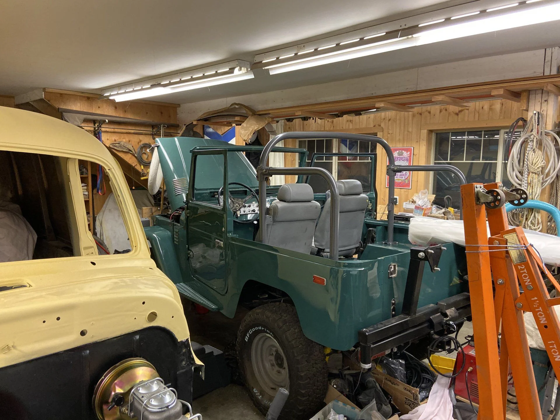

Roll bar is back from powder coating and installed this weekend. Only had a couple hours or so to work on it, so did what I could. Ran the engine up for the first time since building the harness and am pretty happy with it. Cycled the thermostat and got the Danhard heater bled out.. Wow is it ever great! Throws off a ridiculous amount of heat. Biggest drag is that my alternator regulator is dead, so I'll pull the alternator back off and convert it to internal reg. I'm also going to add a tach pickup while I'm at it.
One of the strange mysteries of this truck is that it came with a factory tach and wiring, but no hall effect on the bell housing..? Weird stuff. Instead of messing with the factory setup I'm going to just install a Stewart Warner tach in the factory location and run it off the alternator like a normal person. We're already no where near stock, so lets not kid ourselves.
Here's a crappy picture of my progress.

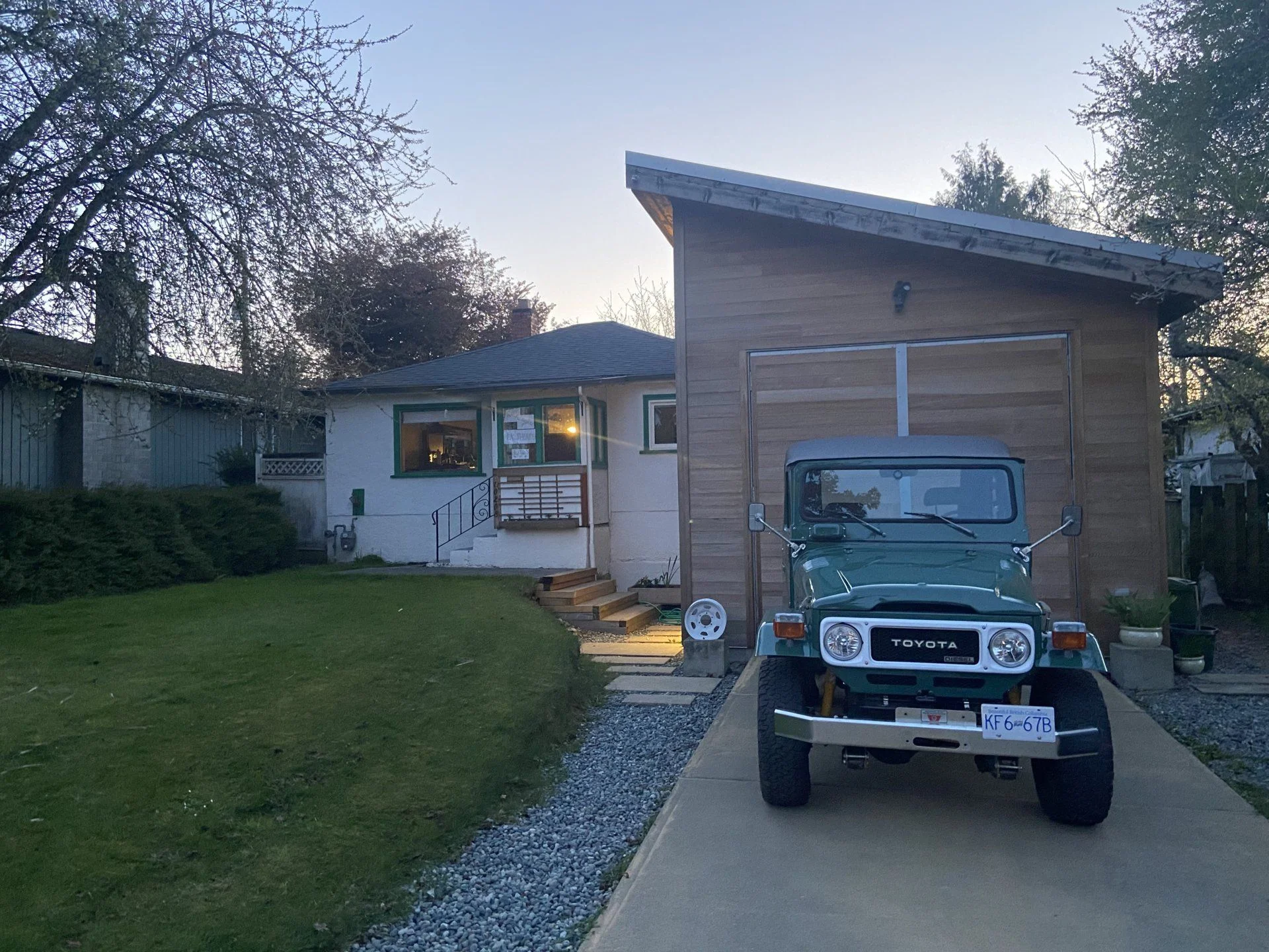

Things are looking up in the Landcruiser department! I fortunately/unfortunately bought a house so my January was totally eaten up with general household renovations. The good news is that the house has an enormous landcruiser-ready shop so my baby will be there soon.

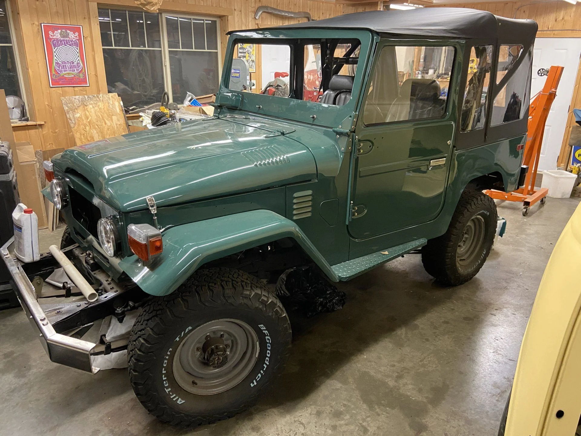

I did, however, make some time at the end of the month to jump ahead of some of the little things I had been neglecting. I finally replaced all the flex lines in the brake system that I had installed a couple years ago with stainless steel and secured all the hard lines to the frame. I had been putting this off because brakes are boring. The hardtop, unfortunately, just isn't going to work. I'm mating a used first gen Aqualu tub with a second gen cowl and the whole body is 3/4" out of square. Door gaps against the top were horrendous and I got tired of screwing around with it, so I bought a Bestop soft top to get me through until I feel like putting a shim between the cowl and tub on the passenger side to correct the issue.

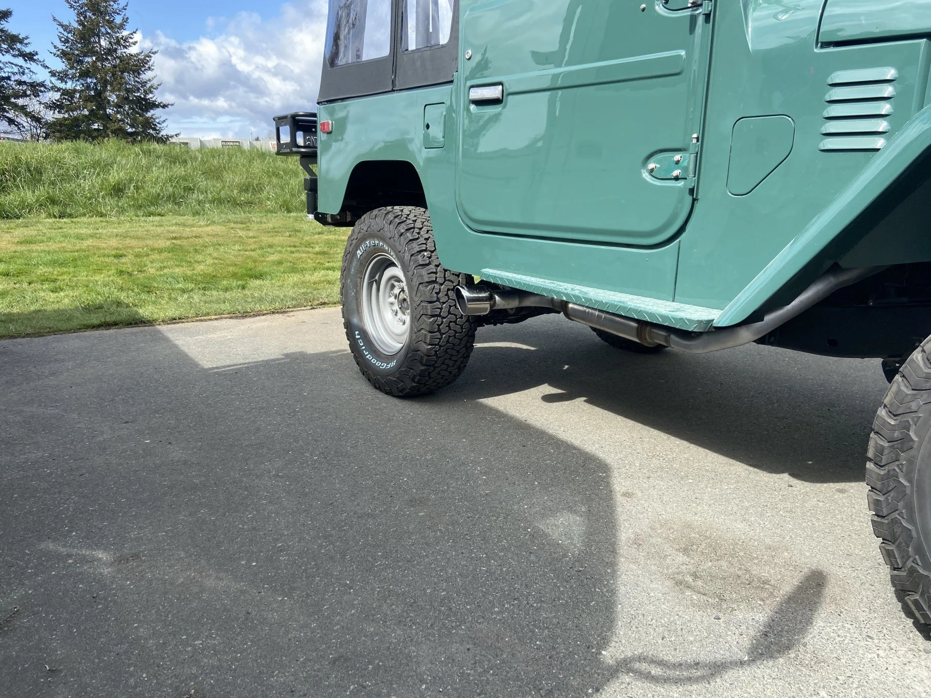

- Had an exhaust made... I dont own a tube bender and with work, Covid19 and renovating my new house I just wanted to knock this off. I drove the truck from Nanaimo to the Victoria area with a stub sticking out under the passenger front wheel and the noise was a bit nuts. I understand your perspective now, Varty!
The exhaust on this guy is 2.5" through a 6x14" magnaflow pass style through muffler with a 4" magnaflow rolled tip. I wasn't really into the tip at first, but the exhaust shop guys did a pretty sweet job and I think it sounds great.

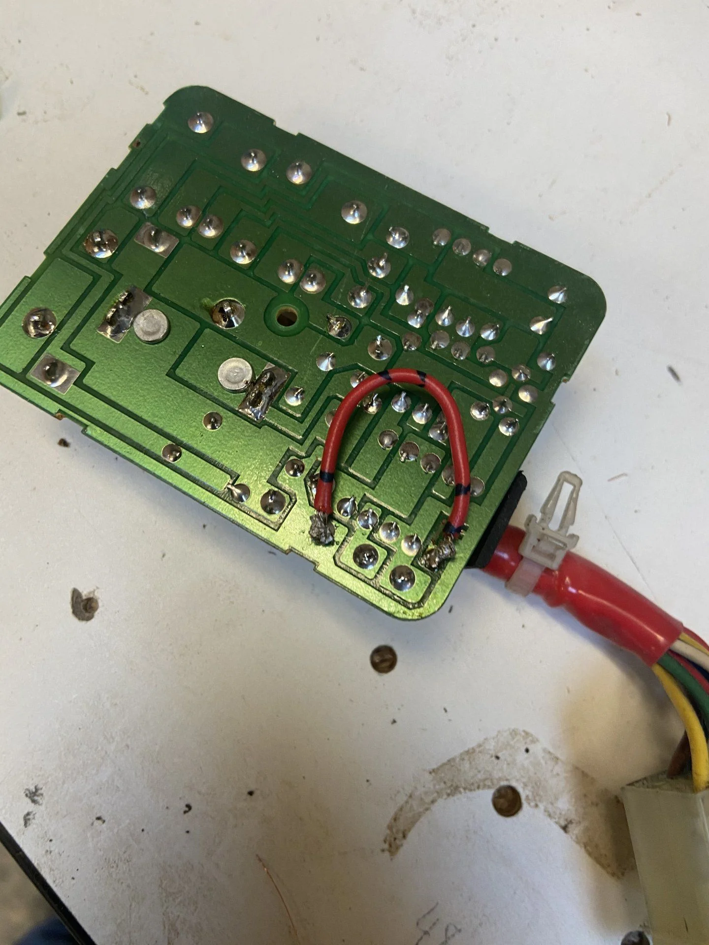

I’ve been shutting the truck off with a piece of string through a pulley tied to the steering column. I’m a bit over that, so pulled the EDIC relay apart and found a small section of circuit board was broken.. since nothing appeared melted so I casually soldered this small section of wire on there to bypass the broken bit and now it works! Ive got some more work to do on my homemade harness so will integrate this system in there.
