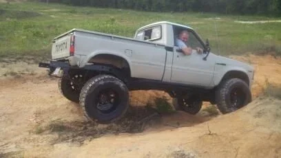

Looks like I only have one that actually has my truck in it.
Edit: This is sitting at the bottom of 4 right before I failed to go up it. Or, rather, I succeeded in only going 1/3 of the way up.
"before I failed to go up it. Or, rather, I succeeded in only going 1/3 of the way up."
You gave it hell, and I am proud to say I was there when you did make the 1/3. Trail 4 was no joke.
