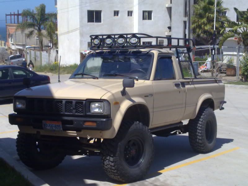

Sorry the pics aren't great. Small size and from a camera phone. This is about 2 seconds before I went down the steep part of the hill and had no brakes and almost needed a change of pants. :o
