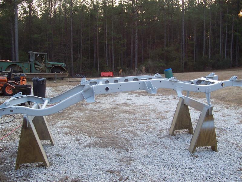

I originally bought this in 1994 and it sat until last year when I finally got started working on it. Initially planned to sand blast the frame and paint but just couldn't belive that sandblasting could get to every nook and cranny. Then thought about acid dipping and finally decided to have it hot-dip galvanized. Then I primed and painted.
Slowly getting put back together. Swapped in a full-float rear axle, chromoly rear shafts on the way from PolyPerformance, ARBs front and rear, new 4.10 gears, 30-spline Longfields in the front, and OME suspension. I'm powdercoating everything I can and am going with new OEM parts wherever possible (thank you CDan!).

Rotors are DBA from Man-A-Fre. Calipers are Toyota remanufactured. Here's a better pic.

Unfortunately, I didn't take any pics of hub rebuild. It was pretty straight forward though. And "rebuild" is probably stretching it a bit. Basically disassembled, cleaned, inspected for wear, greased and put back together with new o-ring and gasket. The FSM has pics. I did powdercoat the faceplate and selector - thought the yellow would be a little different than the stock red and match the OME shocks.

I went with a Rustolem Industrial DTM Urethane Mastic topcoat that I ordered from MSC. From the specs it superior resistance to chemicals, weathering, etc, etc. I also used Rustoleum's 2-part Industrial Epoxy Primer which was recommended for galvanized metal. If I had it to do over again - I'd probably just go with their Industrial Epoxy topcoat. The Urethane stuff seems to chip a little too easily.
