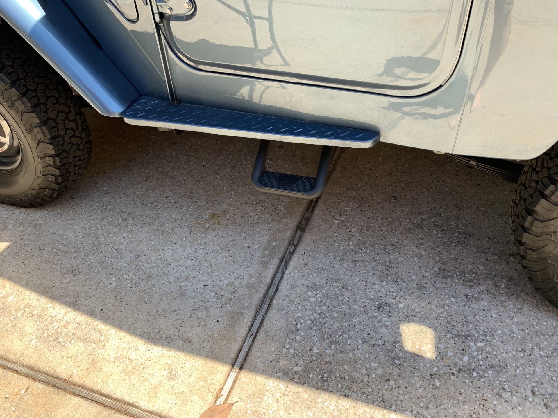

Here is what I did for my wife. If memory serves, the step was for a Tacoma. I know it looks like it is sitting on the driveway when folded down but it is 8.5 inches above the ground and 14.5 when folded up
