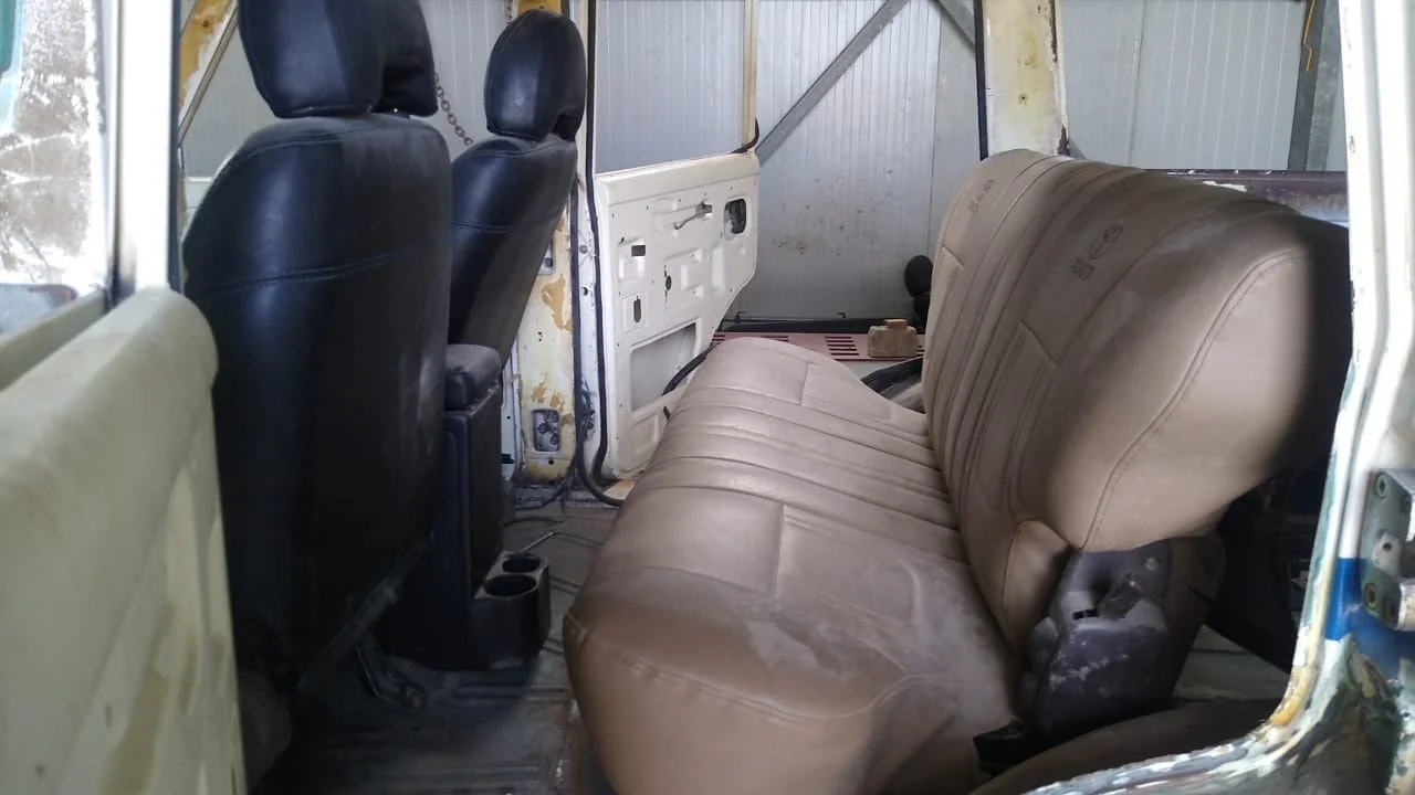

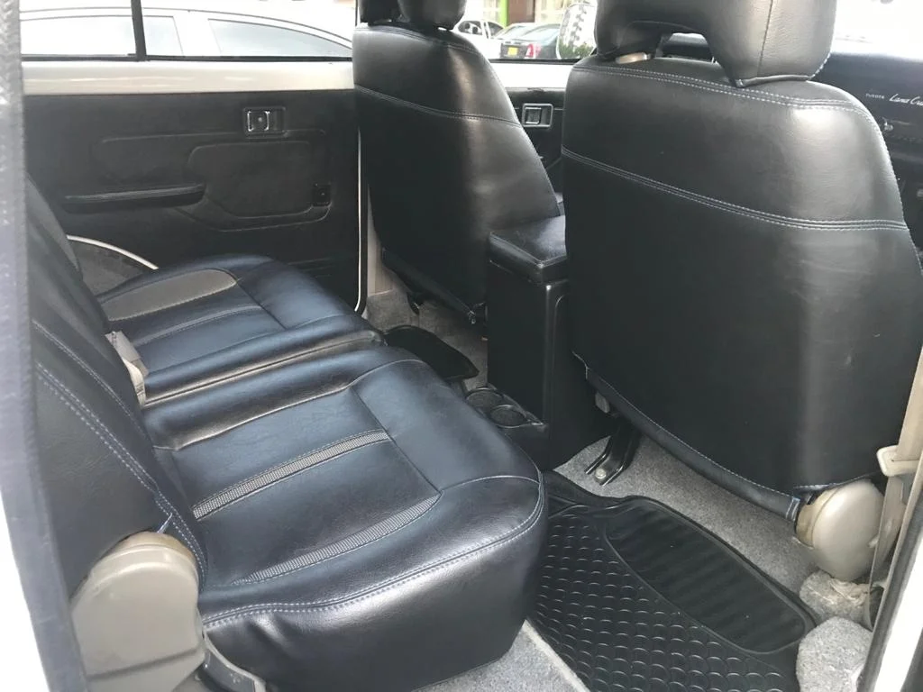

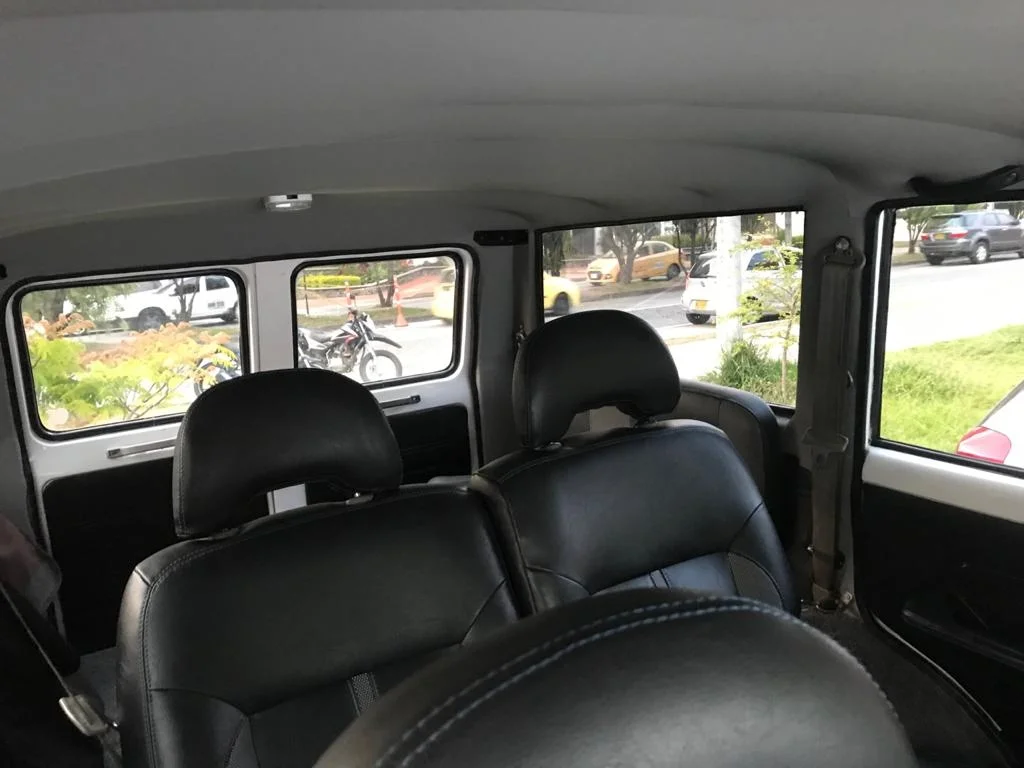

Building out an interior. Going with a 60 series second row.
Bolt on or did you have to mod hinges and latches?
Modded. That’s just a trial fit. PO had buckets on the second row, and that just didn’t feel right, and the dogs will have more room this way.

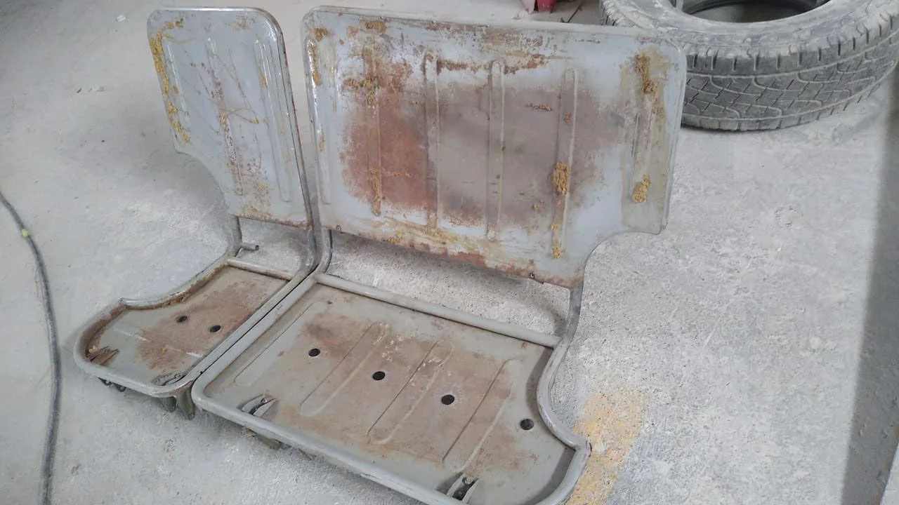

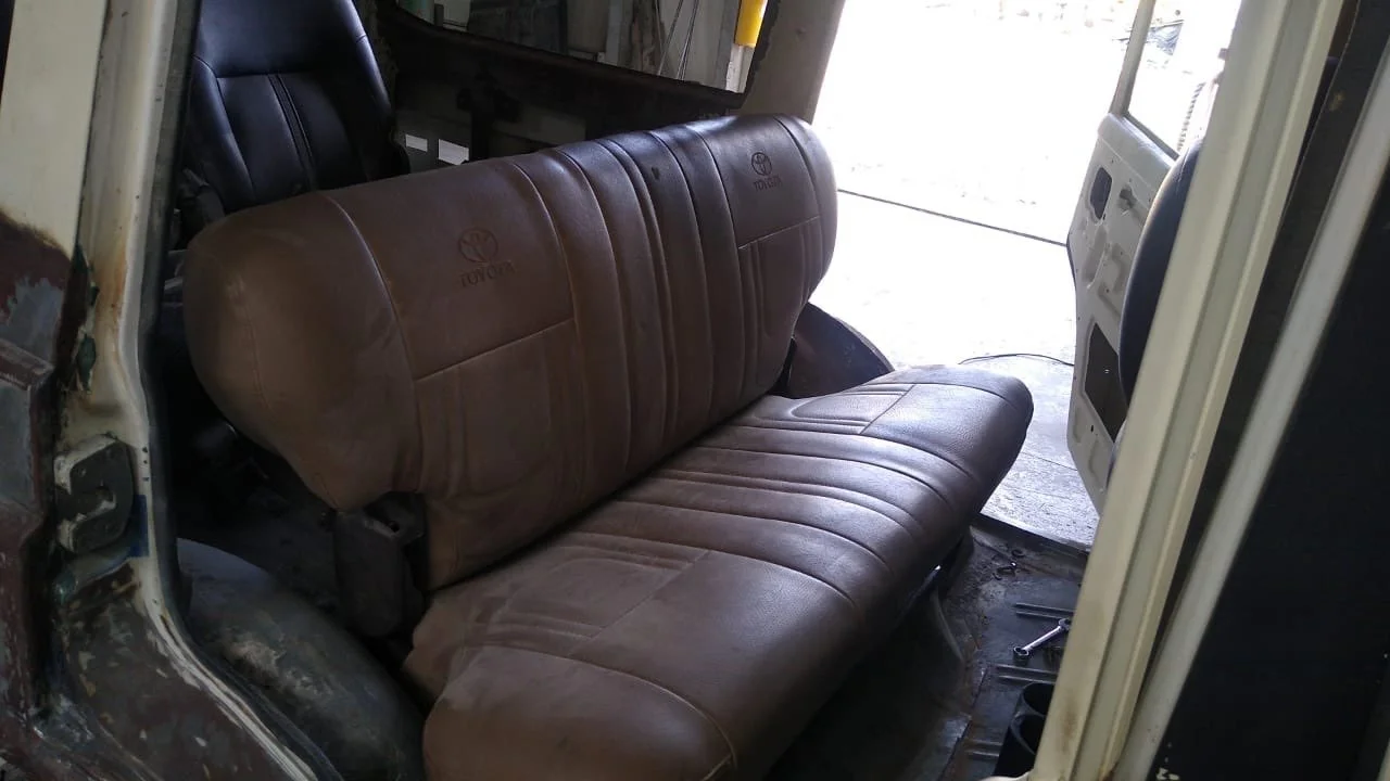

OEM seat was a split seat. This is what’s left.

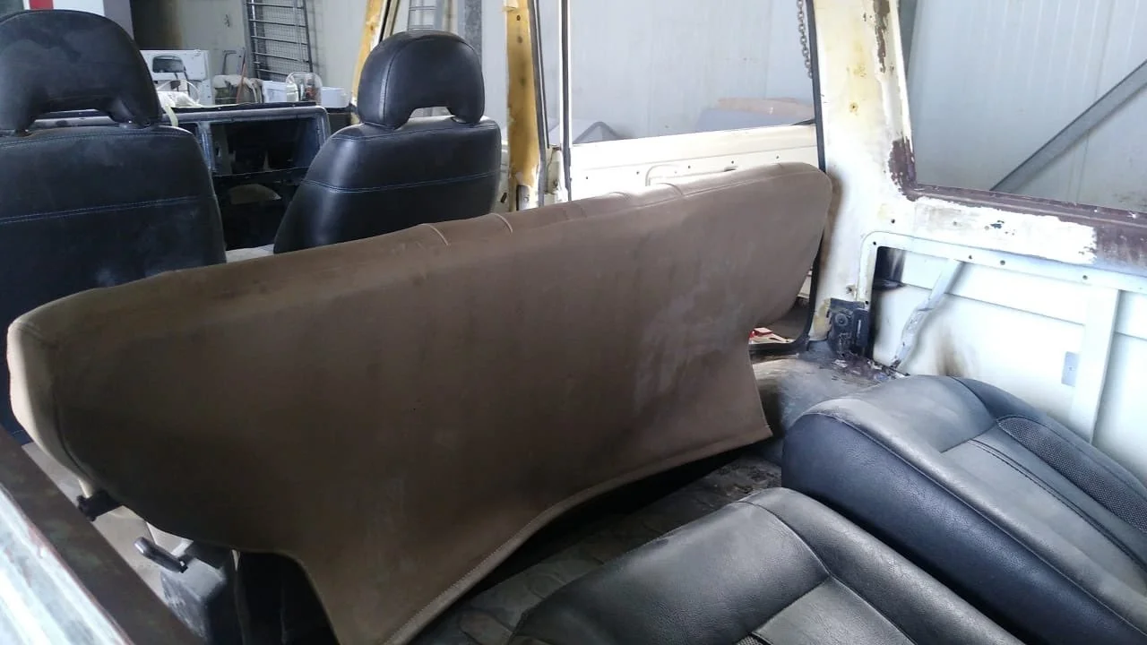

What year 60 series? Where are the pins the lock in back seat in upright position 🤔? All you should have to do is shorten those pins to lock in upright position 😉🤔with the hardware for the 60 mounted!

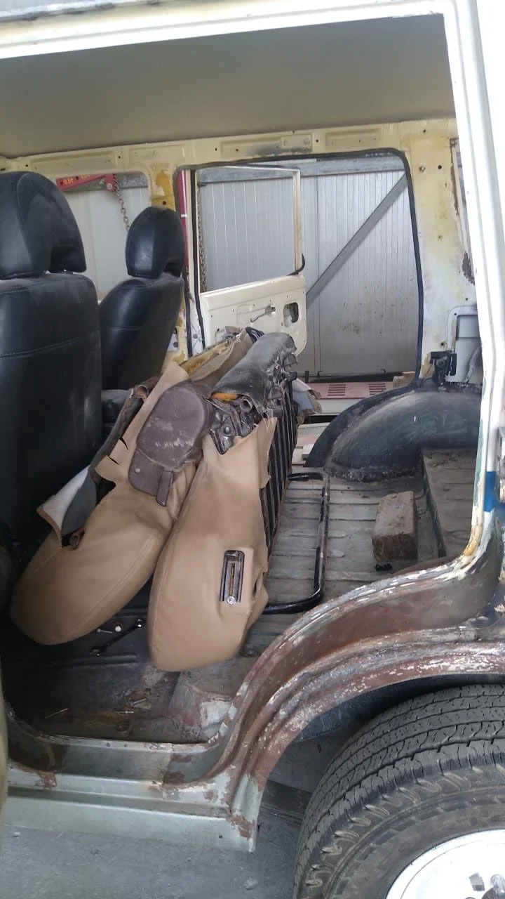

PO removed the split 55 second row bench and installed buckets. Took the towers off the fender wells, so it’s all gotta be put back together.
that bench isn’t mounted it’s just set in-place

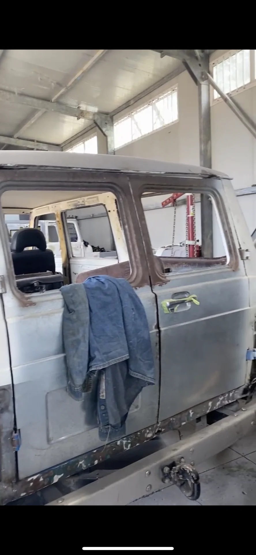

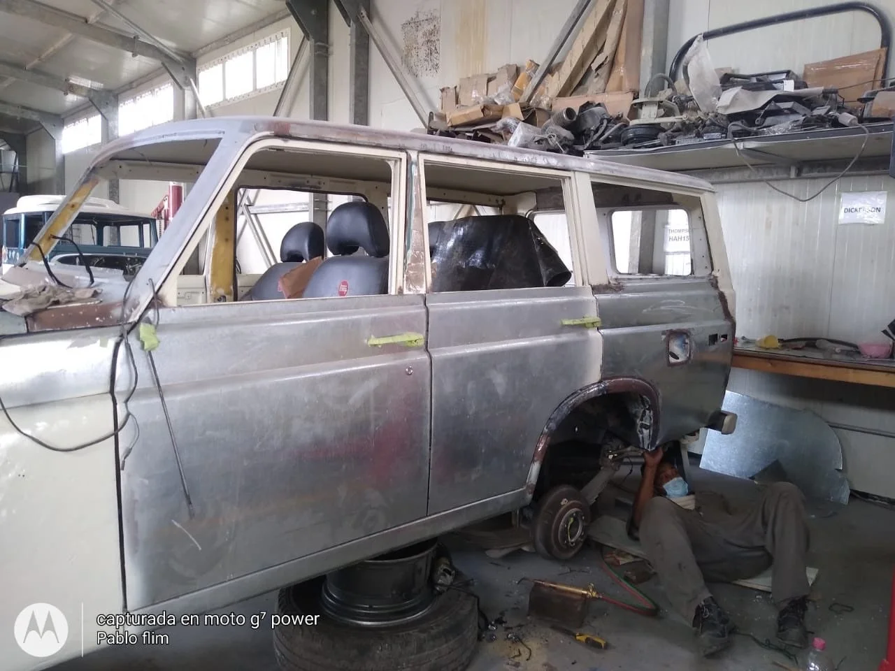

unknown year. 1982, foreign market. Truck has ambulance doors.
@TachedOutOffRoad might recognize this one

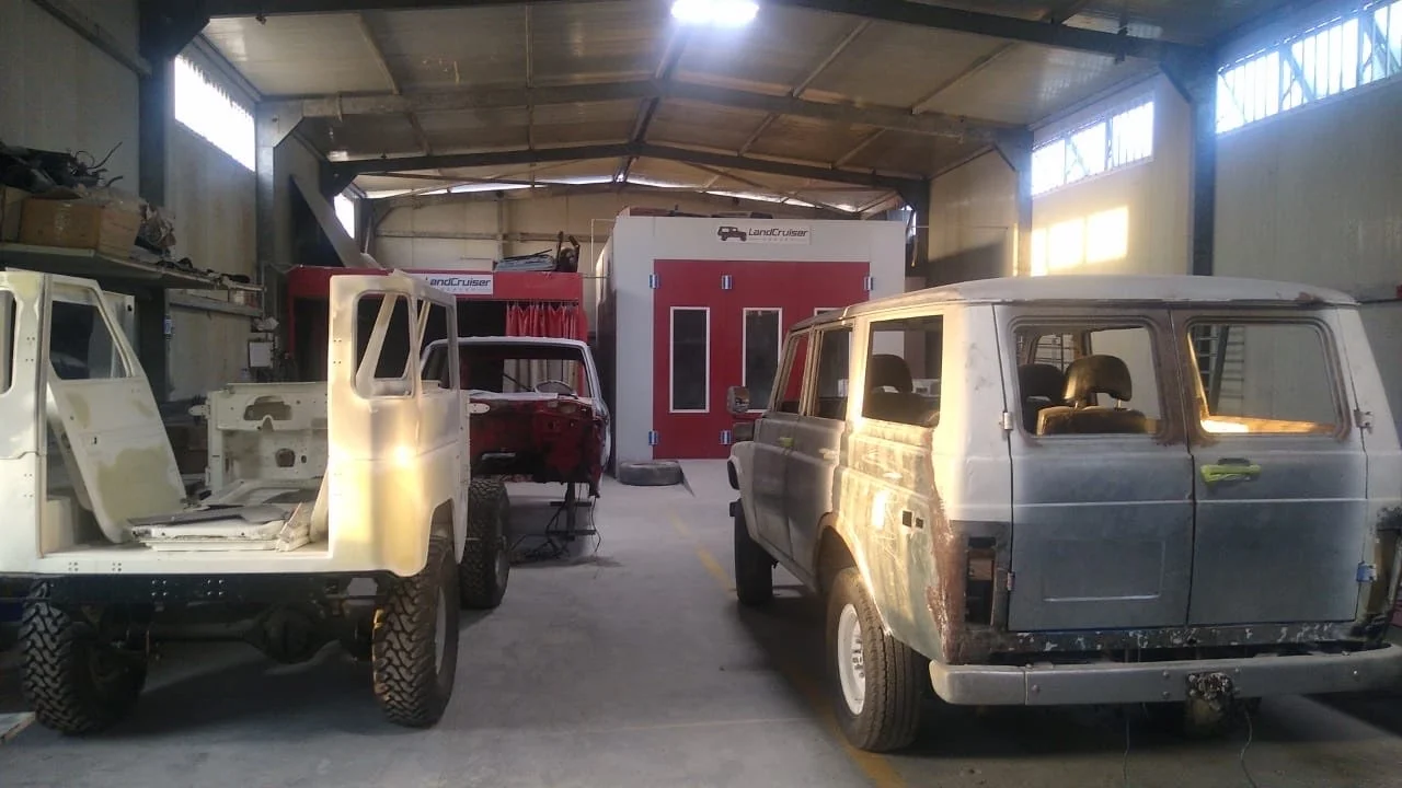

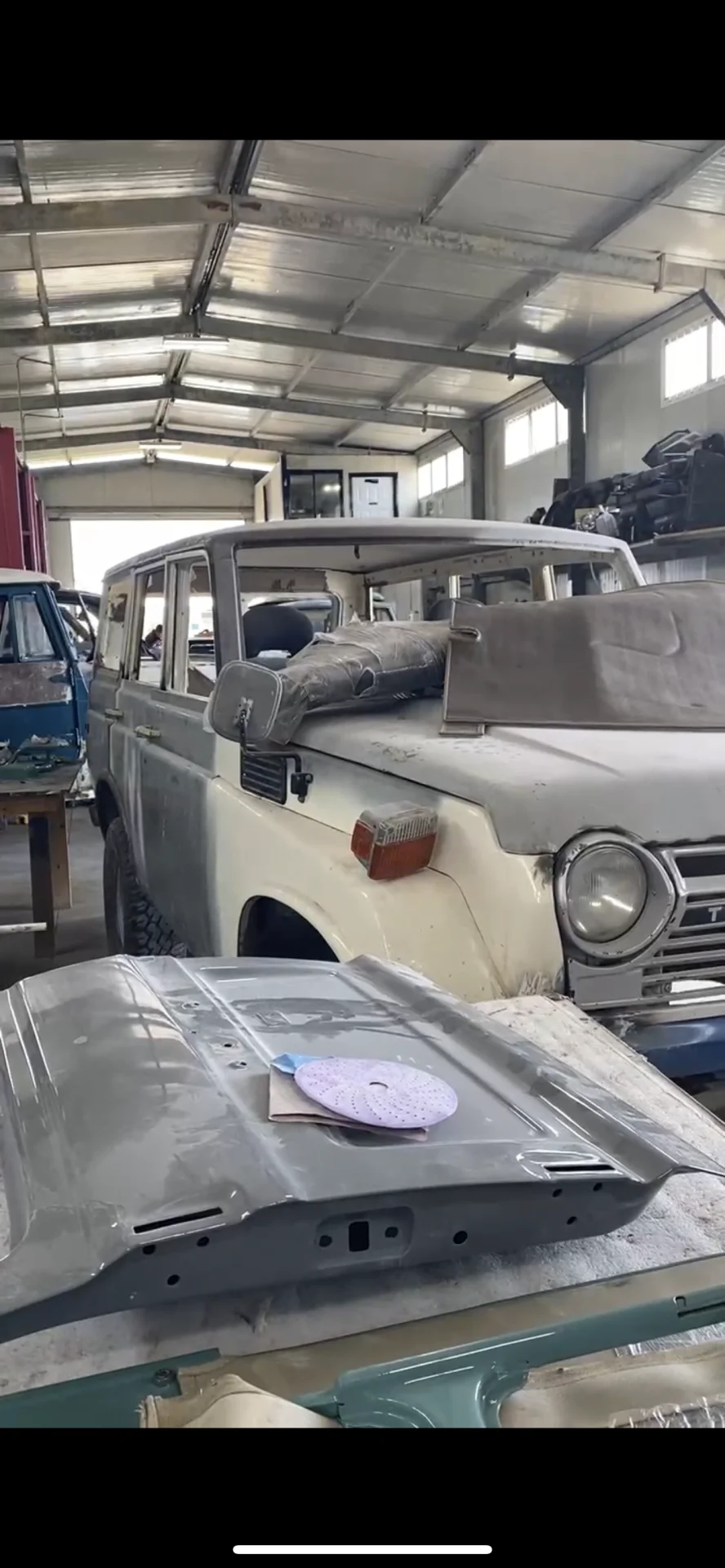

Since I’m going 2UZ, h151 and 70-series axles in the ambulance-doored body, I have a clean 2F, 4-speed, and disc brake PS front suspension that can be used in Clay’s former body.

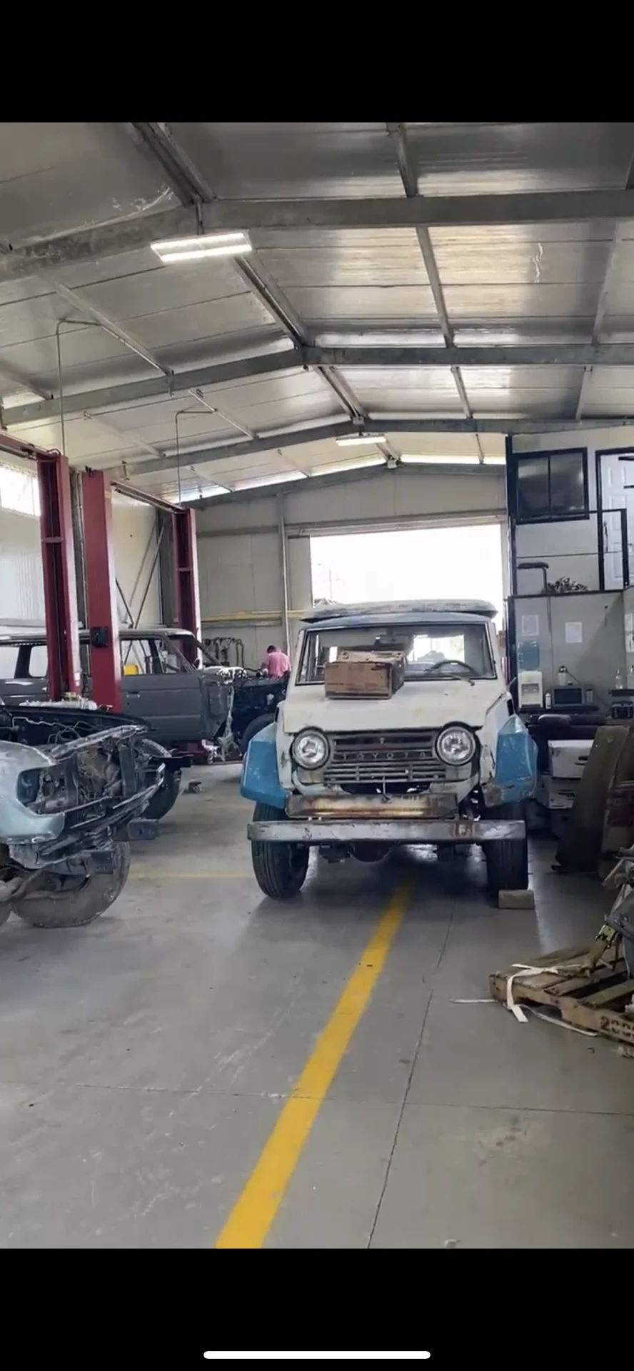

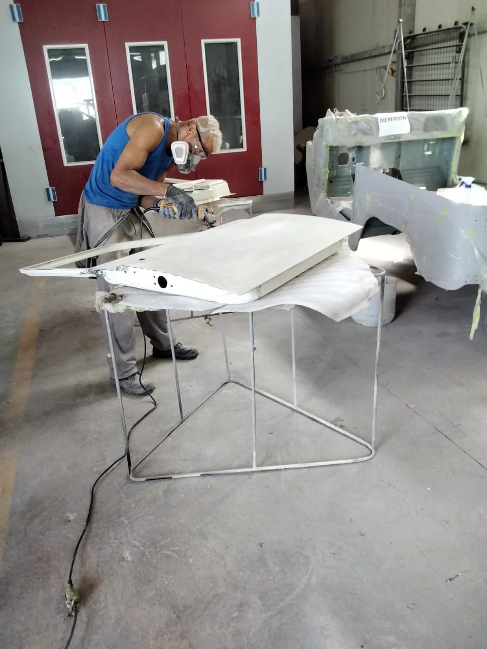

This one will be mostly stock. Not a concours level restoration, but a nice, clean, 1978 truck.

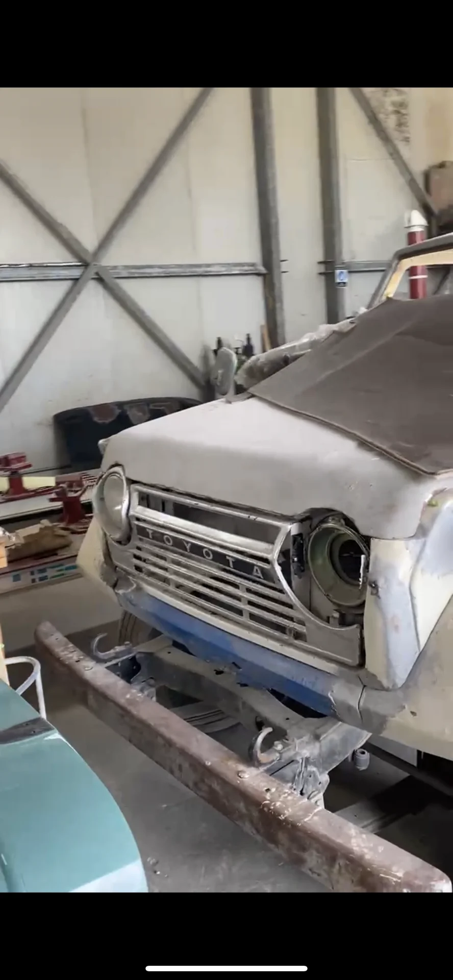

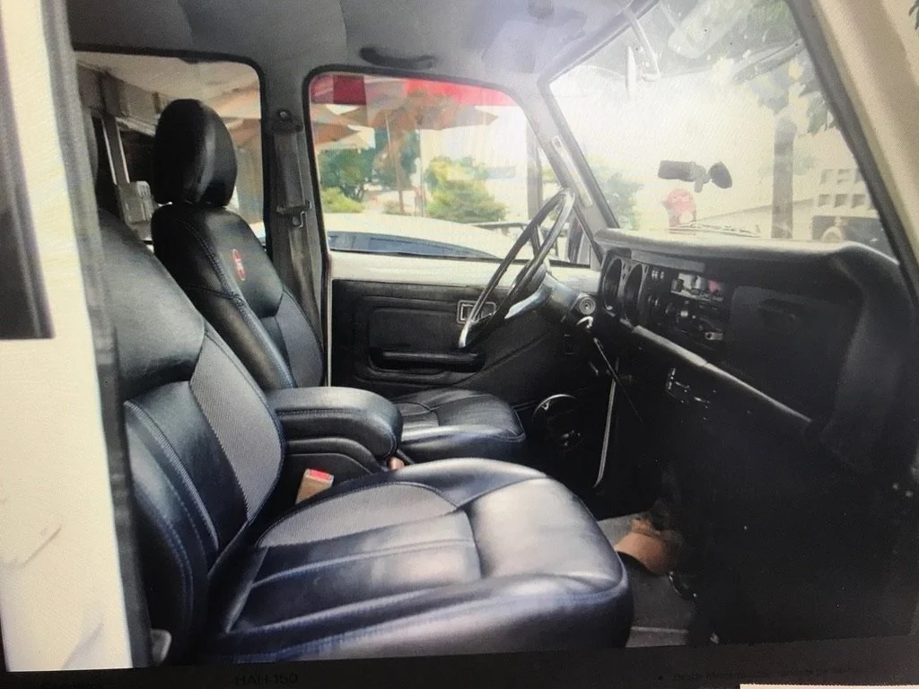

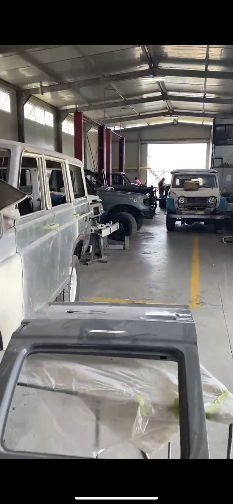

More pics of the second truck from before I bought it.
Two in progress at the same time...mucho heuvos!
