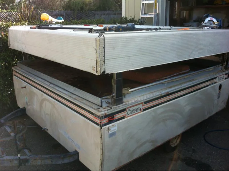

Time to dismantle the trailer!!! This thing stinks like hell!!! 80% of it is going straight to the dump!
Anybody wants $20 to do this for me??? just joking!
I work at a full restoration shop here in San Luis Obispo CA.
I have torn apart some pretty nasty cars at work before but nothing has made me sick to my stomach like this little trailer!!
Will be glad to be done with thrashing most of this junk! God that smells!

I got rid of all the nasty canvas, the disgusting cushions, drilled out the outside sheet metal panels so they are all loose, starts disassembling the roof and stopped!
I kind of got sick and didn't work on anything else the next day!
I'm also married with two little kids so time is very precious around here!
Will continue when I feel better and have some hours to spare!

Did I mention the hail damage to the roof of this pop up?! AAARRRGGHH!!
Spent a couple hours the other day futzing with the roof. Almost finished scraping/cleaning all the old layers of caulk off along the seams of the roof and the end caps on this pup. I was hoping to perhaps reuse some of the roof aluminum, but instead I'm gonna try to find a single sheet to get rid of the seam down the middle of the roof. The roof aluminum is pretty beat. I'm going to call a few local shops... Thanks for the advise on this one folks!
After further inspection I found several more small holes in the roof.
I also popped the roof and took a closer look at the ceiling... stripped all the thin paneling along the inside of the roof for a better look at how its all built. Pretty solid/simple construction actually. The roof is quite lightweight/strong... I'm diggin' the design of this vintage Coleman!
Haven't dug into the roof itself... I figure if I'm going to replace the entire roof then I won't have to bother stripping rigid insulation, panelling, aluminum, etc. I'll probably have to make my own roof sandwich anyway. :)
