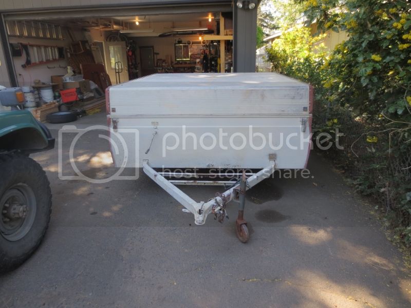

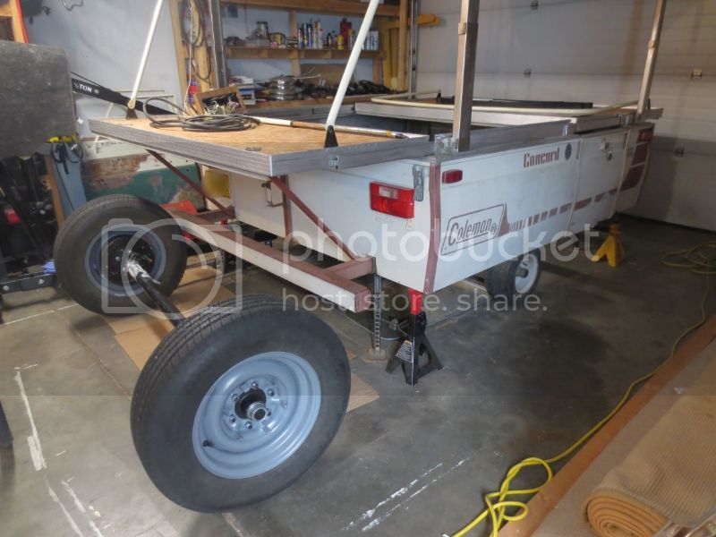

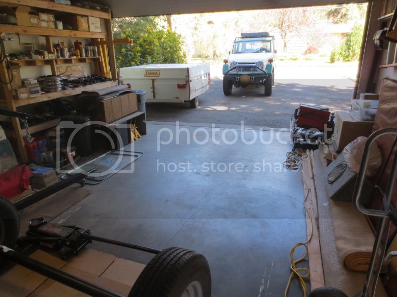

I actually unburied the pop-up recently and sized up the new axle. It looks like I may have even measured/guessed correct on the length!
Then I pushed it out of the garage. WOOOOT!

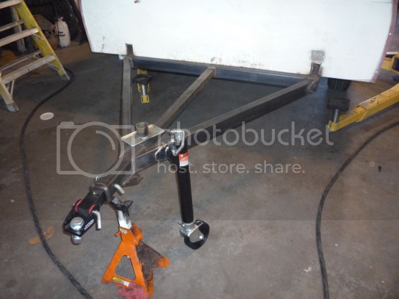

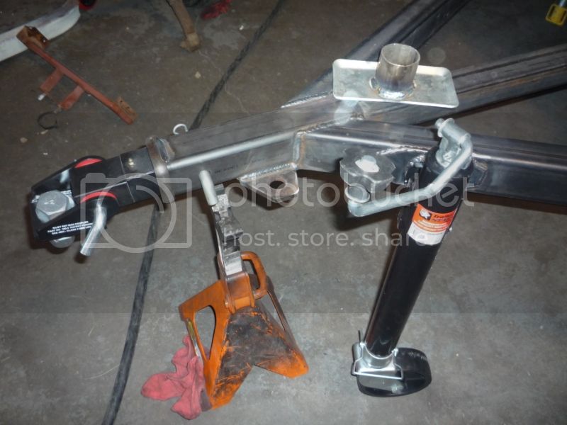

Soooo, part of my plan with this project was to push myself to try new things. I had hoped to teach myself to weld and then finish the fab work on this pop up myself, but this project's been fairly stagnant for a good long time and summer is here now. I'm gonna try to get the family out in it at least once this year. Therefore, I made the decision to get some help with this and speed up the process before my wife torches the whole thing.

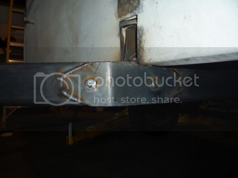

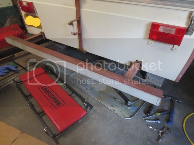

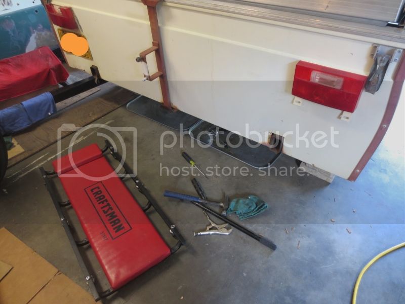

Before I dragged the pop up to a local fab shop, I finished prepping the existing frame. Removed the rear bumper, mostly removed the rear tire carrier, removed propane lines, tank holder, etc.

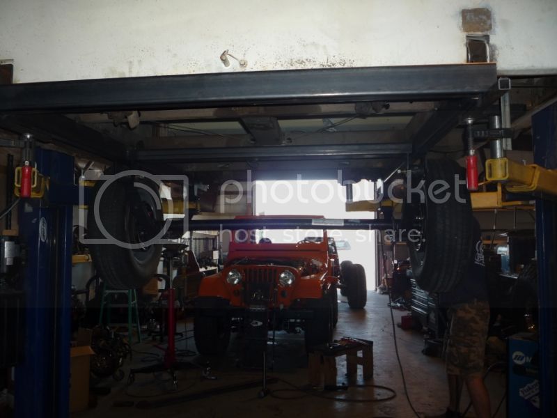

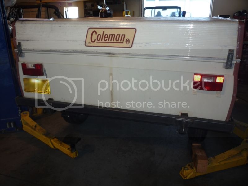

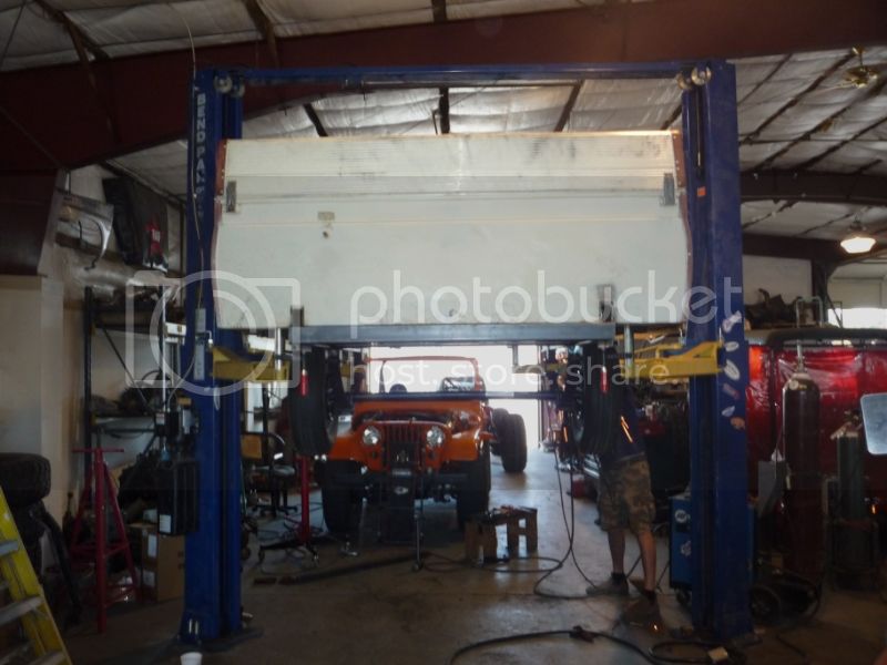

Here's some sneak-peek pics of the pop-up in the shop!

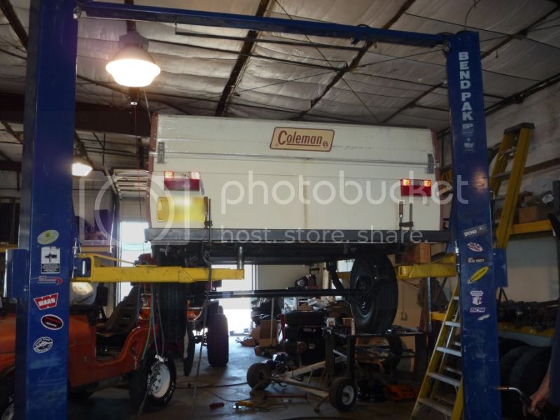

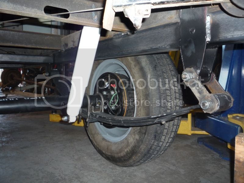

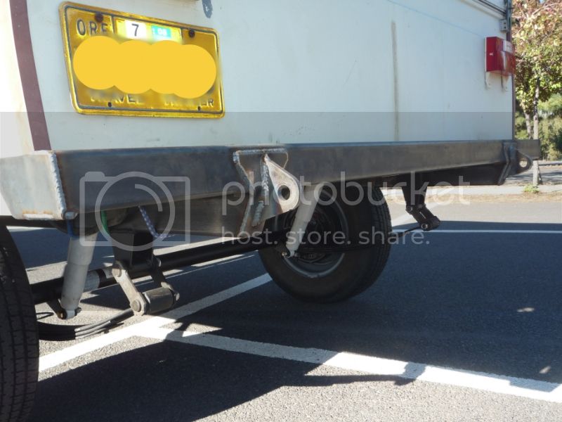

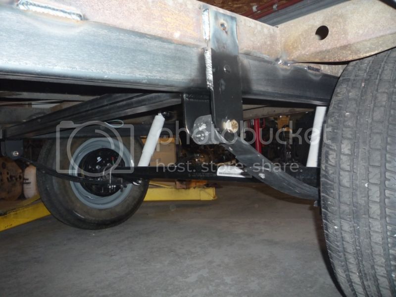

Rear shackle angle
Those rear shackles on the springs looks too close to horizontal.
Maybe have a friend come over and the both of you jump up and down on one corner of the bumper to make sure that axle doesn't over extend.
LAMBCRUSHER- Thanks! By the way, I really dig your 'Half Hawged' pig-up, and I'm seriously thinking of doing something similar. Thanks for your documentation and inspiration! :)
Muleysam- Thanks for pointing this out. When I first checked out the suspension, I immediately thought maybe the shackles were a bit past 45 degrees, but the more I looked at it the less I was concerned.
However, after having it at home for awhile and also working on it, loading it, etc. I've noticed the springs/shocks have settled a bit more. I now have a healthy 'Cruiser Lean' on the right side/door side of the pop up and the shackle angle is near horizontal. Bunk.
I'm hoping if I add another spring or two back to the springpack that it will remedy this scenario. I should probably add some bumpstops too. Any other thoughts?!

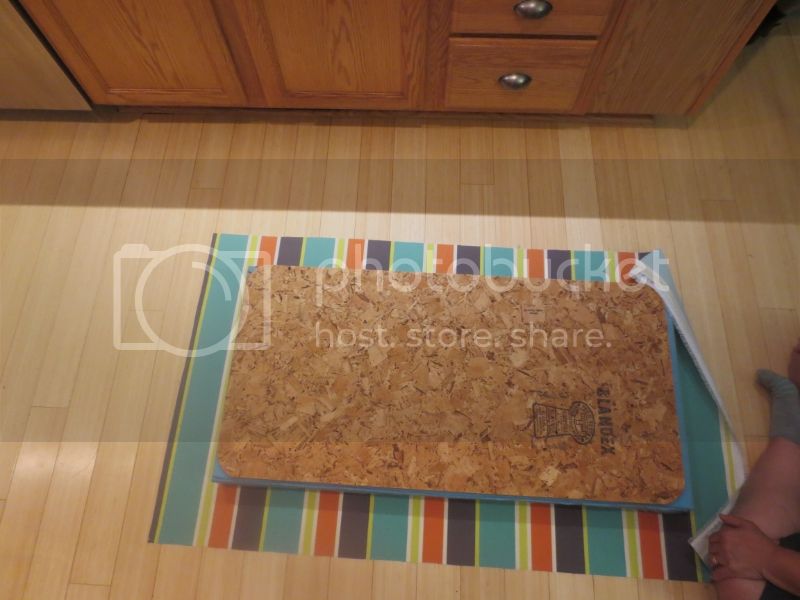

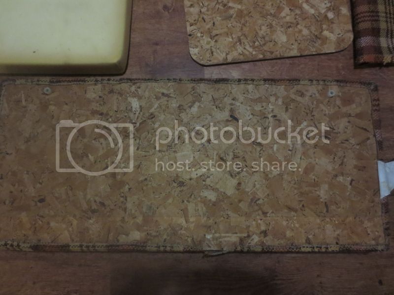

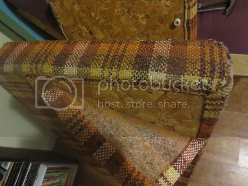

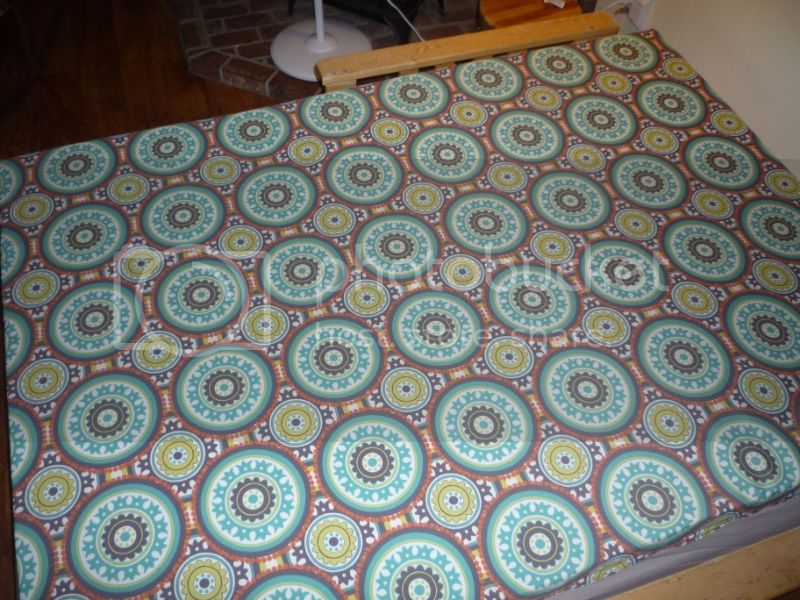

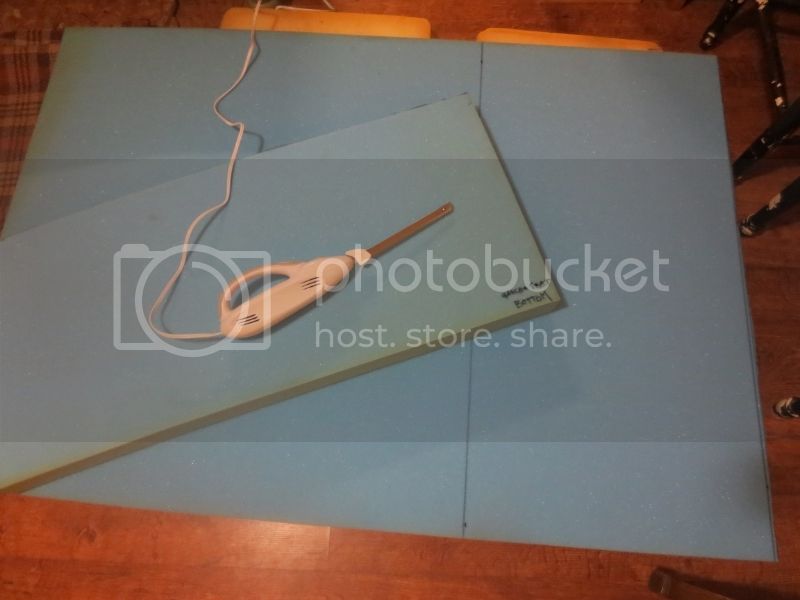

My Mom came to visit recently... and we put her to work! I dismantled the old gaucho cushions to reuse the plywood cut-outs, remeasured the foam, etc. My Mom bought a sewing machine off Craigslist and then began the task of recreating all of the cushion covers. She cranked out all of them while she was here on 'vacation'. My wife went out and found a great deal on some indoor/outdoor Sunbrella fabric. She bought all that was left in stock, no idea why there was no longer any stock left. I guess it must have been a real hot seller! ;)
Anyway, here's some pics of the process, 'cause I like pics.
If you plan to cut foam, BUY/BORROW an electric carving knife. This thing rocked!
Here's Mom working diligently...
... and of course I coaxed her with alcohol. :)

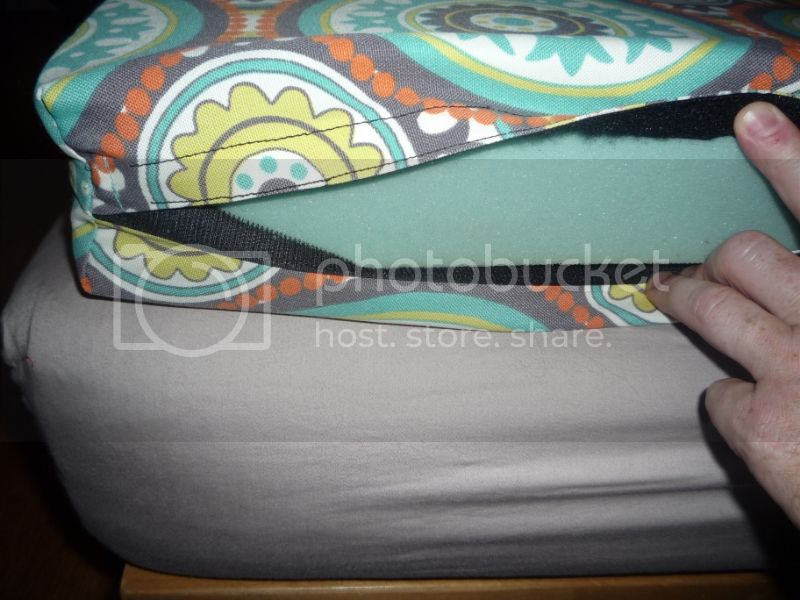

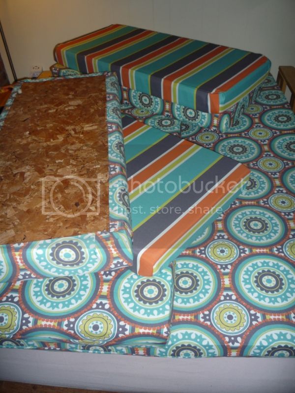

The main design is this funkiness...
Mom built in velcro so we could easily clean the cushions. Mom is cool.
Here's a pile 'o cushions!
We have plenty of more pressing steps to deal with before the pop up is road-worthy, and this is normally kind of a later detail to complete, but Mom insisted so we obliged. Cushions are done.
