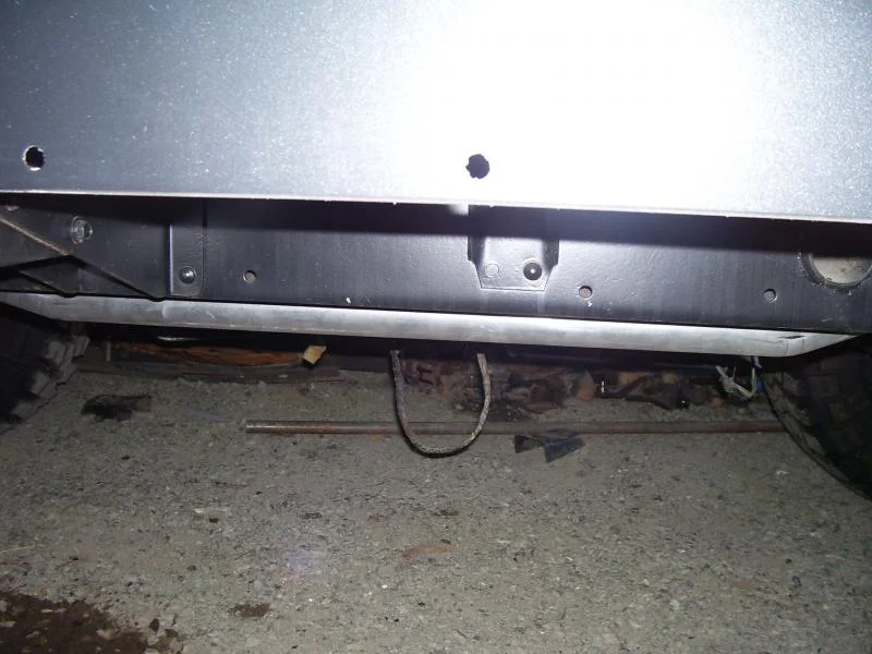

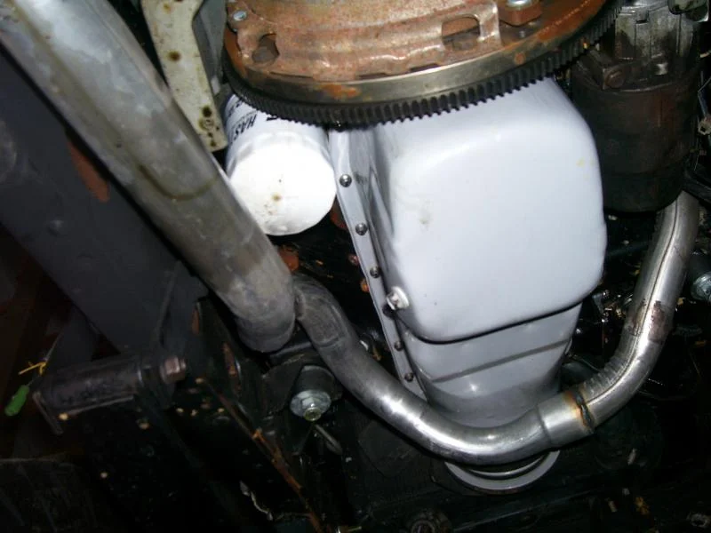

Well I finally pulled the cover back off the fj now that the rest of my vehicles are starting to get back to normal :rolleyes: I hauled it in to get the delta flow master plumbed into the walkers crossover with the challenge to my exhaust guy that I would really like to get the PTO shaft back in there, get my oil filter off, and not have the exhaust seen :D He chuckled and said any thing else?? But I will say even though I am not THRILLED with it I think he did the best with the items I asked for as possible so for that I applaud him. The only thing I may have changed is I wanted it out behind the rear tire and he went out the back with it tilted down which looks ok I just dont want it swirling.
This is squatting down you can just see about an inch of the exhaust below the frame
The walkers crossover had to be demolished to make it happen..... Would have been great without the PTO shaft idea

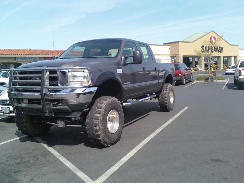

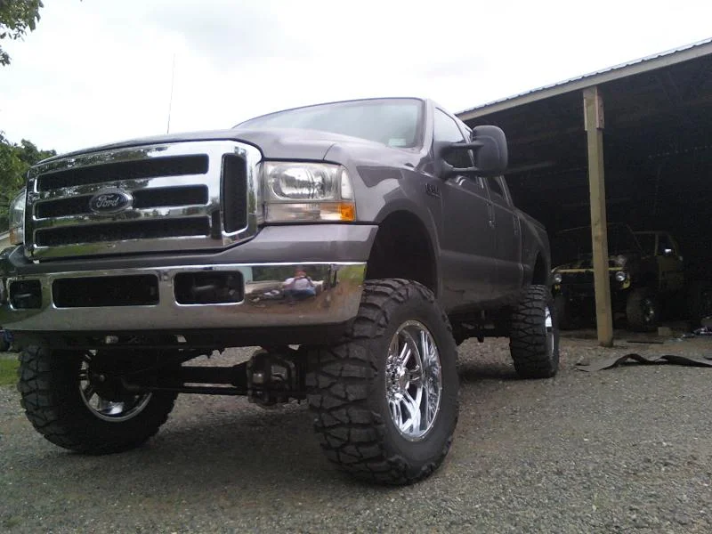

But to better explain my absence life threw me a curve ball..... Things were going good and I really wanted a tow vehicle so I sold my Cherokee and my Tacoma and threw in a good chunk of my available funds and found a great deal on an 02 power stroke with low miles, decent amount of lift, 60% tread on the swamper's, etc. I had a three hour drive back to home where I was excited to pull the fender flares and chrome junk off and I was going to be living the dream.....
My 2 year old was so excited he absolutely would not ride home with his mom! He had to ride with his dada.....

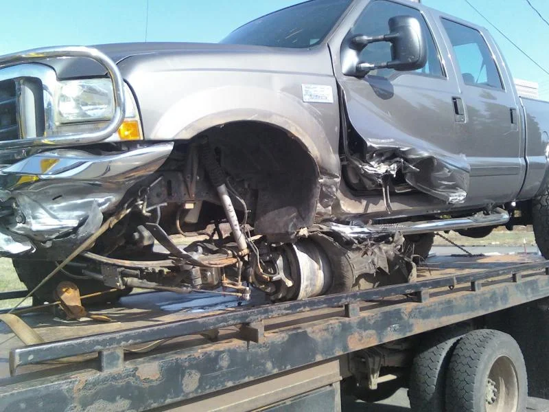

Well after the left front tire instantly blew on a right hand curve at 70 mph luckily he was OK other than a sore neck the next day! :frown: I couldn't give two cruds about the truck nor the embarrassment or whatever but this was my very first reality check about what truly matters!!
So back to what has held me up a bit...... Even though insurance is a beautiful thing it doesn't pay for everything :D

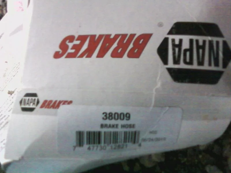

So the hoses fit like a dream. They are a bit on the long vs. short side but not too long as I have my backing plates removed and spring over.
The 38881 you need two of as they are the caliper to axle
This is a decent length hose to go from the front axle to the frame.

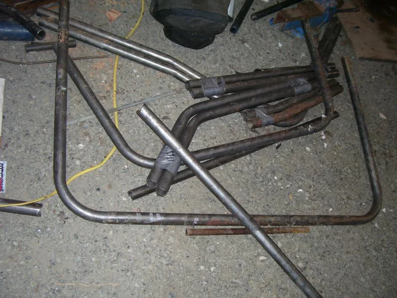

For those that followed my build and then I promised to pull it back together and get back to it...... I fell short but I promise I have a decent excuse. We were selected for Top Truck Challenge 2011 and we completely rebuilt my friends Willys jeep including lengthening the frame, 4 links, 3 link front, rockwells, engine, tranny upgrade, rewire, new cage, steering upgrades, 54" boggers, custom homefabbed Hemmit beadlocks, yada yada yada basically 2 months of every night after work till 10pm or weekends all day till midnight or once 2:30am.... I was fortunate to be the copilot and we were even more fortunate to win. I busted the FJ out the other day and cleaned it back up as well as a few other things. I am staring at the pre fabbed cage itching to get it in as well as shock mounts, wire the collumn and then no excuses time to hit the road.

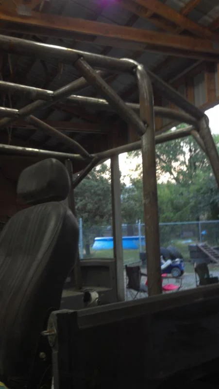

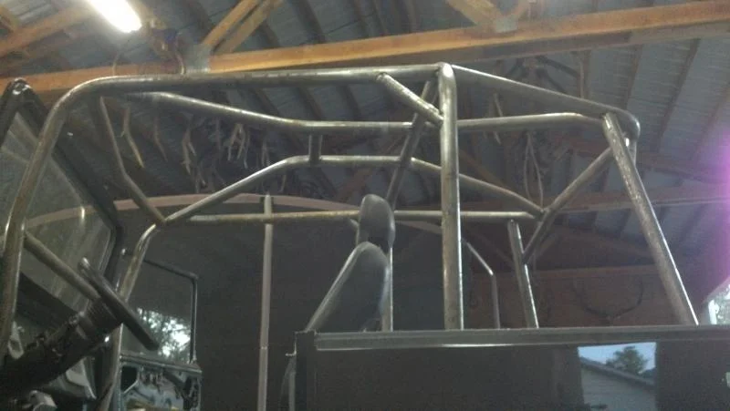

The redline cage is mocked up and tacked together I will try and download some pics tomorrow... New phone is giving me heck. As for the reviews it is a nice cage it looks great it started off a bit rough when the main hoop was a bit wide but a huge ratchet strap later and some blood and sweat it was fine. The rest only took minor modifications which are expected...... All in all good job guys and it definately looks great
LMAO anftfj I know I know!!!! I cant believe I fell so far behind..... All I can say is two years in a row of Top Truck Challenge slowed me down a bit!!!!!!
I redid the knee bars to main hoop gussets and made them smaller and added the upper tie bar. I am going to add a couple more gussets and handles and call it a day. Then off to the powder coaters!

Cage is done. We added a couple gussets as well as shortened some up. We also tipped the back down a bit more than normal and added grab handles. All in all it was a nice pre built cage from red line.

Scary looking crash, glad to hear you are all right
