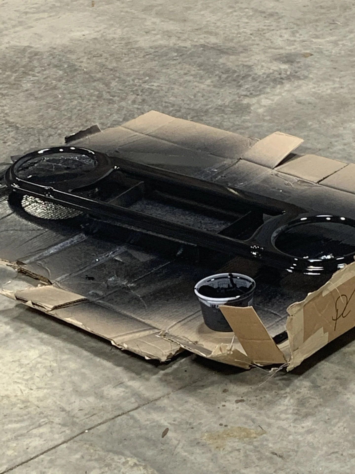

Lengthened front and rear drivelines finally. Shot some black on them today and am now one ujoint short of being able to throw them in (ordered new oem bolts too). Noticed the rear ebrake drum was leaking bad so I added some rtv to the splines.
