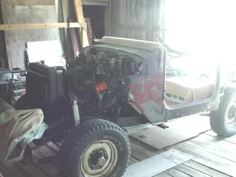

two from the way back. late 90's or early 2ks.
