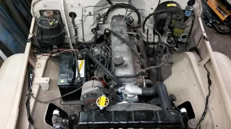

tidied up under the hood a bit. put a new brake master cylinder on it. still need to ordered a new header before putting the intake back on. also cleaned up the rear wiring. finished plumbing the rear brakes while i was back there too. probably work on getting fluid back in the brakes next time i get to the garage. also redid the parking brake. the rears, transfer and tranny need refilled as well.
i "get" to "enjoy" a little bit of winter this week, but i'm looking for warm weather at this point. once i get all paper work taken care of, and can get it on the road and out of the shop i can get to work on a motor for it as well as maybe a hardtop.
once it gets parked again for next winter i can swap the 2fs around.
