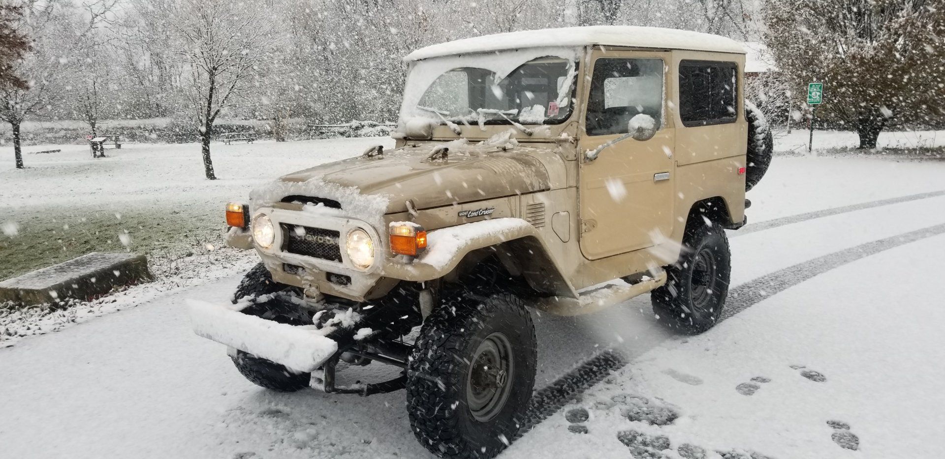

interestingly this pic was taken in almost the same spot(i like snowy cruiser picture taking apparently), albeit looking west vs looking east in the new pic......and before the park was developed, and with the pre restored version of the cruiser.....about 15 years ago.

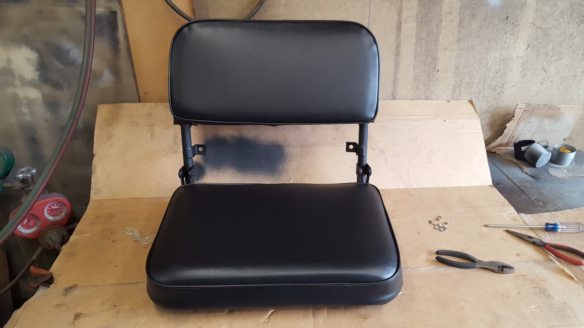

i started off with replace the DS seat cushion that i bought years ago and never got around to....it's one of SORs high density dealies...you do not so much as sit in it, as on it.

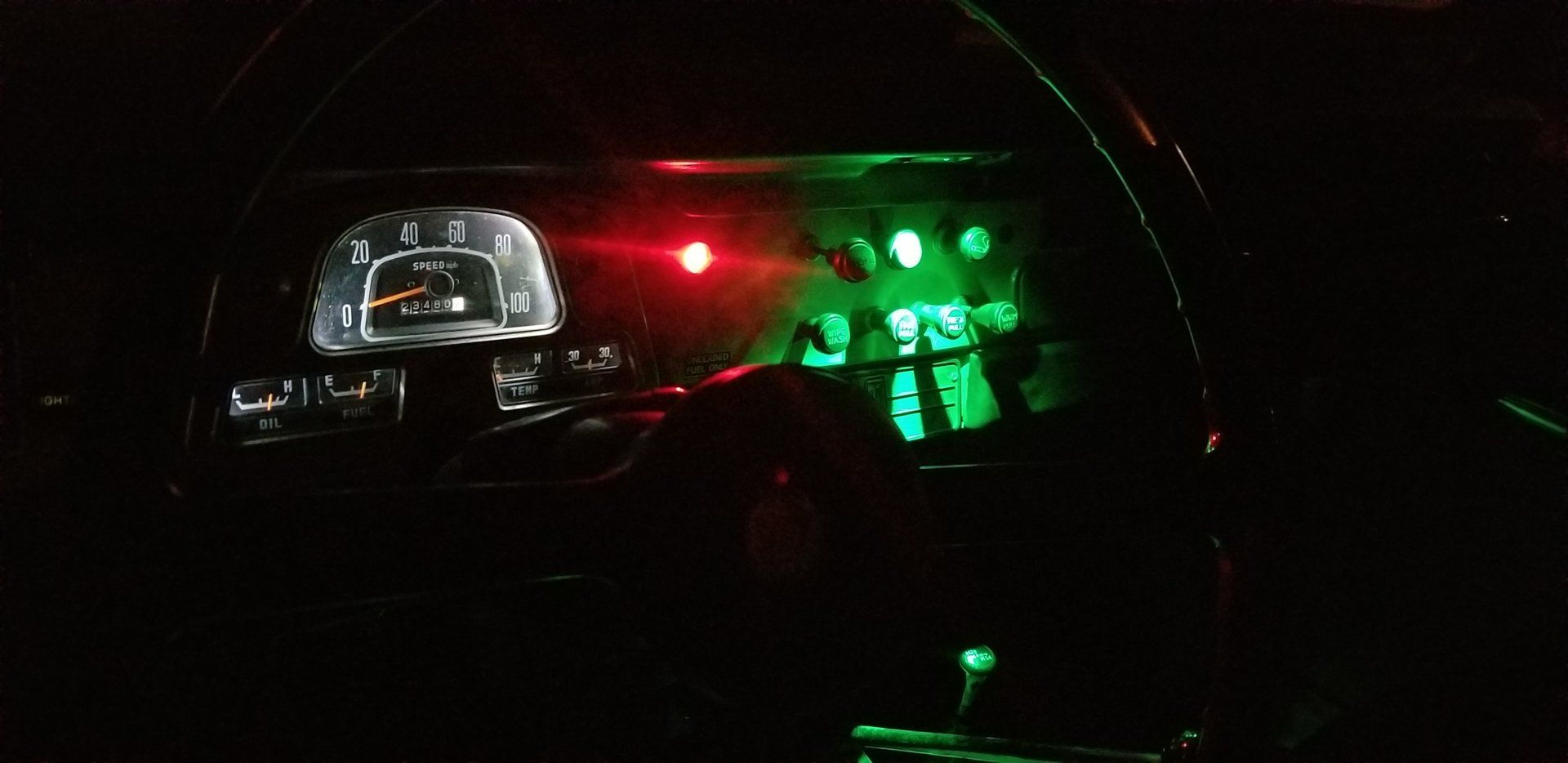

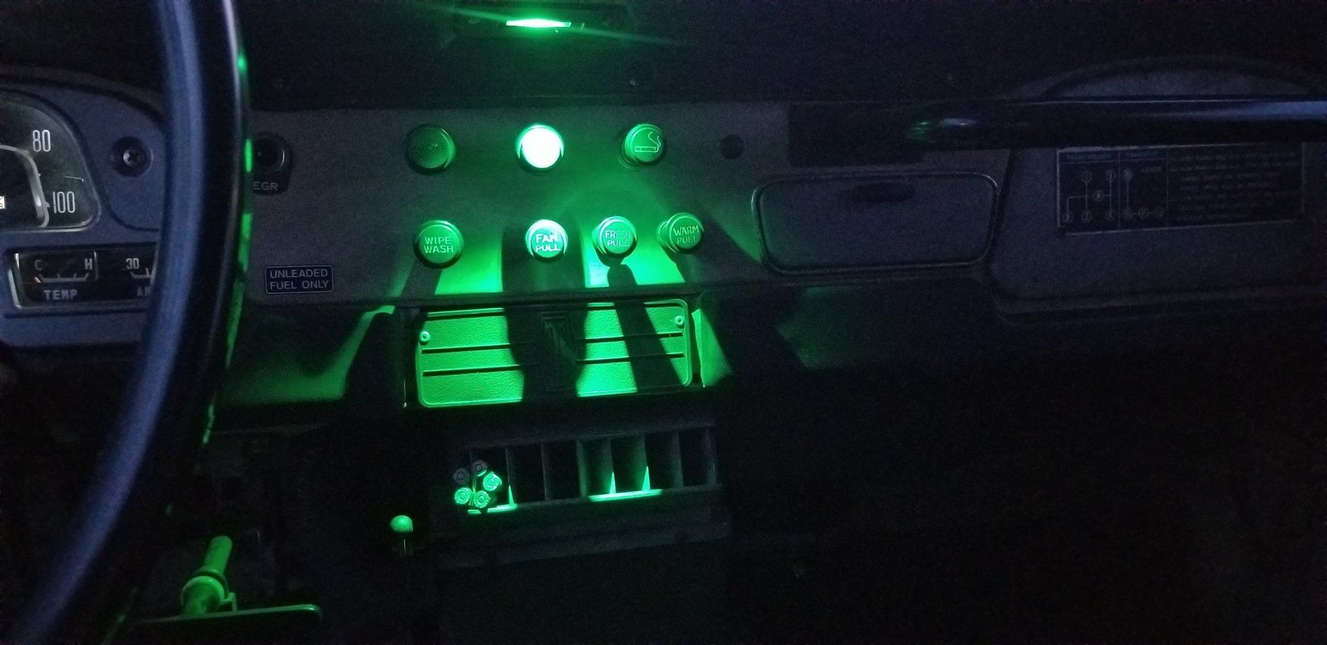

toyotamatt came into play here as well with a selection of lights, mostly leds.

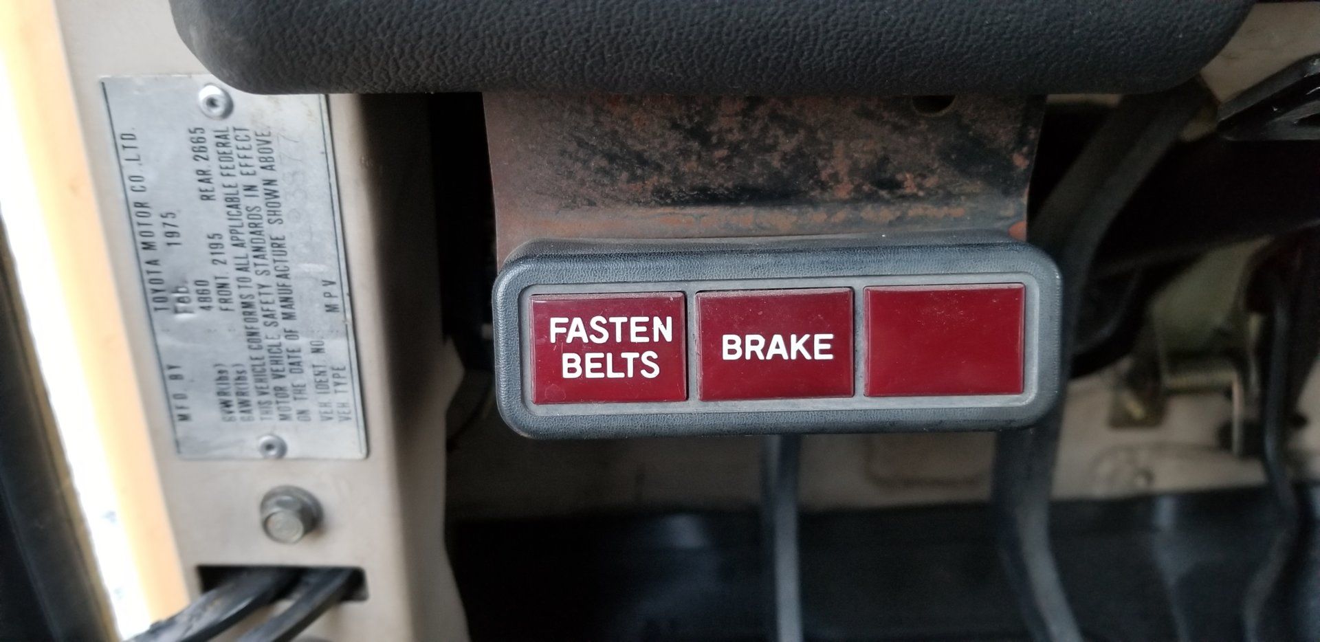

so the 77 brake warning array was replaced. the erg light i had placed in the brake light loaction, was moved back to it's correct location below and left of the column. a quick easy rewiring job and a new led light was in place behind the now correctly located brake warning light, along with a switch from matt that works all of the time ensures that the light works. while doing some bulb work the dash knob light in the dash pad was replaced with another one of matt's led bulbs.
i also picked up one of his blue super bright bulbs for the high beam indicator lights

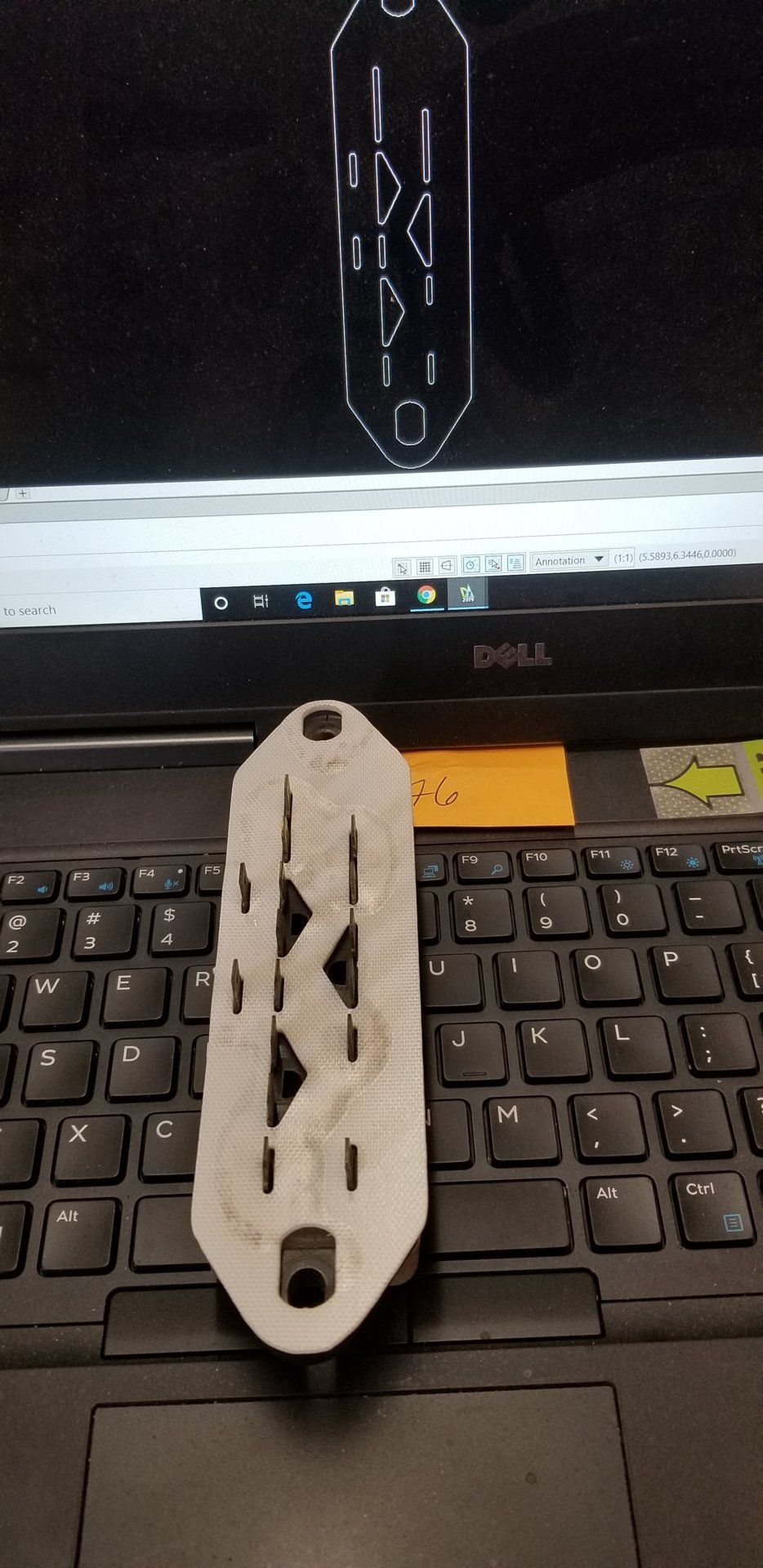

decided to take a swing at making a new insulator for behind the fuse block, which is now sporting one of city racers replacement covers.
the first go is pretty close, but not sure if the material thickness is going to be an issue. im going to check that with a junk harness i have laying around.
Since I've been on an illumination kick I got the heater controls light sorted out with another one of @ToyotaMatt led bulbs as well his led bulb for the light switch.

Top Shelf Brian !
did you preform a Cluster Meter Light Shades Modification ?
or
is that simply updated LED bulbs on a untouched Meter as is .........
it appears non- stock bright lumens
They are LED replacement "bulbs", but I cant remember if the hoods are removed or not...I'm leaning towards the "yes they have been" side.
That brakes warning/ parking brake indicator light of yours is still my favorite.
