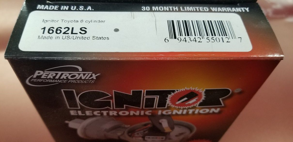

Hey Brian,
We're all really enjoying reading your build, nice work! Would you mind sharing which Pertronix kit you used in your distributor?
Thanks so much!!
Cheers,
Adam
the first version started eating itself.
they warrentited it and replaced it with the lobe sensing version.

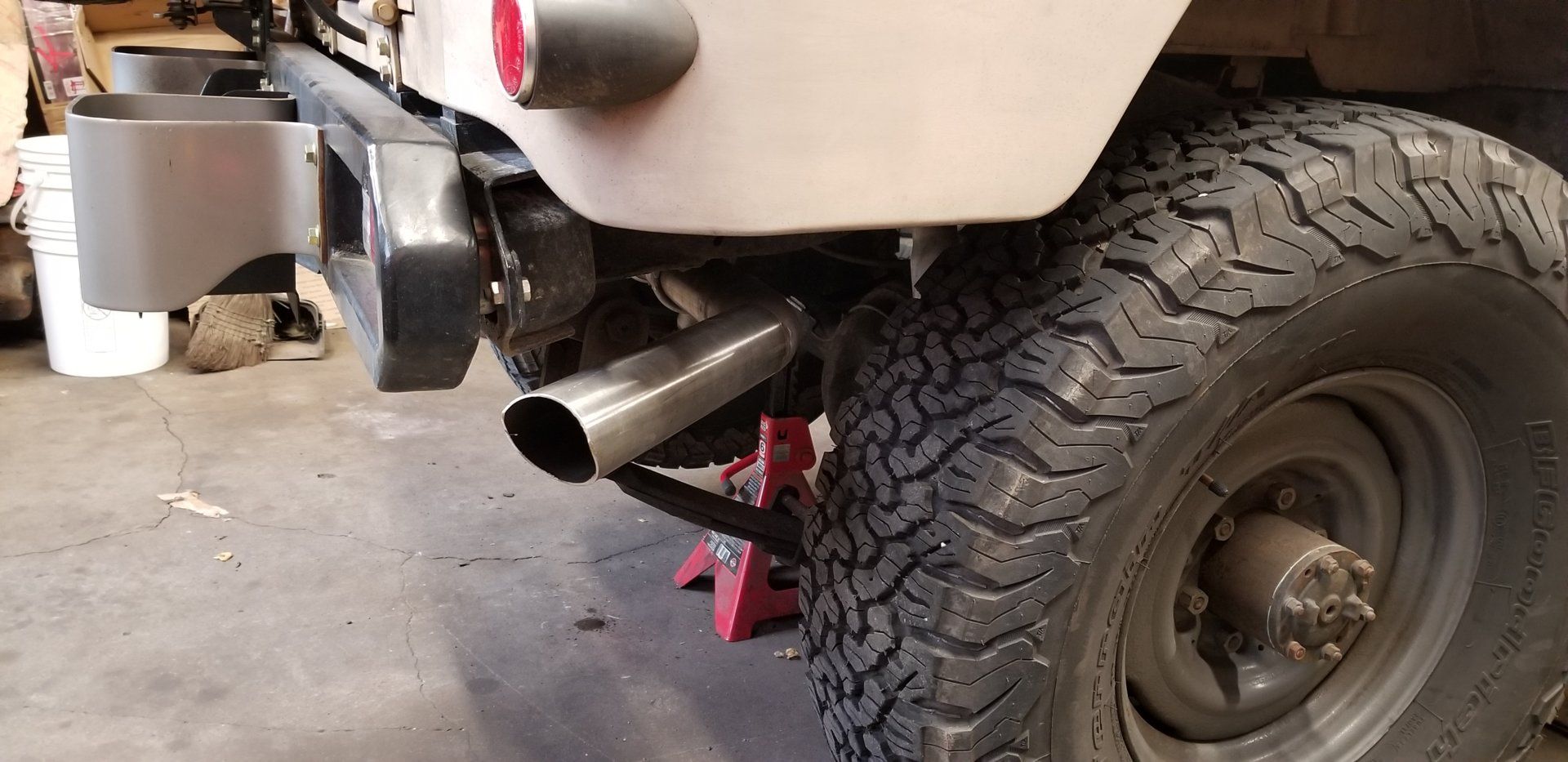

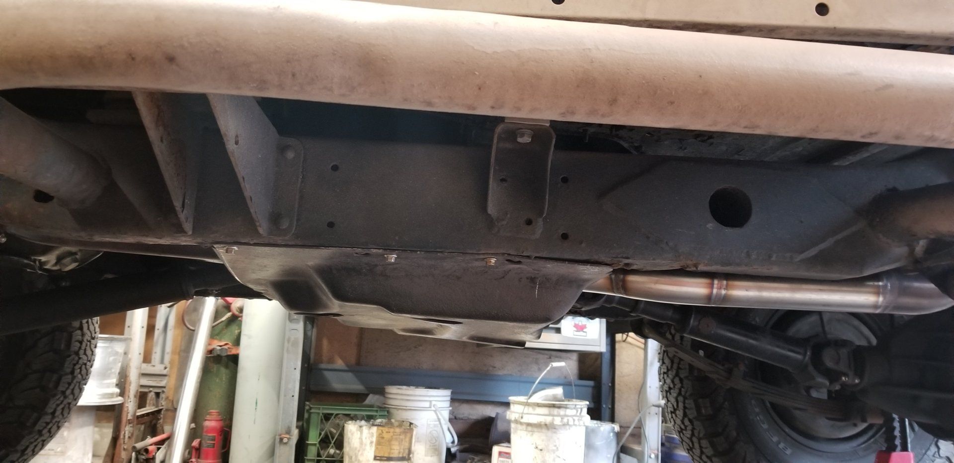

2.5 inch 304 I/O tubing and fittings, purged with argon.
Muffler is stainless thrush.

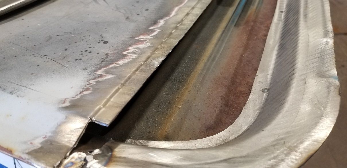

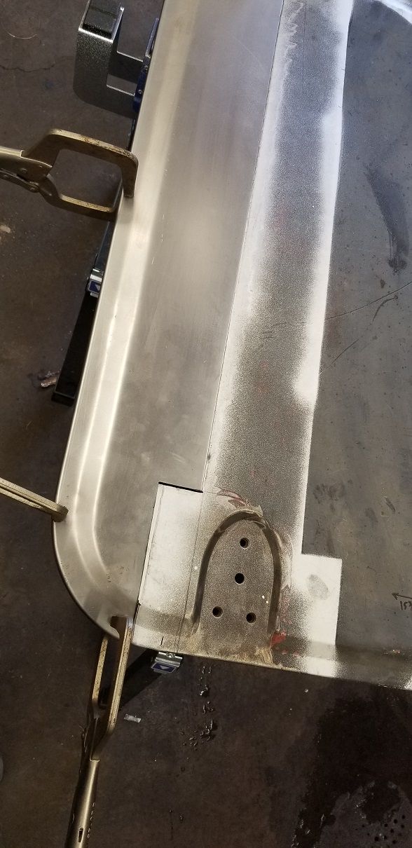

there was a toss up to which vendor would be used for the replacement panels...and i ended up with some from a couple places...in the end i felt ccot had the better pieces.
also felt like living life a little...and rented a couple harbor freight flange tool....took two of them.....they are complete junk...but they work well for the few inches you get out of each one.

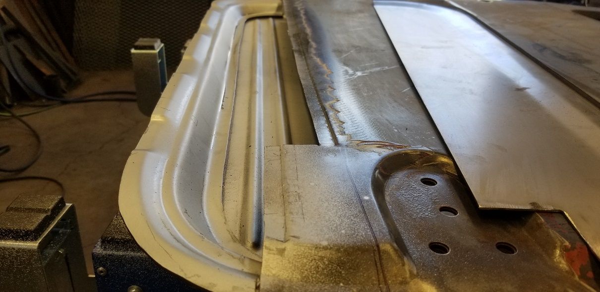

How did you align everything so that the new piece matched exactly the portion you removed? My concern is insuring that the perimeter dimensions and lines are true so that there are no door fitment issues.
clean living and blind luck.
careful measuring
the outer skin did give me the opportunity to do some more body soldiering.
it required some mud and high build primer after the lead.
