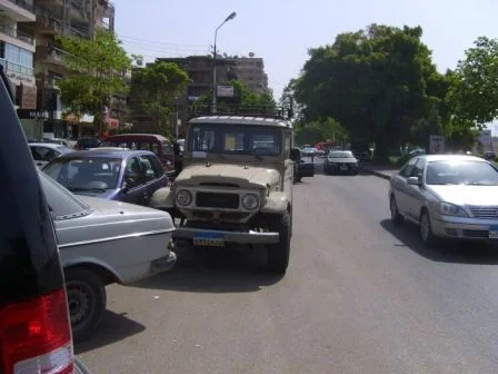

40 Spotted in Cairo
I saw this one parked in front of the Mc Donalds near the Concorde El Salam, Cairo. I'm not sure if it still ran. It didn't move for the week that I was there. Your resto looks great congrats on a great find and keep the updates coming.
@ r083rt : Will have photos of the parts uploaded soon.
@ Cazador: This very orignal FJ40 belongs to a friend. She's almost a daily drive when he's in town. (Did it have BF Goodrich tires?) He wont sell.
