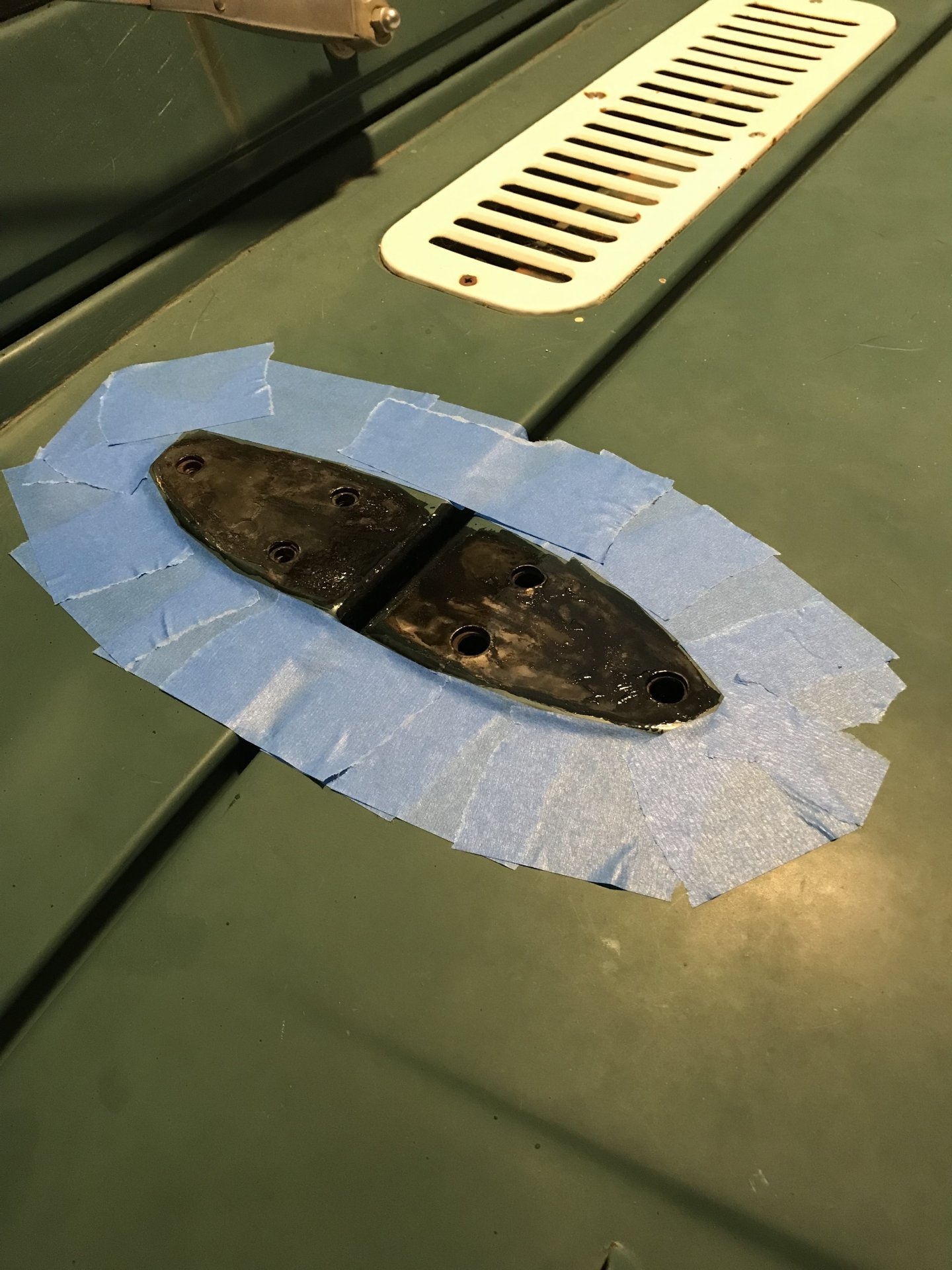

I picked up some bolt kits from @Cruiser Corps when they were having the 15% off sale, to include some for the hood hinges. Also got the weatherstrip for it.
The screws on the body side of the hinge came off easily enough...but the hinge is adhered to the old weather stripping. I've tried to pry off, but paint started to chip. Any tips on a gentle removal strategy??
Good ole mechanical action is the answer!
I was able to get all the old weather stripping and adhesive off using a combination of 3M pad, plastic scraper, and fingernail.
There was some rust, so I decided to use a converter, then painted over that with a rustic green spray can @Cruiser Corps. I used sandpaper to rough up the converter since it was a few days after I had originally applied the converter. I taped up before spraying. Its not an exact match because of fading (and maybe a PO repaint somewhere in there)... but close enough to look good enough for me
I also used rust converter on the hinge itself, and then sprayed with the spray can (below).

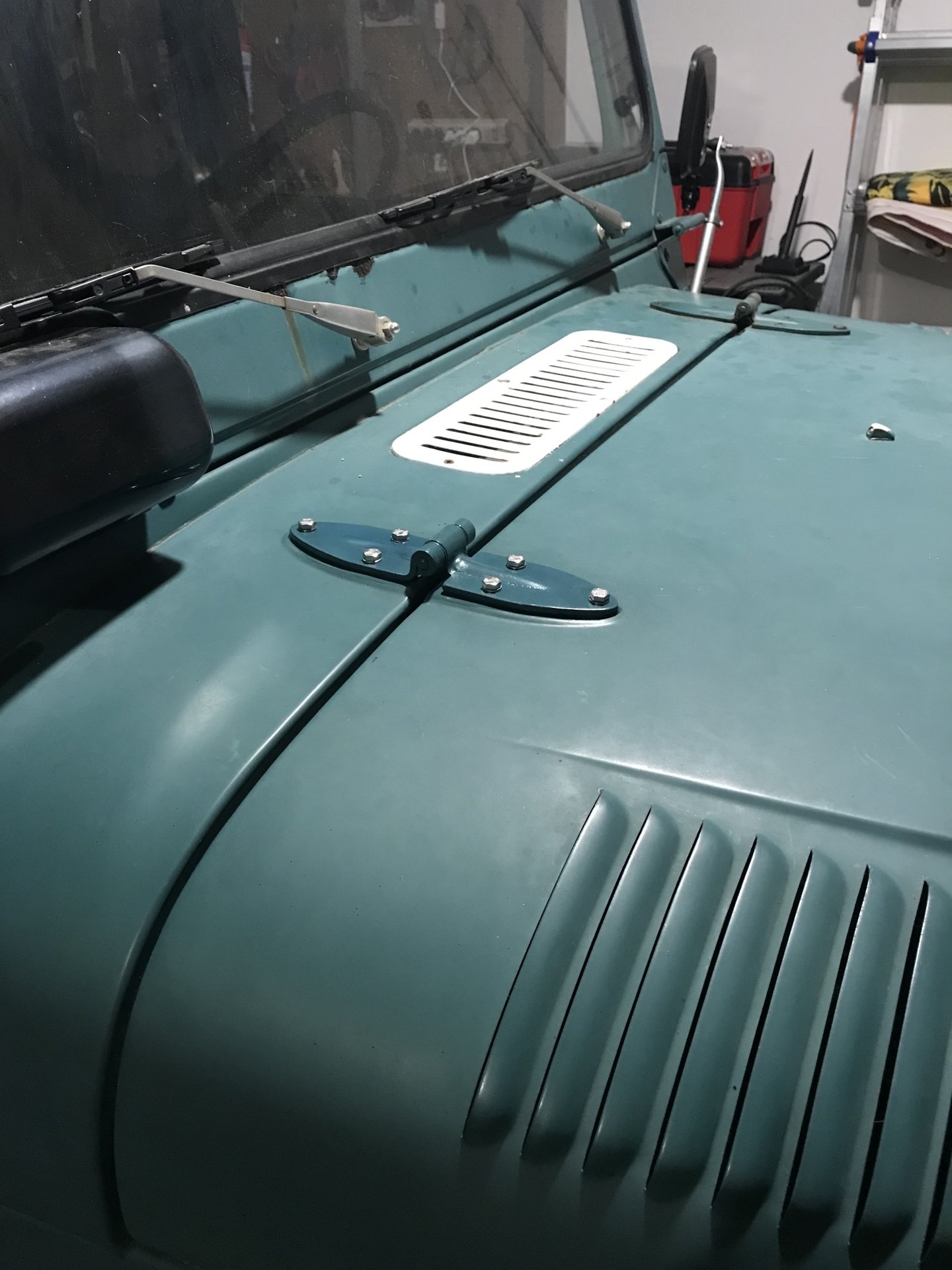

I wasn't happy with how obvious the converter was, so I ended up sanding this paint way back and applying another coat. I laid this next coat on too thick, and ended up with some orange peel. After another sand, I got it good enough looking for my liking and installed with new hardware:

Your repair looks good to help tidy it up. It Should help preserve your truck in the future and make it alittle nicer
