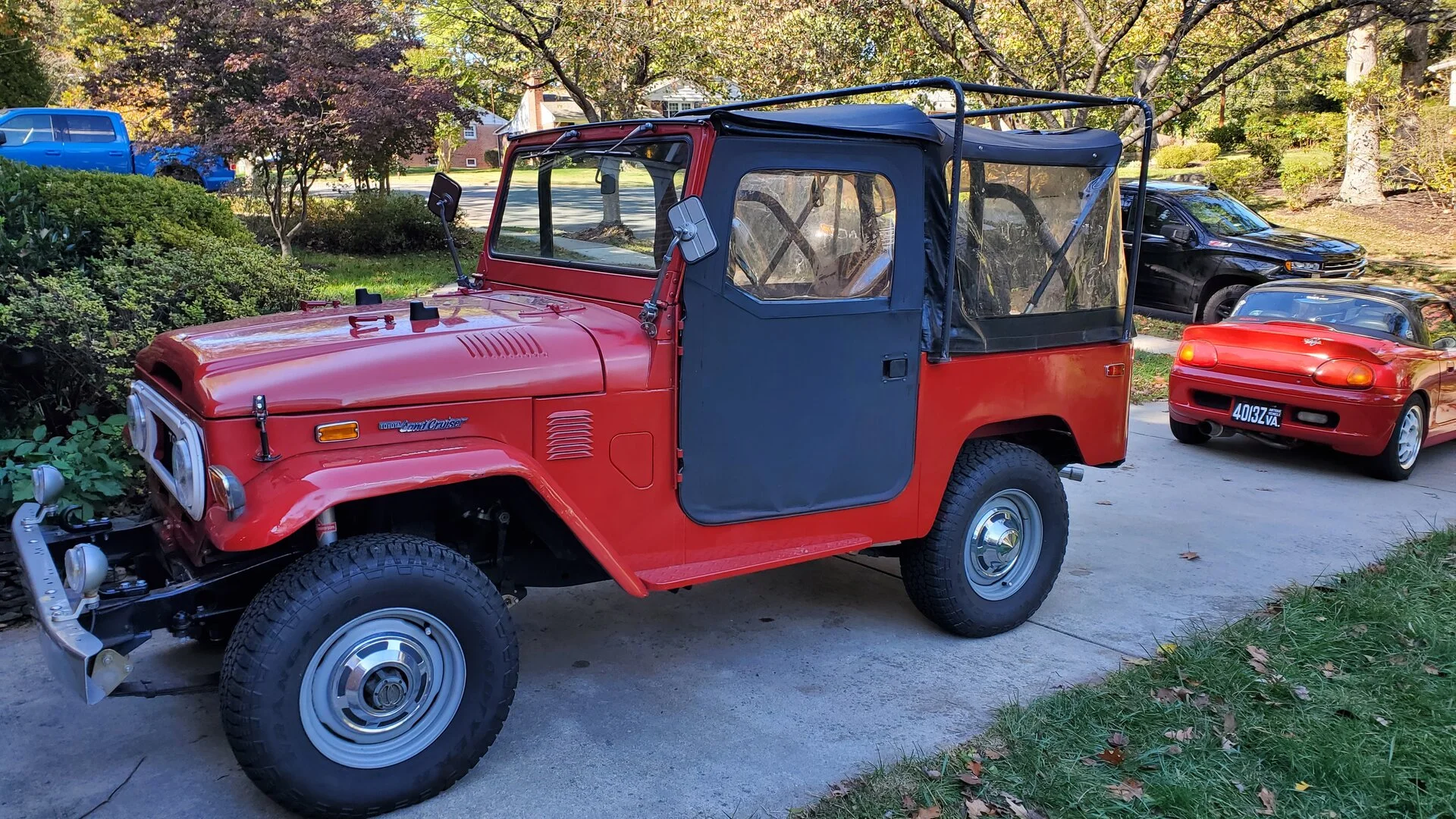

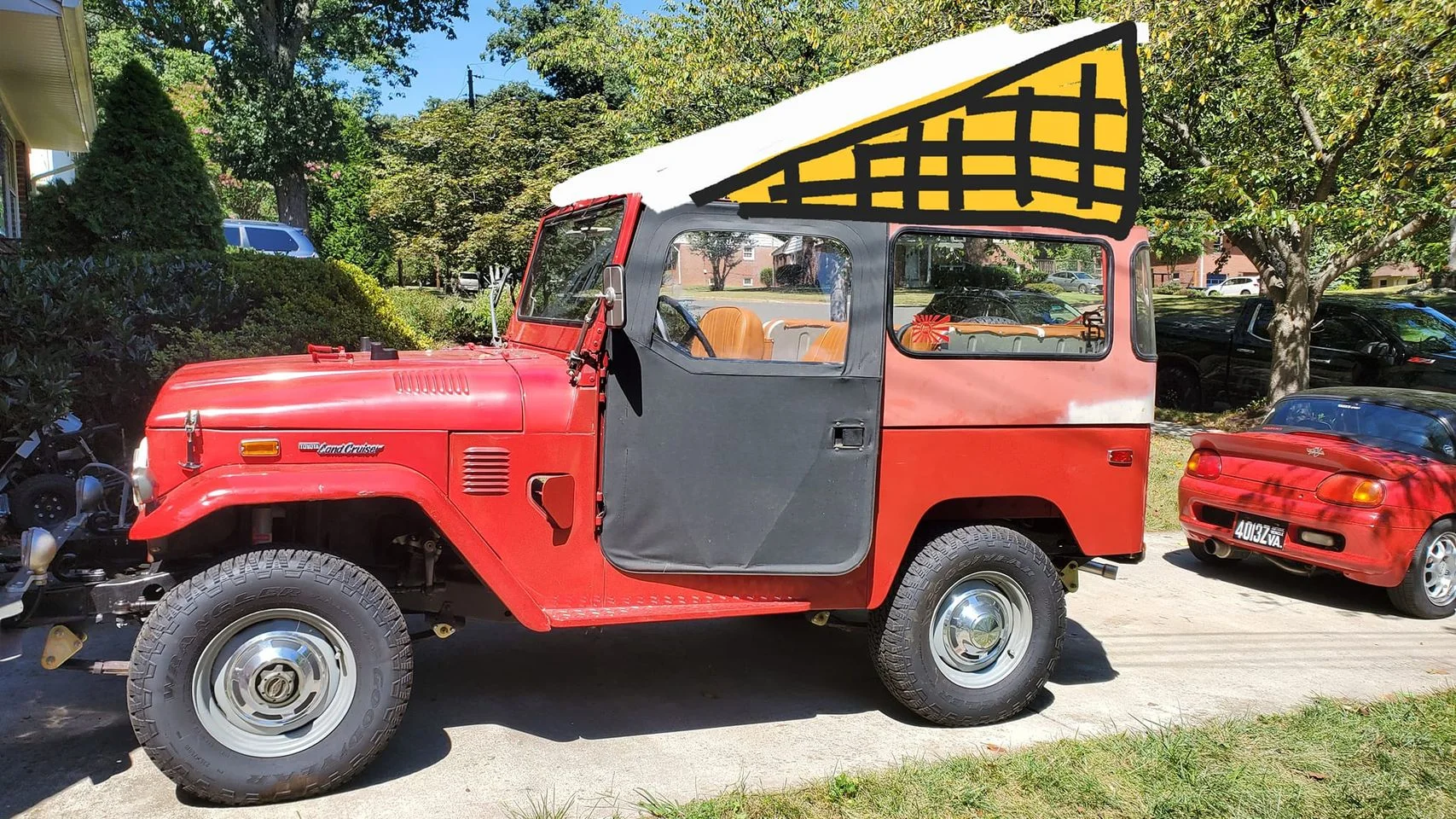

Plan is to take my newly fixed hardtop sides and my old fiberglass top, make a custom heavy duty gutter system that I can hinge on the front. thus making a Westfalia tilt top camper setup. I plan on using 1/8 inch steel for the gutter and foam on the bottom of gutter and top of sides to make a seal. (in reality the car never sees rain and I'd be a fair weather camper in it, we have a toyhauler for real camping). If you have any suggestions on the gutter system let me know. I'm ordering the steel tomorrow.
I can weld and paint so this should be doable. I painted a lot of the little red car in the image below and body worked and re-painted some of the 40.

Looks like a great project.

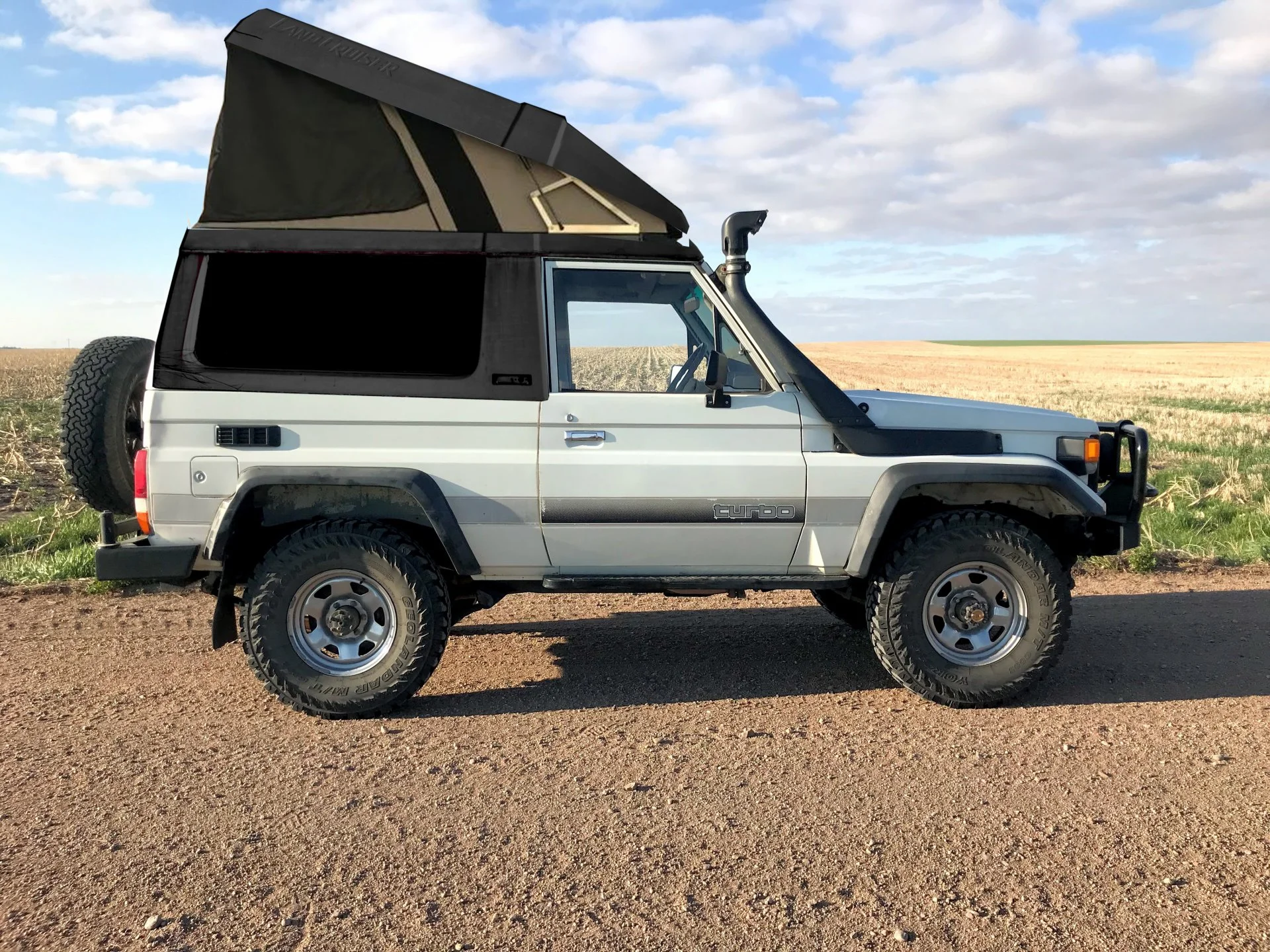

My HJ45 safari truck previously had a pop up safari roof which has since been filled over with steel, but I'd like to reinstate it.
A few points jump out to me - your 40 is much shorter, so I guess you're not planning to put a bed up there?
If you pop it up parallel, then you'll get a lot more usable head space in the limited length available.
Most of the pop ups I have seen adopt a stand-up rim in the remaining part of the existing roof to help create a seal - the actual seal is much less critical then.
very good points.
I see three things I should take into account.

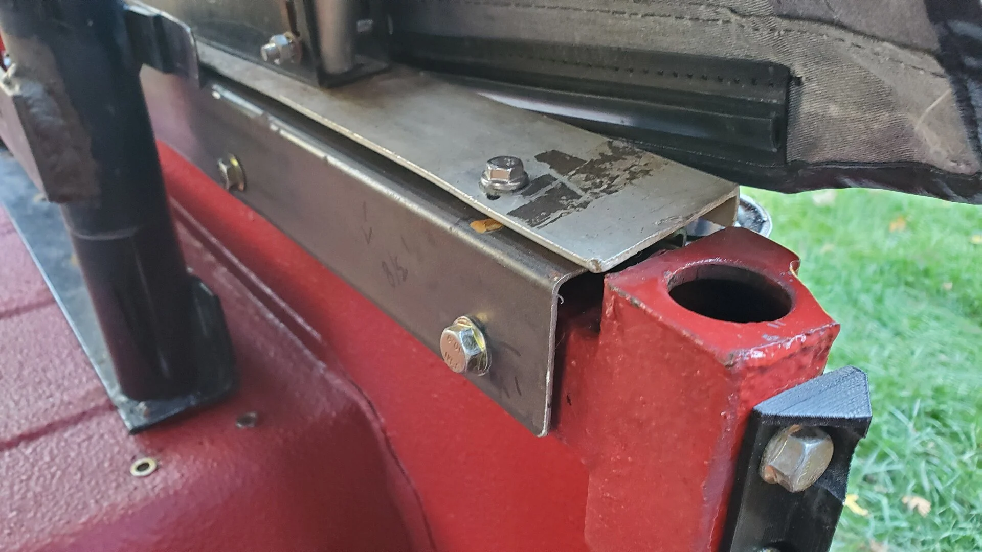

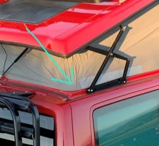

1. I need to affix a L bracket to the entire top of the side panels, like yours shows this will be the (truck side) mounting surface for the hinge, as well as keep the rain out. I'll seal the L to the sides with foam. This roughly aligns with my thoughts for the inside of the roof, likely similar dimensions to the gutter system.
2. I need to beef up the roof so it does not flex -hence the HD gutter system I drafted, maybe some ribs as well.

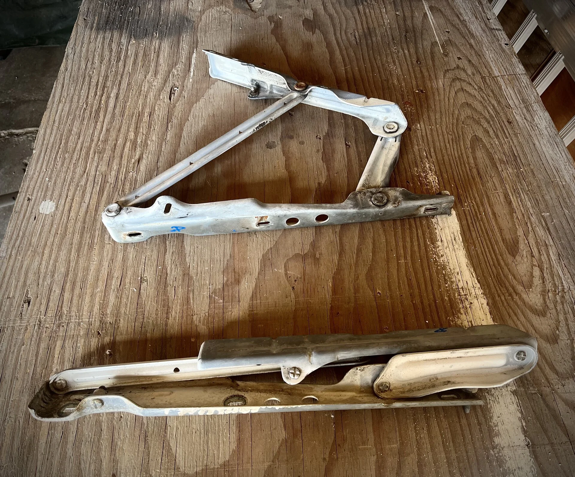

3. I like that hinge design. though it requires some tent material near the hinge
I'm only 5'10 so I can sleep in the 40, it will be a bit tight though, but a neat place to hang out, and standing room when in the back of the truck. I plan to enter from the cab via a trap door. I have some roll bar tubing I plan to use for a roll bar/sleeping platform support (eventually)

The hinges are readily available on ebay if you go that route. I bought some great waterproof canvas on there for another project which would also work for your side panels.
The VW pop up is pretty much perfected now, so it's worth a close look for some ideas.

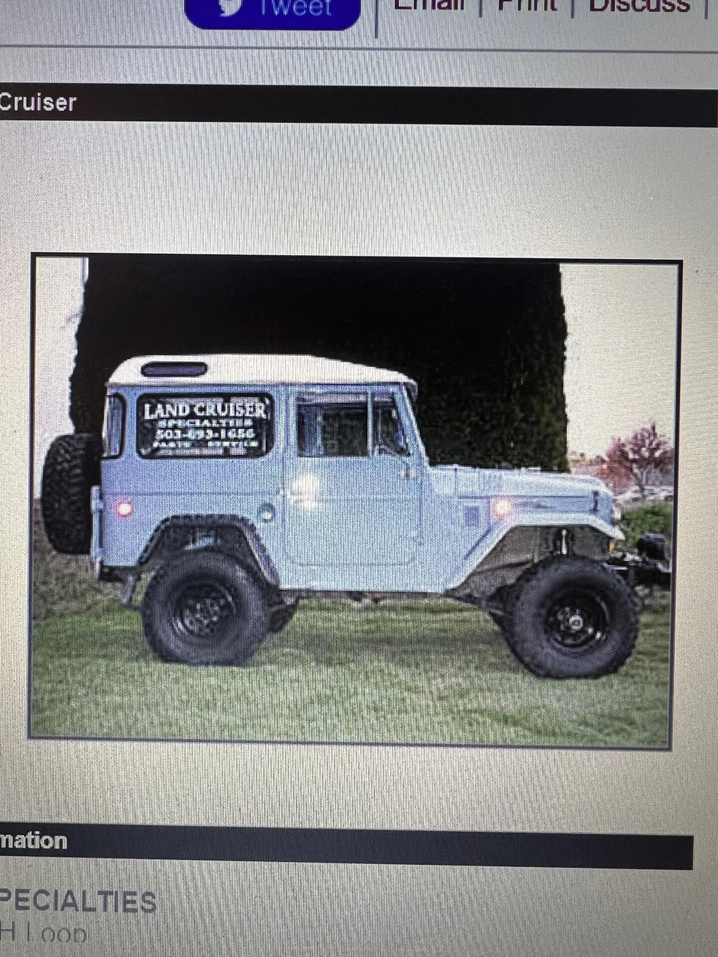

It's been a while since I removed my hard top rain gutters, but I don't think there was a whole lot of room to add rivnuts. From what I remember the rivet holes were already pretty close to the edge so trying to drill them larger would be a problem. It would be easier just to use nut and bolts with some washers.
This thread has some ideas of other pop up designs. I think the rear hinged design is pretty unique and probably more practical from an engineering standpoint, but aesthetically it looks backwards.

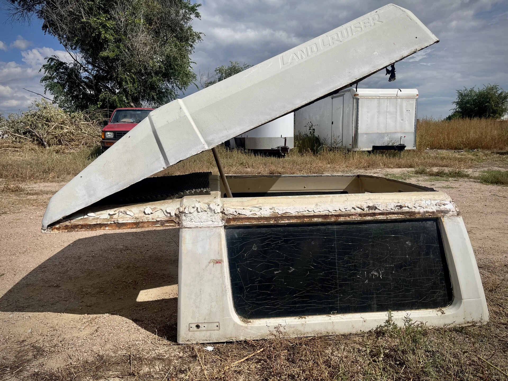

I thought of doing something similar and came up with a design and acquired a spare hard top, but never got past the prototype phase
I think in addition to the reinforced gutter, you're going to need a similar matching channel on the hardtop to tie the sides, doors, and windshield together. Without the roof cap it'll be a lot of separate pieces with no rigidity, and would be hard to seal up. Even if you don't take it out in rain, the wind penetration from the gaps will probably drive you crazy.
The lifting hinge from the westfalia is another idea I toyed around with, along with a hard sided pop up design. Without some type of lifting hinge it you lose a lot of usable space in the hinged side of the roof, enough that it would make it difficult to sleep in because your feet would be hitting the roof cap and your head would be pushing out of the opposite end. The roof is around 7ft long, which sounds like a lot but if you've ever slept in a 7ft tent you'll know it's pretty cramped even for someone of average height

I plan to reintroduce the safari roof on mine (similar to the one on this Tanzanian 70 series), but then add a canvas surrounding which we can zip in for camping.
Hopefully can tweak the dimensions a bit to fit a bed up there plus access (my roof is around 10 feet long).

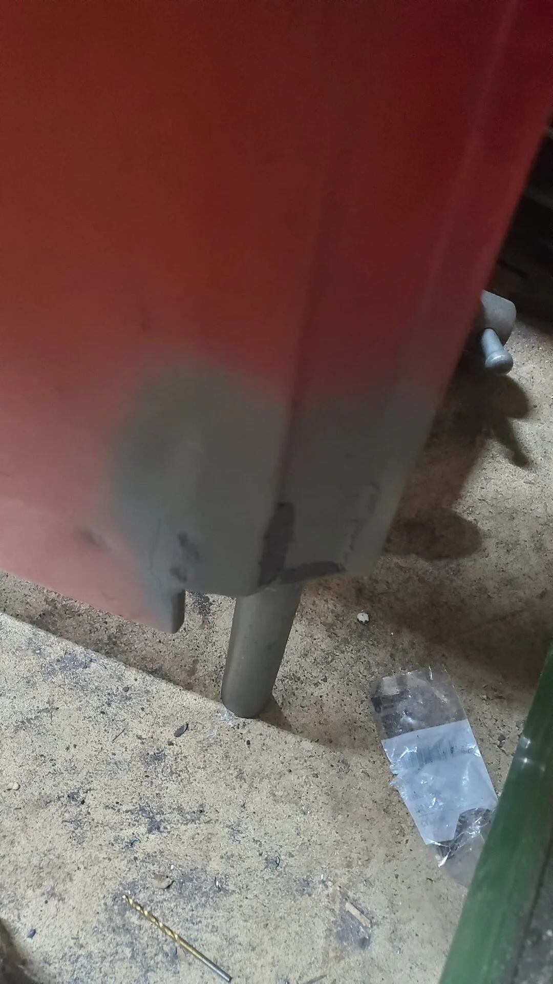

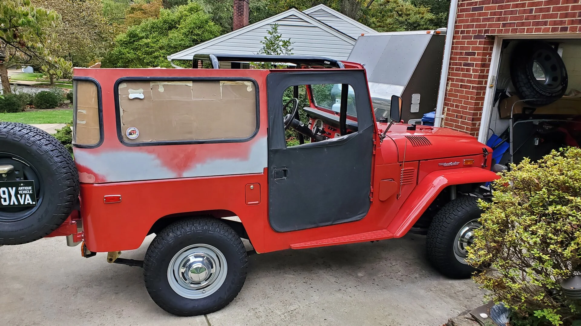

Here's a body work picture as of today. This entire corner was rotten and thin, cut it put and replaced. Pretty proud of this. Very minimal filler, just to get thr edge right. The shadow makes it looks less even.

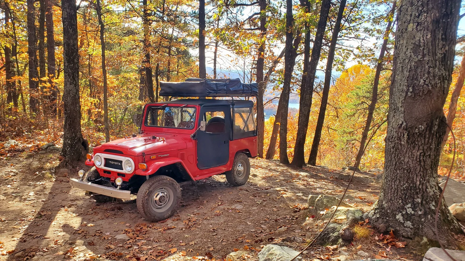

I mocked up my soft top and think I have a solid plan to make a rack out of spare 1.5 inch .120 wall tube I have a pile of. Strong enough for my RTT.

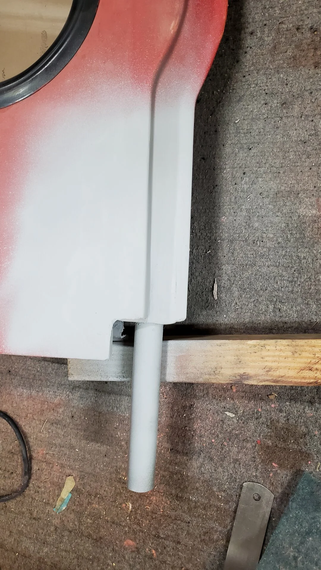

Did some mock up of the PS side pannel that's about done with body work. First time with cage and door and a pannel on. It all fits, sort of. The soft door is not made for a hard top, it overlaps the side near the top, and doesn't sit flush against the header bar, but it'll be fine until my hard doors are fixed up, or hacked into half doors (seemingly likley with the state of the door regulators and innards).
The cage should work great for supporting the front half of the sleeping platform. It definitely will need additional support of the rear of the sleeping platform. Maybe something light weight that swings down from the platform and rests on the floor So I don't have to actually tie it into the cage and it's not a weak point or a hazard in an accident. I have a bunch of 1.5 inch .120 wall DOM and thin 2 inch square tube.

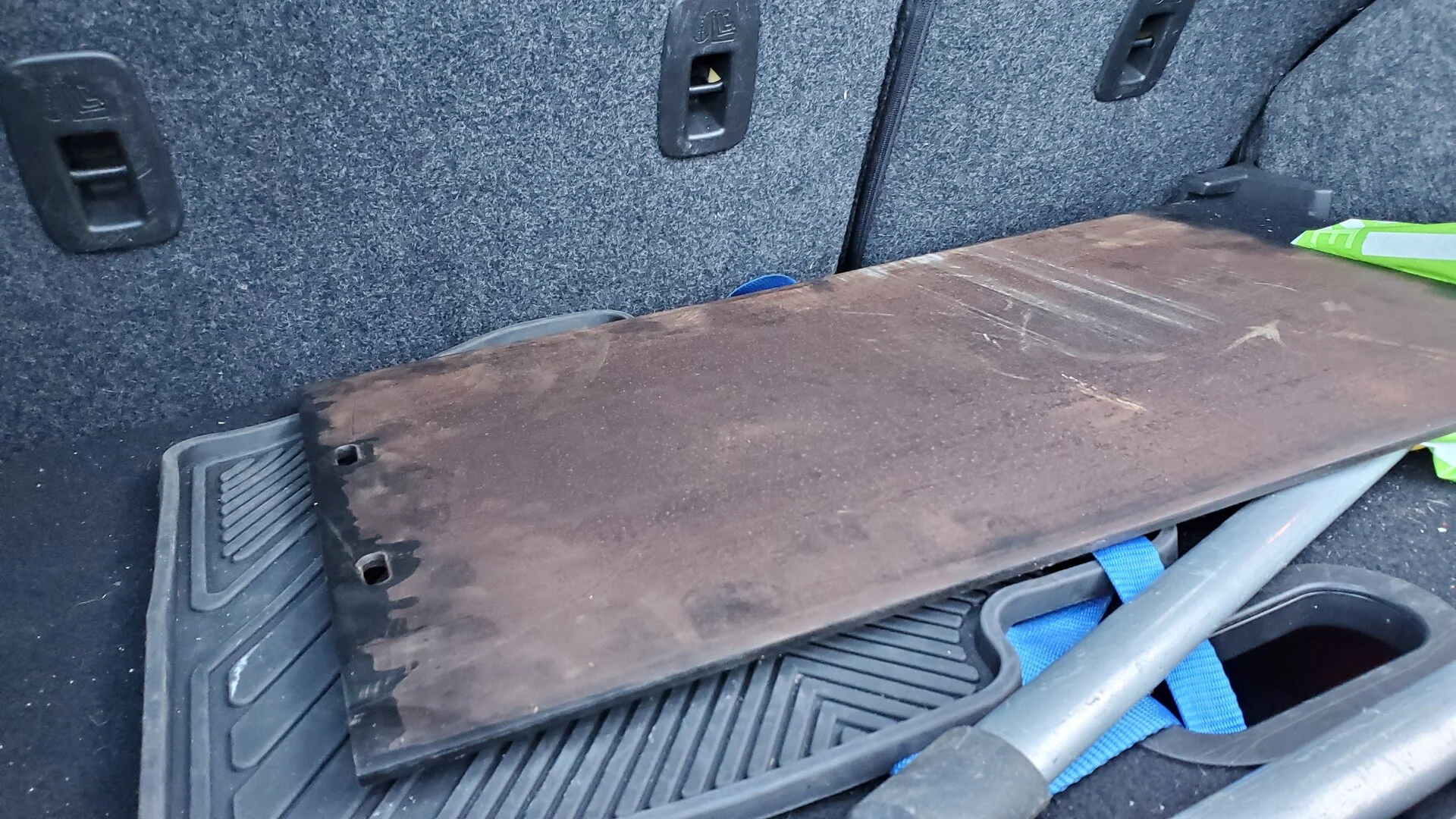

Sitting at my desk and someone says "will someone take this sheet of 1/4 steel from my cubicle". Uh yes!
Will use this to sandwich the tub and tie into the frame at the body mount for the tub/step.

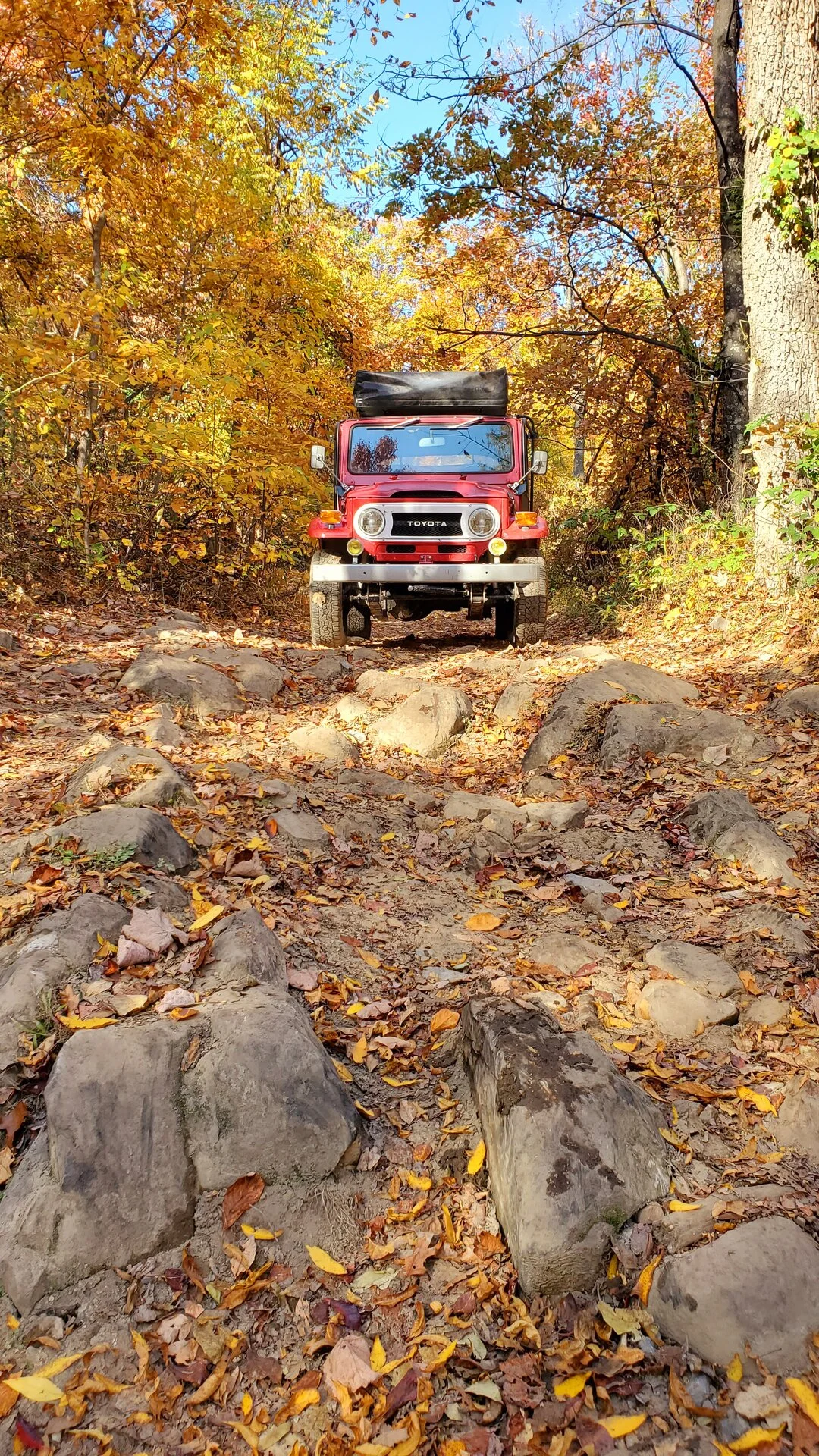

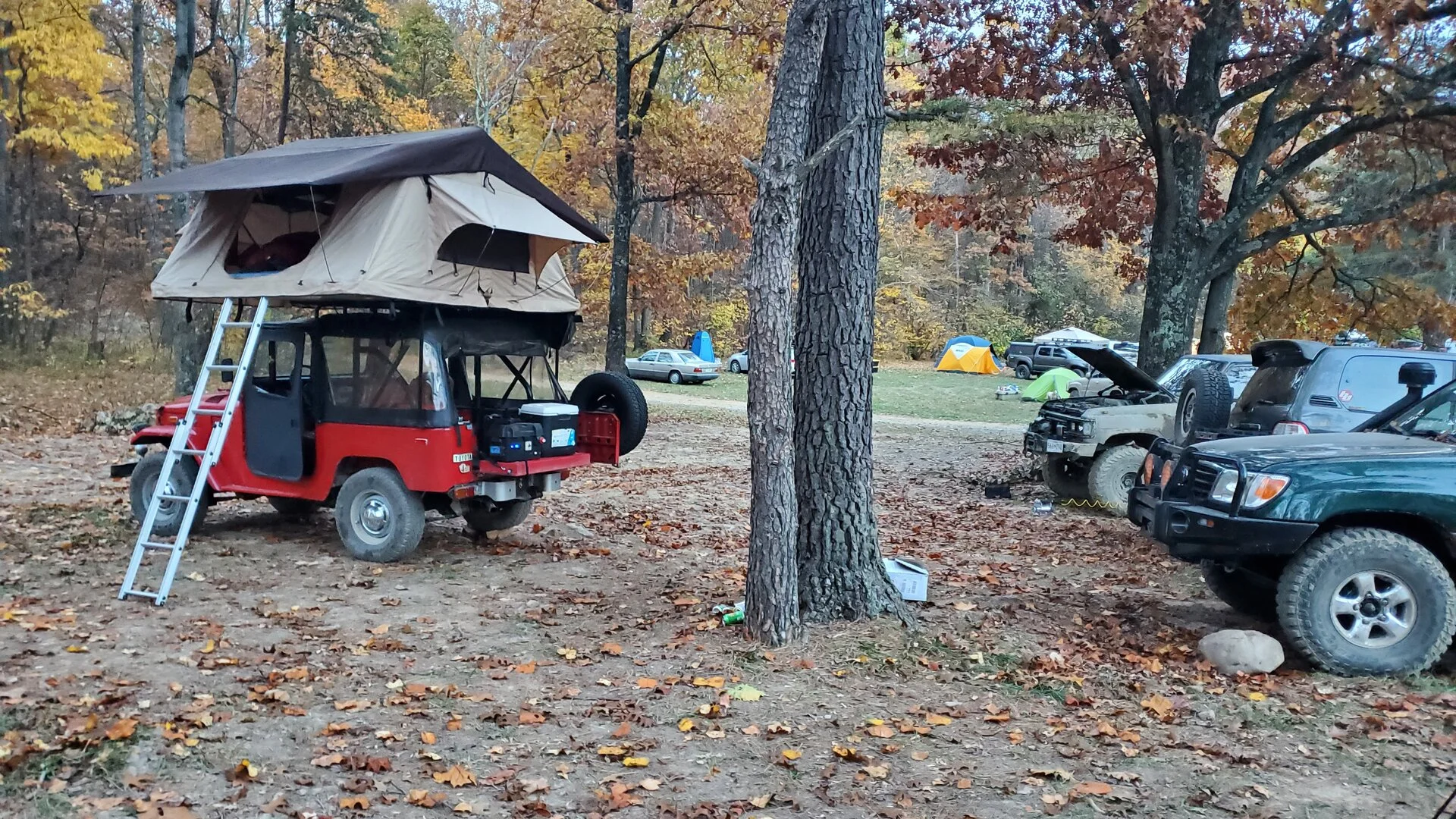

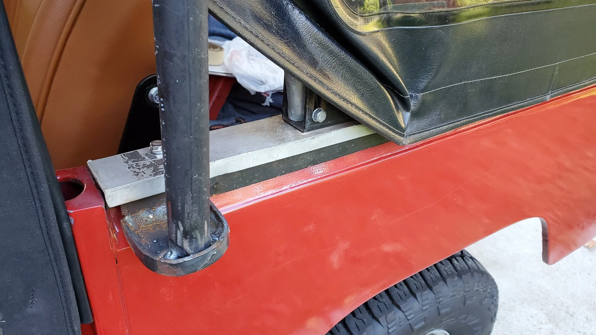

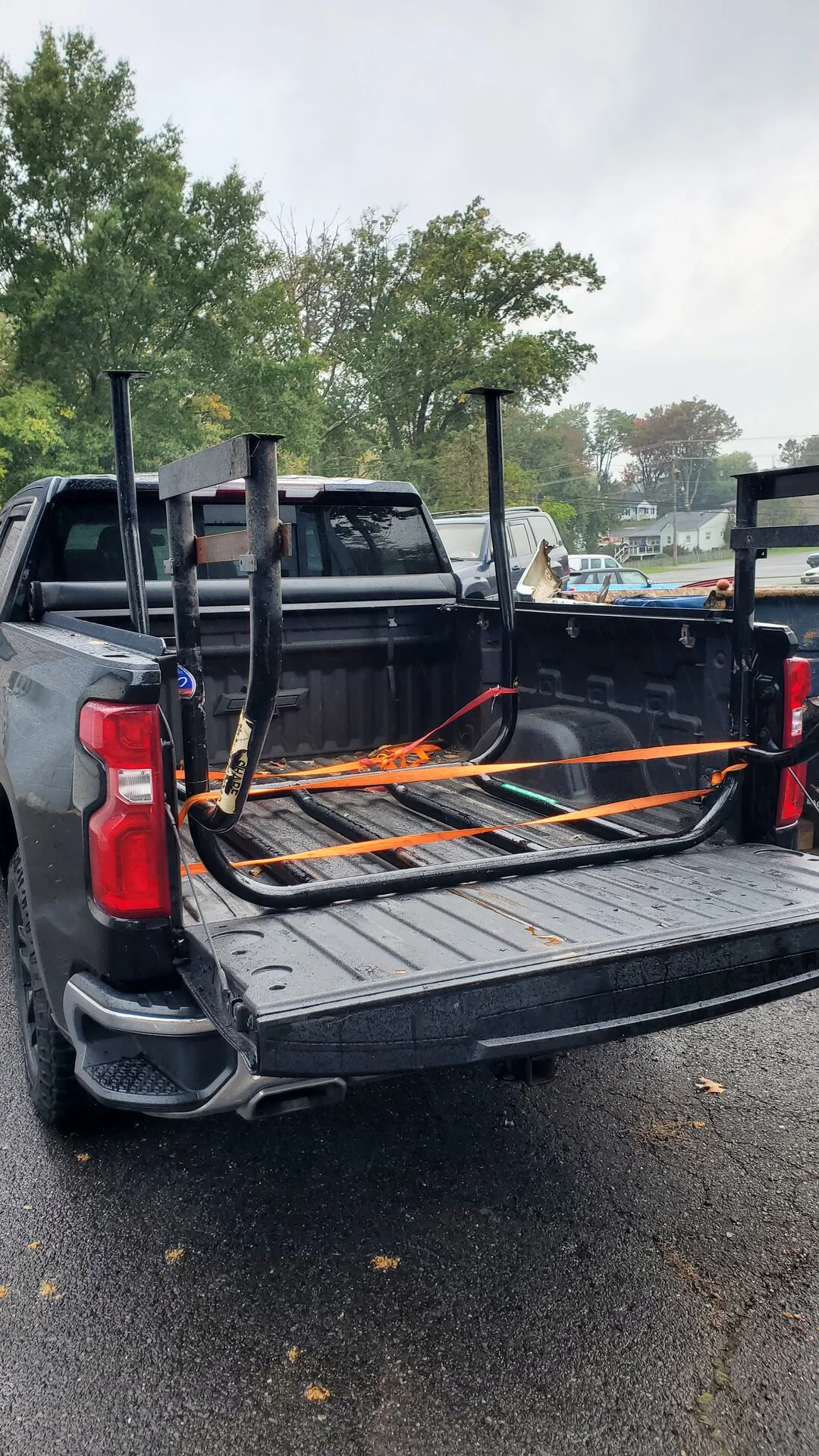

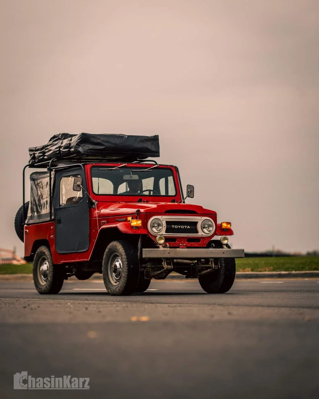

Slight change of short term plans. Threw back on the roll cage and the soft top and welded up a rack for my RTT that works with my soft top. This will do for this weekends ride. Then back to bodywork on the hardtop next week.
It uses the hard top mounts to anchor. Seems solid. Here's so pics mid fabrication. Finish welding and paint tonight.
I finished up the soft top rack in time for my trip. Here's some images. I did tie it into the windshield with some over-door-bars. Worked great. I wouldn't put a ton of weight up there but the tent was fine.
