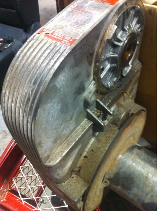

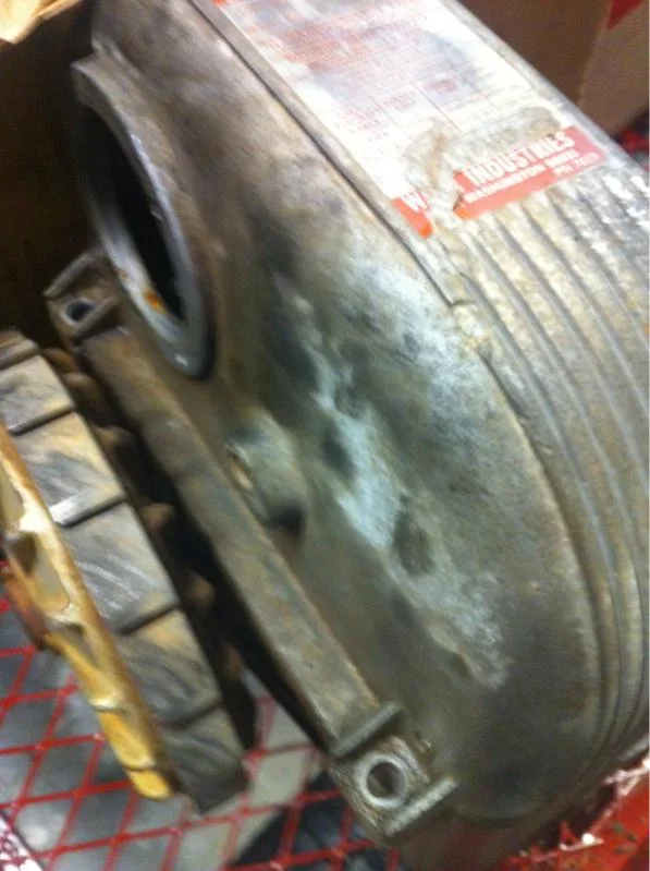

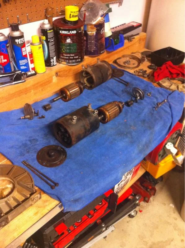

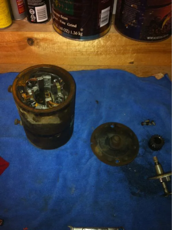

Alright so I got the motor casing and motors removed on both winches which is good. I also removed the bolts mounting the upper housing to the lower and attempted to remove it. Anyways, couldn't get the job done. I'm nervous to beat on it as I don't want to damage it. Any ideas on how to get the two cases to separate? Am I missing something?
Looks great man! Did you order new stickers from Warn? I'm curious if they can send you a replacement sticker for your S/N. Also how did you get the two cases to separate?
Thanks for the tip, I'll find a shop and see what they say.
Yep - just call and ask for the decal kit for an older 8274, it has a window for the S/N. I just hit the side of the upper case with a rubber mallet, be aware there is a tongue and groove along both sides of the case if you try and pry it apart ;)

Thanks Tucker.. I tried to pry it apart and now I will Move towards pounding with a rubber mallet. Also I'll be ordering a couple decal kits from Warn. Thanks for the lead on that.

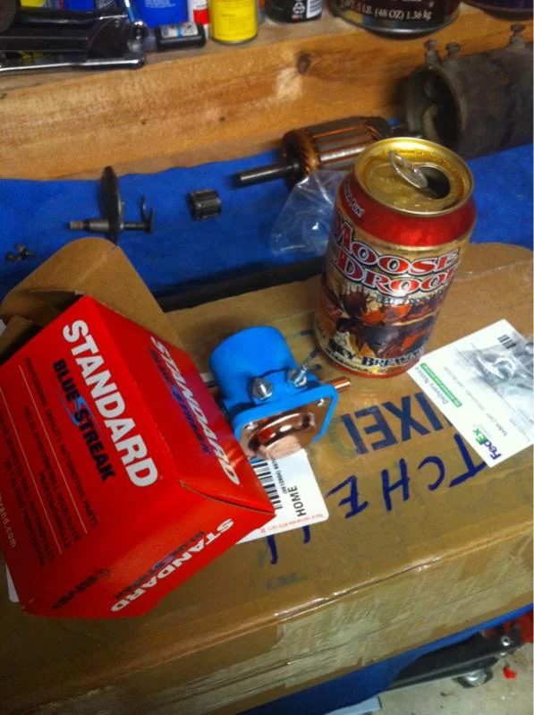

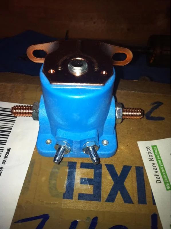

Got my new solenoids in... They appear to be the same exact style as the original warn solenoids. Except they are smurf blue, I guess that's where they came up with the "blue streak" name. I honestly thought the ones I ordered were black. Here's a couple pictures
Just looked online for the blue streak ss581. It looks like they typically run about $20 to $32 each. I purchased what Rock auto shows to be the ss581 and their image is of a black solenoid. Anyways paid $15.00 bucks a piece. Good buy, hope they work!

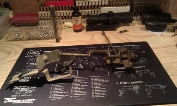

Linkage..
Hey Man, looks like I got enough stuff here to connect your foot pedal to the carb............

Do you think those solenoids will work I just got in? I can't find any info anywhere on if they will run continous. I know Tucker mentioned People are skeptical.
Don't know about those...
Need to be there abouts 100% duty cycle rated, if not they will stick closed under load leaving an uncontrollable situation..... seen that before, wasn't a pleasant experience..........
Thanks I'm uncertain if these are continous. This is probably my first fail in the winch rebuild. Hmm...

No - he is stating you should put a marine type isolation switch on your power to the winch. This is a good idea anyway IMO, but would allow you to kill power to the winch in the failure case before it causes damage ...

So I need to return these solenoids and get different ones.
