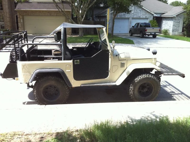

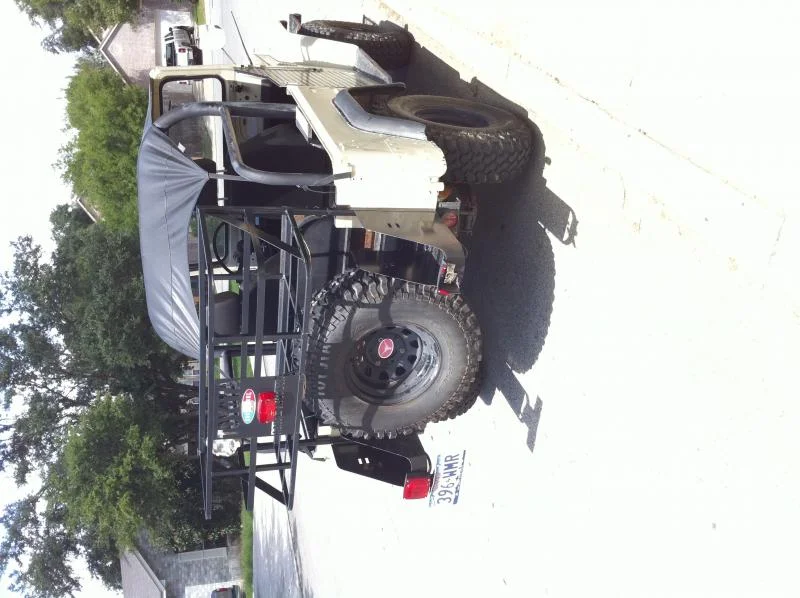

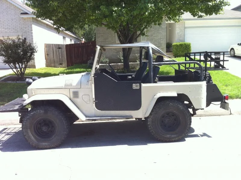

Well after much debate, much research, and many questions, I have decided to go ahead and tear my 73 down, and build it back up. I got my hands on this 40 after much conversation and a fortunate trade (one of my quads for this 40). Anyways, long story short, PO bought it to restore with his son but never did exactly that. Now onto the nitty gritty. I am not sure what my plans are for this 40 but I am hoping to educate myself and be educated on these amazing machines. I fought with idea of tearing it down or just fixing what could be fixed and going on, well I decided to say heck with it and tear it down. Best way to learn right? As I go through this build, I would highly appreciate any advice or tips from you all, so please feel free to put as much input into this build as you can, as I will truly appreciate it. Below are a few photos of my 40 prior to tear down.....

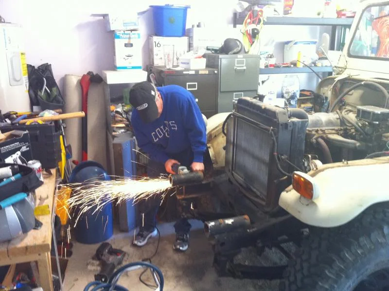

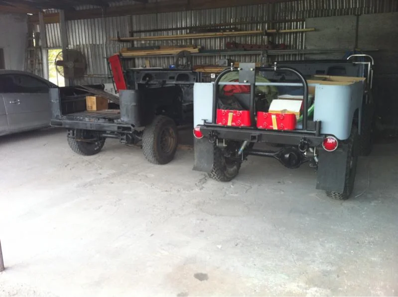

Alright, first thing on my list was to remove the dang bumper and the rear spare tire carrier... The spare tire carrier came easy but whoever welded on that dang Texas ranch style hunting adventure crocadile hunter type front bumper welded solid as I went through almost 5 metal cutting wheels in order to cut it....
continued....
Alright well decided to cut the main part of that front bumper off, leaving the support part still welded onto the frame.... After a couple hours of trying to break the welds I said hell with it and relaxed.. The family friend in the photo took about two minutes to cut both off using the same angle grinder....

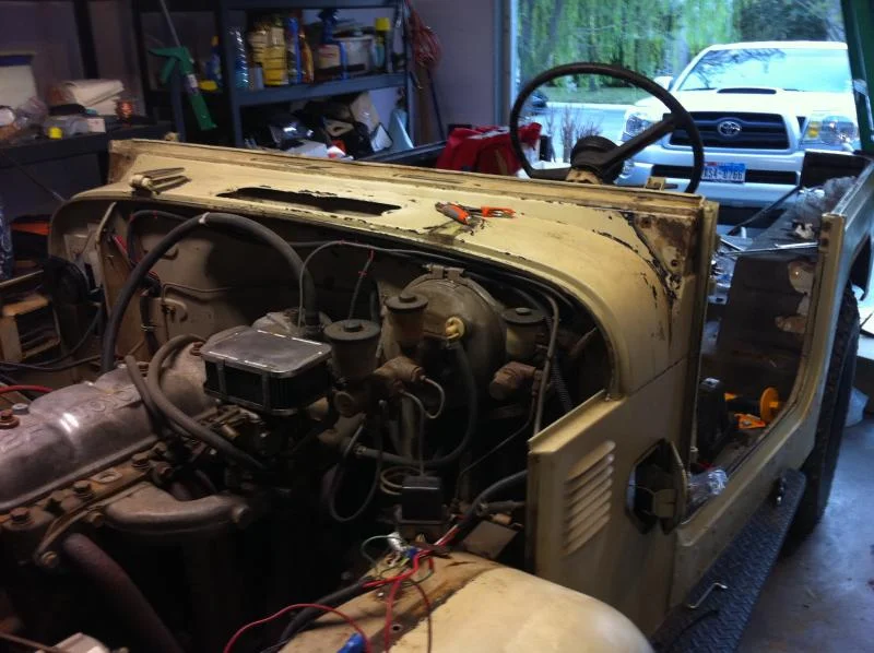

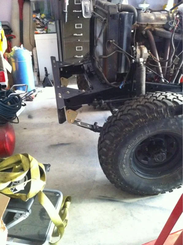

pictures of where its at now....
some more pics...

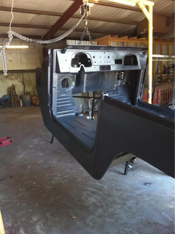

I have removed the tub from the frame, and am planning on cleaning it really good here in the next week or so and applying rust bullet with the rust bullet black shell.
Also I will be picking up a good tub on Saturday and hopefully taking it and the rest of the parts that I had sand blasted and primed by blast the past into the body/paint shop. Im hoping to make it to the body shop before they close Saturday.
Ive decided to go with 6h9 Olive Grey as the paint color of choice. I am still debating if I am going to have the bottom of the tub and inside of the tub Linexed or not.

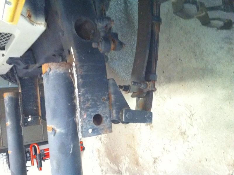

I was also going to purchase 4 inch springs from a gentleman that was local, but with his wisdom, the warranty part became a concern. So with that said, I just placed an order for a 4 inch Hellcreek lift with steering stabilizer kit.... I must say Tom at Hellcreek is great to work with. I decided to opt out of the Hydro shocks that he sales due to the fact that I bought Bilstein shocks from a gentleman.
What shackles are you all running? I really would like to go stock height, and the width of the hellcreek springs are 3 inches from bushing to bushing on the outside. Is there really a need to replace the pins? or Shackles?

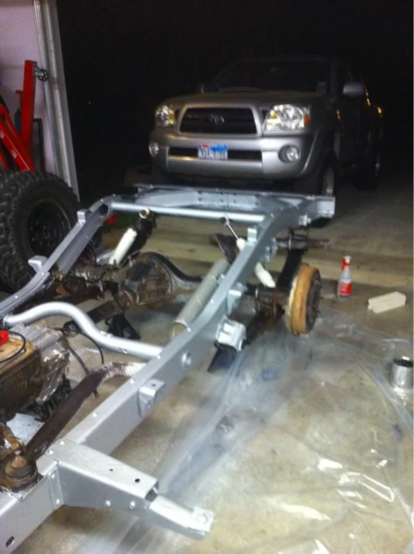

Here is a list of what has been done so far:
-- Removed the old tub, Thank you Kevin
-- Purchased another tub from a gentlleman in Dallas
--Dropped off that tub to Scott to have new rear quarter panels, sill, and what not, thank you Scott for the welding
--took everything to Stan at blast the past for sand blasting, thank you Stan
--Cut that hillbilly front deer hauling bumper off, thanks Terry for the help
--Pressure Washed the frame really well
--Applied Rust bullet with black top shell to frame (My better half did most the work)
--Installed 4 inch hell creek springs, $OR greasable anti-inversion shackles, greasable pins, Thanks Chris and Joe(mainly Joe)
--Installed Bilstein Shocks that I purchased from a fellow mudder for little to nothing pretty much new
--Purchased, blasted, and painted 5 stock steelies and had my 33x10.50 wrapped around them
--installed a new front bumper

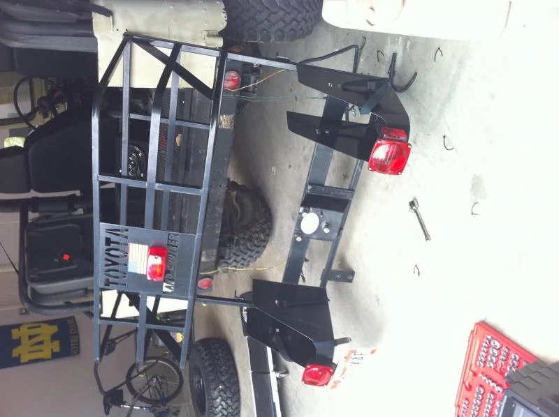

--went ahead and installed my spare tire carrier that I purchase from Dirt worx
--all the bolts that have went back in have been the full flange gold cad kit that Dave Workman sells here, great kit, easy

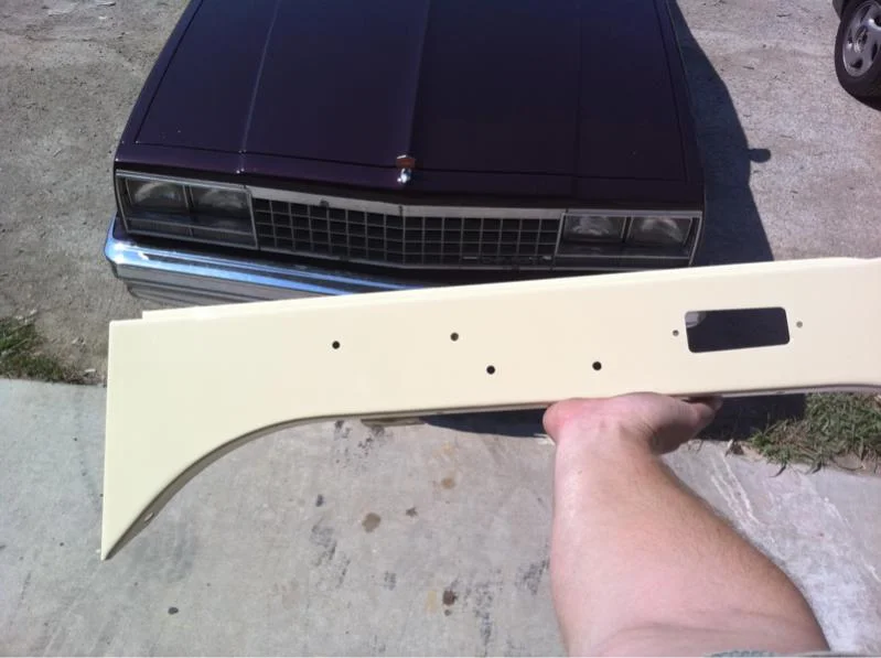

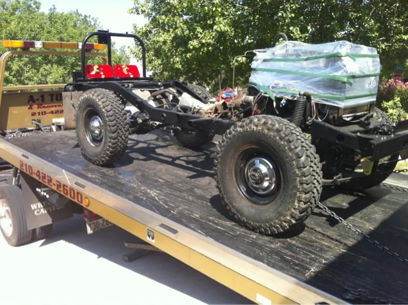

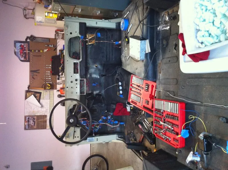

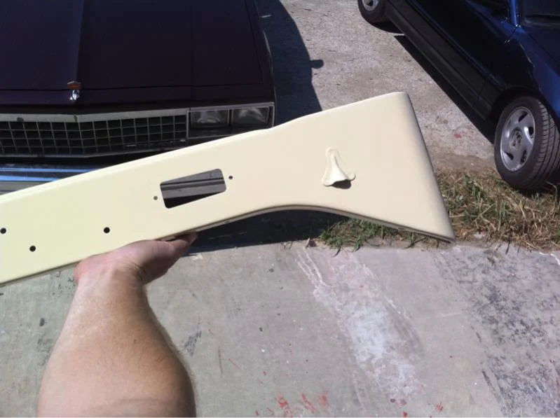

I'm sure there are things that I am missing on here and what not but today the chassis was moved to the paint shop. I decided to go ahead and have it painted the sahara tan color which you can see below. I've got new autometer gauges, new oem fuel tank, new wiring harness, and the list goes on and on. Now that I have found this Ih8mud app for the iPhone I hope to update much much more often. Its been a long time since I have but anyways looking forward to posting more...
Here are some more pics
Dude, thats looking good. You oughta paint the axles and shafts while its tore down.....
Thanks Kevin, painted the Axles, but need to touch the bottom side up when I get it back. What do you think about the color on that apron?

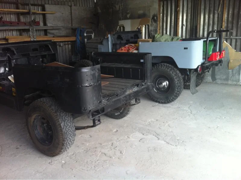

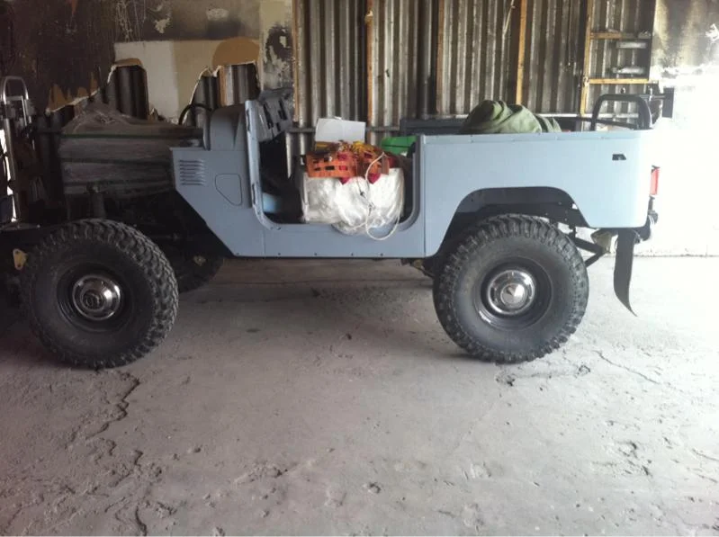

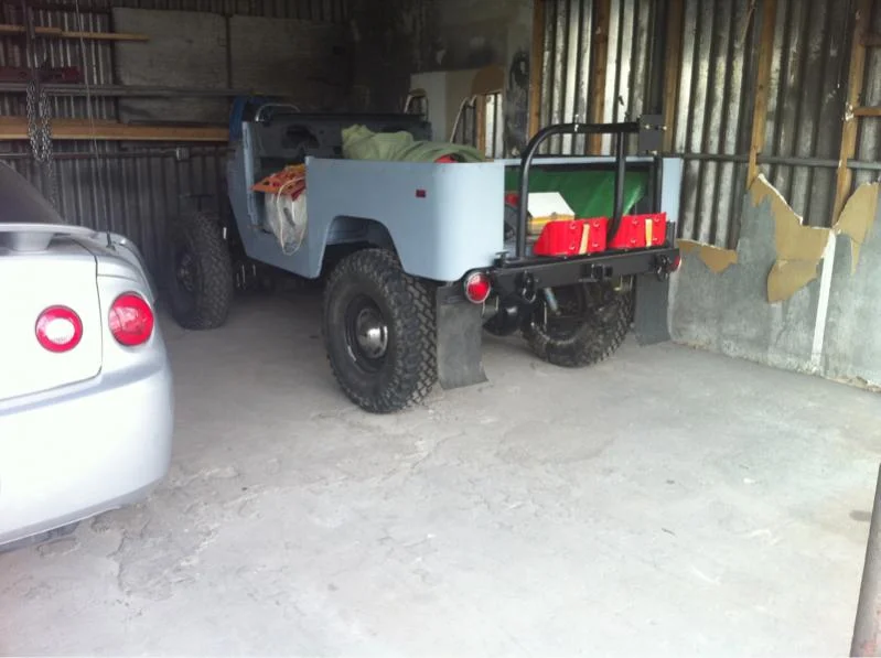

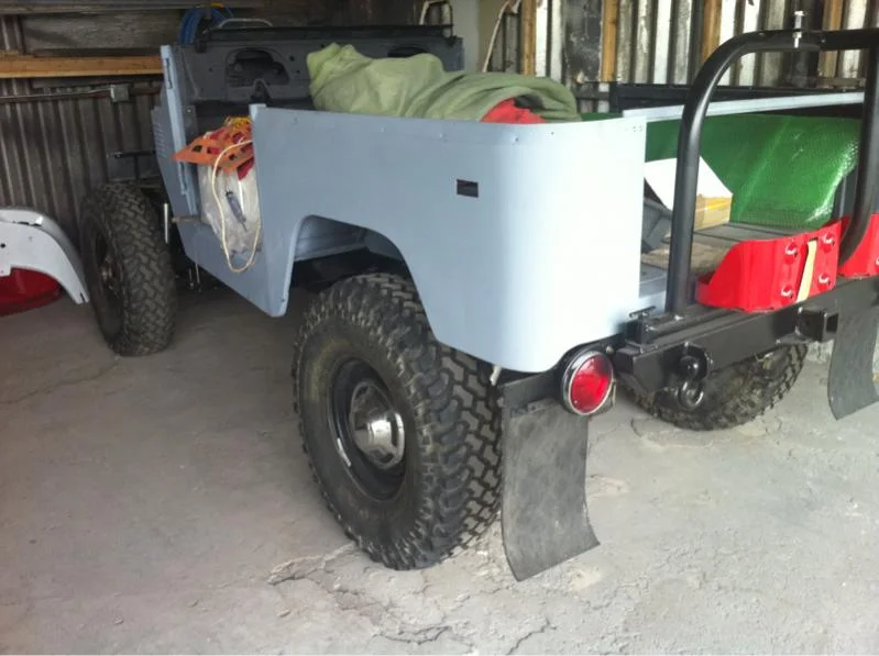

Here are don't updated pics. The tub is just sitting on the frame as my painter lost his lease due to owner selling and had to move the rig. The black fj40 sitting next to mine Is a fellow mudders project
